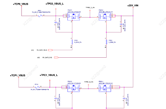

    Review the mosfets on the attached page. Each is a suspect. Remove all power. Meter in resistance mode. Measure the resistance across each of the DCin mosfets:
    source (1-2-3) & drain (5-6-7-8)
    source (1-2-3) & gate (4)
    gate (4) & drain (5-6-7-8)
    Each measurement must be hundreds of k ohms or higher else is a suspect and part may be defective.

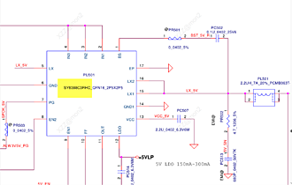

      Thanks mon2 for the tips., I checked all the 4 MOSFET & all were 100% ok. Upon more trouble shooting, found that this chip gets very hot, it the 5VALW chip & the number printed on the chip is QrFHB. I have this chip in stock SY8386BRHC (Qq). Is this chip the same as SY8386CRHC (Number printed on the schematics)??? or I have to find the correct chip SY8386CRHC. I was checking AE, I could not find this number. Thanks dear
      • mon2
        • Dec 2019
        • 14512
        Hi. How is the great weather there? Crazy hot here.
        No - cannot replace theSY8386CRHC with SY8386BRHC - there are differences. Measure the resistance to ground of the output of the SY8386CRHC.
        Pins # 12 & 13 do not match between the 2 different parts.​​

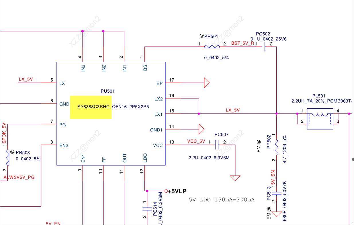

              Can you confirm which IC was replaced on the board?
              For PU501, the part number showing in my database of schematics is SY8388C3RHC.

              • mferna14
                • Jun 2018
                • 1038
                Yes this is the same IC SY8386CRHC which was replaced..... It's Qr... which is the same # on the OLD & new chip... Now at least 5v is stable & the chip does not get hot at all.

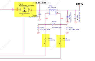

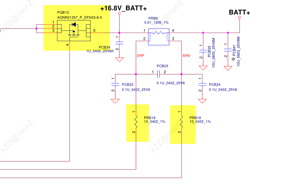

                  Remove all power. Disconnect the battery. Measure the resistance between pins SRN & SRP (19 & 20) directly on the charger IC.
                  What is the full path resistance of the battery charger leg?
                  Measure the resistance across the mosfet pins of:
                  battery mosfet @ PQB13
                  source / drain
                  source / gate
                  gate / drain

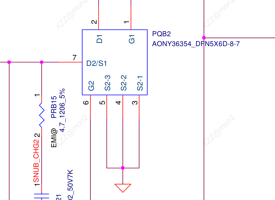

                  Repeat for PQB2 but note that this is a dual mosfet in a single package so review the pinout for same measurements.
