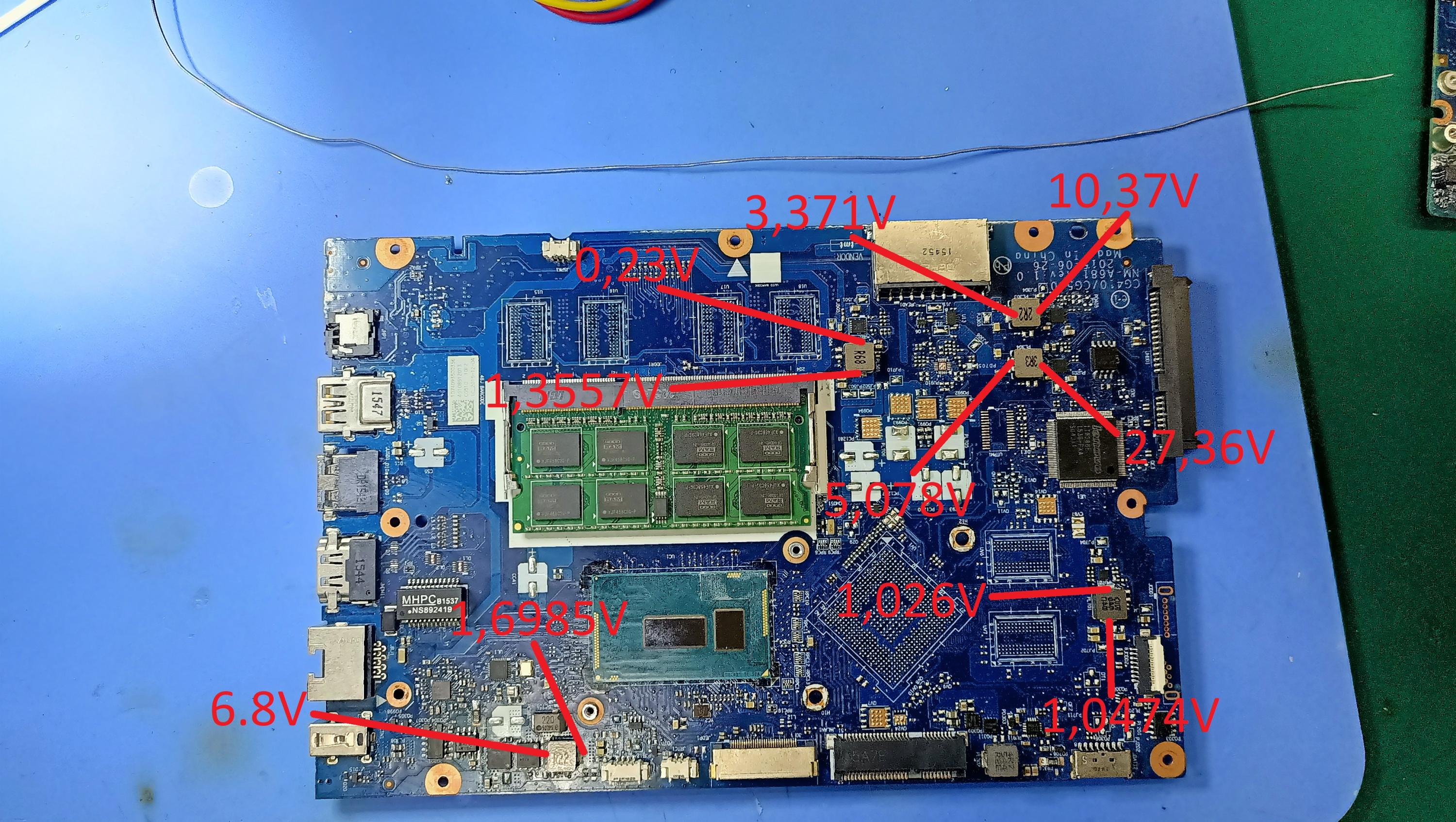

      Thanks for help, I replaced PQ307. Now laptop turns on but with no display, cpu is cold.
      I measured coils:
      PL9: 1.6985V
      PL701: 1.0474V
      PL304: 5.078V
      PL303: 3,371V
      PL501: 1,3557V
      Bios chip Has 3,370V.
      Power supply consumes 0.098a when turns on.
      If I shutdown through button it consumes 0.011a.
      I programmed bios and changed ram nothing changed.
        That is 98 mA and is a very low current for a laptop.
        Check the voltage to ground on each power rail / coil. Someone is off.
        Confirm the main power rail voltage to ground after the DCin mosfets.

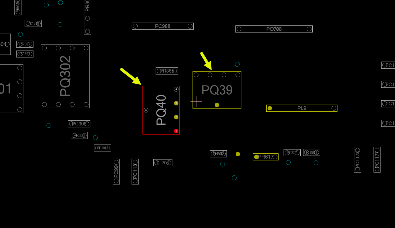

          I measured coils, measurments in attachments and checked pq40 and pq39. Should I replace them because of low resistance?
          PQ40
          S:4,45 voltage to ground
          G:16,148 voltage to ground
          D:20,10 voltage to ground
          diode test: 0,53V
          Source - drain: 2mohm and goes down (no power)
          Source - Gate: 1ohm (no power)
          Gate - drain: 13mohm and goes down (no power)
          PQ39
          S:0 voltage to ground
          G:4,4528 voltage to ground
          D:4,32 voltage to ground
          diode test: 0,0767V
          Source - drain: 37,48ohm (no power)
          Source - Gate: 10mohm and goes down (no power)
          Gate - drain: 11mohm and goes down (no power)

            Yes, they both look bad but remove each and check their resistance again when they are off the logic board and on your work table.
            If the resistance remains to be low, replace the mosfet.
            Post the measurements. On a good mosfet, the resistance should be high.
            Start with removing one mosfet to check if it impacts the resistance of the other.

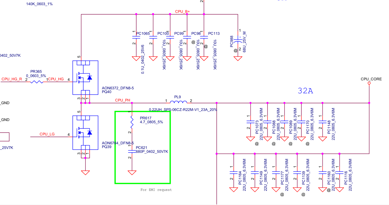

                                      Re: Lenovo 100-15idb NM-A681 no turning on
                                      See attached. Can you confirm that the measurements are from the correct mosfets?
                                      It is important to confirm as the ~37 ohms to ground may very well be the CPU rail resistance.
                                      Take the resistance to ground @ PL9 inductor - remove all power.
                                      What is the resistance @ PL9 ?
                                          This is the CPU vcore rail and by design, it will be a low voltage and respectively is a low resistance to ground rail.
                                          Unless this rail is extremely low in resistance, this resistance reading looks ok to me. If the CPU was shorted, then you may see extremely low resistance readings like 1 ohm or less.
                                          You can measure the resistance of the removed mosfets while they are off the logic board. If the mosfet readings are high then place them back.
                                          Each, the high side and the low side work together to lower the very high voltage used by the logic board to a safe value for the CPU core.
                                          After the above, confirm if the switching regulator for this rail is being enabled or not. This is pin # 1 of PU908.
                                          In either case, do not power up till both mosfets are onboard and confirmed to be soldered ok. Otherwise, if for example ONLY the high side mosfet is soldered but the low side is removed, then the regulator @ PU908 will assume both onboard and the CPU will be killed since there is no mosfet to lower the high voltage. Both mosfets must work together to lower the voltage to a safe value.
