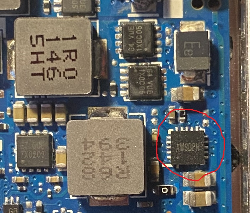

    I'm trying to fix this Asus UX435E which has been water damaged.
    I cleaned everything, removed a bad capacitor and he powered on. I access the bios just fine but a chip becomes mad hot and the laptop shuts down.
    It seems that this controller chip is faulty: its reference seems to be "AWDPN" or "AWS0PN"
    I tried to find reference on the web but no luck on this (seems to be very close to SY8288RAC with "AWS5MA").
    Can you help me finding the good reference?
    Thank you
    Re: UX435E: Water Damage
    Hi it is the same the first 2 or 3 letter give the ic typethe other 3 are year and badge number.
      Wow okay perfect then!
      Thank you very much!
        It's sticky thread right above your request:
        IC Marking Codes and Datasheets
