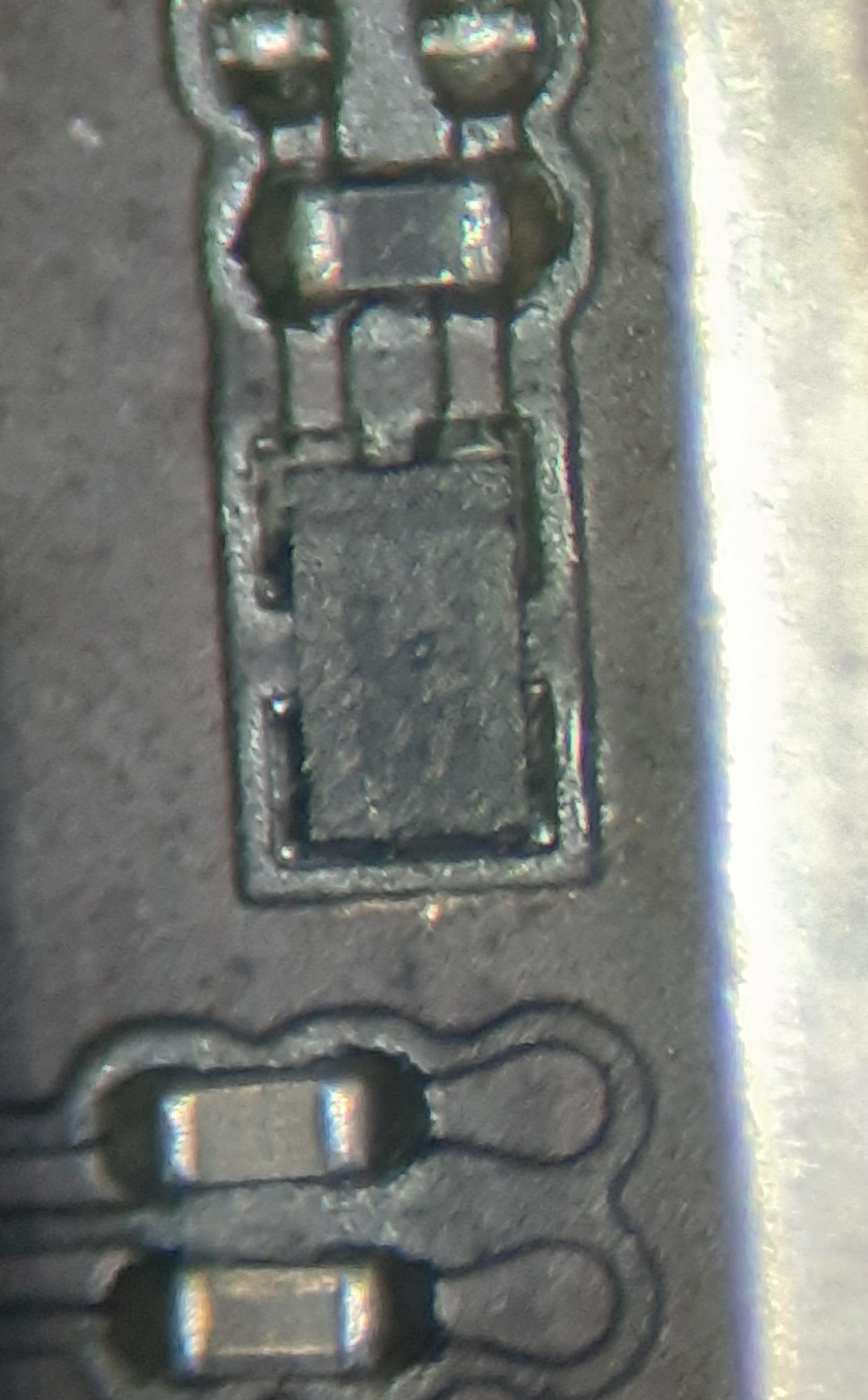

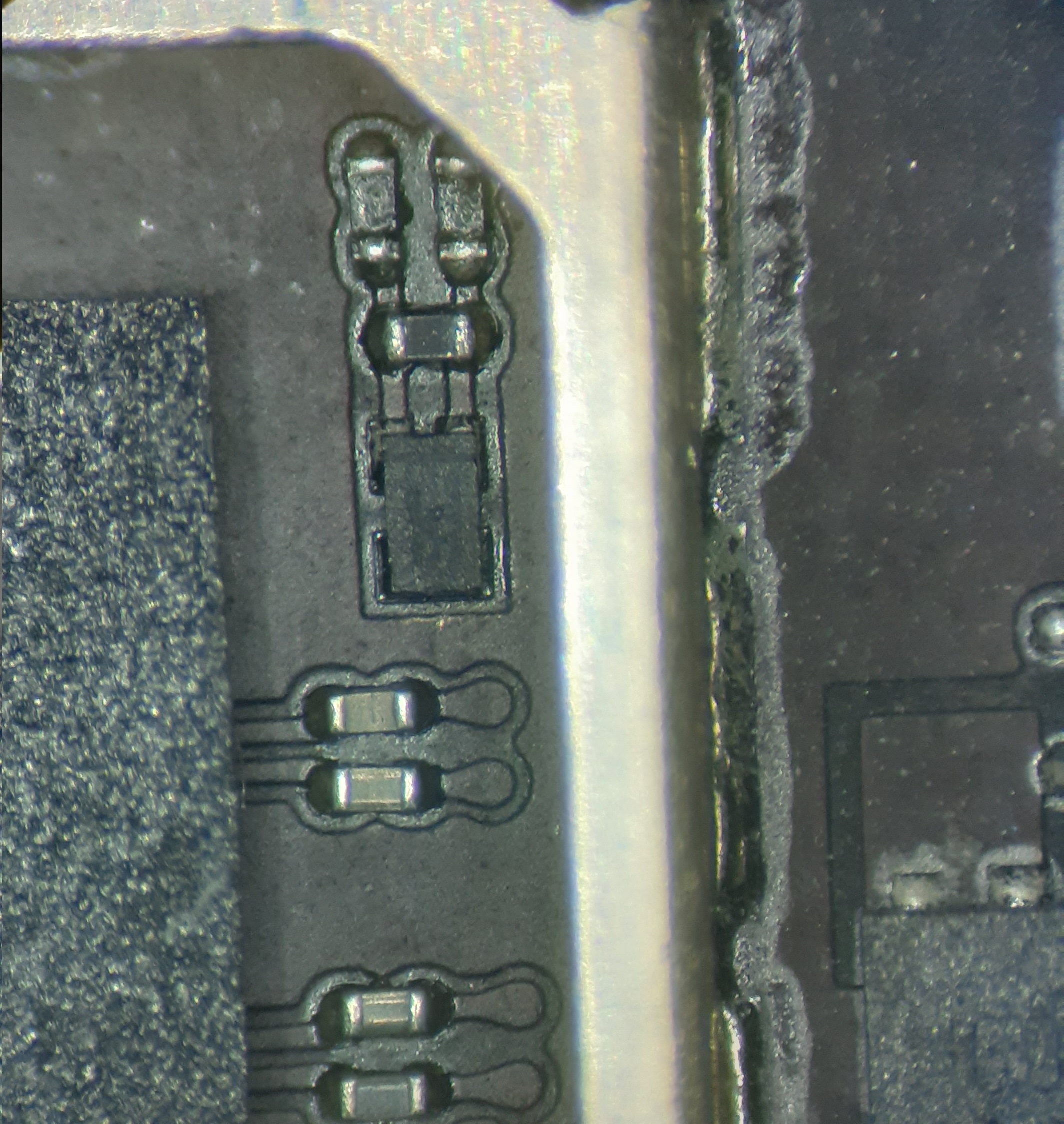

    Hi guys
    The PC in question starts automatically when the power supply is connected both with magsafe power supply and with bench power supply it behaves the same.
    This happens both when the pc is whole, i.e. with all the periferals connected, and only with the card removed from the case bare and raw.
    There is no light on the magsafe connector, the fan spins fast and nothing appears on the screen.
    I understand that the main voltages are present on the board, if I have checked correctly.
    PP15V_TBT is not present.
    There is no obvious oxide damage or the like, or anything like that.
    It seems to me that I only noticed a sort of small hole on the Q5820, I am attaching the photos (apologies if they are not crystal clear) TBT Sensor.
    Could that be the cause? What can I check?
    I gladly accept advice.

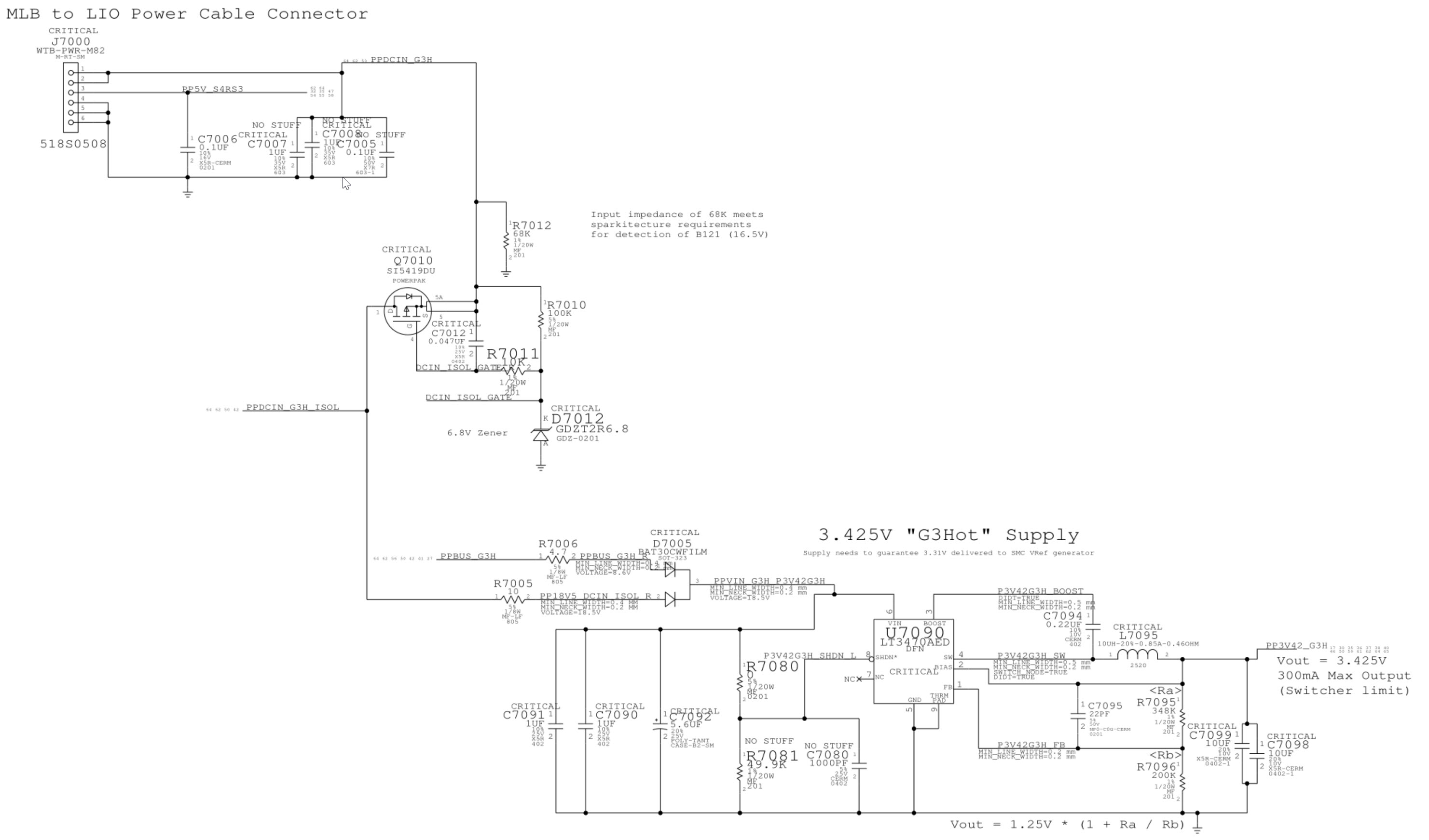

    Re: Macbook A1466 820-3437-A no green light and fan speed full
    No green / orange light means you do not have the PP3V42_G3H power rail which is used to power the single wire communication of the magsafe interface (head only for your case). This single wire communication is used to soft start a true Liteon (Apple original) power supply and is also used to index the green / orange LED inside the magsafe head.
    Select your meter to DC 20v or higher voltage scale.
    Measure the voltage to ground of each point (with your power adapter connected) of:
    D7005, pin # 1; Red probe on this pin; black to ground
    D7005, pin # 2
    D7005, pin # 3
    Then check the voltage to ground of PP3V42_G3H @ L7095.
    Post each measurement.

      Here are the voltages:
      D7005 pin n. 1 - 8.12V
      D7005 pin n. 2 - 14.66V
      D7005 pin n. 3 - 14.39V
      L7095 PP3V42_G3H - 3.40V
