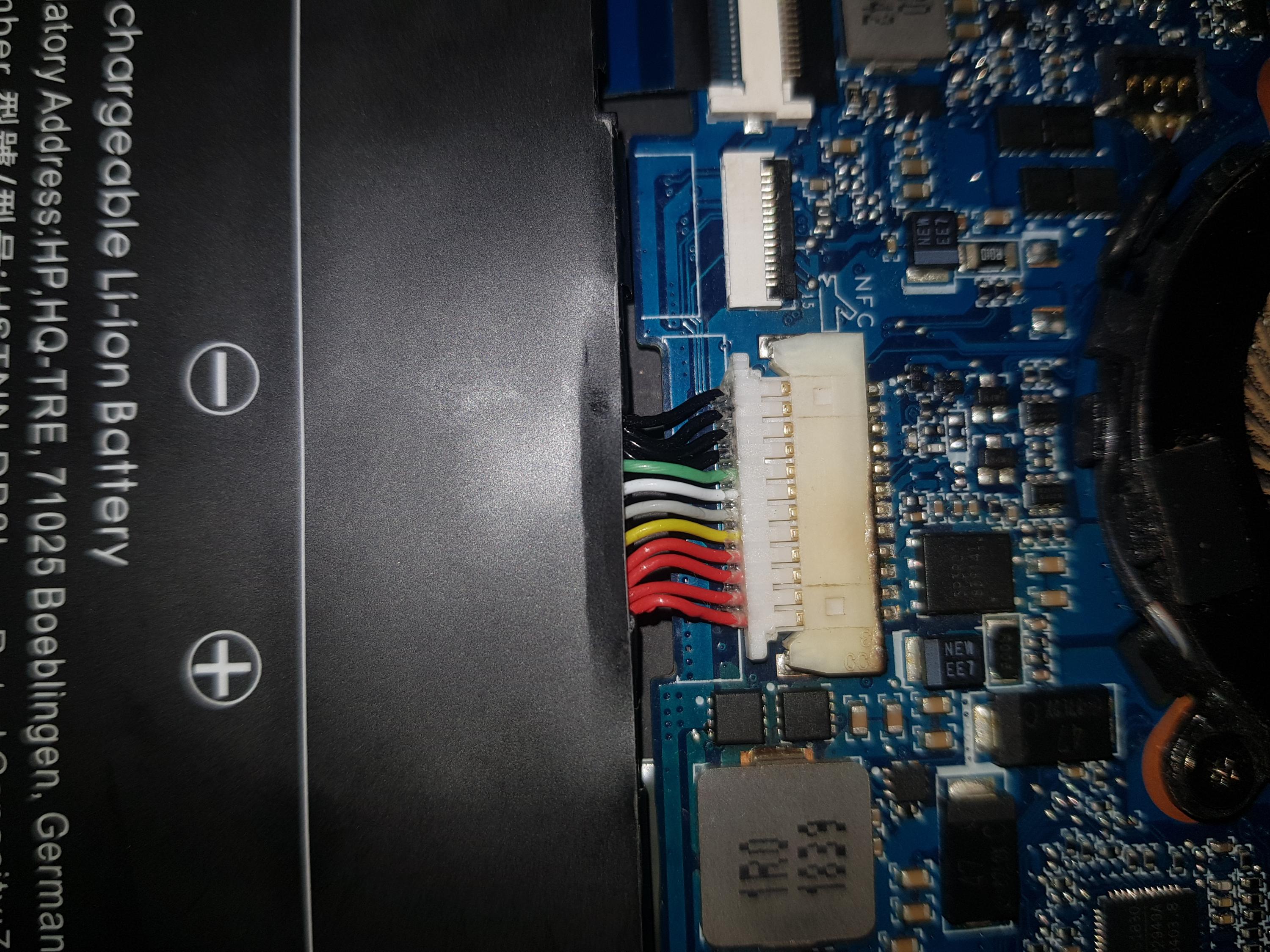

    What is the possible solution for hp x360 1030 g3 that detects battery but does not increase, I have tried with different batteries that i know work, I have also replaced the charging ic but that does not solve the issue.
  • mon2
    • Dec 2019
    • 14334
    Re: 1030 g3 battery not charging
    Check the voltage to ground of each pin on the battery connector.
    The SMBUS SCL / SDA lines often contain a TVS ESD diode that can get zapped by static transients. This event will then pull down the SMBUS line(s) and cause the balance of the battery functions to fail.
    Post the measurements.
      Pins RED 0V
      Pin yellow 0V
      Pin Grey 2.9V~3.1V*
      Pin White 0v~1.1V*
      Pin Green 0V
      Black 0
      *They have the 1st voltage when battery is connected and 2nd one when battery is disconnected

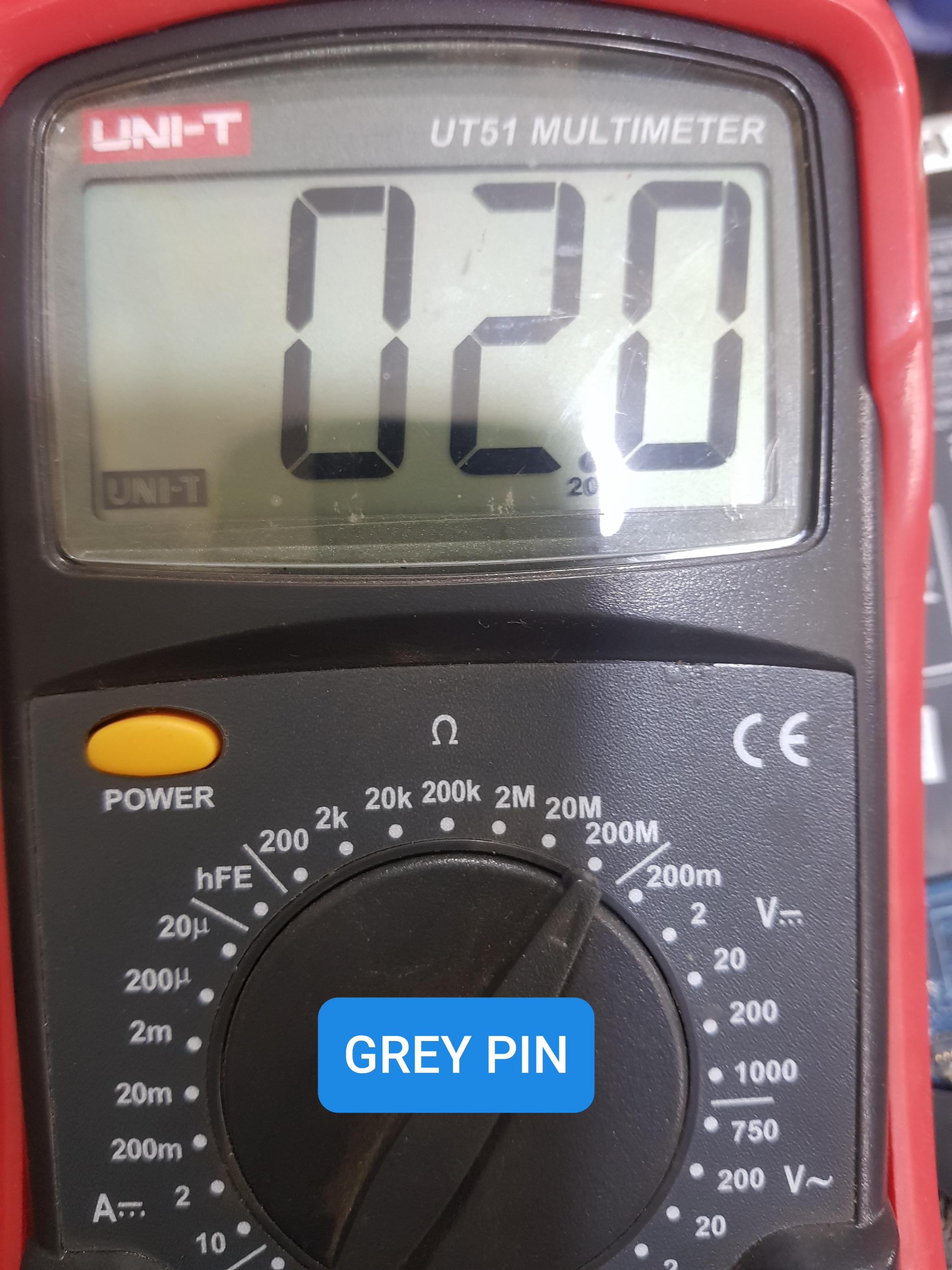

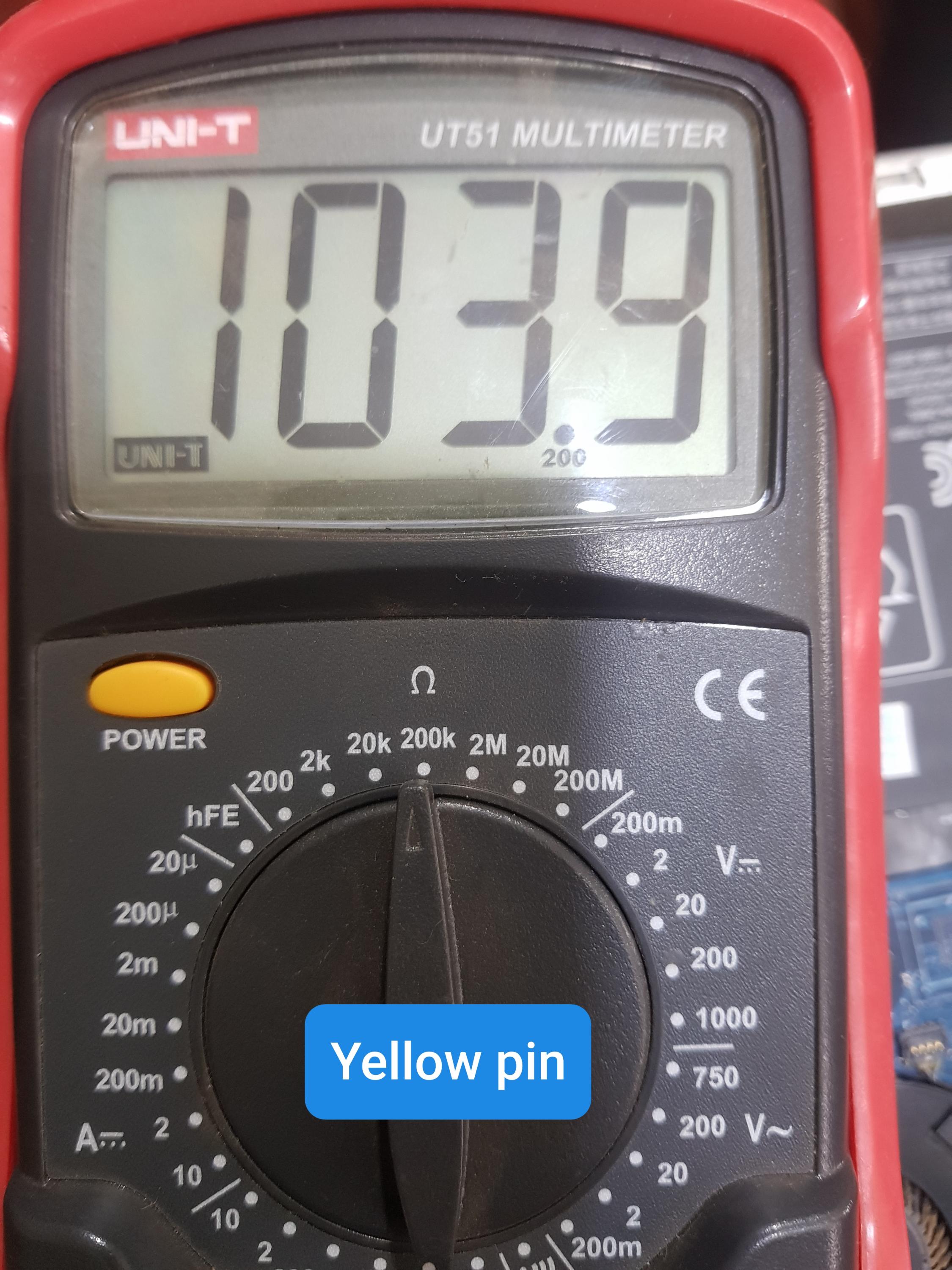

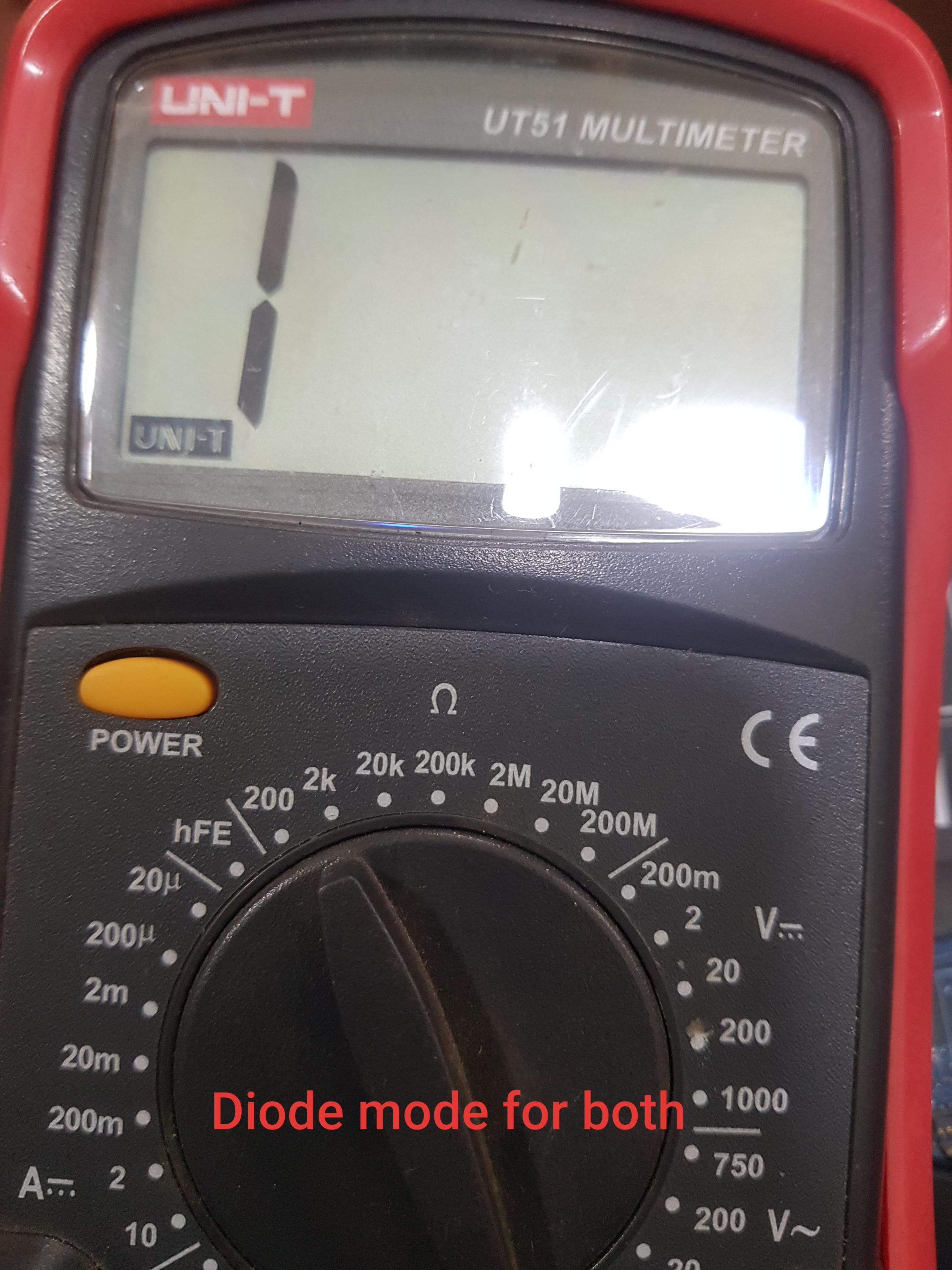

          Originally posted by mon2
          Remove all power. Remove the battery.
          Meter in resistance mode.
          Measure the resistance to ground of the contact pin that mates with the yellow wire on the battery. Do not attach the battery - just interested in the resistance to ground of the battery connector on the logic board.
          What is the resistance reading ?
          Then repeat for the GREY wire contact for a comparison.
          Also consider to test in DIODE mode. Meter in DIODE mode.
          Red meter probe to ground, yes RED probe.
          Black meter probe to the YELLOW wire contact on the logic board. What is the diode reading ?
          For comparison, repeat to test the GREY wire contact on the logic board. What is the diode reading ?
          Thanks mon2 and sorry for not replying early, it was night here so i left my workstation.
          Anyway I have done the measurements, I am not sure if they are correct, I have attached photo evidence in case there is something I need to change let me know.
          Resistance to ground for the Pin that mates with the yellow is 103.9k ohm
          Grey 1.9M Ohm
          In diode mode both have no readings the meter remains unchanged
