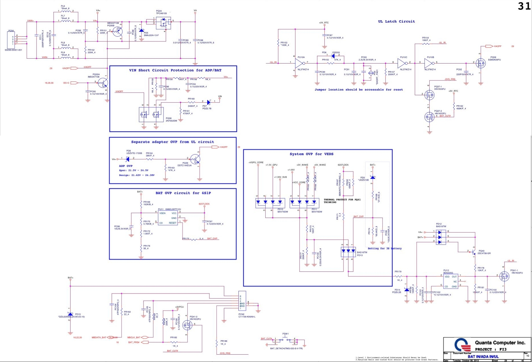

    I would like to repair this motherboard. Can you help me with this? I have little experience. Thanks!
    PQ34
    1-2-3: 19.5V
    4: 19.5V
    5: 0V

    Try this first:

      I tried. Not good.

        Re: Sony SVF15N DA0FI3MB8E0 no power on
        PQ34
        1-2-3: 19.5V
        4: 19.5V
        5: 0V
        I had the same problem...
        Check PQ35 if is not shorted and PR151, PR152 have 220k ohms.
        to PQ34 gate (4) should be presented ~10V, not 19.5V
          Remove PQ35 and check pin4 of PQ34 again. The problem is sony's classic protection
            Maybe someone has some ideas for this motherboard...
            I had the same exact problem, I changed PQ34 (because was shorted) and now the main power rail 19V is ok, LDO is presented, and the battery can be charged too.
            Then I plug the adapter it takes 0.004A(LDO, 3V and 5V are ok then, but only for a few seconds), after pressing the ON button 3V and 5V are presented again (Amps ups for a short time up to ~0.015A), and don't disappear, but no other power appears, like for CPU, RAM and etc, only LDO, 3V and 5V works. I don't found any more shorts. Anyone have some ideas?
