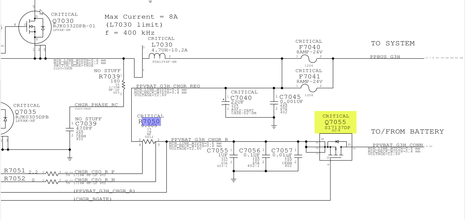

          Found shorted q7050. Fixed charging issue (above 0.5A) but hasn't changed a thing otherwise ;(

            Yes, agreed. What is Q7050? Do you mean R7050?

              Q7050 is pmosfet 'in front' of battery

                That is Q7055 in my schematic for 820-2915-B.

                  Re: A1286 820-2915-B CPU throttling
                  Yup, exactly this one. Was shorted drain-source. Replaced now.
