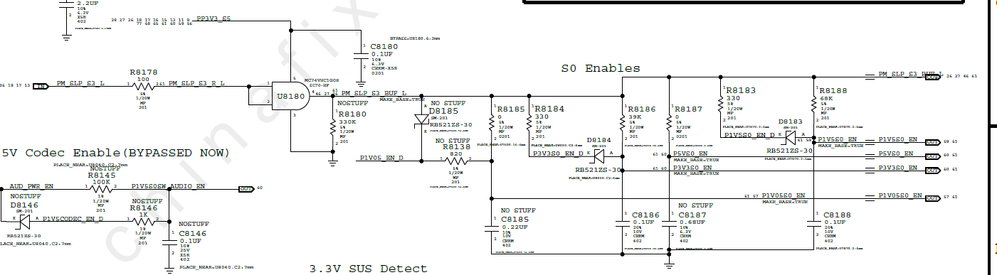

    Seems like all the main power rails are present but there're issues with the S0 1.05v enables.
    I took the following measures:
    P1V05S0_EN - 3.35V
    P3V3S0_EN - 3.3V
    P1V5S0_EN - 3.35V
    P5VSO_EN - 3.35V
    I'm don't know what could cause the higher voltages on the 1v lines.

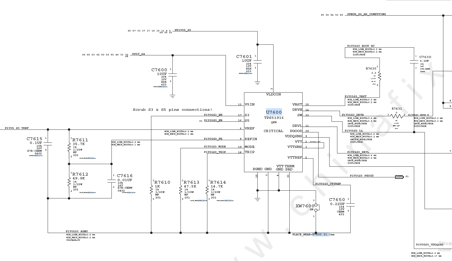

    The other area that I believe could be related and also have some weird values is the U7600
    Here's some readings:
    IN
    Pin - Name - voltage read
    12 - V5IN - 5.16v
    2 - PP1V05_S0 - 1.04V
    17 - P1V05_S3 - 0V
    16 - P1V05_S0 - 3.35V
    6 - VREF - 1.8V
    8 - REFIN -1.05V
    19 - MODE - 0V
    18 - TRIP - 0.16V
    OUT
    15 - VBST - 6.16V
    14 - DRVH - 1.36V
    13 - SW - 1.05V
    11 - DRVL - 3.5V
    20 - PGOOD - 3.35V
    9 - VFFQSNS - 1.05V
    5 - VTTREF - 0.52V

    So you have fan spin? Check voltages on L7630 and L7310. Be extremely careful probing around the +1.05V converter while it's on as that's a great way to kill a PCH. Logic levels for enables are supposed to be 3.3V BTW.
    If you are getting Vcore, then it's something beyond G3 to S0 state.

      checlk load switches they are tiny 8pin ball chip like glass top they are the cause.3.3_s5 to 3.3_s0 5v_s5 to S0 and so on for other voltages.

        Hi thanks for the input.
        Yes I do have fan spin and Vcore voltages.
        L7630 = 1.05v
        L7310 = 1.7v
        So if the enables are correct than I'm not sure what I could check next...
        The only "glass like 8 pin ball chip" I could find was u2940

          Re: MBP A1502 820_3476A S0 Enable issues (total beginner)
          He's referring to the switches on Pg60 of the schematic. Like U8030 for example (3.3V S0 switch). Often with these boards its some kind of shorted cap on switched power rail.
          I normally go through the output of each one and check resistance to ground (with power off of course). If you have fan spin, then it's easy to check the output of each one for voltage.
          A very close examination of the board under a microscope usually presents some kind of corrosion somewhere. It can be quite minor too. Had an insect die on top of a cap once on one of these boards, and the cap went short as a result.
