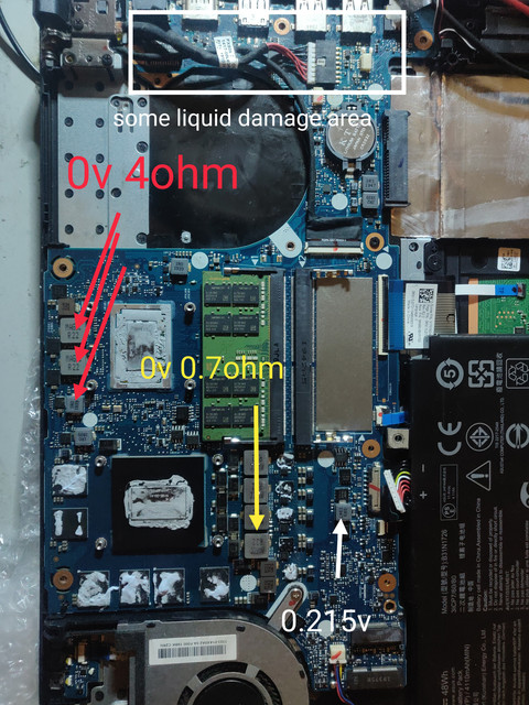

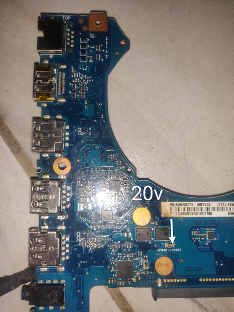

    Hi,i got FX505du,it charges battery but when power button is pressed it has no led,dead totally,i have checked and 20v is present near gpu caps,caps above cpu are shorted,it is ryzen 7 with 1660ti gpu.What to check next?

    Check at the coils whether any power rail comes up when you press the power button and share what voltages are present before/after pressing the power button. Maybe you can tale a picture of the board and write the values near the coils.

      https://ibb.co/x1kt0t4
      Hi,i cannot get powered it because power button is in keyboard,but i have tried and i get 20v like on picture,on the other side i have 3.3v near ITE chip,on keyboard connector is 5.2v but this signal goes to 35ohm short and again in circle...I have spotted some liquid spill near usb ports,i cleaned it but nothing....something is suspicious with 5v here...
      Gpu has 0.7ohm resistance on coil,CPU 4.2ohm...
      In the meantime i cleaned all usb ports,hdmi,even took those realtek chips,cleaned and soldered in place ,but no go...has somebody boardview cad,brd for this board ( FX505DU V2.0) ?

          If the power-button is inside of the keyboard, then find the corresponding pins. just needs some research and the knowledge howto use your multimeter. Also we can't do anything with the information where the 20V is present. If it is present at the current sense resistor, then it is present on the whole board.
          The only thing we now know is that the main power rail is present and the Embedded controller gets voltage. The other observations are random, have no relations and lack descriptions.
          Resistances of GPU and CPU Core rails are okay but you didn't shared any measurement from the coils, so what do you expect now?
          i can't do more than to ask for measurements, to hope for sharp eyes and a clear mind.

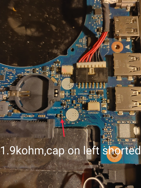

            I tried press on CON3104 pin 5+pin6 but all is the same,voltage on coils under cpu and above gpu are 0v,pin 5 is 3.3v,around ITE8987 i have 3.3,1.78,and 2.2v,those first two mosfets before current resistor r005 have 20v,only one coil 3R3 1947 under battery connector gets 0.215v,nothing gets hot on board..

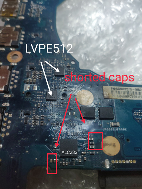

              and i found some shorted caps,and this is place where was liquid damage(burnt paper was by me,cleaning mosfet with hot air and flux)...

                Those 2 caps from left goes to pin 26(+5VS_AUDIO),and caps on right on pin 41(PVDD1) which is in loop with pin 46(PVDD2)...all on +5VS...

                  Is it safe to inject some voltage on + side of shorted cap,if yes how much volt,amp?Thanks

                    If you are sure about short, inject 1V/5A.

                      Well,i injected too much and resistor has blown,near cmos battery😮now no short on left two caps...

                            Alright, with the Injecting you have seperated the +5VS_AUDIO from +5VS by blowing up L3603. So yes, the short at +5VS_AUDIO obviously has disappeared although the Short at +5VS is still present.
                            Since I am a fan of constructive troubleshooting with _values_, I'd start with a good old resistance to GND measurement of +5VS to have something to start with. Ohms mode, range 200, without power.
