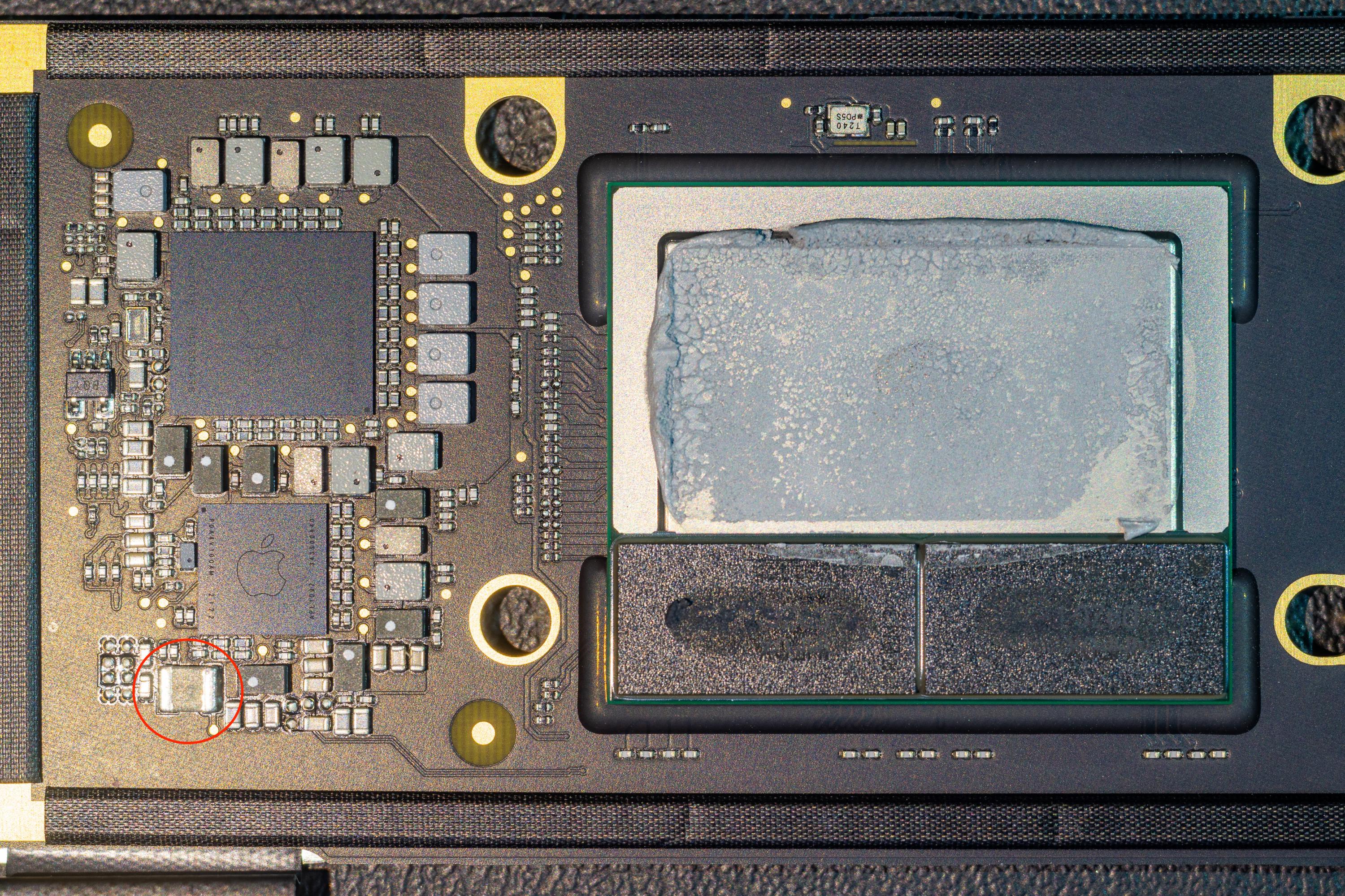

    After some further investigation I found that there is damage some damage on the logic board it self.
    I'm missing a couple capacitors (C8462 C8463) and ripped pads on the PPVDD_SOC_S1 rail.
    - Board 820-02016

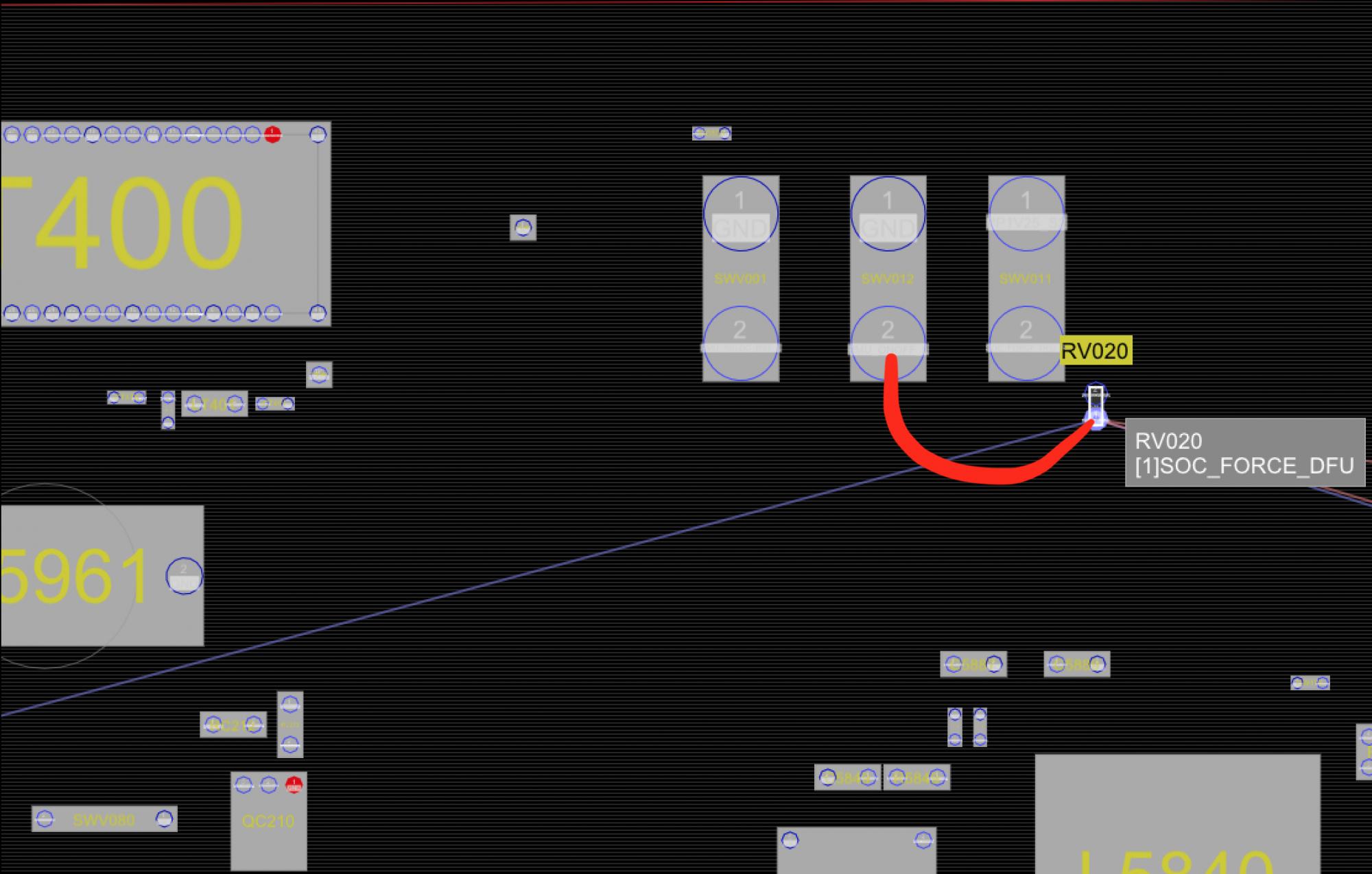

    I was able to find more info about forcing DFU.
    Not sure if I can share links here's so I'll just reference from Logi.Wiki
    "100% direct DFU mode using jumper
    * locate FORCE_DFU jumper. on some Macbook Air boards there is just a testpoint which needs a wire to connect it with 1.8V. This signal needs to be pulled up to 1.8v to activate FORCE_DFU
    * power-reset the device (unplug the battery, plug it back).
    * Pull FORCE_DFU to 1.8v line
    connect DFU cable to the device. It will both activate and autostart the macbook which will act as a proper "power button" trigger, switching the device straight into DFU.
    This results DFU mode in 10/10 cases unless there is something wrong with T2/Jumper/CD321*/Cable"
    For the A2337 there are just solder points so can be done with tweezers or soldering a jumper.

    I was able to enter DFU and revive the machine, now just waiting on the previous owner to create a Backup before full restore.
    I've also noticed that the iPhone 6 board has some of the 0201 missing caps so I should be able to grab from a dead board that I have.

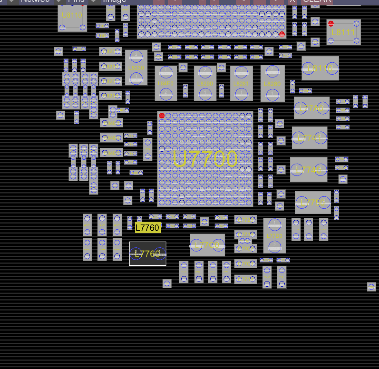

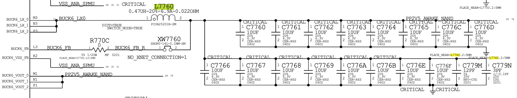

    However I still have more damage on the Logic Board on PP2V5_AWAKE_NAND.
    L7760 is damaged and I'm not able to find a replacement for this inductor (0.47UH-20%-6.9A-0.022OHM PIUA25201B-SM) so if anyone have information about a possible similar replacement or a donor from where I can grab I would appreciate.

      MBA A2337 820_02016 board working but missing components (beginner question)
      Hello, I have this M1 A2337 board here that I already did a post on:
      (https://www.badcaps.net/forum/showthread.php?t=116553)
      After I was able to force DFU and did a restore with Apple Configurator2, only today I got back from the previous owner who did the process to remove activation lock remotely, so I was finally able to activate and reinstall the OS.
      I put in another chassis and seems to be working fine (apart from the original issue with not being able to access startup options or DFU mode using the power button).
      But I'm still missing some components near the CPU area and I would like some help from more experienced people determining "how important" they are.

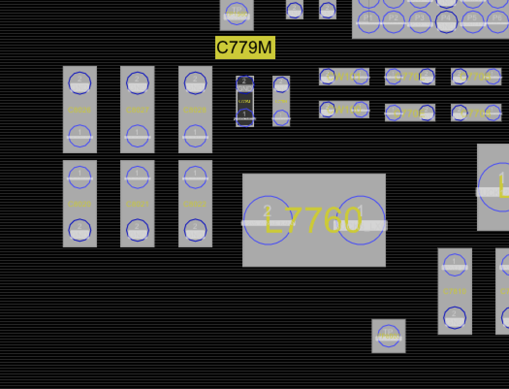

      The parts missing are from PP2V5_AWAKE_NAND
      L7760, C779M and C779N
Name:	Screen Shot 2023-03-24 at 18.04.38.png
Name:	Screen Shot 2023-03-24 at 18.05.02.png
      apart from that I'm still also missing two caps C8463, C8462 on PPVDD_SOC_S1
      For the caps would not be too hard to find replacements but I'm having trouble with that inductor. (maybe I'm just not searching correctly but with the data on the schematic I can't see to find anywhere)

        Reading the schematic, it seems like SOC_FORCE_DFU is pulled up to 1.25V via a 1kOhm resistor in the schematic/boardview (clipped to the imgur link below), rather than pulling straight to 1.8V... but I really don't know.
        imgur OZmQL9t
        The issue might be that I don't have a keyboard/screen/touchID/battery/IO board connected aside from a usb charger or DFU cable.
        Board boots fine straight to recovery after nand swap, but it doesn't see any volumes at all (idk if that's because I disconnected touchID, but at the bare minimum, the firmware needs to be updated since I swapped to kioxia nand)
        With the 1kohm up to 1.25V, the board just boots to recovery, and PPVBAT_AON_CONN is at 12V. With a deadshort from SOC_FORCE_DFU to PMU_ONOFF_L, the voltage drops from 1.8V to 1.4V, but I chickened out and disconnected USB-c power after I saw PPVBAT_AON_CONN go negative. (board still boots to recovery fine).
        It turns out I need a newer version of apple configurator 2 to detect m1 boards anyways though, so maybe SOC_FORCE_DFU shorting to PPVBAT_AON_CONN worked and I just didn't give it a chance?
        Thanks in advance. I'll grab my board and check for those components you are missing... though there are plenty not populated on my board too and the schematic does call out a bunch of things to not be connected/populated.
