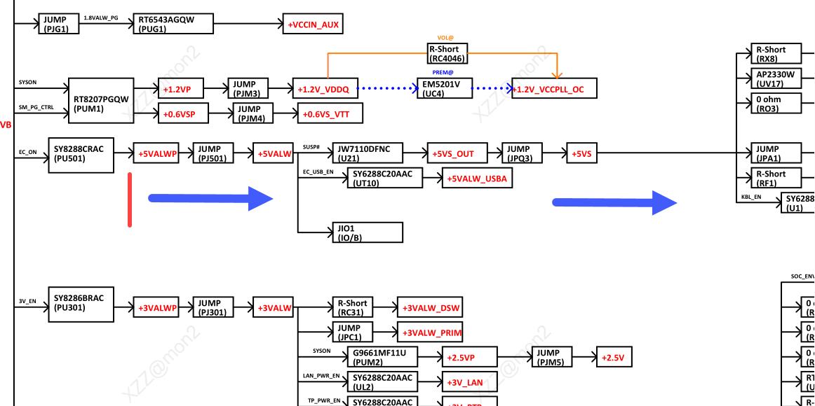

                        Hi guys, total noob here I have an Acer board in with “no power” issue. GH5JJ / GH7JJ LA-K701P Rev 1 C.
                        @ PRB3 I get 18v (7Mohms)
                        19v comes up to PCB8, PCB9, PCB10 but nothing goes into PQB5.
                        Side note:
                        PC501, PC506, PC503, PC504, PC505 all continuous with ground on both ends but the shorts are released when PU501 is removed.
                        PL502 is also continuous to ground on both ends (along with all the caps PC508 to PC513) even after PU501 is removed.
                        If anyone can offer me some guidance on where I can check next I'll be super grateful. How / where do I detect shorts?

                          See attached. This means everyone to the RIGHT side of this PU501 is a suspect.
                          I would start with checking the USB connectors since VBUS is used to power the USB devices. The local load switch often fails.
                          Remove all power. Meter in resistance mode. What is the exact resistance to ground of +5VALW_USBA? If the resistance is ok and not a short, move onto reviewing JPQ3. Remove this short / solder blob.
                          Is the short condition now gone?

                            I checked @ UT10 the resistance is 2.2 Ohms. Is that a short?
                            • mon2
                              • Dec 2019
                              • 14662
                              #34
                              100% a short. Flux and remove this part. Then test if the short is gone or not.

                                Removed...... still shorts. PL502 is also continuous to ground on both ends (along with all the caps PC508 to PC513)

                                  Remove the solder blob @ PJ501. This will isolate the 2 sides of this shorted rail. Then measure each side of the removed solder blob.
                                  Which side is still shorted?
                                  • EpicFix
                                    • Aug 2024

                                    PJ501 removed. Shorts gone from PL502 and the surrounding caps (PC508 to PC513). Resistance @ UT10 now 7.8 Ohms @ PIN 5, 13 MOhms @ PIN 1 (both readings done with the component removed). I checked the component off-board PINS 1,2 and 5 are continuous. The pads on the board for UT10 (PIN 2 and PIN 5) are continuous between themselves and also to ground. Is that still shorted? Where do I go next?
