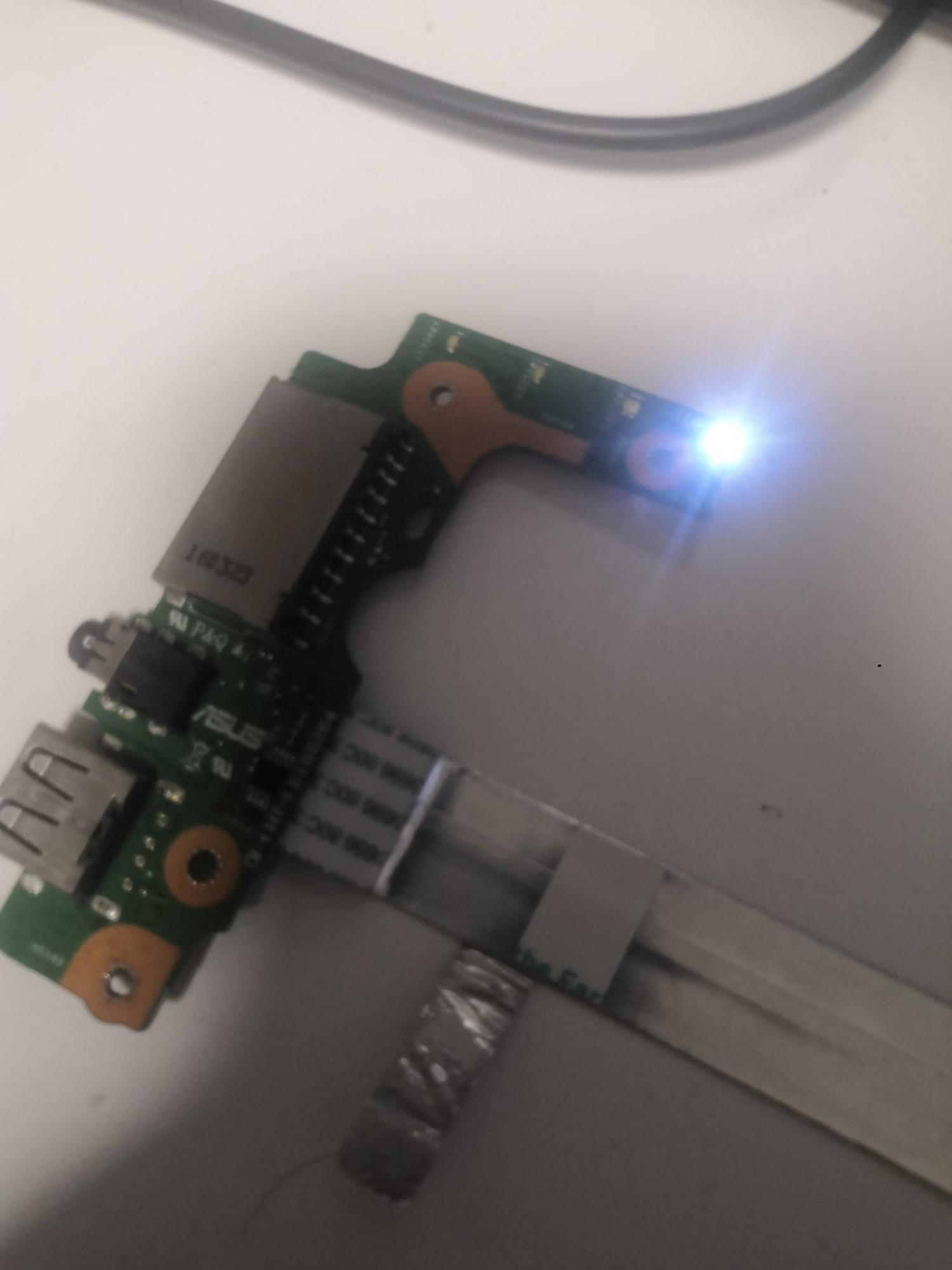

    Hi im Monster.
    I have an X556UJ motherboard, which doesn't turn on but the power led stays on all the time as soon as I connect the charger.
    I have the boardview, I have analyzed all the voltages of the it8995e, all are correct (i mean, the most important for wake up the pc) except the RsmRst 0v and the PWRBTN 2.4v.
    I have injected 3.3v into the rsmrst and the led turned off momentarily but nothing else.
    Also check other threads where they say to inject 3v to +3VADSWO to see if the pch gets hot but that line already has 3v.
    Bios voltage pin 1 = 3,2v | 2 = 3,2v | 3 = 3,2v | 4=0v | 5 = 0v| 6= 0v | 7 =3,2v | 8 = 3,2v
    On the photo can see that power light is always on, i dont knw why. Maybe Ec damaged? or pch?
    what else can i check? Also i want to know where the RSMRST is from.
    Sry if i dont know so much im learing

      RSMRST# is generated by SIO and its a wake up call for PCH. When RSMRST# is released by EC and goes to PCH, then PCH in turn will release SLP_SX signal. What is the resistance on RSMRST#? It must be atleast 10K or higher. PM_BATLOW# status??

        Resisitence 10k aprox some times 9.9k and others 10k so its working properly.
        The BATLOW is high 3.2v aprox, so is active i guess.

            Yes, nothing wrong here.

              Today i recived my CH341A, but my bios chip mx25L6473E isnt detected, detect mx26L6405D, how i can download the correct or change it?

                Re: Motherboard asus x556uj maybe dead
                bios chip was empty, i searched how read and erase.
                  it was the bios thx for help me im happy
