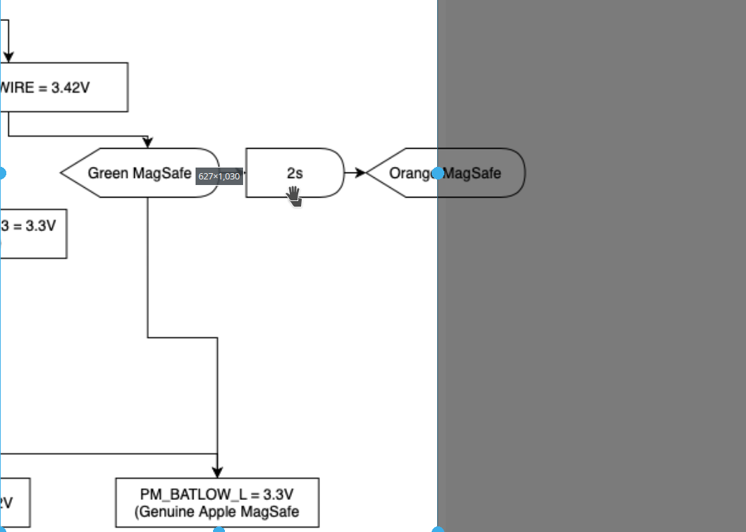

      Good. Follow this flow chart:
      https://logi.wiki/index.php/G3_to_S3..._and_Broadwell

        #43
        Does that mean, it needs to stay green before moving forward?
        here it shows green then 2 seconds orange in that flow chart.

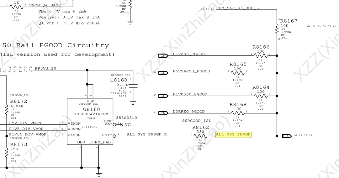

          There is a lot going for the magsafe led turning green (first) and then switching to orange. This led color change is handled by a 1-wire communication protocol created by Dallas Semiconductor / Maxim and now owned by Analog (believe this is the order of acquisitions). That is, the SMC is performing these duties by sending out very time sensitive signals of high / low to toggle the LED. The orange color denotes the battery is low or missing - another good sign.
          Does the green led turn OFF and then power cycle repeats? The flow chart is gold to follow. If you are power cycling, suggest to remove all power -> meter in resistance mode -> measure the resistance to ground of each and every inductor (grey in color usually). If the resistance is low -> check if the power rail that is linked to this inductor is a low voltage rail or not. If it is a low voltage rail then expect a low resistance on that rail - by design.
          However, if the resistance is low and the rail is something like 3v3 then there is a shorted part on that rail. The current sense loop on that power rail is sensing this excessive current draw and powering down the local power rail, hence your power cycle loop. We have seen many A1466 logic boards with this fault due to shorted tantalum caps. Keep in mind that this macbook is relatively old so capacitors will age (some more than others). Tantalum caps which are polarized (+ and -), just short when they die. They are crap IMO. This is the #1 reason we do not use them at all in our product designs. We have products running 7-10 years 24/7 and still kicking. Japan banned their use ages ago. We prefer ceramic caps which are not totally innocent but less prone to this serious fault. A $0.50 USD part can kill a macbook or make it look like it is dead.
          Confirm again that the led remains ON (does not matter if green or orange). If you have power cycling then the hunt is on for a shorted part. What is the voltage to ground of ALL_SYS_PWRGD ? This signal must be a stable 3v3 to denote that all power rails on the board are stable.
          Another review should be on the SMBUS lines (SCL / SDA) that are used from the SMC to the ISL chip that creates the boosted voltage for PPBUS_G3H. If either of these lines is defective, the ISL will not be boosted.
          Click image for larger version  Name:	ALL_SYS_PWRGD.png Views:	0 Size:	120.0 KB ID:	3227181
