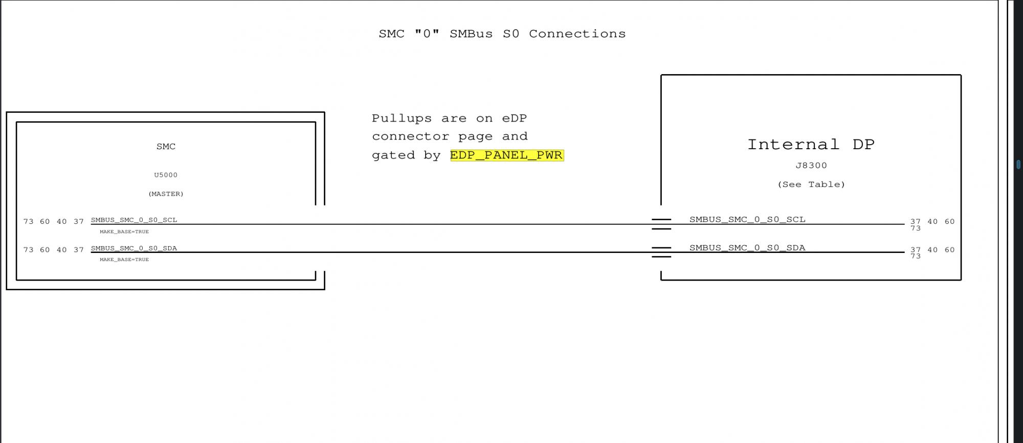

    SMBUS is an open collector design. Locate the pull-up resistors on each line. Confirm the pull-up voltage to ground for each resistor. If the pull-up voltage is missing, SMBUS will not function correctly.
    Also, remove all power, meter in resistance mode.
    Check the resistance to ground of:
    SMBUS_SMC_0_S0_SDA
    SMBUS_SMC_0_S0_SCL
    Post each measurement.
    • bargo
      • Aug 2022
      • 46
      Re: Macbook air 820-00165-A fixing
      Thanks a lot mon2, I appreciate your help..
      SMBUS_SMC_0_S0_SDA: is at 70k ohm with 2.6v on diode mode
      SMBUS_SMC_0_S0_SCL: is at 73k ohm with 2.65v on diode mode
      I believe both of them are being pulled up to PP3V3_S0SW_LCD which I can't find where are they being pulled up from, but I may be wrong, I thought these are being generated from the SMC internal circuit. I may have seen designs where the I2C is being generated internally
      The only logical explanation would be a missing touch point between the SMC and the PCB, but both balls are being missed is quite strange thus I dont think its an SMC issue, but still it could be.. On a working logic board it would be great to know if the SMBUS_SMC_0_S0_SCL gets pulled up at the same time as SMBUS_SMC_1_S0_SCL? because my SMBUS_SMC_1_S0_SCL is being pulled up to 3.3v just fine, I think there is some activity also on the SDA line SMBUS_SMC_1_S0_SDA.
      Again my measurements, apparently the capacitors were not fully discharged on my first readings:
      SMBUS_SMC_0_S0_SDA: is at 27k ohm with 2.6v on diode mode
      SMBUS_SMC_0_S0_SCL: is at 27k ohm with 2.6v on diode mode
      SMBUS_SMC_1_S0_SDA: is at 8k ohm with 0.96v on diode mode
      SMBUS_SMC_1_S0_SCL: is at 8k ohm with 0.96v on diode mode
      I can see difference here, its high resistance on SMBUS_SMC_0_S0_SDA/SCL which means something is broken, and the only place it goes to is the SMC, right?

            The SMC is the bus master so it initiates the smbus traffic.
            What is the voltage to ground of PP3V3_S0SW_LCD?
            This is the pull-up voltage source for this bus pair of lines. See R8363 and R8364.
            Also since your power good status is low means that at least one power rail is not valid.

              PP3V3_S0SW_LCD is at 0v same as SMBUS_SMC_0_S0_SDA/SCL
              I actually asked earlier
              PP3V3_S0SW_LCD do you know what is the source of voltage for this rail? I can't find it, its connected to the L8304 but going to PP3V3_S0SW_LCD_UF which goes to J8300, so does it take power from the display!! or what is the source of it?
              if it takes it from display, then that explains it, as the EDP_BKLT_EN is low at 0v so the main screen power is not present to the LCD so it can not give power to the SMBUs anyway, but if the source of power is not the display, what is it ?

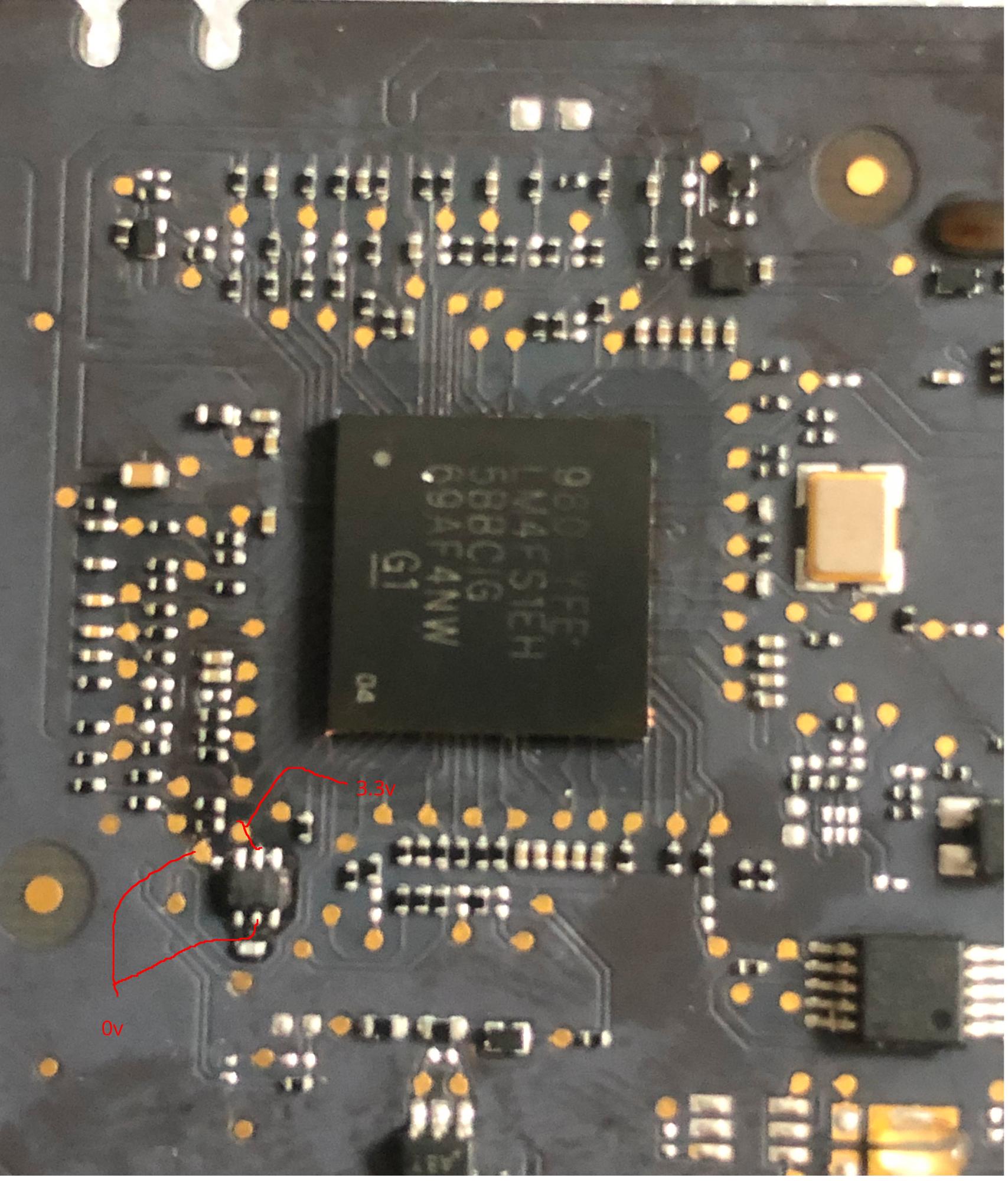

                  Ok I think I need to know a little bit more information, the SPI communication from CPU to BIOS is happening, and its reading some stuff, at first, then after few ms it acknowledges or say something else, now, that means bios is being read and CPU should know what to do as well as SMC, now the SMC part is a bit tricky, I have not yet understood correctly, but I think there is a separate rom that resides in SMC, which basically explains why it also has these lines connected to it.. if SMC has its own ROM could it be that it has the wrong ROM in my case? I'm no expert.
                  attaching SMC picture, I will try to plug my self into it, and see what I can get it.

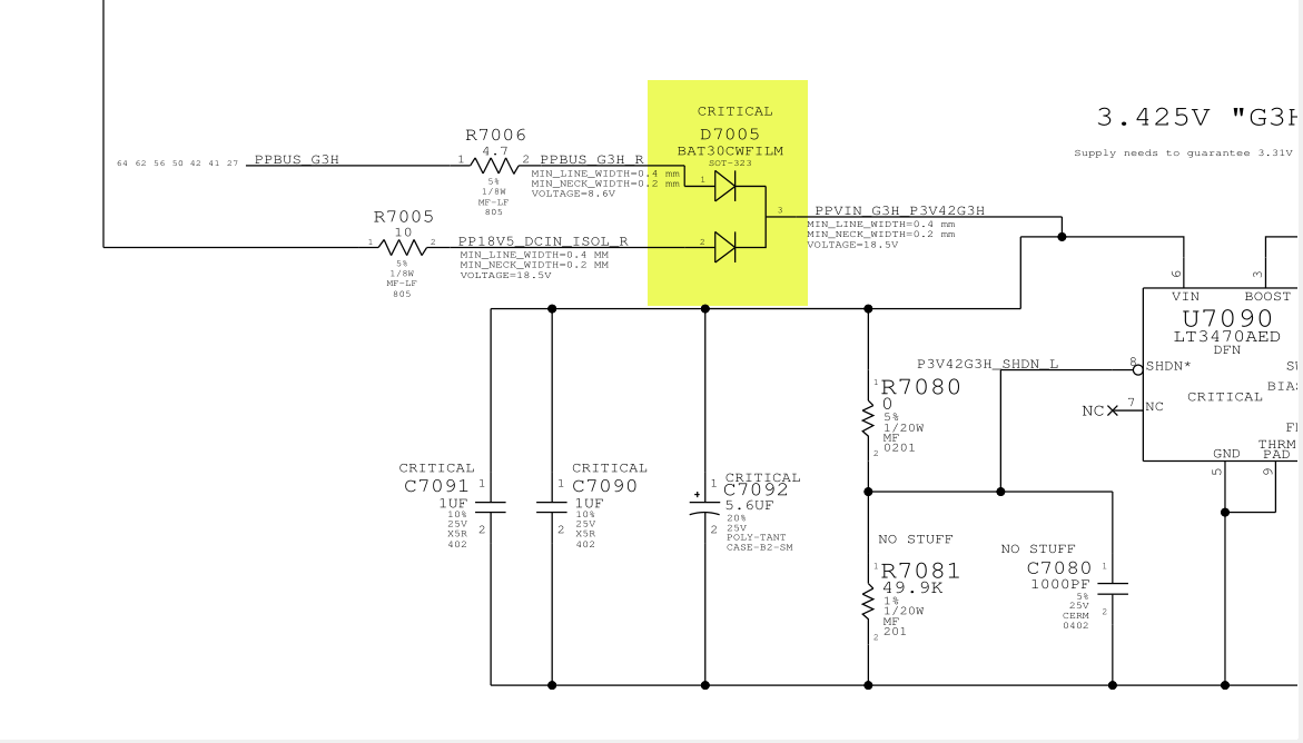

                    Can you confirm you are using the original and official power adapter? What is the color of the led inside the magsafe head?
                    What is the voltage to ground of ppbus_g3h?
                    • bargo
                      • Aug 2022
                      • 46
                      Yes, I can confirm original macbook adapter, the 85w variant. (so not the official, the official is 65w) but that should not matter I assume
                      The magSafe color is green at the first second then turns to orange
                      Voltage at ppbus_g3h is static at 8.55v
                        More power is ok. Except when the 7 million dollar man was a guest on the six million dollar man show. 'The power Steve...'
                        Is the ppbus_g3h the same on both sides of the fuse? Do not have the schematic open but may be F7000 or F7040.

                          Ok i actually think there is a problem with the charger, its says output is 20v which i assume is not actually the correct input voltage for this poor logic board, I think the correct output should be 14.5v or I'm maybe wrong. I already check voltage on the fuse, its equal 0 ohm between end points. Do you know what should be the official charger output for this variant?
                          • mon2
                            • Dec 2019
                            • 14317
                            To me, the adapter voltage seems high. Would you have another magsafe adapter for testing ?

                              Thanks mon2, I checked D7005 and pin 1 is at 8.6v pin 2 and 3 are at ~17v , I'm still using the same charger, I currently don't have another charger, but soon I will.

                                  Just to summarize, at this state, I currently have no power rails missing, what I have is digital signals missing, these are as far as I know:
                                  - SMC_S4_WAKESRC_EN (A must check)
                                  - SMC_THRMTRIP
                                  - SMC_SYS_KBDLED (when the keyboard led lights jack is connected tested with two keyboards)
                                  - EDP_BKLT_EN (when the LCD jack is connected tested with two screens)
                                  SMC seems to be doing most of its job but not the complete job, digitally speaking. So I don't want to put it a suspect while it is, the EDP_BKLT_EN comes from CPU, I dont want to put that as a suspect too because its doing what it should be doing as far as I can see.. But of course I don't see it all.

                                      btw i could not find the SMC_S4_WAKESRC_EN listed for any boot sequence requirements so far, I think this signal should be one of the signals to check if you are in S0 or not.. it also says SMC, its becoming more of a suspect at this stage
                                      I think SMC_S4_WAKESRC_EN is not needed, It actually has no reason as the u8170 is no stuff, thus I am on S0 state at the moment, with all power rails apparently, as well a valid 3.3v all_sys_pgood
                                      I think the SMC that was planted on this board is not the correct version, I would be looking for a LM4FSXAH5BB and what I have attached in the previous picture is LM4FSXEH5BB so the letter A and E differs, could that be flashed or I need to get LM4FSXAH5BB? or it should not matter, I think it should matter a lot!!
