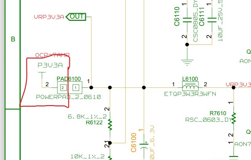

HP 8470p 3V short to ground
  • motanya
    • Nov 2021
    • 160
    • Kenya
    Does anyone have a clue on how to solve HP EliteBook 8470p that shorts to ground at powerpad PAD6100 I have tried to find where the short might be originating from cant be able to figure it out?

    Re: HP 8470p 3V short to ground
    1V voltage injection and thermal camera is the quickest way.
    • kalilinux25
      • Mar 2018
      • 2089
      • ZAMBOANGA SIBUGAY
      check resistance to gnd of pin 8 of bios chip
