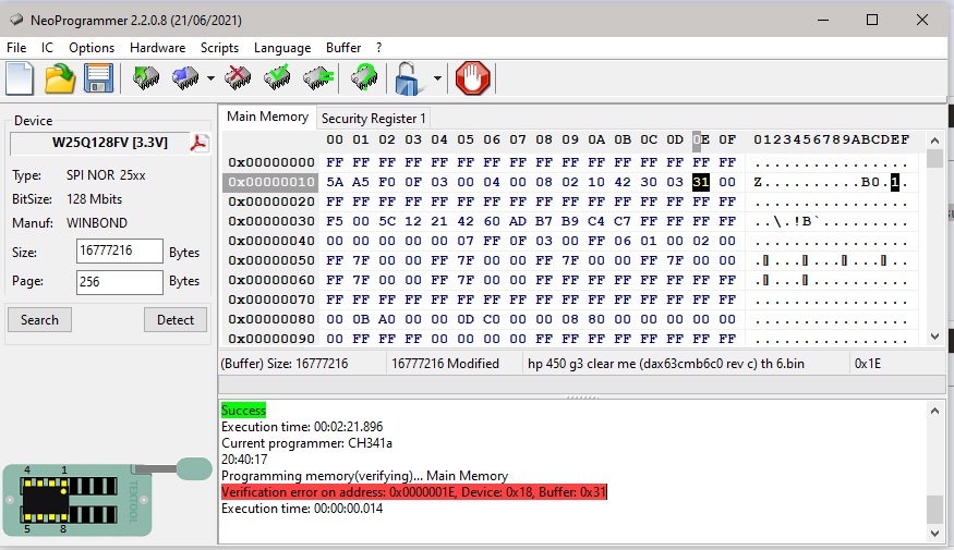

            Re: HP Probook 430 G3 wont turn on
            So when i try and reflash the original bios back i get the following.
            "Verification error on address: 0x00001100, Device: 0xFF, Buffer: 0x26"
              Tried a new version of NeoProgrammer and get this verification error.
              Verification error on address: 0x00000EFC, Device: 0xFF, Buffer: 0xDF
              • mon2
                • Dec 2019
                • 14564
                Continue to verify only the contents with this flash device.
                Do you have the same location fault everytime?
                Are your programmer tools stable? Can you slow down the read/wrote speed in your software? Being spi flash, it should be possible. Use a slower clock in the setup. This may be the true issue.
                Otherwise, to me, the flash device is defective and should be replaced.

                  • reformatt
                    • Feb 2020
                    • 1446
                    CH341 there are many clones and knock offs. Check the data line voltage levels, apparently on some these run at 5V rather than 3.3V and result in these errors.
                    I'd still be checking your power switch with a meter.
                            Turns out the Programmer was the issue. ive bought a new one and was able to flash the bios again successfully however the fault still remains. all u get is an orange light when charger is attached and no sign of life when i pish the power button.

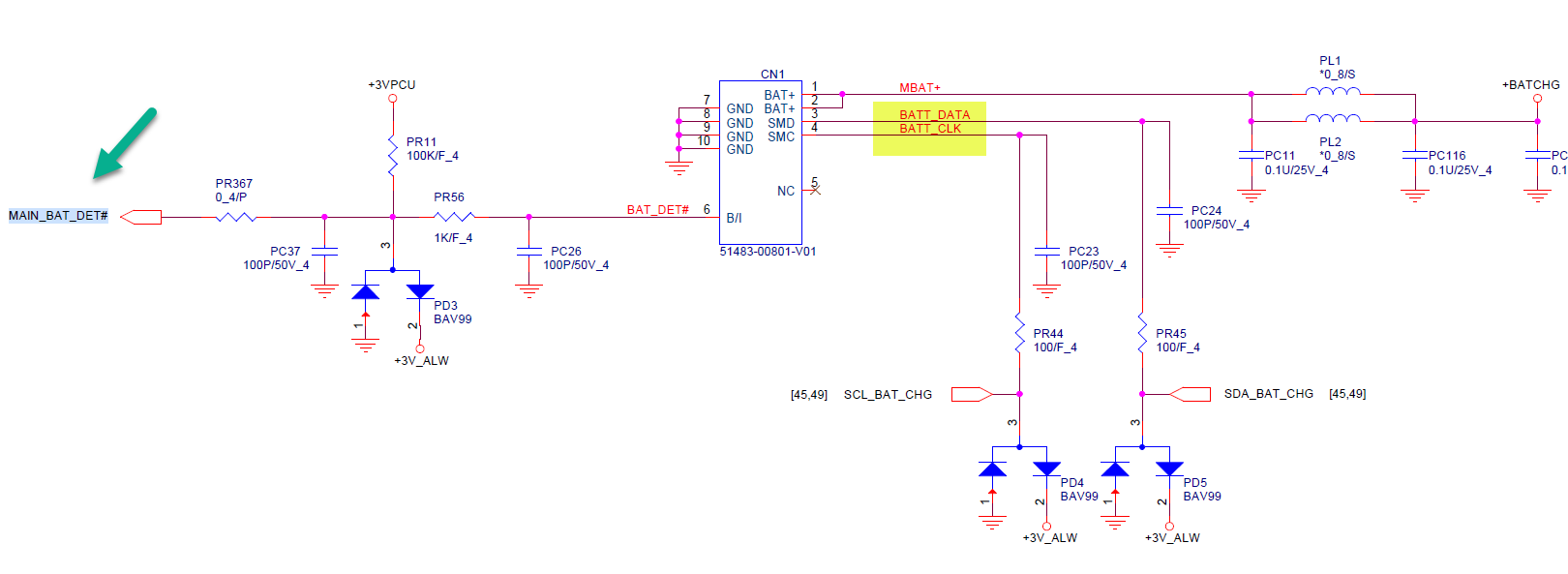

                              1) be sure your bios is correct to use for this logic board.
                              2) post or link the schematic for this logic board.
                              3) review the DCin mosfets and power adapter detect circuit. The charger IC details are of interest.
                              Which one is onboard? BQ series?
                              • roxboy1984
                                Thanks i shall do the above and post back. Not sure if this is relevant but the amber light is there regardless of whether the battery is installed or not.
                                I tried multiple bios's.
                                here is a link to the Schematics. https://www.badcaps.net/forum/attach...8&d=1538122191
                                  Check the voltage to ground of BQBATPRES pin # 15 of the BQ charger IC. This pin senses if the battery is present or not.
                                  The netname for this signal to the battery is MAIN_BAT_DET#. Interested in the voltage to ground here.
                                  Also - see attached.
                                  Other points to measure are the voltage readings of the SMBUS pins on the battery pack = SMD / SMC (names from their schematic).
                                  Each must be ~3 volts else the TVS ESD diodes may be shorted and causing a communication fault of the SMBUS lines.
                                  Update: REMOVE the battery and check the pin #15 voltage to ground. Without the battery, this pin must be ~3 volts.
