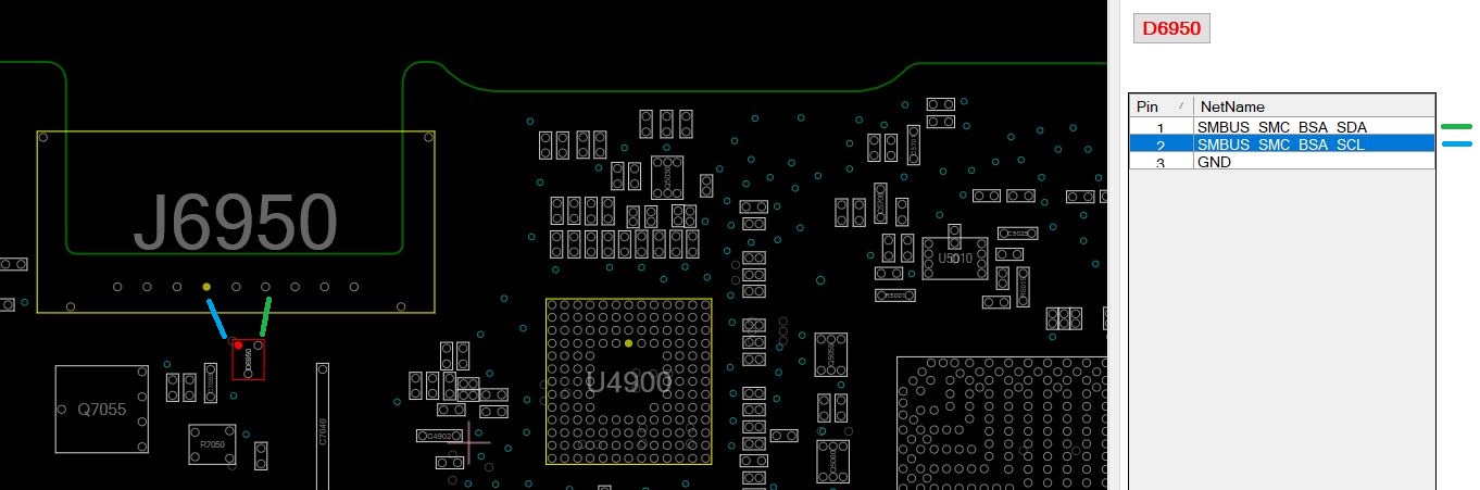

    Review the battery connector.
    On this connector are 2 pins with the SMBUS interface. One is SCL and the other is SDA.
    Measure the voltage to ground of each of these pins. Red meter probe to SCL, black meter probe to ground.
    What is the measurement?
    Repeat for the SDA pin.

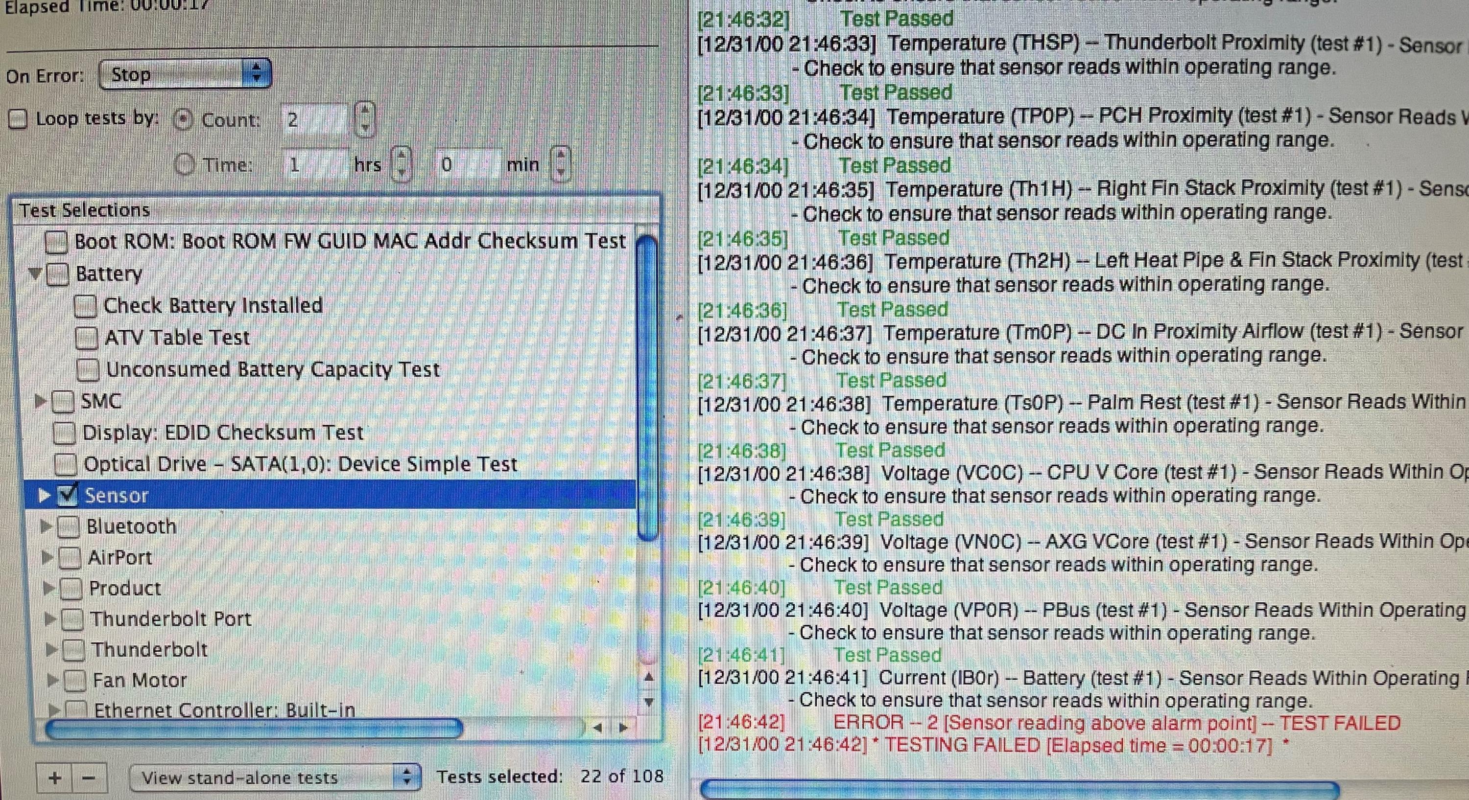

        From Louis' slides:
        I fixed it and they say it runs slow
        ● Running slow is often due to a sensor issue.
        ● Not slow as in slow hard drive, I mean slow as in the mouse
        stutters as it moves across the screen with no activity.
        ● The SMC likes to sense voltage levels, current usage, and
        temperatures from various different parts of the machine.
        ● If it receives information that is out of whack, it will turn the
        machine off, or make it run very slow as a means to protect
        itself from damage.
        Run ASD to tell you what sensor is failing
        ● You will have to venture forth onto the internet to find ASD.
        ● There are different ASD for every model machine from every
        year.
        ● ASD will tell you what sensor is failing, and then it is your job
        to check the schematic and see what's going on.

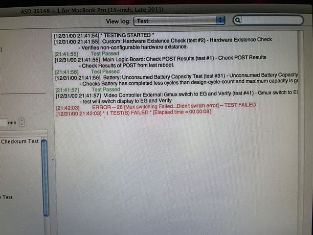

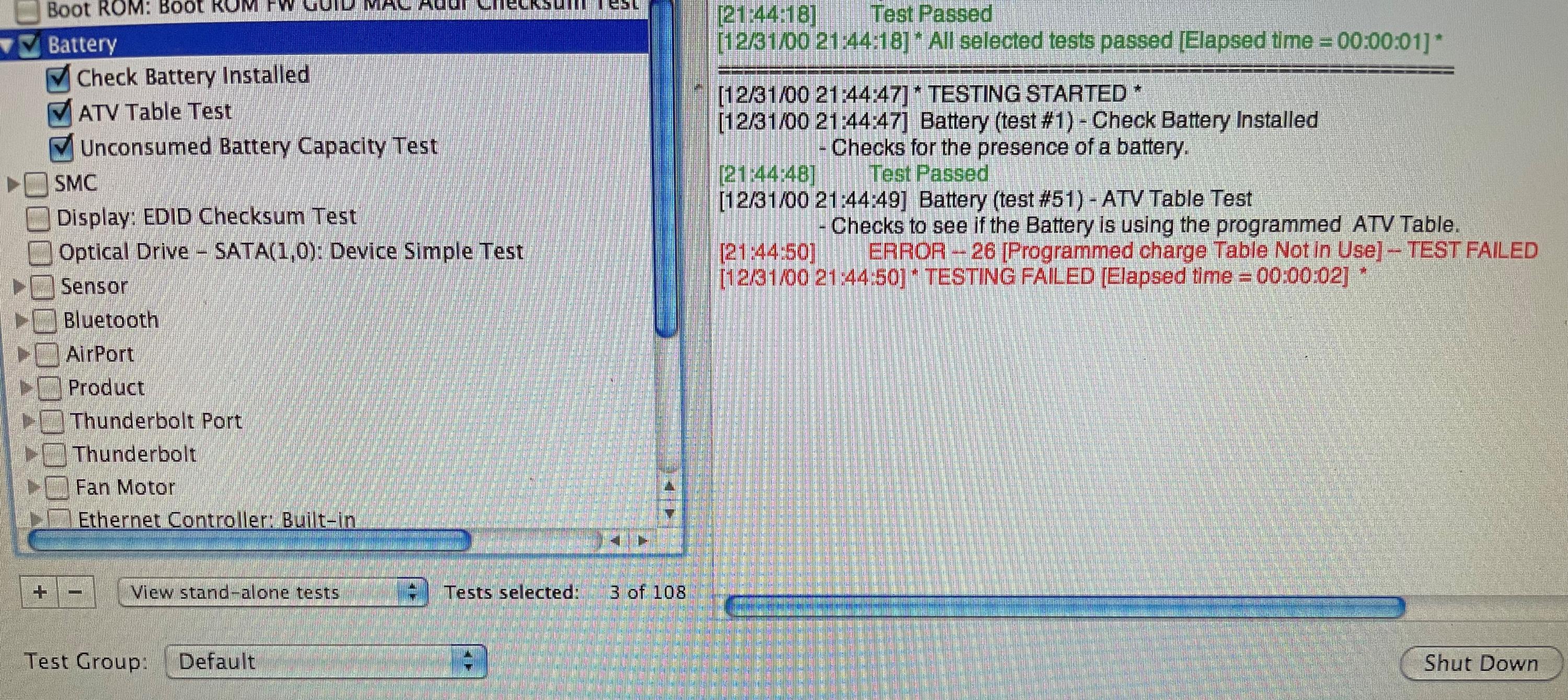

              here the tests with battery connected:
              EFI mode
              OS mode

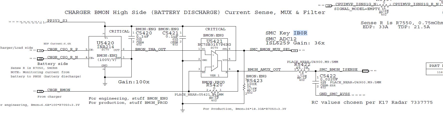

                I recovered the boardview and the schematic, I found the area related to the IB0r sensor.
                But now I don't understand why the integrated U5420, U5421, C5420, C5421 and R5423 are not physically soldered?

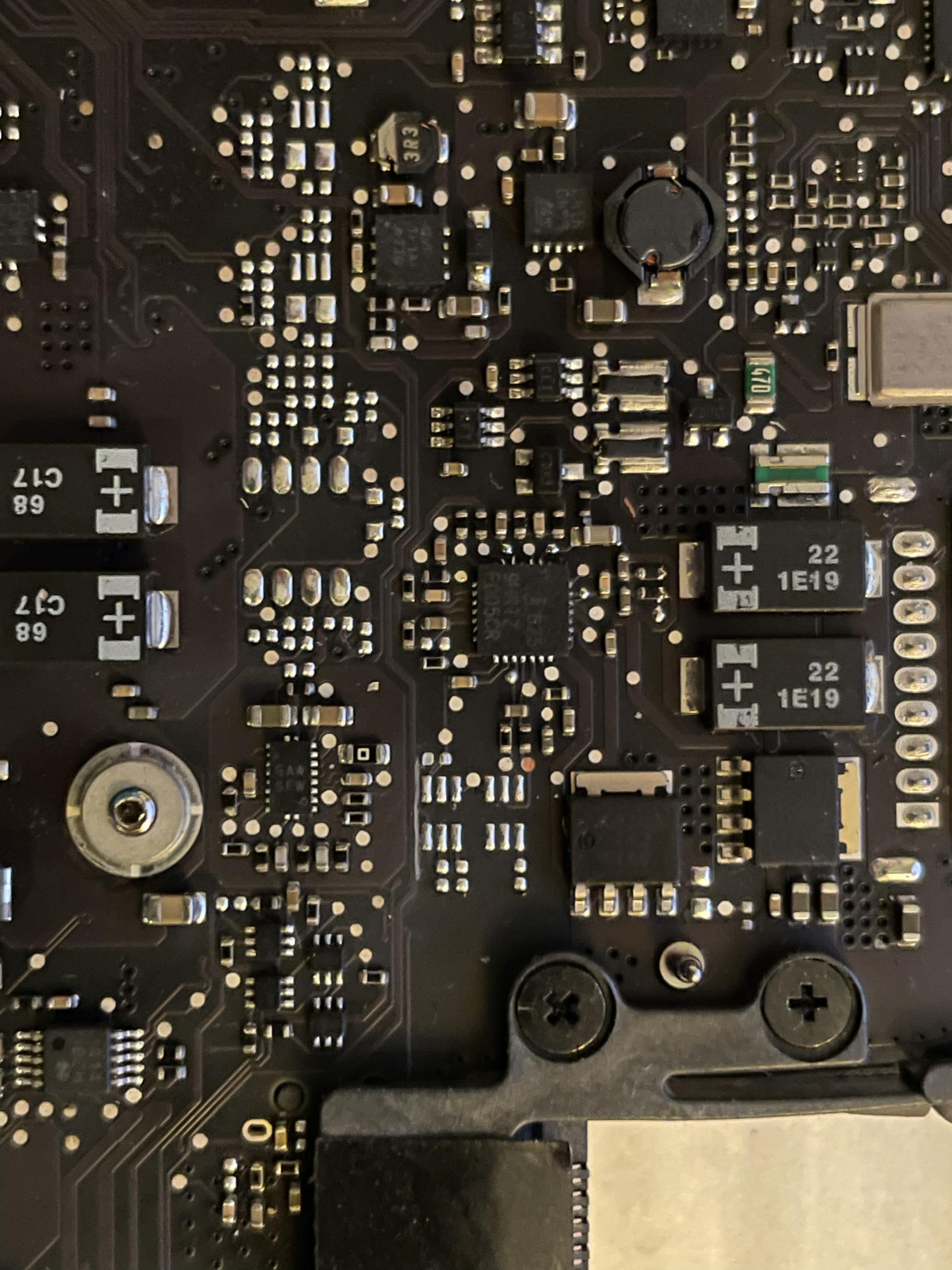

                    I solved the problem related to the IB0r sensor, there were three resistors to replace.

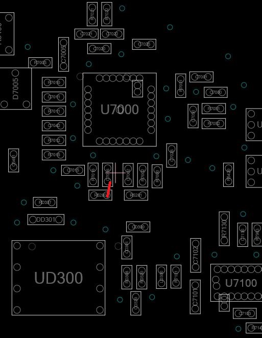

                    Now, however, I am left with the problem of very slow battery charging and I made a mistake when checking the voltages on the board.
                    I probably accidentally touched this capacitor (C7016) with this resistor (R5280) with the test lead.
                    From that moment the card doesn't turn on anymore and the power supply has a weak green light.
                    U7000 is very hot. Do you think it should be replaced?

                      Yes, U7000 is likely damaged and will have to be replaced.
                      The magsafe head led is driven by the 3v42 rail on macbooks. Do not have the schematic open but search for it and confirm this power rail. Likely the same on this model.
                      What is the voltage to ground of this key power rail?

                          I replaced U7000 and now the green led lights up.
                          The fans, however, do not turn by connecting the power supply (I mean motherboard only + fan), while before breaking the integrated U7000 they turned by themselves.
                          It's normal?

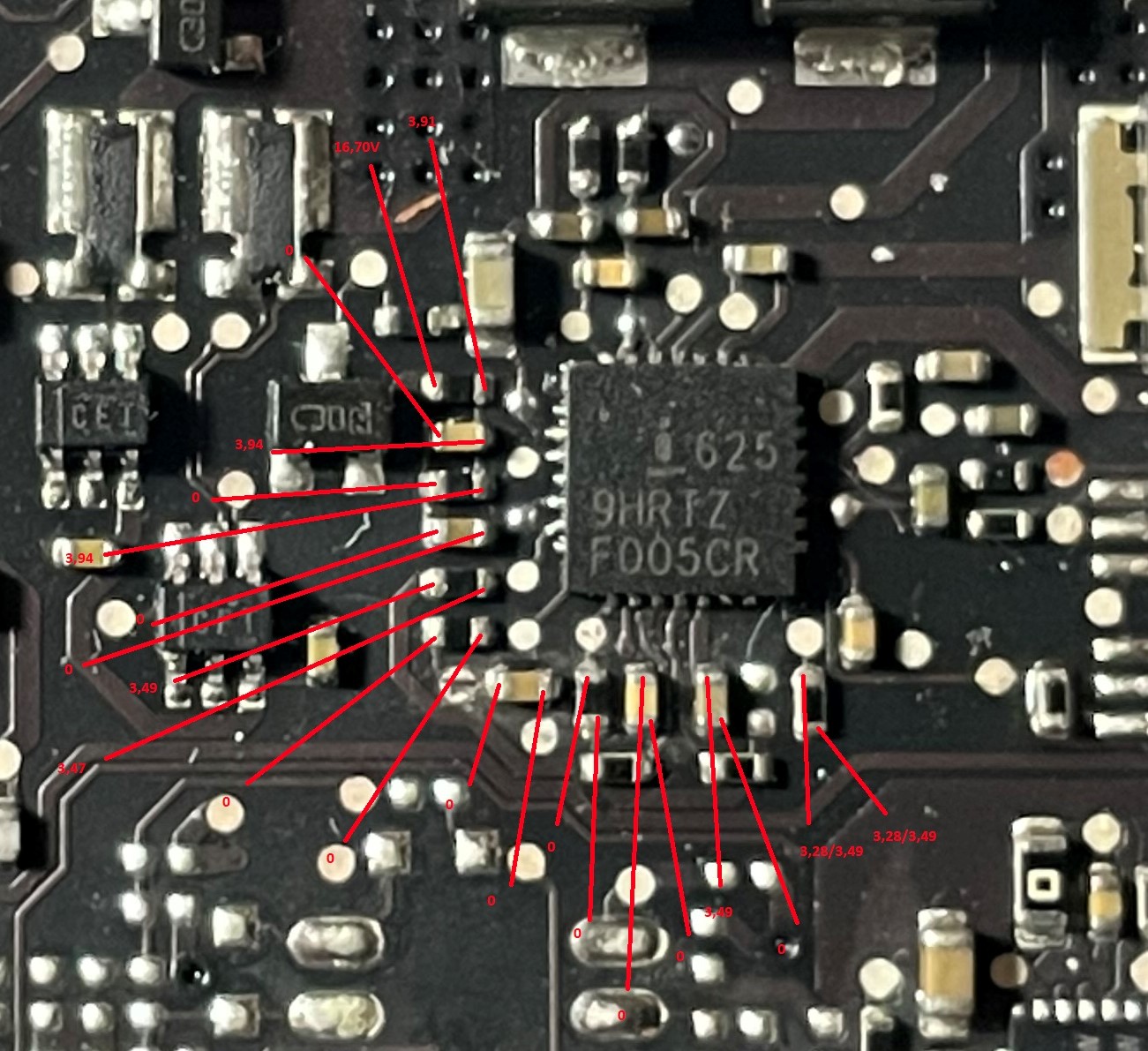

                            UPDATE: I tried to mount the motherboard and also connect the battery. In this way the green light is weak, the mac turns on anyway because it feels the battery and in the battery logo there is also lightning but it doesn't charge, I can also unplug the cable and the lightning still remains.
                            What can it be? Did I solder the U7000 badly?
                            UPDATE 2: I disassembly the motherboard and the green light came back to normal (just motherboard and fans but not spin)
                            some misuraments near U7000:
                            • mon2
                              • Dec 2019
                              • 14685
                              Re: Macbook pro 15" 2011 A1286 stuttering and slow
                              Measure the voltage to ground of the SMBUS lines on the battery connector.
                              We need to know if they are working properly. They should be ~3v4 each if ok.
                                SMBUS_PCH_CLK 0\0,30v
                                SMBUS_PCH_DATA 0
                                SMBUS_PCH_DATA 0
                                SMBUS_SMC_0_S0_SDA 0
                                SMBUS_SMC_A_S3_SCL 0,01v
                                SMBUS_SMC_A_S3_SDA 0,01
                                SMBUS_SMC_B_S0_SCL 0,02v
                                SMBUS_SMC_B_S0_SDA 0,02v
                                SMBUS_SMC_BSA_SCL 2,95/3,45v
                                SMBUS_SMC_BSA_SDA 3,00/3,45v
                                SMBUS_SMC_MGMT_SCL 0
                                SMBUS_SMC_MGMT_SDA 0

                                  I repeat the measurements on the connector:
                                  SMBUS_SMC_BSA_SCL 3,31 \ 3,49v
                                  SMBUS_SMC_BSA_SDA 3,33 \ 3,49v
                                  • mon2
