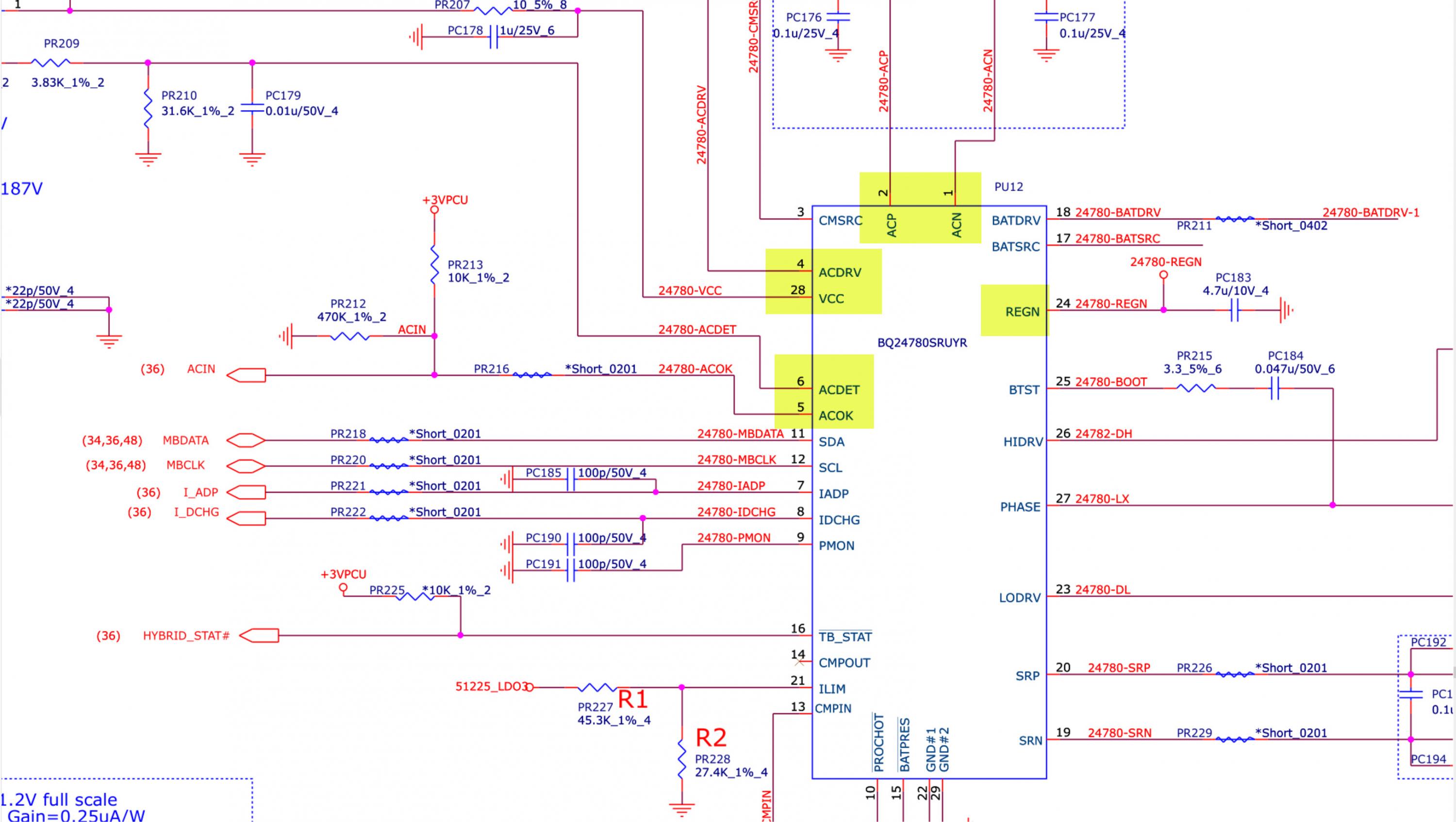

    Hello I am contacting you because I have a tuf506l laptop which does not start just the keyboard and the power light which lights up for 1 second then nothing. I did not find a short circuit on the main rails. The battery charges well. I have already flashed the bios but no change. I also tried other rams even without any change either.Thank you in advance for your help .

    Start with the charger IC review.
    Remove all power. Check the resistance to ground of the main power rail @ pin # 1 (ACN) of the BQ charger IC.
    What is the reading ?
    Assuming there is no short / low resistance, power up:
    Same pin - this is the main power rail and should be ~19 volts (steady).
    Also review the other highlighted pins as per attachment.

      here are the measurements on the BA charge
      1 on gnd = OL
      1=20.2v
      2=20.2v
      4=26.1v
      5=3.2v
      6=2.7v
      24=18.2v
      28=19.3v

        Can you check the voltage to ground on pin #24 (REGN) again?
        It should be ~6 volts.

          Sorry 24=6.04v

            the computer boots now i don't know the reason but it gets very hot at the gpu power rail. if I take charge, it heats up much more and turns off after 30 seconds. on battery the computer stays on but it only lasts about 20 minutes because it consumes a lot.
