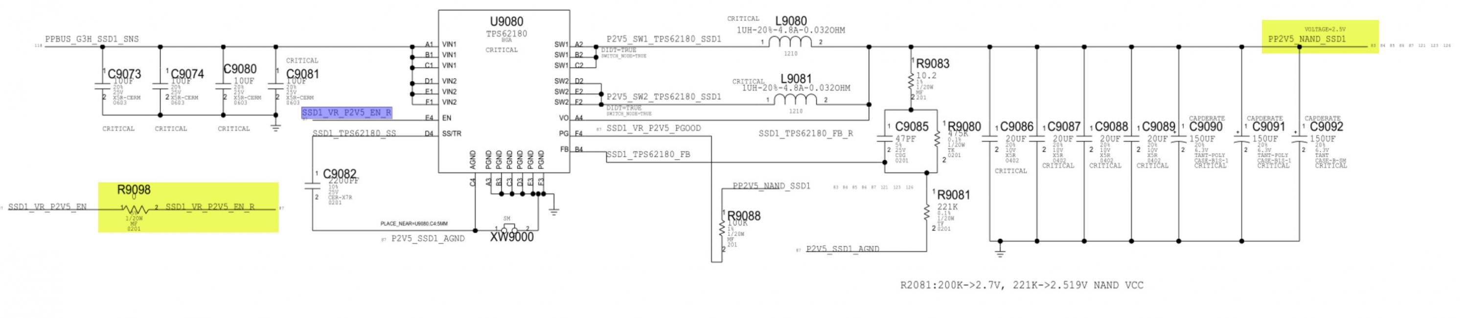

    We have a Macbook A2141. LIQUID DAMAGE. Customer must have showed it somewhere , as many caps are are removed or burnt out around UB000 and U8900 (assuming this was the region of liquid spill)
    AMP Meter is Pulling 5V on all 4 Ports. (Using a 96W Charger)
    PPBUS_G3H is 12.3V.
    Can anyone help me out on this?

    Check the voltage to ground of each LDO rail of the ACE (CD 321x) controllers. Each ACE controller must be working to select the 20v power delivery contract from the power adapter.
    Post each measurement.

                  PP2V5_NAND_SSD1 is at 0 Volts.
                  • mon2
                    • Dec 2019
                    • 14659
                    Re: Macbook A2141 820-01700
                    Focus on U9080.
                    What is the voltage to ground of SSD1_VR_P2V5_EN_R ?
                    You can measure @ R9098. This is the ENable pin for the missing voltage rail needed by the SSD.
                    If this EN pin is a logic '1' = high, then U9080 is being requested to turn ON but due to the possible liquid damage, the output is not present.
                    So this will mean that U9080 needs to be replaced.
                    With no power, do measure the resistance to ground of PP2V5_NAND_SSD1.

                      SSD1_VR_P2V5_EN_R at R9098 is 0 Volts
                      Resistance at PP2V5_NAND_SSD1 is 70.
                      (Meter set to lowest scale i.e 200)
