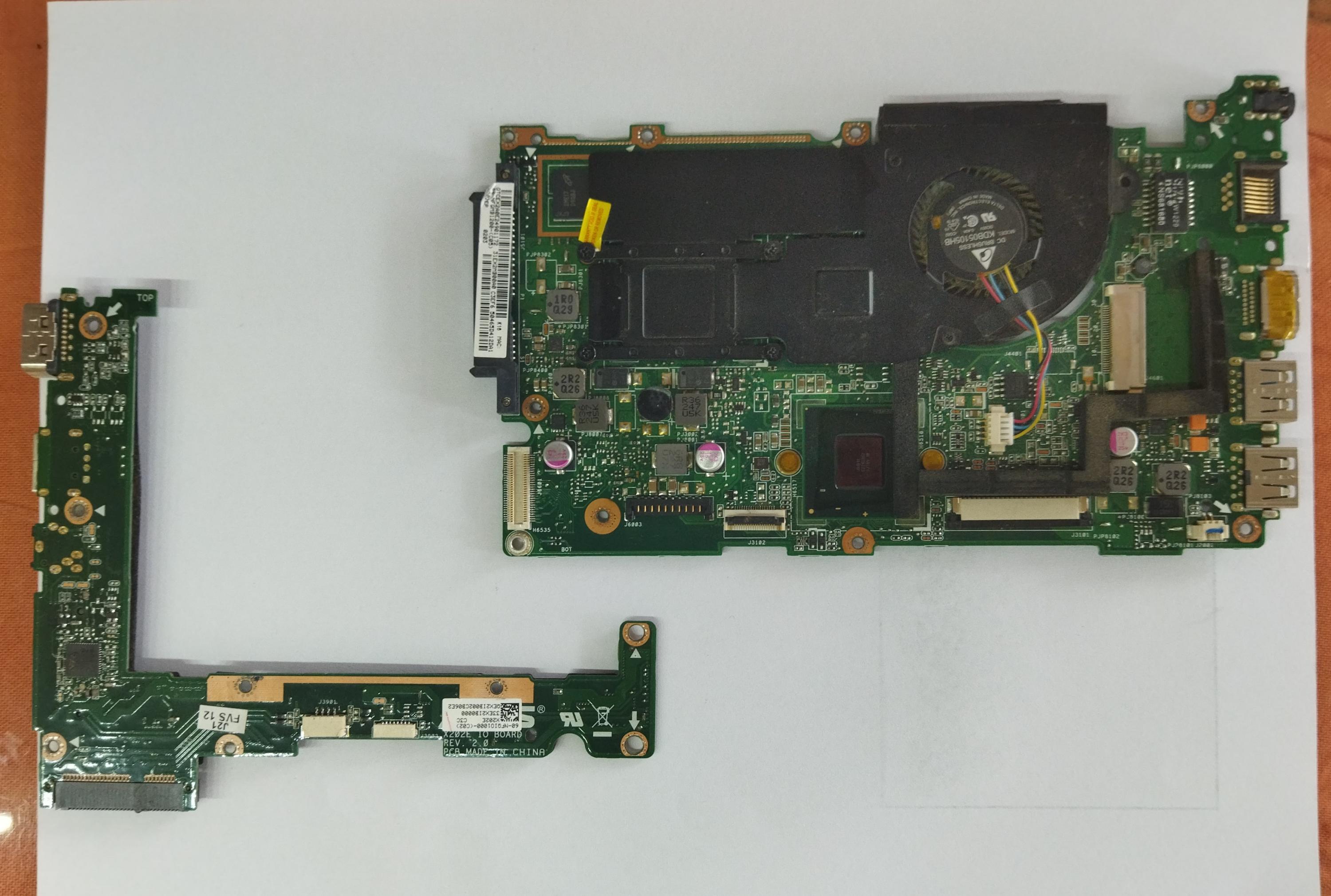

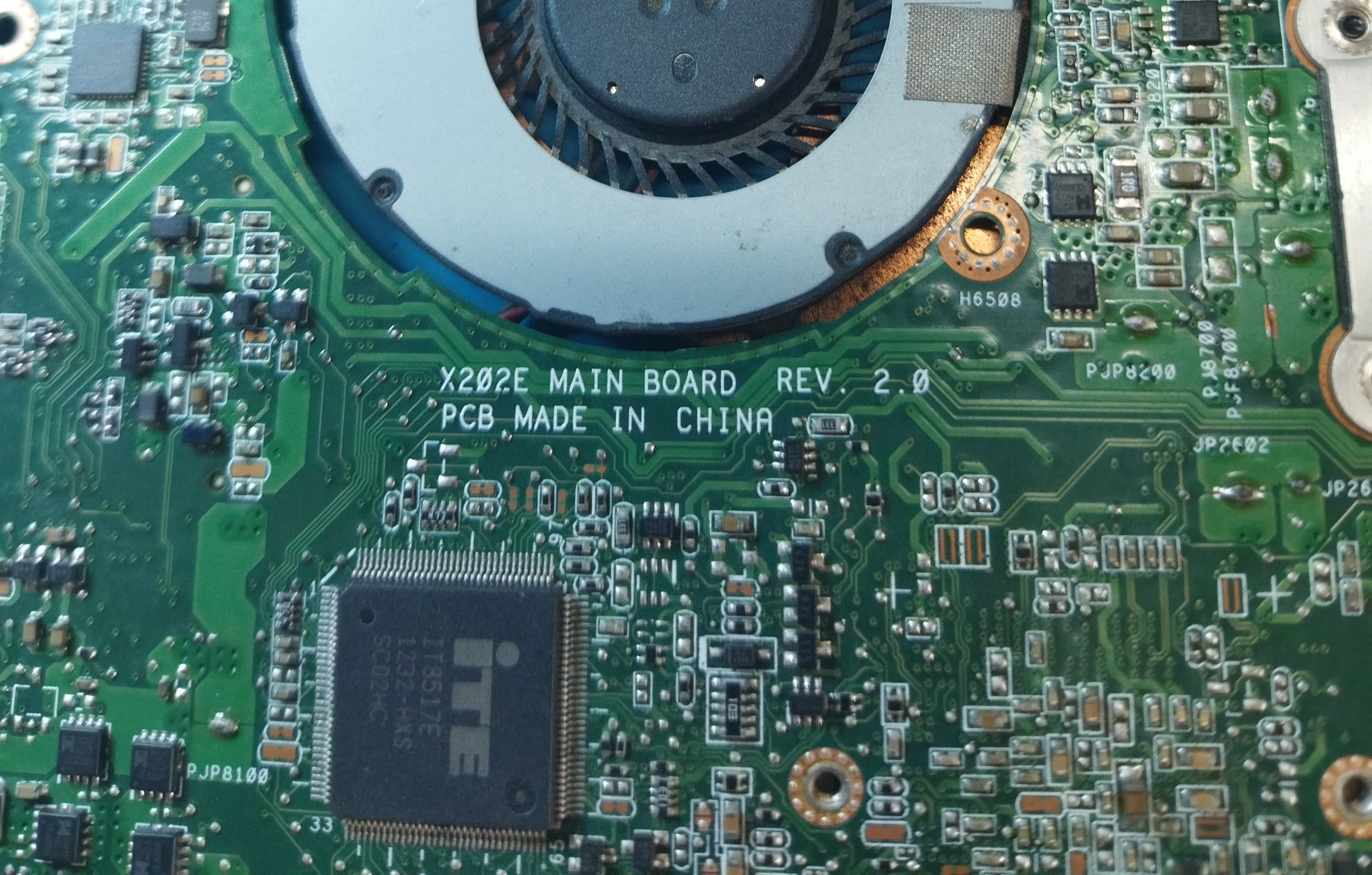

    hello!
    i'm new here and i don't know where to go. i just want to ask somebody about a laptop problem., i have this asus (X202E) laptop that i fix for a button problem only. the laptop works for a month and suddenly it turns off (no charging LED light & no power LED light). the board has: 19v on power rail, 3.3v on power button, 1.2v from one of the coil
    I tried this:
    1. replacing the BQ735 chip(responsible for regulating power to the battery). The laptop turns on (for a day) and then turns off (no charging LED light & no power LED light)
    2. replace the high side mosfet that supply power on battery. the laptop turns on when i test, but after assembling the laptop, it did not turn on (no charging LED light & no power LED light)
    3. replace the low side mosfet that supply power on cpu. the laptop turns on when i test, but after assembling the laptop, it did not turn on (no charging LED light & no power LED light)
    i don't have schematics & i don't know what else to do.,
    i want to flash bios but i don't have the bios file..
    any reply to this is much appreciated...
