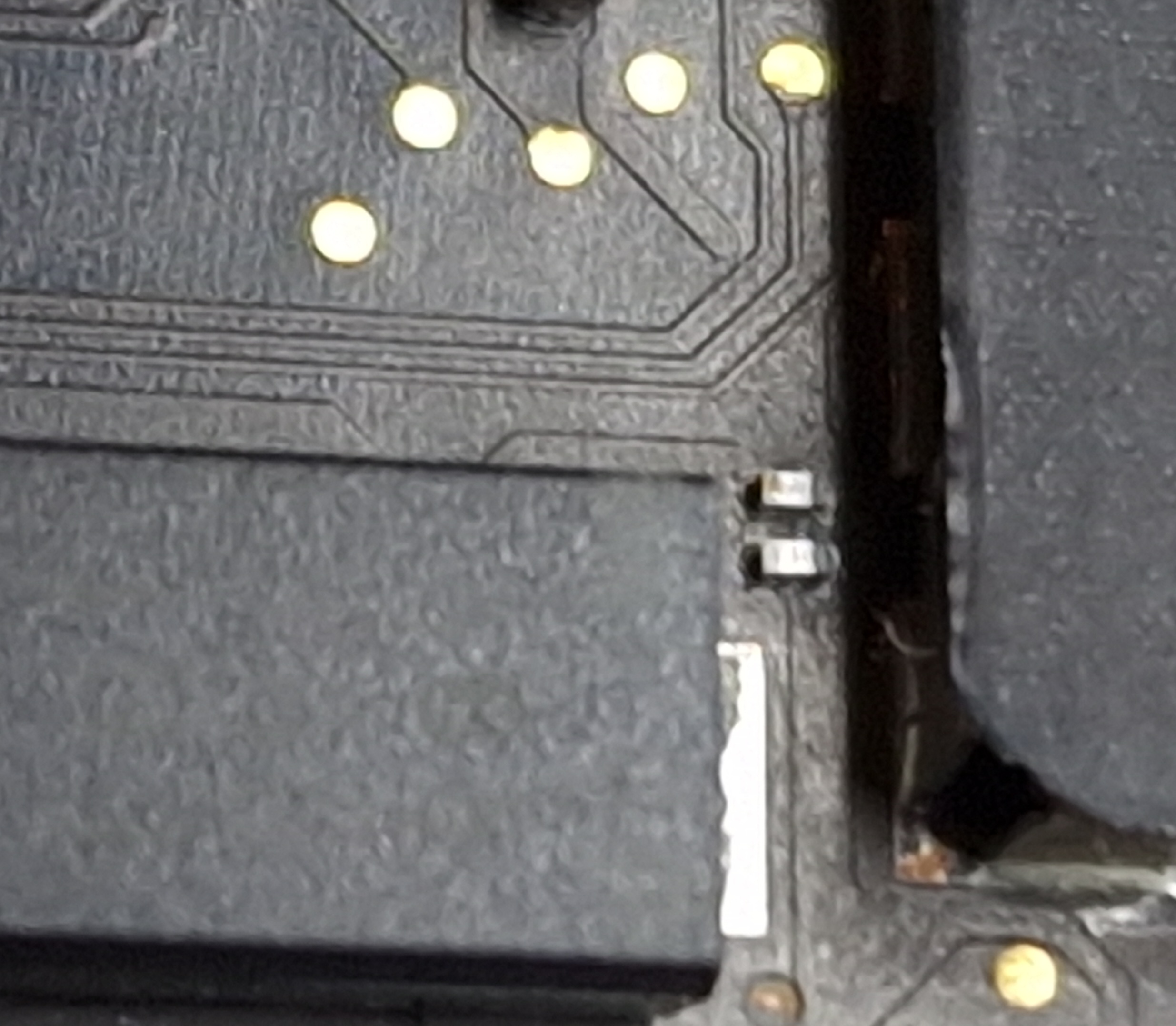

    I have a MacBook Pro A2338 with liquid damage. And some parts are broken. including The 2 pcs CF120 and CF 121 USBC_ATC1_R2D_C_P<1>. I have different LogicBoards from which I can take parts. But I can't find you. Can someone tell me exactly what SMD parts are? thanks

    Hello, can anyone tell me what the parts are or where I can get them? thanks

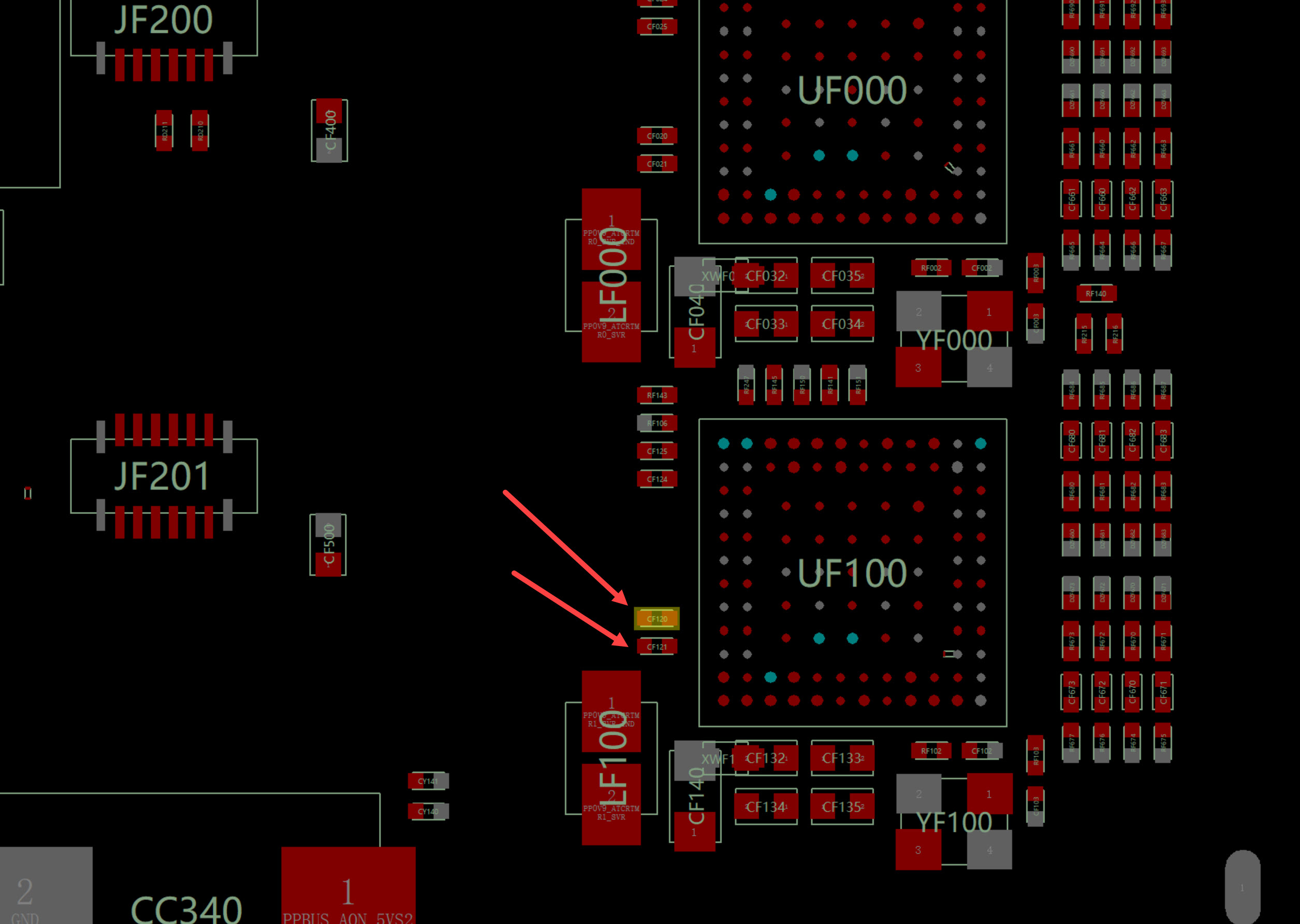

      Hi. See attached. Is the same as your board layout ?

        Re: A2338 820-02020-a
        yes 100%

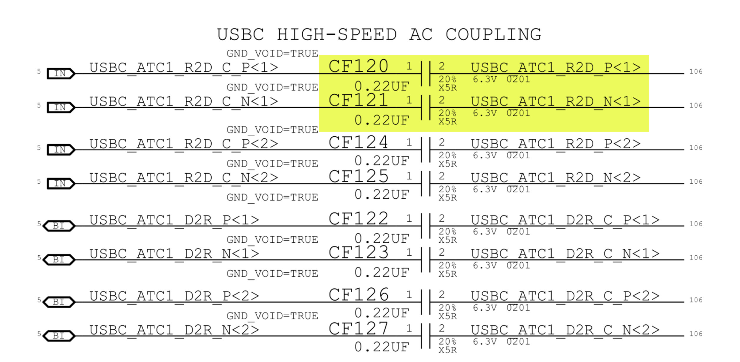

          See attached. These are very common DC blocking caps - nothing special; any brand will do.
          Value:
          0.22uF X5R or X7R
          0201 size (tiny !!!)
          6v3 or higher is fine
          Suggestion: Pickup 100 of these on cut tape as they are very cheap & easy to lose!!
          Where do you shop for such parts? RS / Digikey / Mouser ?

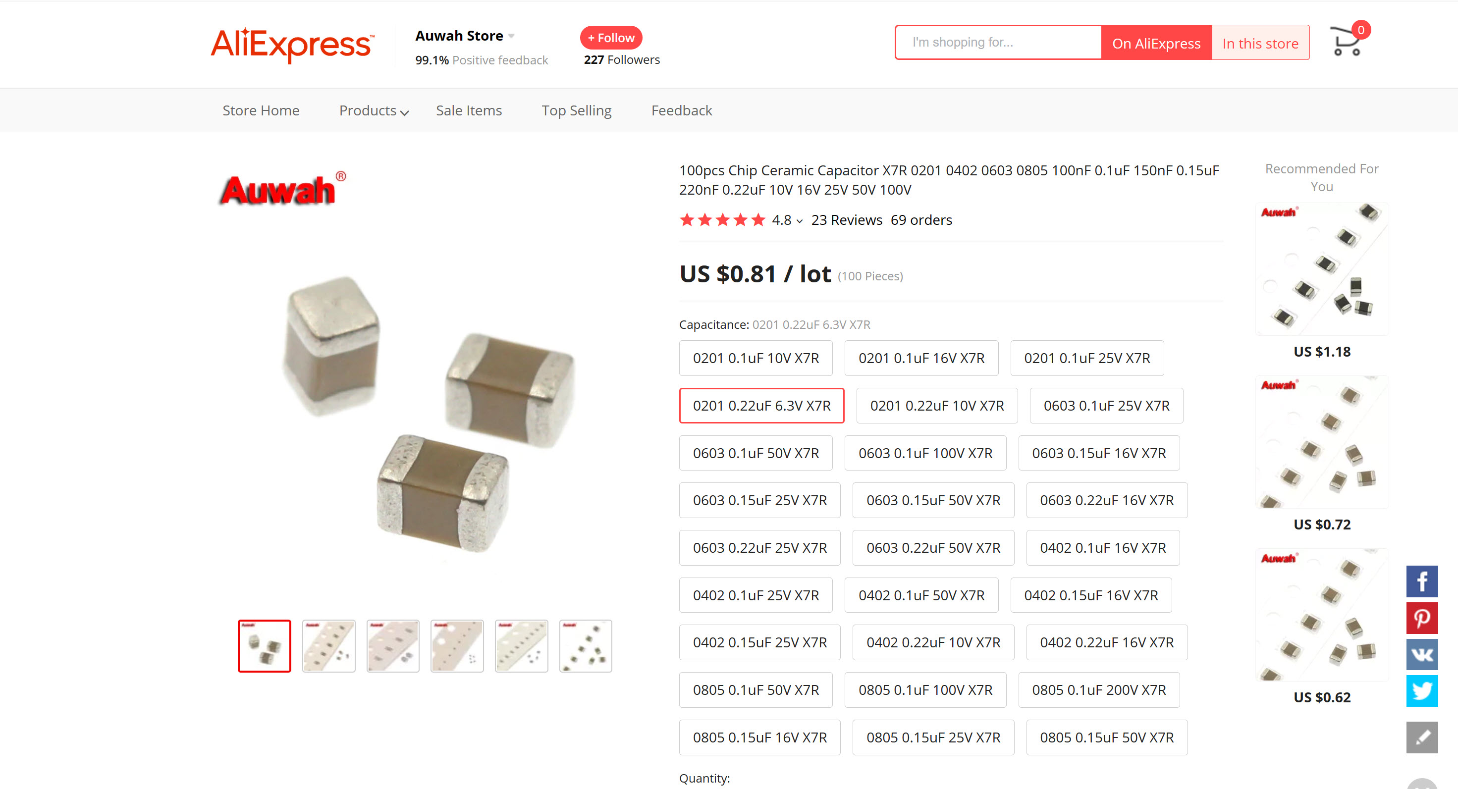

            I buy from Ali, do you have a link where I can get the parts

              Oh I didn't see pin 2 on the schematic. It was late after work ;-))

                Arrow / RS / DK / Mouser may be faster and better but Aliexpress does offer the parts.

                    Search for '0.22uf 0201' on Aliexpress and it is the first match.
