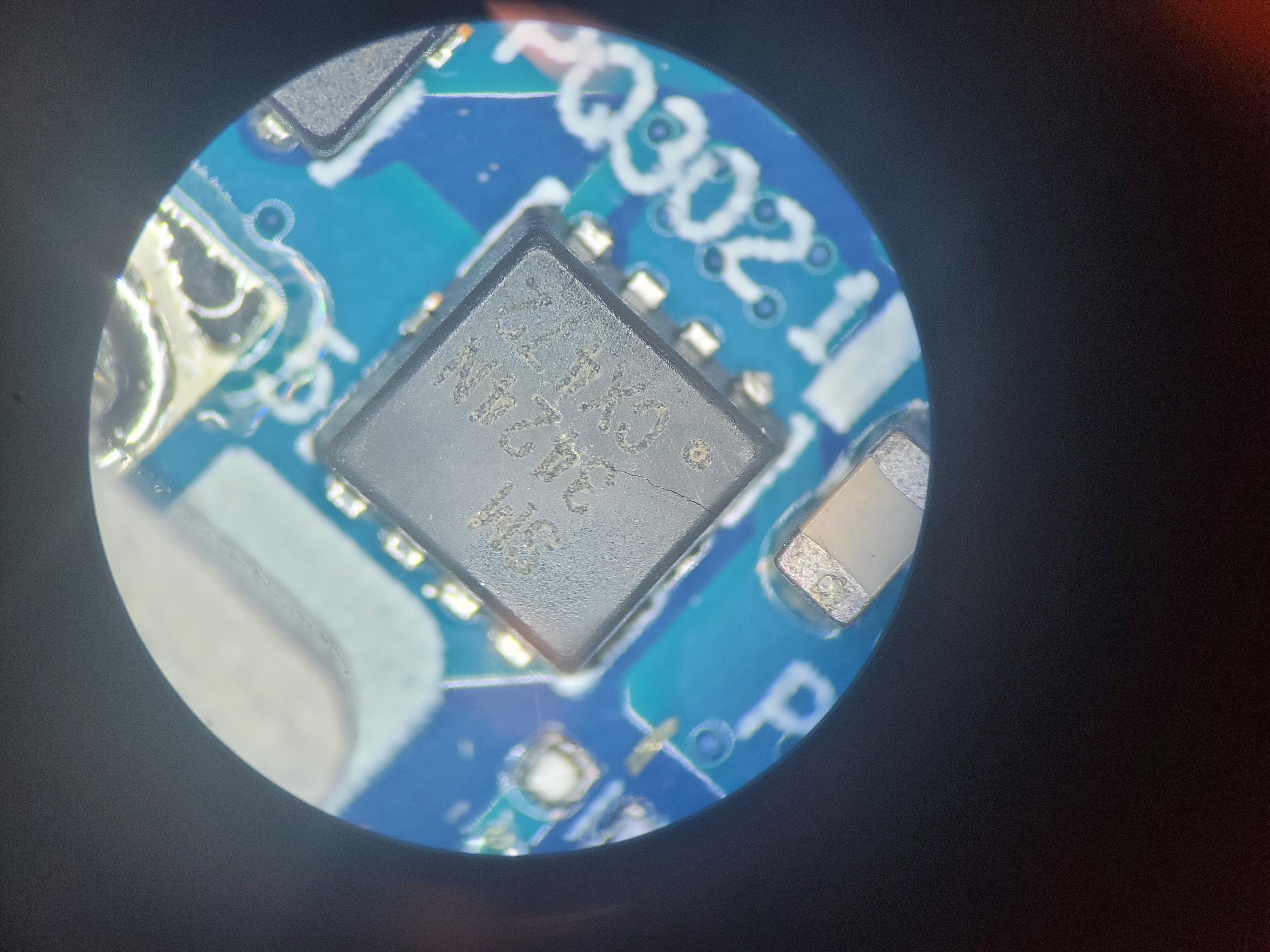

    I don't know if this is the correct forum or if I should be posting in another one. I have a broken mosfet that needs to be replaced on a yoga motherboard.
    The mosfet is labeled:
    SM
    3424n
    CX427
    I have found a replacement before searching a combination of these number but this one is giving me issues.
    Am I going about this wrong?
    Advice and any and all tips is greatly appreciated.
    Re: How to find the correct Mosfet on a laptop I need to replace
    It's a SM3424NHQA.

      Just in case anyone wanted to see what I'm talking about.
