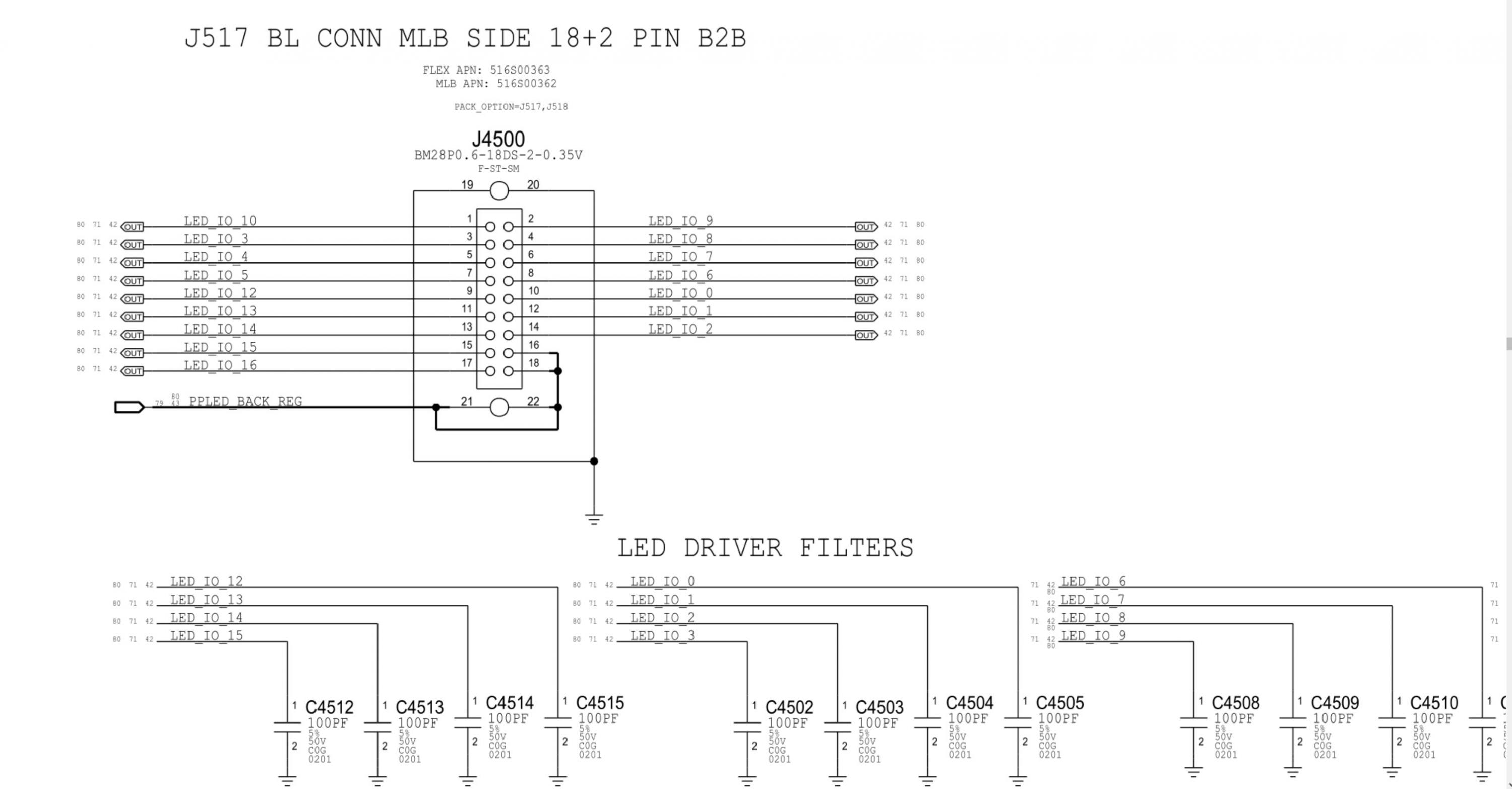

    Hi everyone
    Had an iPad Pro 11" 3th gen come in (model A2377), motherboard number 820-02300, come in for no backlight. They tried to replace their own screen. I'm gonna assume they didn't disconnect the battery before connecting the new screen.
    I'm working using ZXW, so I have the boardview, but don't have the schematic for it.
    Is the J4500 connector responsible for the backlight? It has the signals PPLED_BACK_REG and LED_IO_1 to LED_IO_16.
    Any advice welcome, it's my first time with a newer gen iPad Pro.

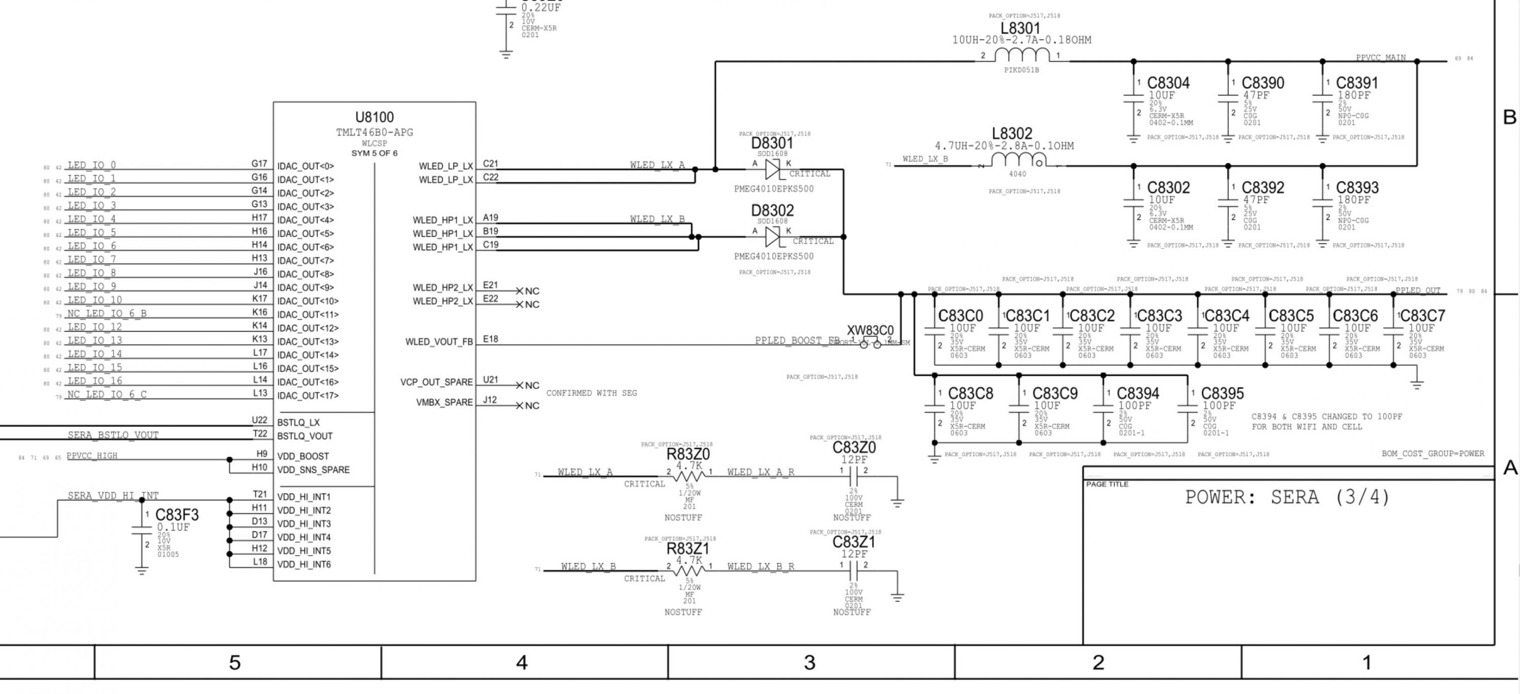

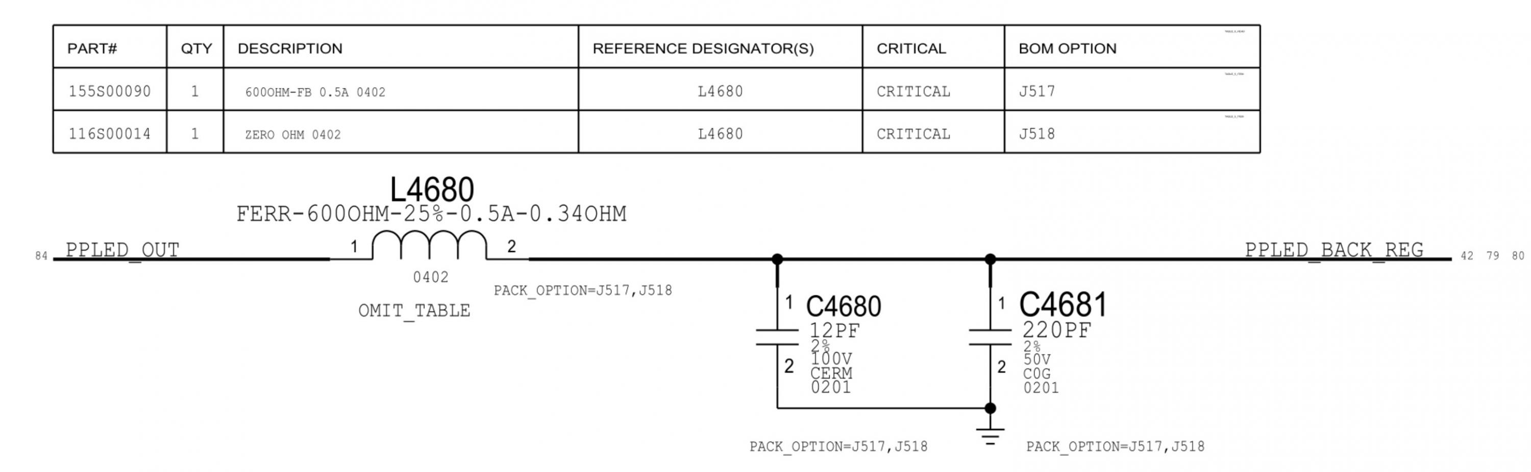

    Re: iPad Pro 11" backlight (820-02300)
    See attached,
      So I'm assuming yes, this does backlight. It is a little unclear to me tho, what do PPLED_BACK_REG and LED_IO_X exactly do?
      Also on a sidenote, if by any chance you have the full schematic available, any chance you could drop it here? Thanx!
