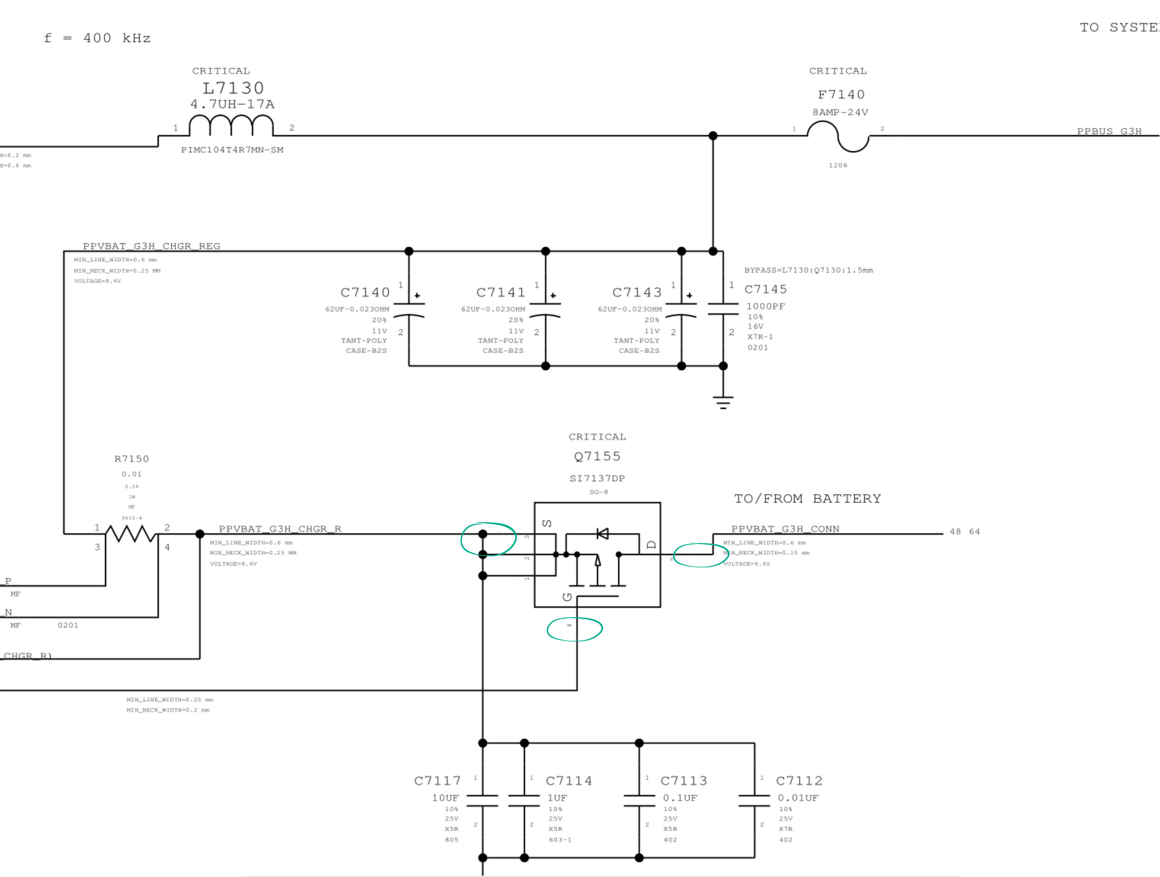

              • mon2
                • Dec 2019
                • 14002
                Re: 820-00165 Charging Problem
                See attached.
                Measure the voltage to ground of:
                source (1-2-3)
                gate (4)
                drain (5-6-7-8)
                pins of the battery mosfet @ Q7155 when:
                a) using the non-working / flaky original charger - interested in the voltage readings when the battery is NOT charging
                b) the battery is charging with your DC power supply

                      • mon2
                        • Dec 2019
                        • 14002
                        Yes, right side of this mosfet has the drain pins = pins 5-6-7-8. Any of these pins can be measured since these block of pins are mated together. See the datasheet or the bottom side of these mosfets. You will see a solid connection between these pins.
                        The gate voltage defines if this mosfet is on or off. Being a P-channel mosfet, the gate voltage must be lower than the voltage it is passing between the source and drain pins.
                        So if gate is a high or same voltage as the source / drain pins, the mosfet should be off.
                        Of concern is that you do not have a lower voltage on the gate pin when the battery is removed, yet drain has the same voltage as the source??
                        That is, the drain pins should be at 0 volts for this case.
                        Remove all power. Remove the battery. Meter in resistance mode.
                        Measure the resistance across this mosfet's pins:
                        Source & drain ; select any of the pins (1-2-3) and (5-6-7-8)
                        Source & gate (4)
                        Gate & drain
                        Post the resistance of each measurement. If the resistance is low on any of the above checks, the mosfet is leaking and should be replaced.
                        Suspecting that this mosfet is defective from your measurements without the battery.

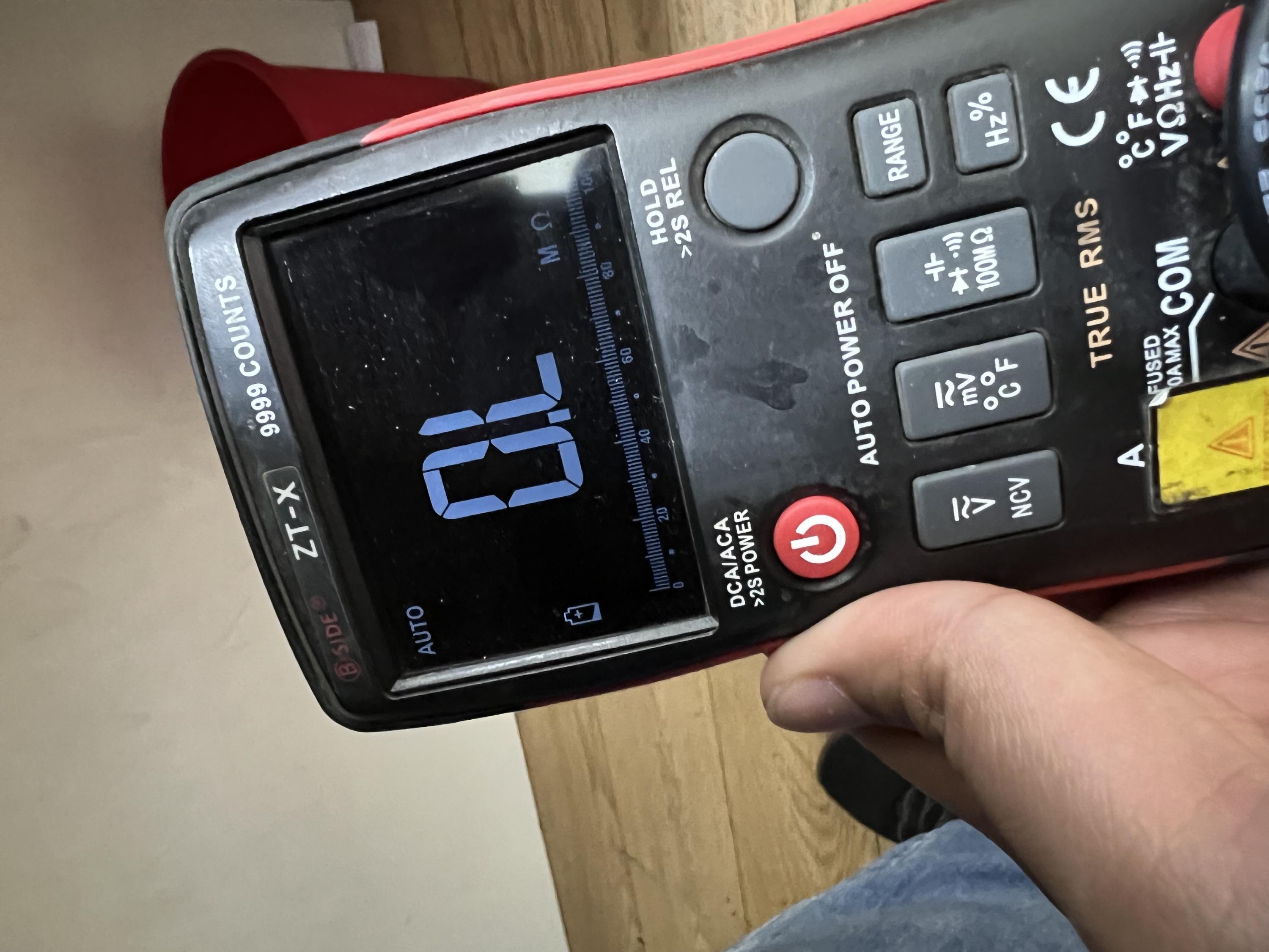

                          • mon2
                            • Dec 2019
                            • 14002
                            Can you post a pic of your meter face?
                            Appears that the same button may be also with diode mode?
                            If yes, keep pressing the mode button till you see the omega symbol. Post a pic to clarify.

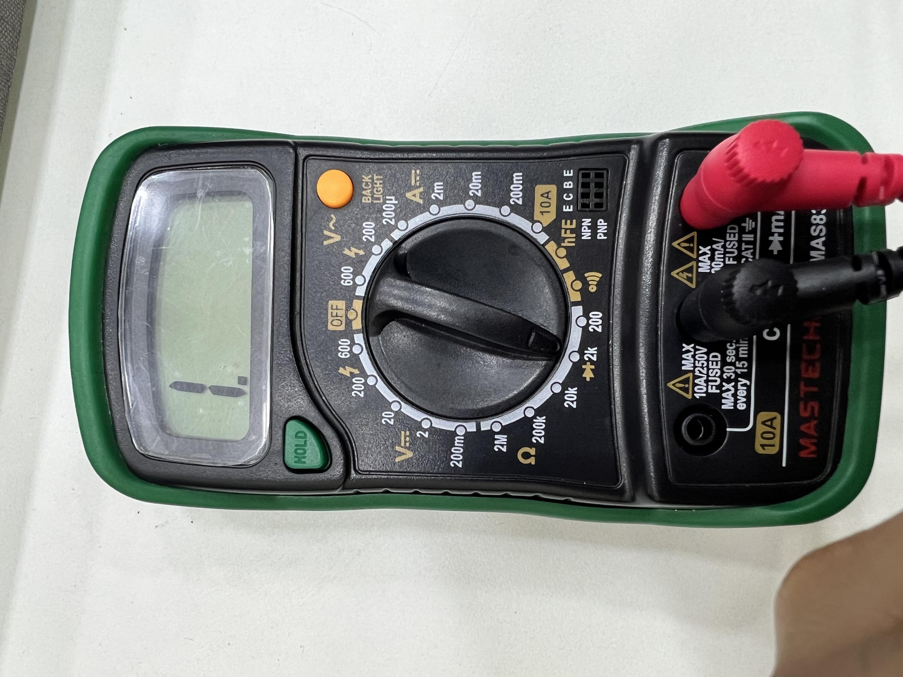

                            • Instafixx
                              • Jul 2022
                              • 374
                              • India
                              Its a Analog Meter.
                              • mon2
                                • Dec 2019
                                • 14002
                                No, meter is digital. The 2k scale also is the diode mode scale.
                                Press the yellow button to switch to the resistance mode scale.
                                Then measure again. If you do not get a proper reading, switch to the next higher resistance scale.
                                Post your readings again.

                                • Instafixx
                                  • Jul 2022
                                  • 374
                                  • India
                                  Check resistance between,
                                  Pins 1 & 8 = source & drain
                                  Pins 1 & 4 = source & gate
                                  Pins 4 & 8 = gate & drain
                                  The Yellow button just switches on the Backlight.
                                  Used another Digital Meter. Pressed the button till i got the Omega Sign on the screen . Picture attached.
                                  Black on 1 and Red on 8 = 2.12
                                  black on 1 and Red on 4 = 8.31
                                  Black on 4 and Red on 8 = 8.82
                                    Can you a pic of the meter face with one of these measurements?
                                    Is the reading in M ohms? That will be then (for example) 2.x megaohms but we need to confirm each.
                                    When you short the meter probes, the reading should be ~0 ohms.
