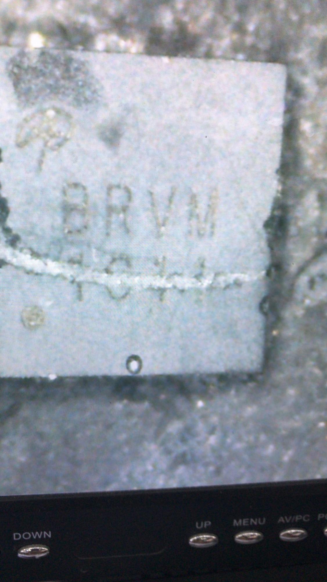

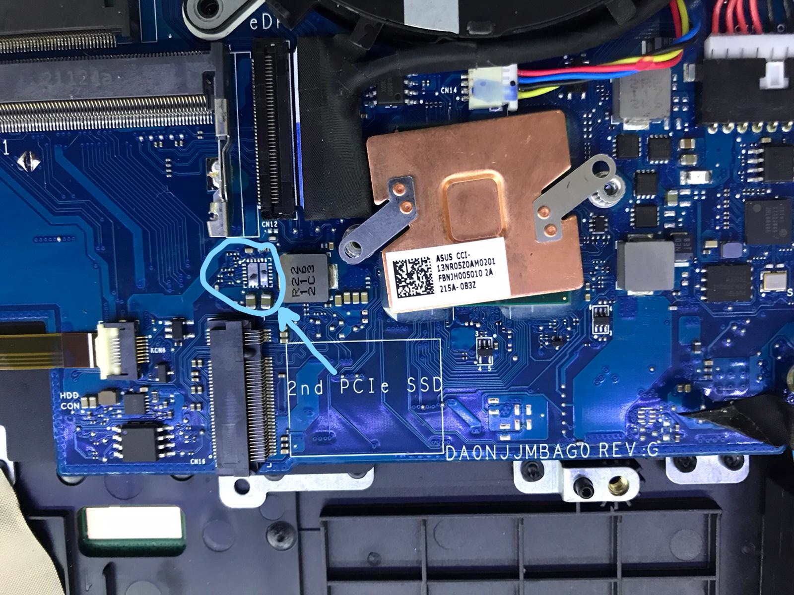

    I need this integrated. whats this piece?
    thank you guys.

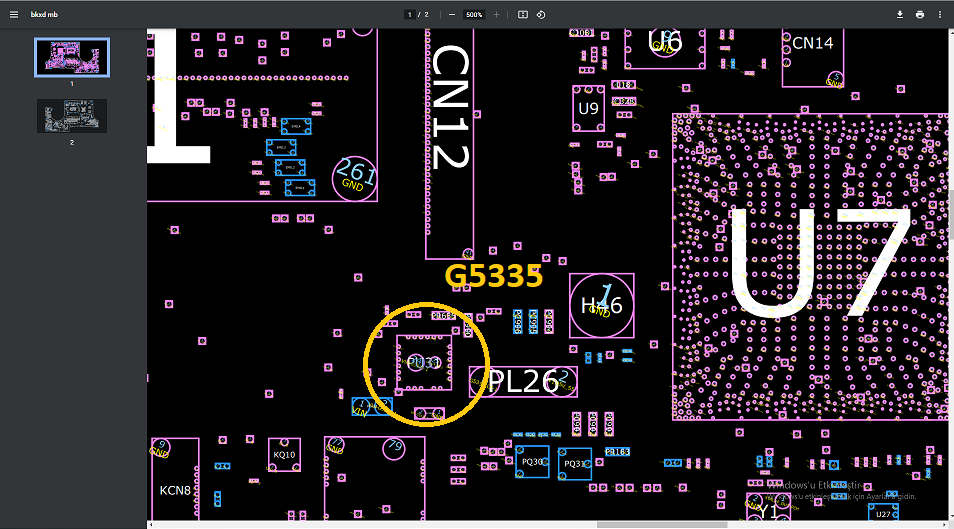

    It is PU31 in the boardview file here (last post):
    https://www.badcaps.net/forum/showth...00#post1132300
    Symbol on part = AOSMD is the manufacturer.

      The footprint looks like its QFN-23L or QFN-22L. Could you post a picture of the chip pins. If it has all pins its 23L if one is missing on the top row its 22L , it will help to narrow down the search.

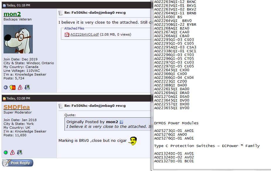

        I believe it is very close to the attached. Still confirming.

          Marking is BRV0 ,close but no cigar .Working on a new list to add to the AO IC marking codes post

            i see "G5335"
            AOZ2264VQI / g5335 other piece and aoz2264vq1 no sale..
            whick one to use?
