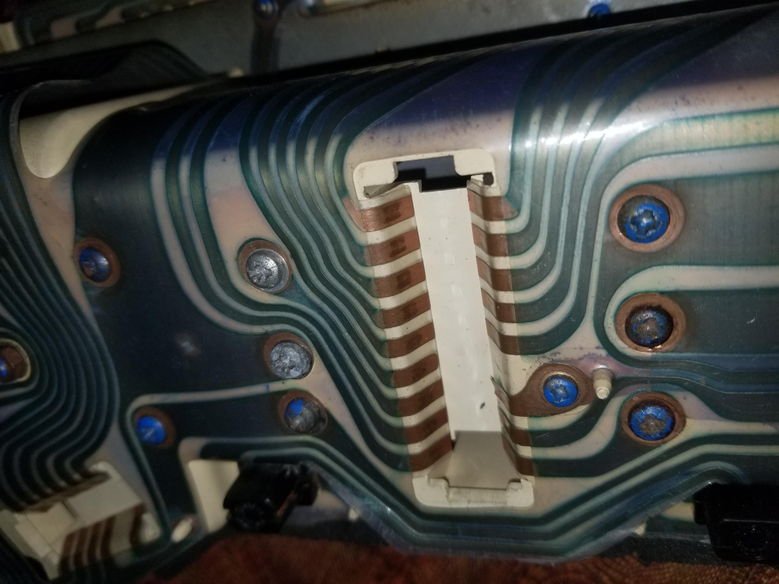

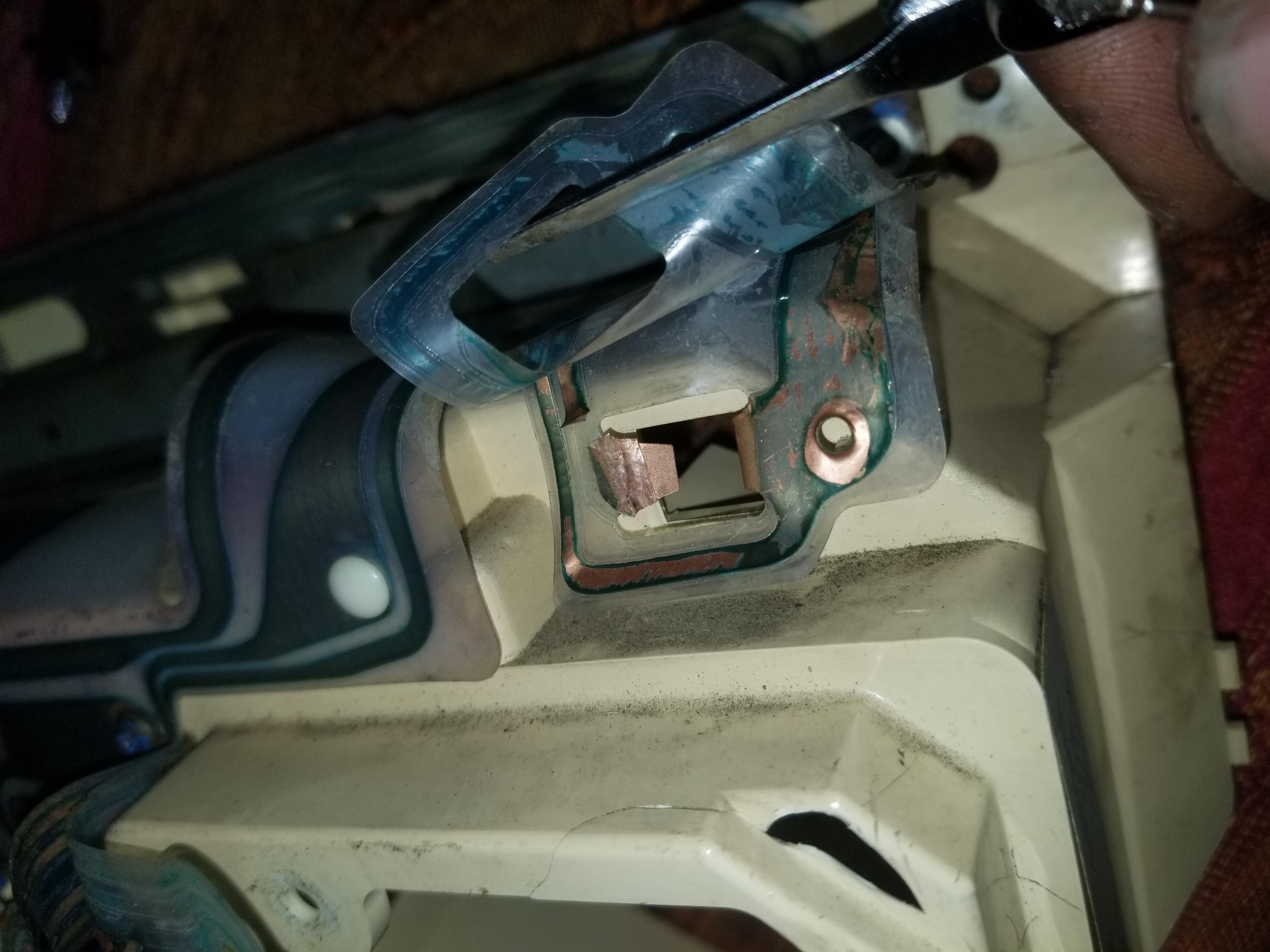

    Hello All.
    I'm working on the printed flex circuit board (flexible type) of a 1990 Jaguar XJS Instrument cluster. If you Google that you'll be able to get a general idea.
    In areas, the plastic has come apart allowing the copper strip to kinda flop around and be exposed to the elements.
    What can I use to glue the 2 faces of the plastic material together trapping the copper ribbon inside...
    Again - thank you all for you help. This will be the 4th or 5th time now that I have come here to receive AMAZING advise and directions. Thanks so much!

    Re: Glueing Two Sided Flex Ribbon,Jaguar XJS Instrument cluster.
    Hey If you are trying to glue plastic together then any glue will work. If you are trying to glue the actual flex cable then I would say hot glue would be the safest option. You can even use it to cover whatever is exposed. I googled it and it appears to be a big flex with many traces. What exactly are you trying to glue and are you sure it doesn't need to be soldered?
    Please attached pictures.
      Hey Gleb...
      Basically the two halves of the plastic ribbon have come away from each other at a few sections, and it's getting worse. This particular area is all B+ 13+ volts, so I need it tied down with something non conductive, that will hold. There should be any heat involved other than the heat and cold that the interior of a car will experience thru seasons. Was looking for an adhesive for this. Will send some snaps
      The other issues, yes, some pictures and diagrams will be forthcoming. Now that I GOT ya, lol...

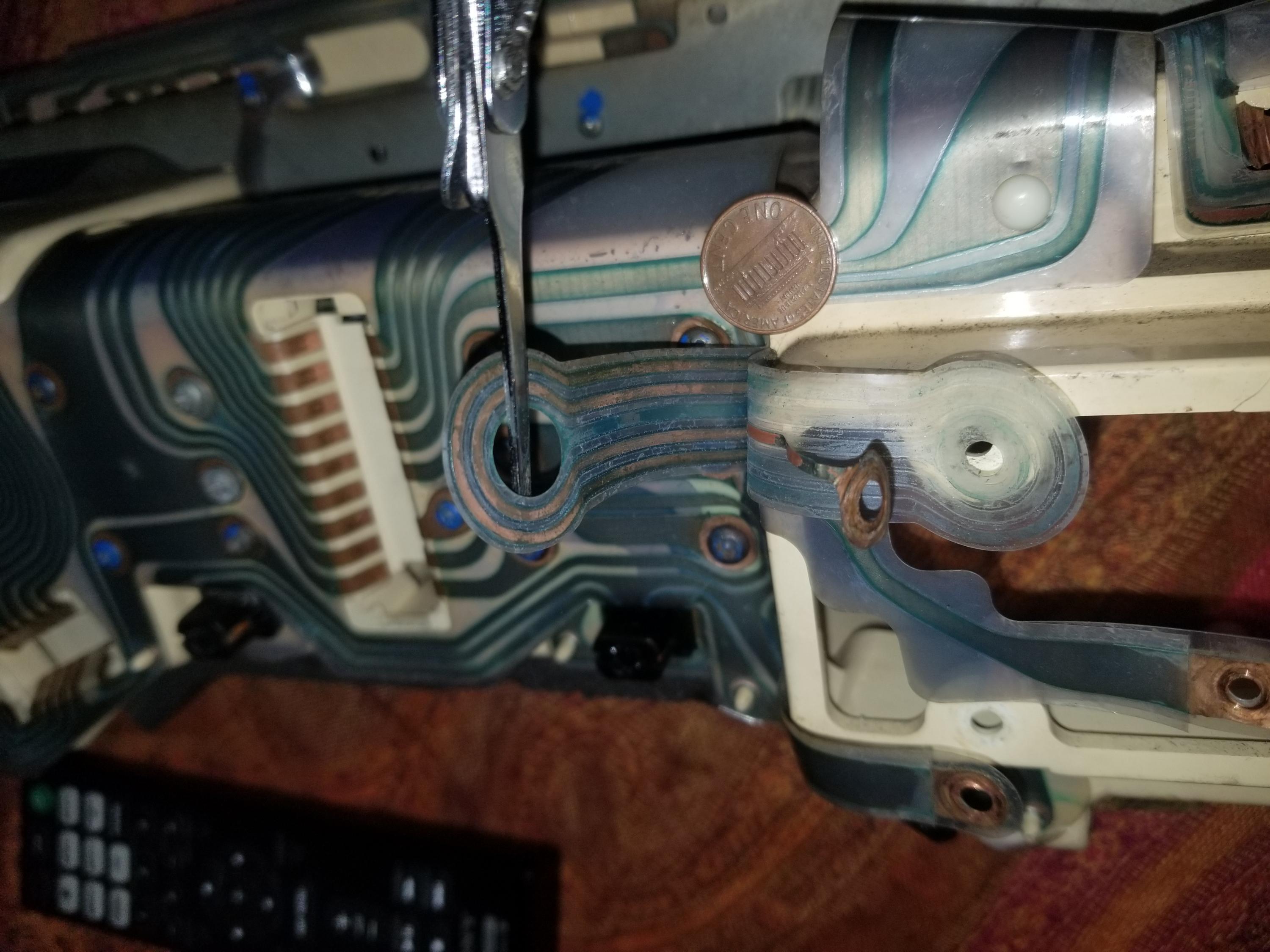

        The original flex is a sandwich of plastic, adhesive, copper formed under high pressure and heat in a press. Guessing mylar film (not darker coloured polyamide) and adhesive similar to DuPont Pyralux LF but it only comes in sheets. I couldn't find any glues for repair.
        Cyanoacrylate (Super Glue) does not stick to some plastics or metal, you'd have to do a test but I think it's not good.
        People solder in jumper wires to bypass the flex cable but soldering it melts and wrecks it. Instrument cluster should not have high current beyond needing to clear a fuse if there is a short circuit.
          HellO Red. Ok, I see the link. And I like your thinking. I have some super glue on hand I just was sure whether it was conductive or not.
          I'll post up some photos, feel a bit ashamed of what I'm working with, but... Time and age did this, not me, lol. I have destroyed anything,,, yet 😆
            I would use B-7000 rather than super glue as it has a little flex.
              This might work but have never tried this but it might be worth a try if the plastic has come loose from both side of the trace then why not use full sheet of laminating that is use to laminate full sheet of paper that you want to keep
              I do not see any reason why this would not work however if someone does feel that this would not work feel free to explain to me why this would not work
              it might not be as strong as the original one is but it might still be good enough to keep using the cluster unit until you can maybe find a replacement for it
              ( I would only repair the sections that are bad I would not try to peal off sections that are not separating )
              ( if the copper trace is torn they do sell copper strip on a roll in different diameters which can be replaced and join back together with soldering them back together )
              I would clean the copper until it shines before I would laminate it back together if this should work please let me know how it turns out
                  We’ve got something called shoe goo. It sticks like mad, but stays flexible.
                    Ha! I remember shoe goo. Was a good thing when it came out,,, 80s I think...?
                    So, I used a combination of super glue (which I liked) and the E6000 (which I know think is a knock off of another product) which reminded me a lot of shoe goo. All good results. The super glue DID make for stiff sections (which wasn't a bad thing in some areas) and the 6000 in areas that MIGHT get bumped or moved. All good. I reinstalled the instrument cluster last night and drove into work this morning.
                    Replaced many lights with LEDs. Great improvement. Dealing with the polarity was not much fun.
