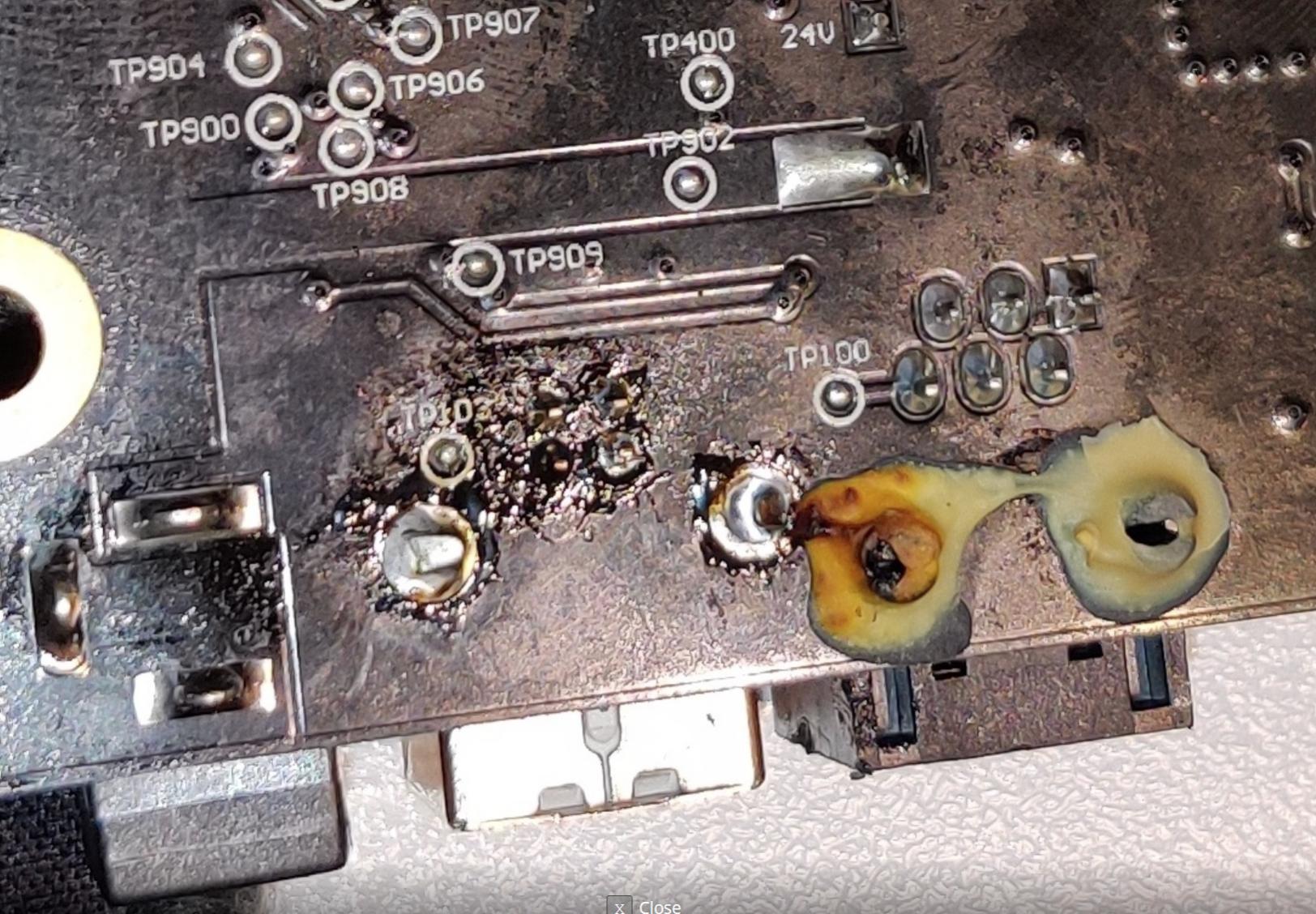

    Working on a Fanatec wheel base assembly with a damaged USB port. It has a USB B female USB port (like a printer). One of the traces underneath the USB port as torn, and the PCB eyelet is damaged. The torn trace itself is not to big a deal to fix, but the eyelet is another matter. It's the eyelet for one of the smaller USB data pins, is it possible to find a replacement eyelet somewhere? Where can I order something like that? And what tool would I need to crimp it in place?
    Thanks.

    Mouser maybe for eyelet, I guess I can measure size of original eyelet with caliper. Although it seems they only have brass eyelets, not copper.
    https://www.mouser.com/c/electromech...q=pcb%20eyelet
    There's also https://www.circuitmedic.com/index.html
    Prices seem high but perhaps a better selection than mouser.
    Any recommendations on eyelet setting tool for this small size?

      Re: Fanatec Wheel Base PCB Eyelet Replacement?
      the board doesnt have islets, it's through-hole plating.
      if you can see where the pin connects then run a jumpwire, if not because it runs inside the board then you have some work to do
              I don't think he is trying to fill a hole, the hole which had a feed-thru is where the usb pin is located, he just needs to connect a thin wire between the usb pin and where the trace went.
                      Eyelets are tiny, 1mm hole width and 1.5mm flange head. Only place that seemed to have it was CircuitMedic. The refill kit here should do the trick:
                      https://www.circuitmedic.com/products/201-3140.html
                        i normally put a strand of wire through the hole and call it done .. has to carry enough current though .
                          Or another option is to take wrapping wire and rap around the compost pin and make a pad where is none left I have done this yes it takes some patience and a little bit of trial and error for you to get it right
