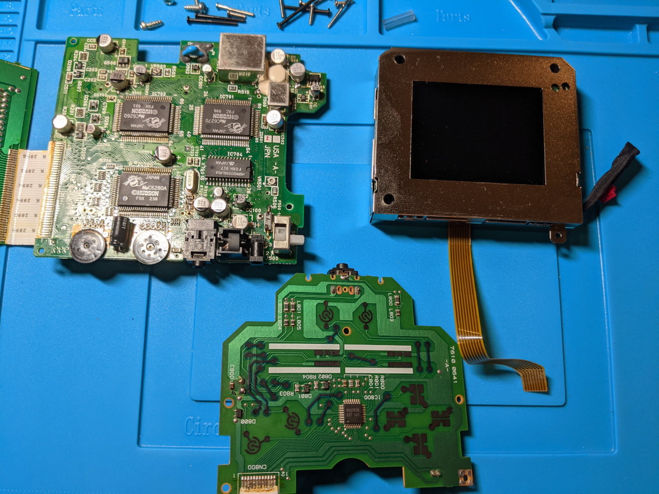

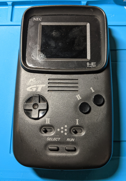

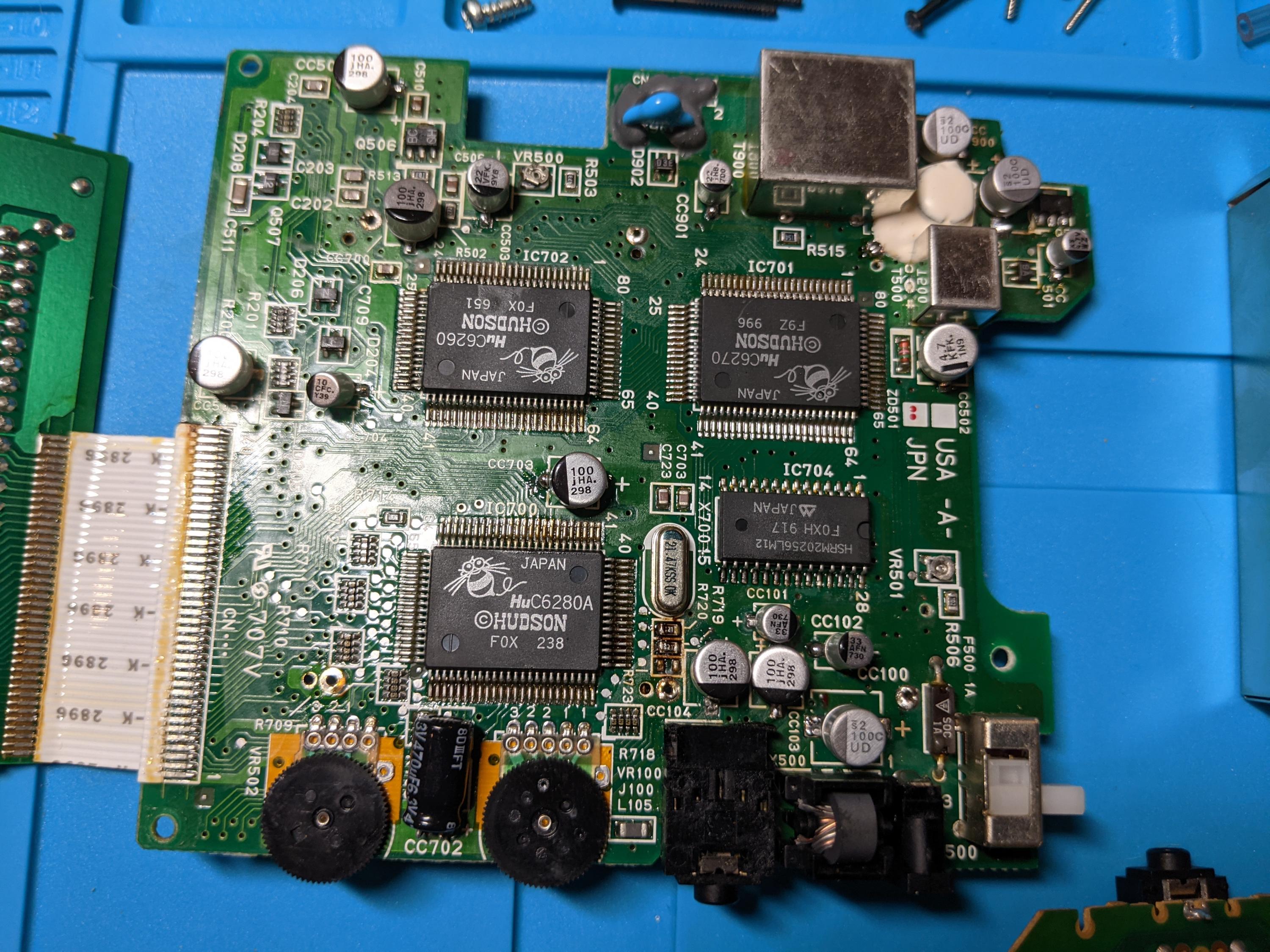

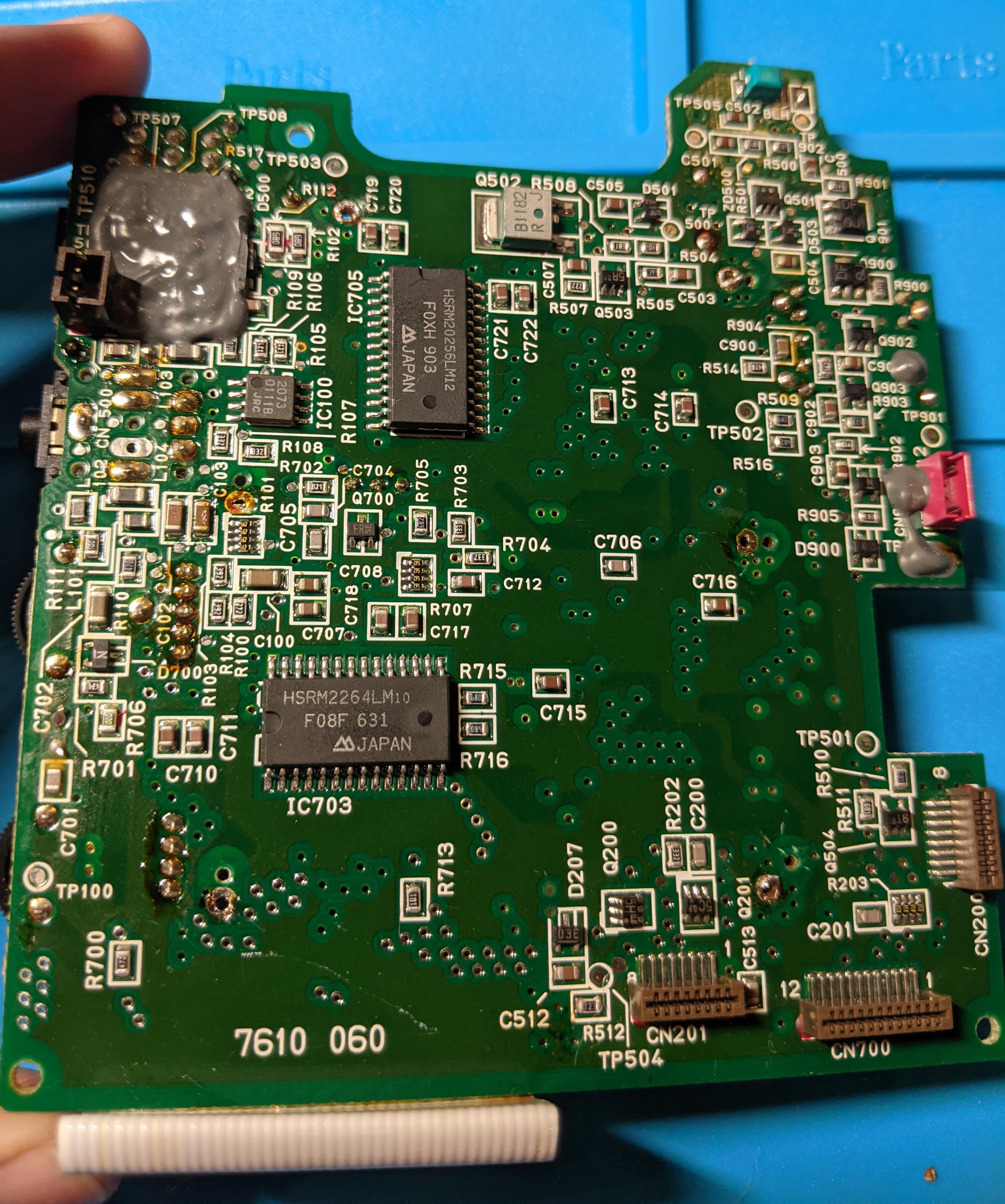

                  Ok, finally had a chance to tear this thing apart again. :-)
                  For anyone who doesn't know, but wants to, here is the device in question. It's a portable version of the PC Engine, which is the Japanese version of what we called the TurboGrafx 16 in the US. It's from 1991 and is notorious for bad capacitors, much like the Sega Game Gear.
                  Here's a look at the 2 PCBs and Screen. I've already replaced all of the electrolytic capacitors. There's also one cap on the other side of the button pcb, but we going to be focusing on the main board.
                  (click here to enlarge)

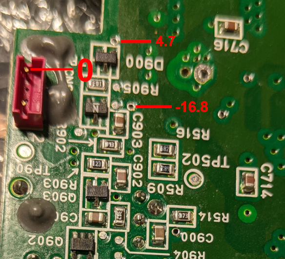

                  I did test some voltages as mentioned in a previous post:
                  Originally posted by OtherThread
                  Also, try for the following voltages at these Test points:
                  TP500 30v
                  TP501 -24v
                  TP502 5v (ish, you will see it from 4.8 to 5v depending on factory)
                  The 2x Variable Resistors adjust the supply rails:
                  VR500 LCD Voltage Adjust (-24v)
                  VR501 System 5v Adjust
                  Here's what I found:
                  • TP500 30.1
                  • TP501 -24.3
                  • TP502 4.91
                  • VR500 -23.1
                  • VR501 3.1
                  None of those seem off by too much except for VR501, but I don't know enough about any of this to know if that's a problem. HOWEVER, I also tried to probe the power connector for the screen directly, and cannot get any sort of voltage reading out of it!

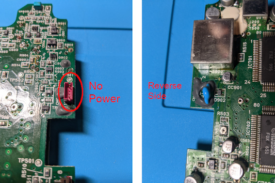

                  Here's a closeup.
                  And here's the other side.
                  It's the red connector I'm talking about. I assume I should get -24v from it, but I get nothing. I also don't get anything from TP901 which is next to it, but I also don't know what I should get there. Also notice what might be cap fluid lurking around? Do you think there could be damage under those grey blobs that is preventing those pins from getting power?
                  Any advice is appreciated! Thanks!

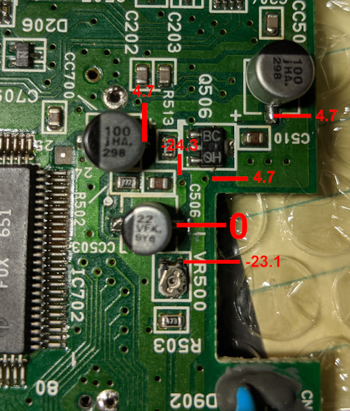

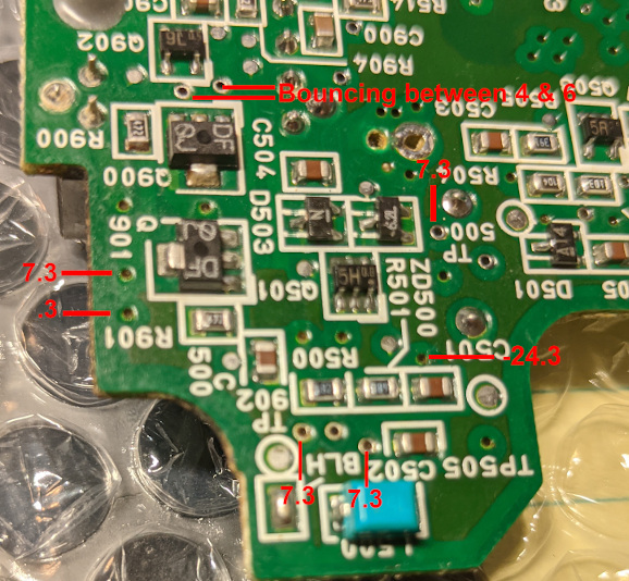

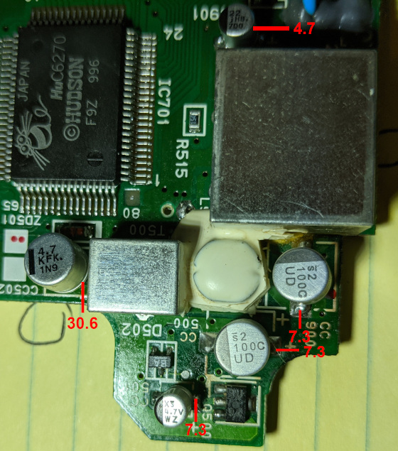

                    I did some more voltage checking. This time of Capacitors and Vias. I seem to have a problem at CC503. See pictures.
                    I'll be removing that cap to see what is happening underneath it. Any other advice? Thanks!

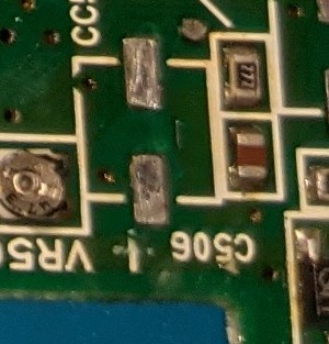

                      Re: PC Engine GT - No Video or Backlight
                      I may have found the problem!!!! I haven't had a chance to remove that cap yet, but I realized I had taken some pictures during the recap, so I went back and found a picture of the pads for CC503. There is CLEARY corrosion on the bottom 1/3, and that seems to be exactly where it connects to the trace. I've very new to all of this, and probably thought since 2/3 of the pad looked good, all would be well. Lesson learned!
                      The pads looks scratched up from me trying to remove some of the corrosion with my tweazers and some deoxit. I suspect if I can't remove more of that corrosion I'll need to either scrape away some of the solder mask at the edge of the trace and connect to that? Or can I run a jumper over to the via? Thoughts?
                      Thanks!

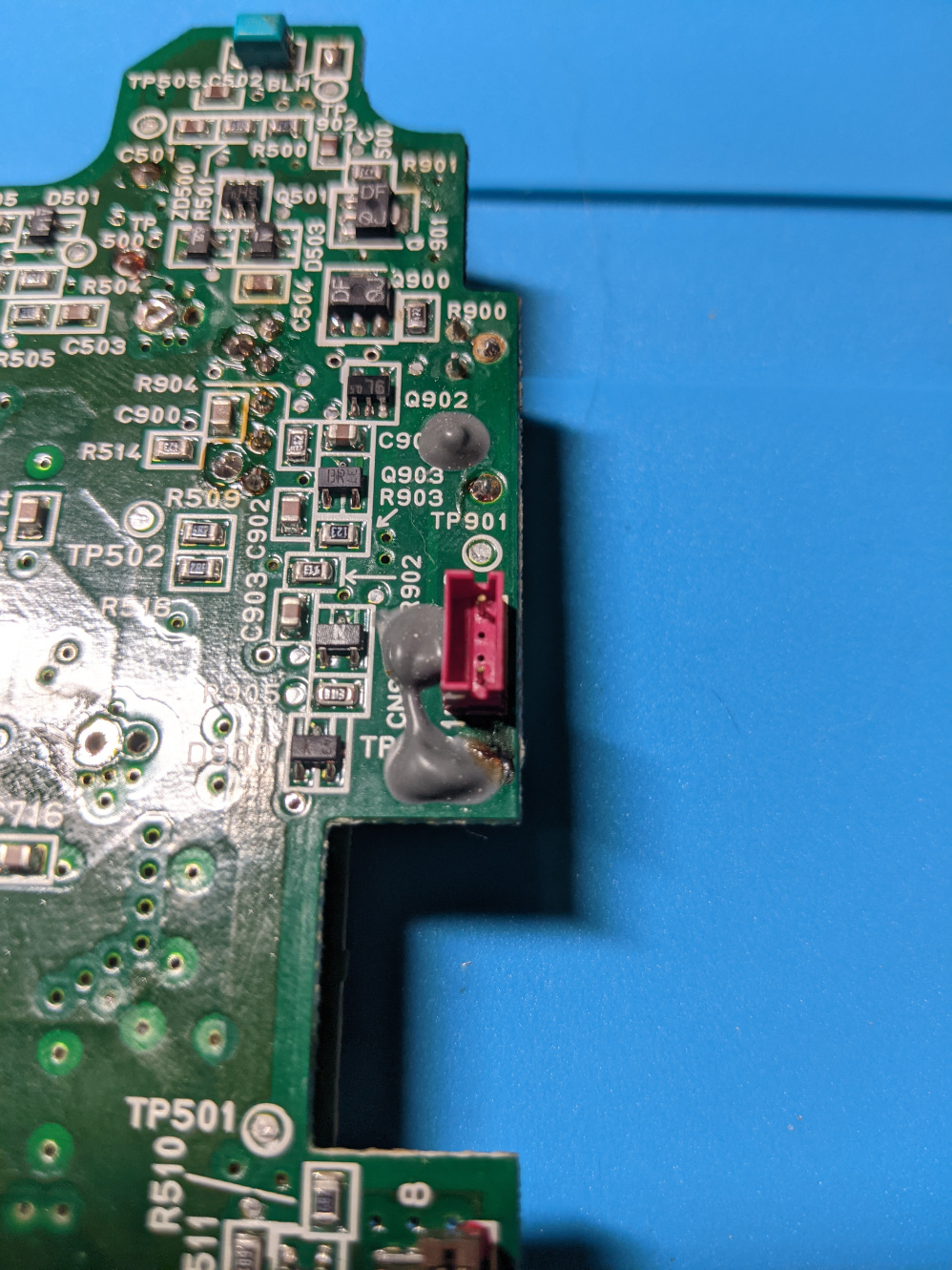

                        Ugh, I knew I shouldn't have been celebrating so soon, but damnit it felt good. Turn out, it was just my ignorance leading me to incorrect assumptions.
                        I was looking for -24V on that cap, but I don't really know what "negative voltage" is, so I didn't realize I needed to check for the voltage on the negative side of the cap. It was there all along. In fact, when I removed the cap, I found fairly pristine pads underneath; turns out I took that picture before I went back and cleaned up the pads. Here's what they actually look like:
                        I've looked at this board up and down a magnifying glass and I still have no idea why there's no power here:
                        Do you think I need to scrape away the grey goo, and is that safe?
                          I'll write a more proper reply later/tomorrow or Monday, since it's early AM hours here... but just FYI, that red connector is probably for supplying power to the CCFL backlights of the LCD. IDK what voltage and current those would require with this being a handheld device, but even small CCFLs in 13-15" LCD monitors still run at 500-700V AC. So I expect the small CCFLs in this screen to still be running at relatively high voltage and probably a few mA of current or less (with total power possibly under or around a Watt.)
                          For this reason, don't expect to be able to measure any voltage on the red connector - not with a regular multimeter anyways. The voltage will likely be high voltage and high frequency AC. It can even damage some cheap multimeters.
                          And no, DON'T scrape the gray "goo" (silicone sealant). It's there to insulate the high voltage from the CCFL inverter output from jumping/arcing to anything else on the board. Only remove it if that blue cap appears to be damage or shorted... but I doubt it (it would have visible damage.)
                          So just as a brief answer, since the backlights are not going up, this may turn into a CCFL inverter troubleshooting. I'll take a look at the posted images and whatnot in more detail tomorrow or Monday. But in the mean time, if you want to get some ideas or just something to think about, perhaps have a quick look through this thread about troubleshooting LCD monitor inverters:

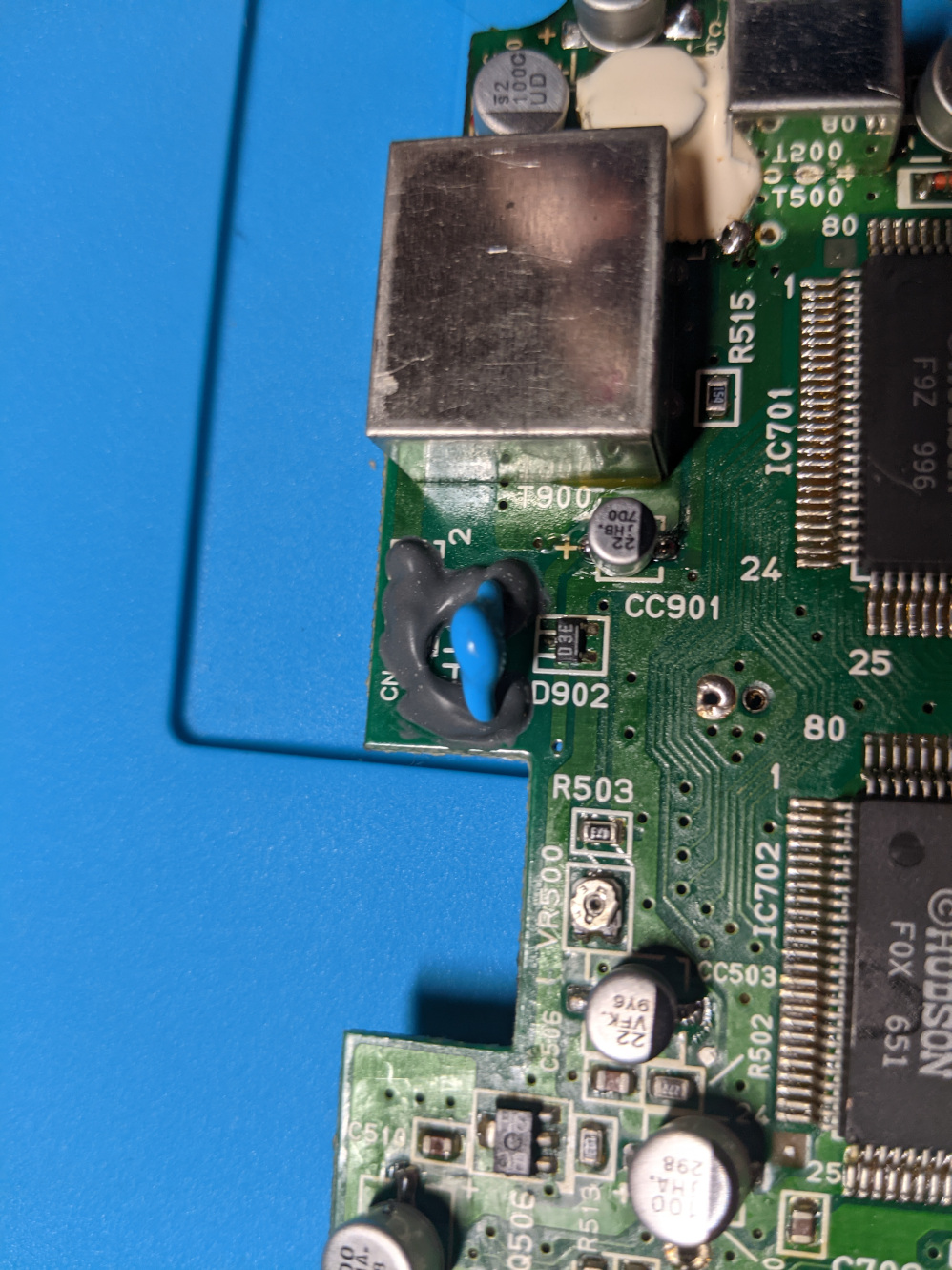

                                OK, I looked at the board a little more carefully, but still nothing obviously wrong stands out here.
                                So perhaps the most logical approach here would be to start with the inverter and see why the backlights are not turning On. This is going to be a bit challenging figuring out what components belong to the inverter on this board, due to it being multi-layer... but I think Q900 and Q901 should be the main transistors used for driving the backlights inverter transformer, T900.
                                One test you could attempt (if possible only) is to see what voltage each of the 3 pins on these transistors read relative to ground... though if that is not possible, then remove batteries and try testing these transistors (Q900 and Q901) with your multimeter on diode test. Run these combinations of diode/forward voltage testing so that we can hopefully figure out what they are (I imagine BJTs, but could be wrong):
                                - Pin 1 to 2 with red (+) multimeter probe on pin 1
                                - Pin 1 to 3 with red (+) multimeter probe on pin 1
                                - Pin 1 to 2 with black (-) multimeter probe on pin 1
                                - Pin 1 to 3 with black (-) multimeter probe on pin 1
                                - Pin 2 to 3 with red (+) multimeter probe on pin 1
                                - Pin 2 to 3 with black (-) multimeter probe on pin 1
                                Report back what values you get.
                                You can also test other transistors (labeled with Q) this way in the area if you like. Make note in particular if you see any low readings, like less than 100 mV (or 0.1V, whichever scale your MM uses.)
                                Another test you can try: scape the gray silicone sealant very minimally right where you see the text "Q902" and above the "2" in particular. Scrape only a little to allow you to touch/probe the solder joint + pin under it. Once you do that, set your multimeter to 2000 Ohms scale (or if it's auto-ranging, don't worry) and measure resistance between that and the two smaller pins directly above it right under the letter "R" from the label "R900". These three pins should be the high-voltage side output of the inverter, and generally those will measure at least a few hundred Ohms. Of course, do this measurement with the power off and batteries disconnected (this is standard for all resistance measurements.)
                                Also, could we see another picture with more detail in the area of the upper-right corner of this picture:
                                https://www.badcaps.net/forum/attach...1&d=1633662298
                                I think only components with 9xx numbers are related to the inverter, so I don't think T500 and surrounding components have anything to do with it... but would be good to double-check anyways.
                                  Hello and THANK YOU for the reply! I will try my best to do these tests next time I get to work on it, but I'm honestly leaning towards just doing a modern screen mod and bypassing that old backlight power circuit. I just wish I knew how to verify that the system is generating a video signal.... any thoughts on that?
                                  This picture seems to show that region, is that good enough?
                                  Actually, I've already ordered the screen mod kit (I'm impulsive and impatient), so I'll be trying it either way, but I could save myself some grief if I could verify the video works first. :-)
