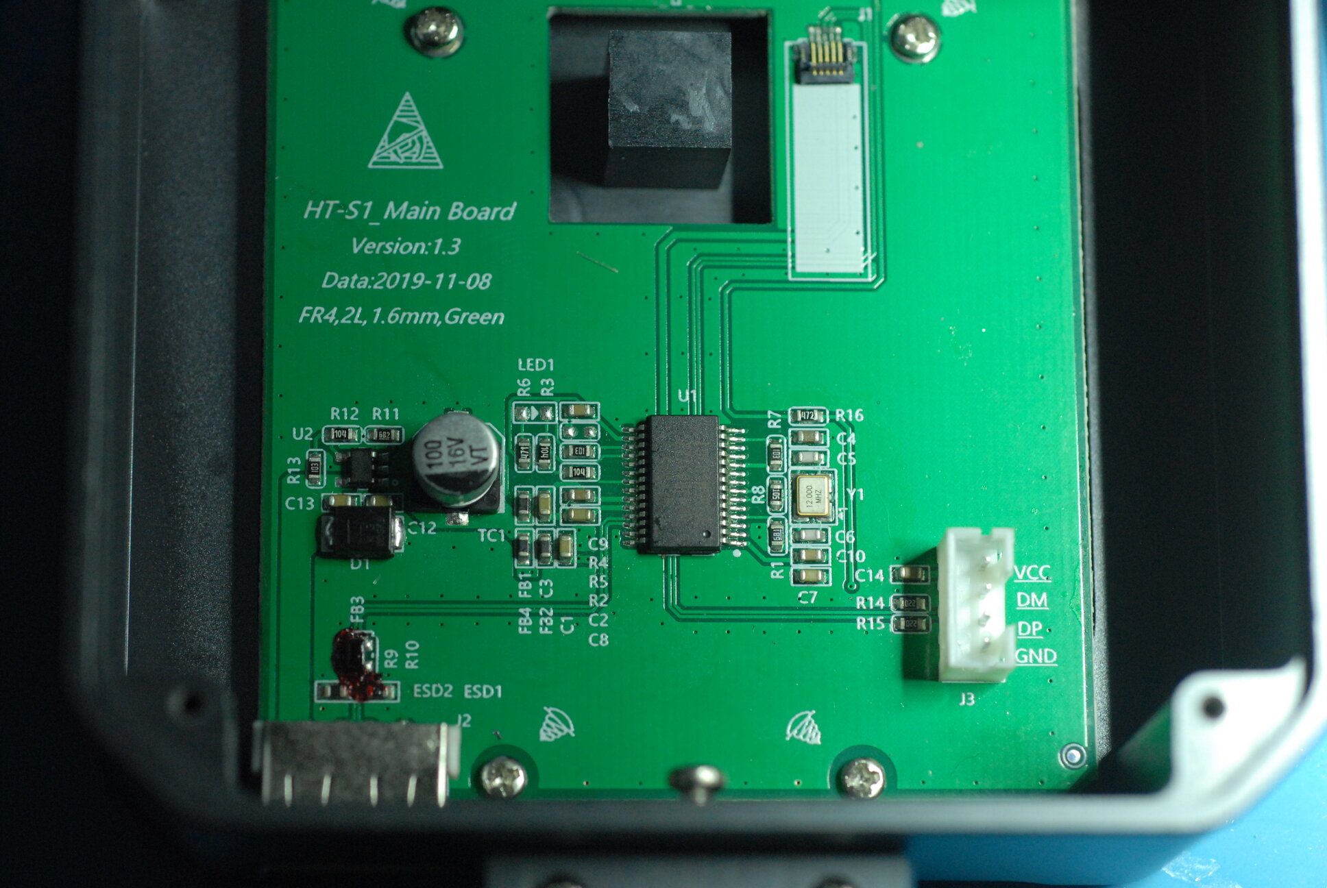

    I bought from aliexpress a thermal camera IRepair RC 10 and it does not work.
    Under Windows 10 it is impossible to install the driver. Under Linux s VID:PID defined in the driver SeekWare.inf is unknown, but we get the name of the devices, visible spectrum camera, infrared spectrum camera.
    A hardware problem is most likely.

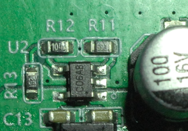

    In the datasheet of GL850G from Genesys logic ( HUB - Universal Serial Bus. ) it says QFN28/SSOP28 only supports 24C02.
    But instead we have a C06AB chip, datasheet not found.

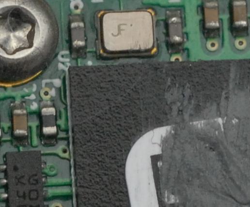

                      I had put aside the fault finding, for having already spent too much time on it. By approaching the research differently I focused only on the thermal spectrum camera, indeed I thought at first that the management of the two flows was managed downstream but it is not the case. Detecting a short circuit of very low intensity I focused on the chip covered by a sticker and thermal paste and in grazing light I discovered a crack that turns out to be a fracture.
                      It is a microcontroller based on the Cortex-M4 of Arm, NXP LPC43S30FET100
                      The deterioration of this component is very easy to explain, by the very design of the heatsink excrescence of the package.
                      Looking at the datasheet of the microcontroller everything is explained.
                      Unfortunately this component is no longer available, except by ordering several hundred.
                      I will look for discarded materials, it has been used a lot in medicine and in the automotive industry, it seems.

                        That GL850G may work fine without EEPROM.
                        C06AB is some voltage regulator,2.8V or 3.3V maybe.
                        Can you post some photo of damage?
                        You say LPC is cracked?
                        Those chips are pretty resistant vs PCB that is more fragile.
                        On that board there must be some SPI flash memory,by any chance can you read it and send me dump?

                          C06AB (COxxx) - SY6280

                            Indeed the GL850G hub can be used without EEPROM, and this is the case for this camera, EEPROM that does not exist.
                            Most likely C06AB is a voltage regulator, 2.8V or 3.3V.
                            Some time ago and by awareness I had changed the component GL850G and the capacitor 100uF 16V, but without effect.
                            The manufacturer of the camera has integrated an infrared camera from SeekThermal and another normal spectrum camera by managing both video streams, on a USB output.
                            This makes the choices and understanding of the operation clearer.
                            For better quality photos and I will try to make a macro-photo of the cracked component.
                            These chips are very resistant, but the design of the heat sink is aberrant and is the sure cause of the damage. You can see a protrusion that goes through the motherboard and comes in direct contact with the component, damped only by a plastic sticker and thermal paste.
                            I have not located any SPI flash memory, but maybe new eyes will be able to do it, I will make a new series of pictures.

                              SPI i was talking about is on Seek camera module.Other side of PCB with LPC chip.
                              I can't see clear crack on LPC chip,seems to be some v mark scraped or something like a check mark symbol but seems huge.
                              edit
                              So you have two USB camera via a USB hub and no one works or get detected?
                              You may try to bypass USB hub and connect somehow direct to USB port and see if thermal and optical camera works.
                                Thanks for the link.
                                It is indeed more coherent.
                                  The crack is very difficult to see, I have passed it many times under the microscope without seeing it.
                                  If you touch it with an instrument the corner moves.
