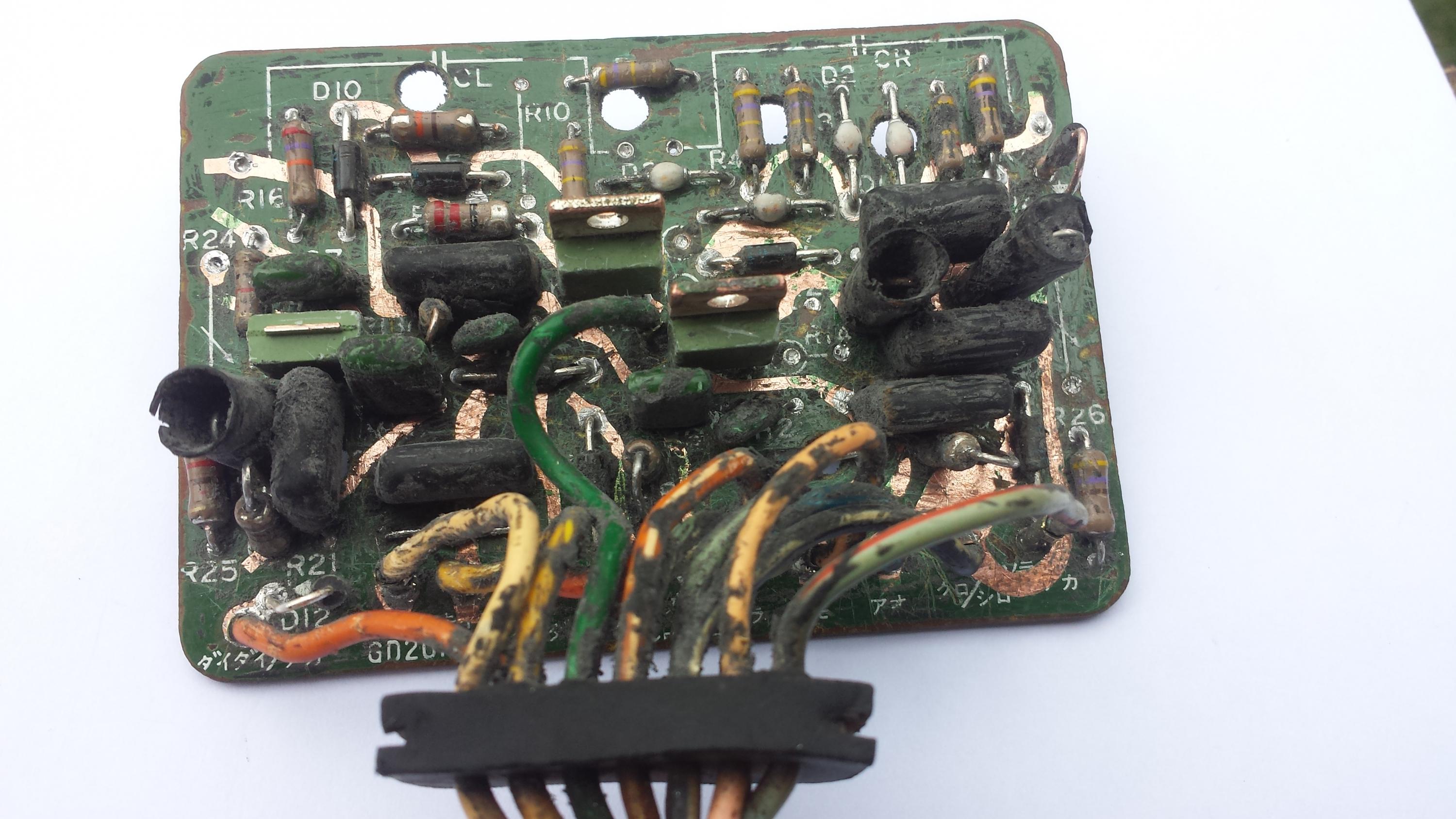

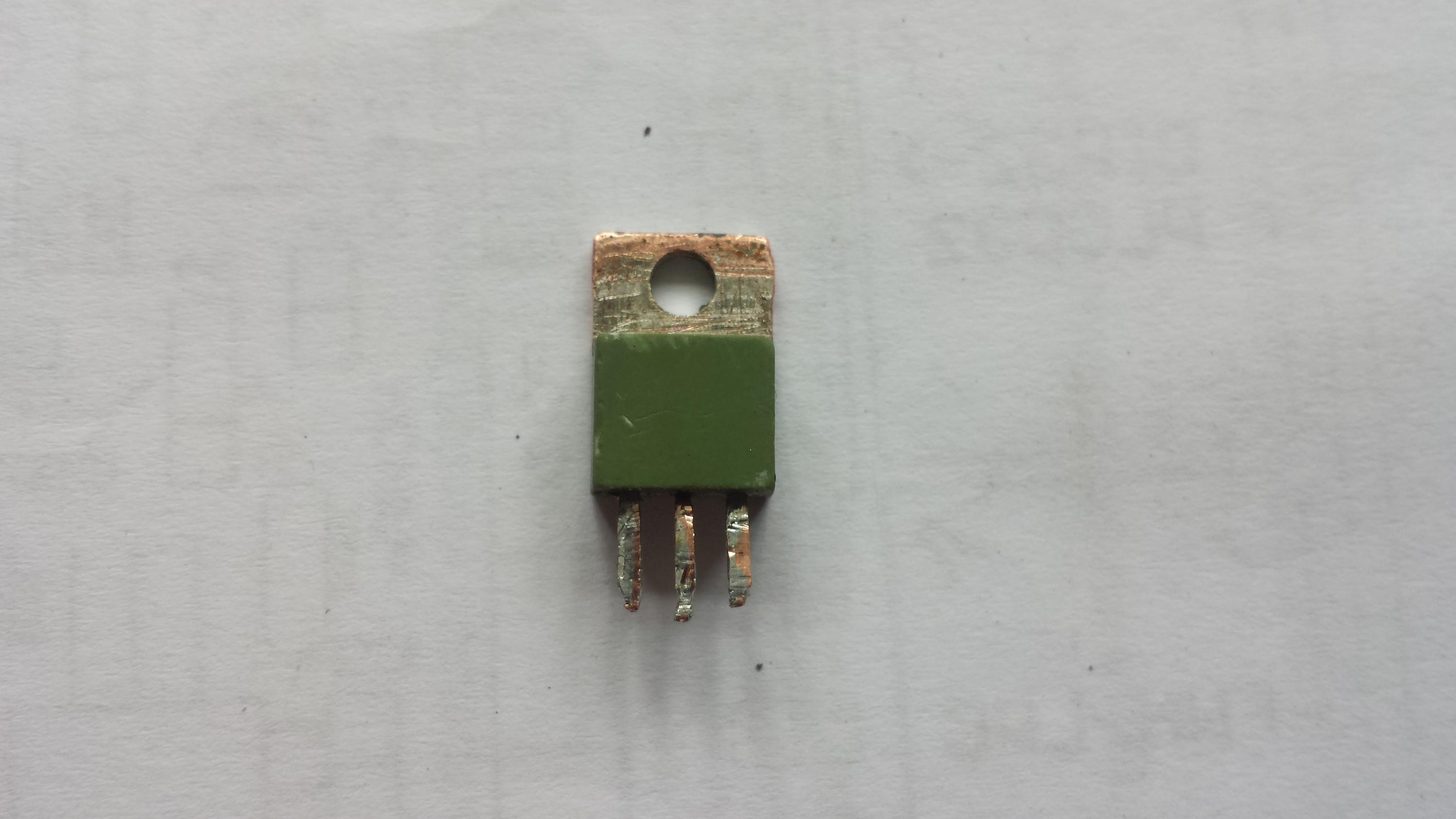

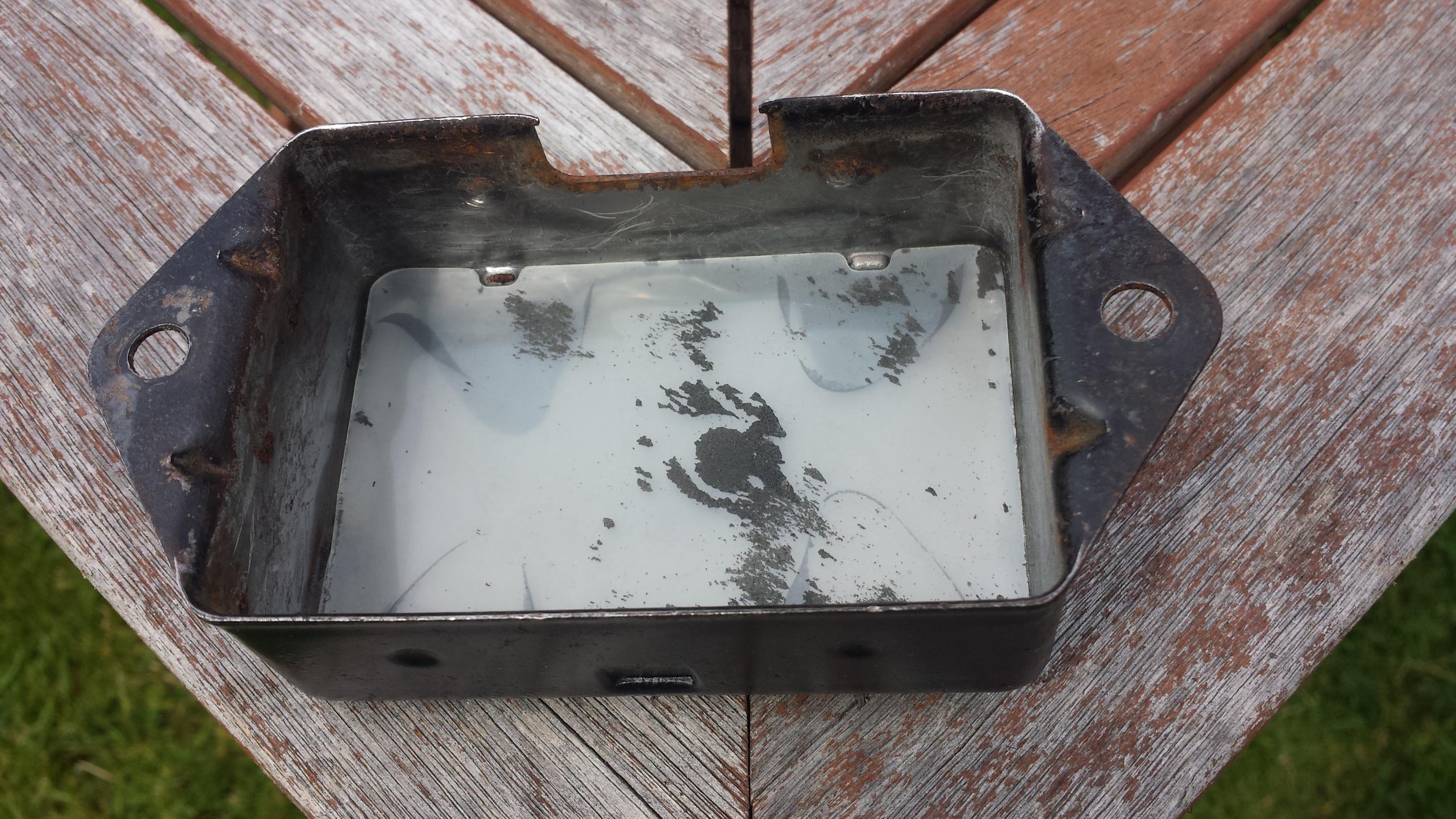

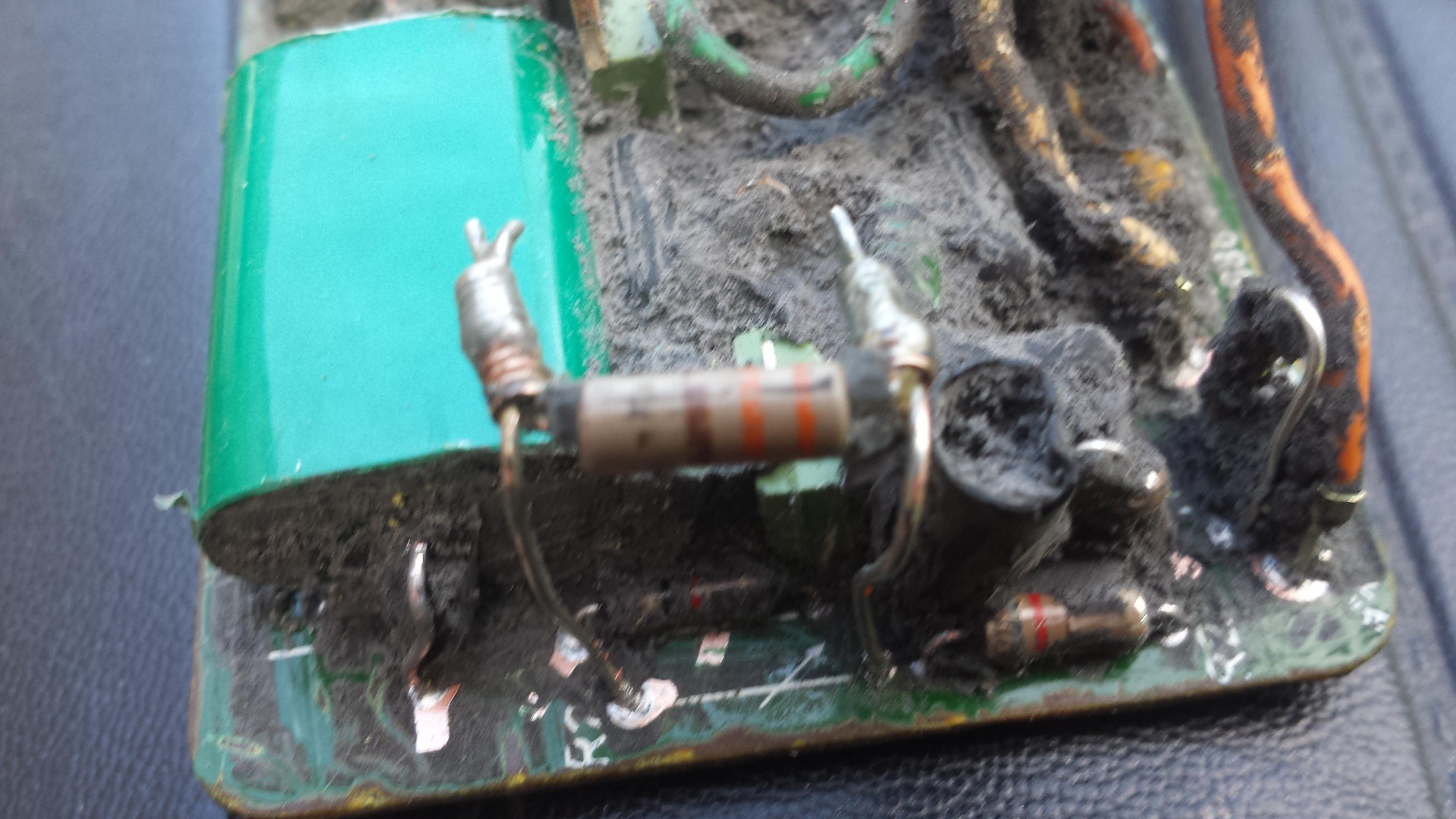

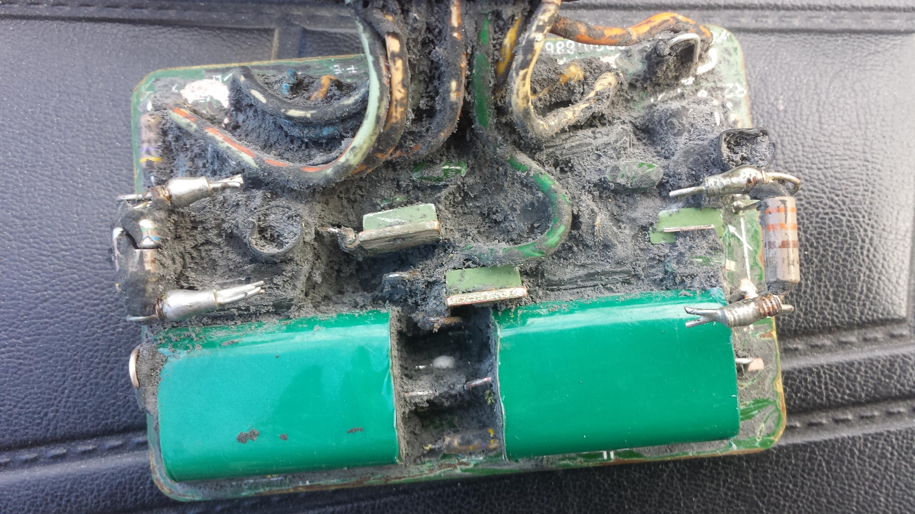

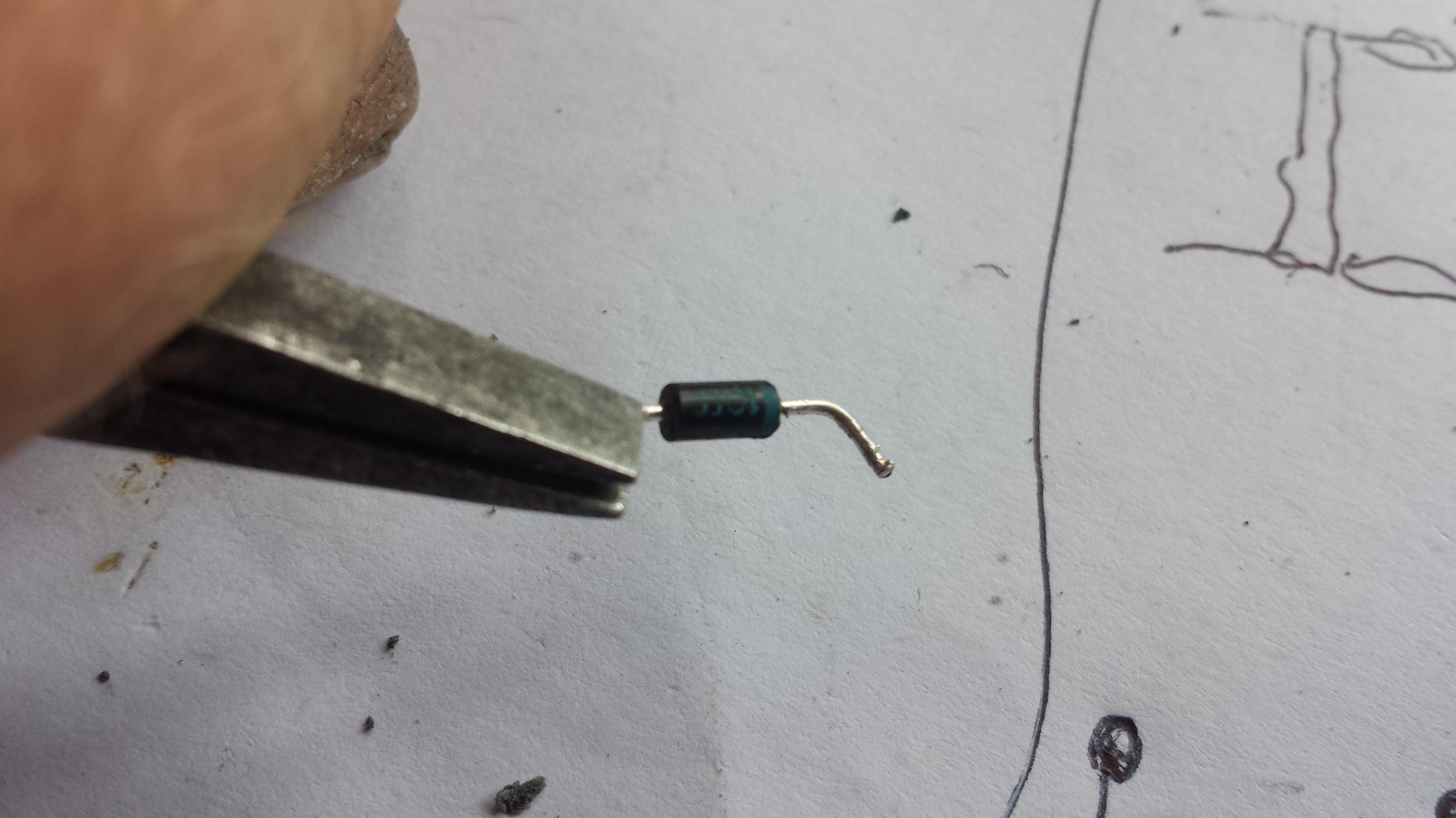

Honda CX500 Motorcycle CDI ignition unit
  • roadrash
    • Oct 2015
    • 490
    • U.K.
    Honda CX500 Motorcycle CDI ignition unit
    Hi everyone. Not a old computer monitor this timer its something a bit different.
    This is a CDI ignition unit from a 1980 Honda CX500.
    In 1980 all Japanese bike starting replacing the mechanical contact breaker points ignition system with these fully electronic Capacitive discharge units. But trouble is like all electronic components they fail with age and these CDI units are are no longer available. That's progress they say ??? Luckily I found a second hand one thats still working miraculously so can use that to get readings from.
    Not just that but these CDI units are placed in a steel box and then filled with a resin sealing them tight inside and away from water ingress. I was lucky this one had a slightly softer resin that was almost rubbery and I found I could pick at it with model knives and tiny screwdrivers. It took me 2 days to get it out and then pick away at it to reveal all the components. Many say the main reason these things fail is poor solder joints and they do look a bit rough.
    Well It was inevitable that a few things might get damaged removing all that resin and I broke 4 resistors and slight damage to one diode and one capacitor,
    Here are some photos of the unit at different stages.
    At each end of the board there was a strange twisted wire resistor thingy I have no Ideal of its purpose. There are a few transistors also but they have no markings.
    I managed to remove the resin from the bottom of it revealing the printed circuit as well.
    Please can anyone help me identify any of these parts apart from the obvious resistors etc. None of the caps are marked either but there are no electrolytic ones.
    I removed the two main output Capacitors to get access to the components underneath.
    Please please help guide me to getting this rebuilt with the faulty parts replaced as its the only way this bike will run when this current still ancient unit I am using also fails.
    I have uploaded more pictures at https://drive.google.com/drive/folde...2s?usp=sharing
  • petehall347
    • Jan 2015
    • 4442
    • United Kingdom
    Re: Motorcycle CDI ignition unit
    some copper traces look damaged .
    did you try petrol to remove the gloop ?
      • 31255
      Re: Motorcycle CDI ignition unit
      remove resin by heating it first, i have de-potted loads of protection devices on arcade boards that way.
      • roadrash
        • Oct 2015
        • 490
        • U.K.
        Re: Motorcycle CDI ignition unit
        some copper traces look damaged .
        did you try petrol to remove the gloop ?
        Yes I noticed there are a few myself. There are also a couple that look like broken tracks but they are not because if you zoom in you can see the green lacquer in the area that looks like a crack.
        I am still puzzled what those 2 strange resistor structures are at each end and what they do.
        • roadrash
          • Oct 2015
          • 490
          • U.K.
          Re: Motorcycle CDI ignition unit
          Originally posted by stj
          remove resin by heating it first, i have de-potted loads of protection devices on arcade boards that way.
          Thanks for that stj. You are right when i once tried to do a old honda superdream cdi which had the hard type of resin and I was able to remove it by heating it with a tiny jewelery blow torch and it goes crumbly.
          Can you enlighten me stj as to the purpose of these 2 resistor structures and each end do.
          • petehall347
            • Jan 2015
            • 4442
            • United Kingdom
            Re: Motorcycle CDI ignition unit
            am guessing they run hot
            • redwire
              • Dec 2010
              • 3912
              Re: Motorcycle CDI ignition unit
              I have helped people reverse engineer these, they can get weird because of the Japanese design and the many patents that were out there back in the day.
              What part numbers do you have for it? Usually other engines got the same (family) of module. It's a lot of work to recreate one.
              The oddball resistors up in the air are likely for setting the ignition timing advance curve for the module, to match it to the engine and its crank pickup. The PCB shows one as R2 trimpot but the factory just soldered in those parts.
              The green TO-220 parts are likely Hitachi SCR's. The green HV caps around 1.5uF 400V.
              Drawing a schematic is the first step, it's mostly the same circuit 2X.
              I don't know the bike's wiring, if it's an exciter coil plus trigger coil or what.
                • 31255
                Re: Motorcycle CDI ignition unit
                the resistor stacks could be a heat thing, was this in an aluminium shell?
                • roadrash
                  • Oct 2015
                  • 490
                  • U.K.
                  Re: Motorcycle CDI ignition unit
                  Originally posted by redwire
                  I have helped people reverse engineer these, they can get weird because of the Japanese design and the many patents that were out there back in the day.
                  What part numbers do you have for it? Usually other engines got the same (family) of module. It's a lot of work to recreate one.
                  The oddball resistors up in the air are likely for setting the ignition timing advance curve for the module, to match it to the engine and its crank pickup. The PCB shows one as R2 trimpot but the factory just soldered in those parts.
                  The green TO-220 parts are likely Hitachi SCR's. The green HV caps around 1.5uF 400V.
                  Drawing a schematic is the first step, it's mostly the same circuit 2X.
                  I don't know the bike's wiring, if it's an exciter coil plus trigger coil or what.
                  I believe that this is made by Hitachi and has a part number in its case TIA02-14.
                  • roadrash
                    • Oct 2015
                    • 490
                    • U.K.
                    Re: Motorcycle CDI ignition unit
                    Originally posted by stj
                    the resistor stacks could be a heat thing, was this in an aluminium shell?
                    No this was in a steel shell like this
                    • roadrash
                      • Oct 2015
                      • 490
                      • U.K.
                      Re: Motorcycle CDI ignition unit
                      Here are a few more pictures of the components. The transistors have no markings but some of the caps have very feint ones. One seems to be showing 40mv/ 0.04.
                      I am trying to make a component list right now 1st. There is no reason . I have found once most of the resin is removed surgical spirit softens the residents so it can be wiped off the part.
                      Last edited by roadrash; 06-11-2021, 07:42 AM.
                        • 31255
                        Re: Motorcycle CDI ignition unit
                        put the green to220 devices in a component tester
                        do you have a wiring diagram for the bike btw?
                        • roadrash
                          • Oct 2015
                          • 490
                          • U.K.
                          Re: Motorcycle CDI ignition unit
                          also have this little green thing that looks like a ceramic capacitor and has the number 351 on it. My component tester says it's resistor with value 331.4 ohms is this right?
                          There is a diode to that's tests ok but is this any special type? It has the markings 100 76 and 1R
                            • 21932
                            Re: Motorcycle CDI ignition unit
                            (off-topic) The old CX500 flying maggot , a friend of mine had one of those
                            • dmill89
                              • Dec 2011
                              • 2534
                              Re: Motorcycle CDI ignition unit
                              Originally posted by SMDFlea
                              (off-topic) The old CX500 flying maggot , a friend of mine had one of those
                              Yep, the CX line was interesting with a longitudinal V-twin and shaft drive, kind of like a Honda version of a Moto-Guzzi, except water-cooled and reliable (at least by the standards of the time). My dad had it's big brother (the CX-650) back in the 80s/early-90s.
                                • 31255
                                Re: Motorcycle CDI ignition unit
                                351 could be a cap or a temperature sensitive resistor of some type to limit current.
                                  • 21932
                                  Re: Motorcycle CDI ignition unit
                                  Found a schematic and a bit of info .
                                  http://rajamolor.blogspot.com/2008/0...schematic.html
                                  https://motovillage.org/wiki/hondacx...=CDI_Schematic
                                  https://docs.google.com/viewer?a=v&p...FlNWQzYTA3YWM1
                                  • redwire
                                    • Dec 2010
                                    • 3912
                                    Re: Motorcycle CDI ignition unit
                                    The tricky part will be the thermistors. You would have measure their resistance at a few different temperatures to find something that matches. As the SCR's heat up, their sensitivity goes up and the thermistor lowers how much gate drive they get.
                                    I did see a remake of the box called Finnbox G47, the thermistors are on the SCR's tabs.
                                      • 31255
                                      Re: Motorcycle CDI ignition unit
                                      maybe re-designing it to use mosfets is the answer.
                                      or darlingtons
                                      • roadrash
                                        • Oct 2015
                                        • 490
                                        • U.K.
                                        Re: Motorcycle CDI ignition unit
                                        Originally posted by stj
                                        put the green to220 devices in a component tester
                                        do you have a wiring diagram for the bike btw?
                                        yes here is what the tester says.
                                        • ngml
                                          Repair of an LG split AC system indoor unit PCB
                                          by ngml
                                          I am trying to repair an LG split AC indoor unit, which does not start and gives a CH05 error code.
                                          This indicates an error in the communication between the outdoor and the indoor unit.
                                          The outdoor unit is fine, so the problem is the indoor PCB.
                                          The indoor unit is an LG PC09SQ NSJ (3SNM09JA2FA), and the PCB has the following type number: EAX35907219-1.2 (see photo1)
                                          I changed optocouplers ICO1X & ICO2X and the NPN transistor S9013 which drives optocoupler ICO2X (see photo2), but this did not remedy the fault.
                                          Does anybody have the schematics of this board,...
                                          02-01-2025, 12:55 PM
                                        • CoinCoin88
                                          Garage door RX unit (Cardin S38C) does not short relay to send opening signal
                                          by CoinCoin88
                                          I'm turning to the Badcaps community to help me troubleshoot the radio Rx card from my (old) garage door opener. While I could just ditch that card and replace the whole system, I first would like to understand "why" it suddenly stopped working, because that's just how I am wired...!
                                          Some basics: the receiver works on a 30.875 Mhz frequency. Yes, I'm aware this is not in use anymore in a looot of places. It does not use any rolling code, it's just a regular dip-switch code that you have to set up on both the receiver and transmitter. The receiver...
                                          09-15-2025, 03:36 AM
                                        • DrDos
                                          Unit runs but no speaker output kenwood KR-6030
                                          by DrDos
                                          I have finished my work. The new lights come on except the one for stereo, I reversed the bulbs to no affect, anyway, the unit powers on, relay clicks. I have no DC voltage in speaker outputs, I also do not have any AC in the speaker outputs. There is some faint crackling in the speaker. This unit cranks up loud so I had the volume on very low. Everything seems to be fine but I can't really check the switch until I can get sound out of the outputs. I was going to do caps for the power supplys and the tone board but thought if it was cranking loud at one time maybe just leave it alone until it...
                                          09-14-2025, 09:57 PM
                                        • roadrash
                                          Motorcycle flasher mystery.
                                          by roadrash
                                          usually get help on here for computers and monitors etc but I thought you guys are the best I can think off to help me solve a real mystery.
                                          I have a Honda NT650V bike and recently fitted a towbar to tug a little trailer sometimes.
                                          Everything was good until I connected up the trailer socket.
                                          The problem is whenever I use the direction indicators/flashers it causes a misfire as soon as I cancel the flashers the misfire stops. The bike without the trailer lights attached is fine.
                                          .So far Ive tried the following:
                                          1) I replaced the battery for a higher A/h original...
                                          04-28-2022, 05:29 AM
                                        • nobbnobb1
                                          Bose Companion 5 - Unit Powers On then Cuts Off Shortly After
                                          by nobbnobb1
                                          Hi guys,
                                          Trying to salvage a Bose Companion 5 computer speaker system that powers off shortly after powering on. It's got a primary USB input (built in DAC) and an aux 3.5mm input. The USB appears to be the primarily source that tells the unit to power on (control pod LED goes green) as the unit has no power switch.
                                          When I first connect power to the unit, plug in the USB, it will play audio nicely for a minute before it drops out and the unit appears to go into standby (control pod LED goes red). It stays in standby and I cannot seem to power it back on without physically...
                                          02-03-2022, 11:14 AM
