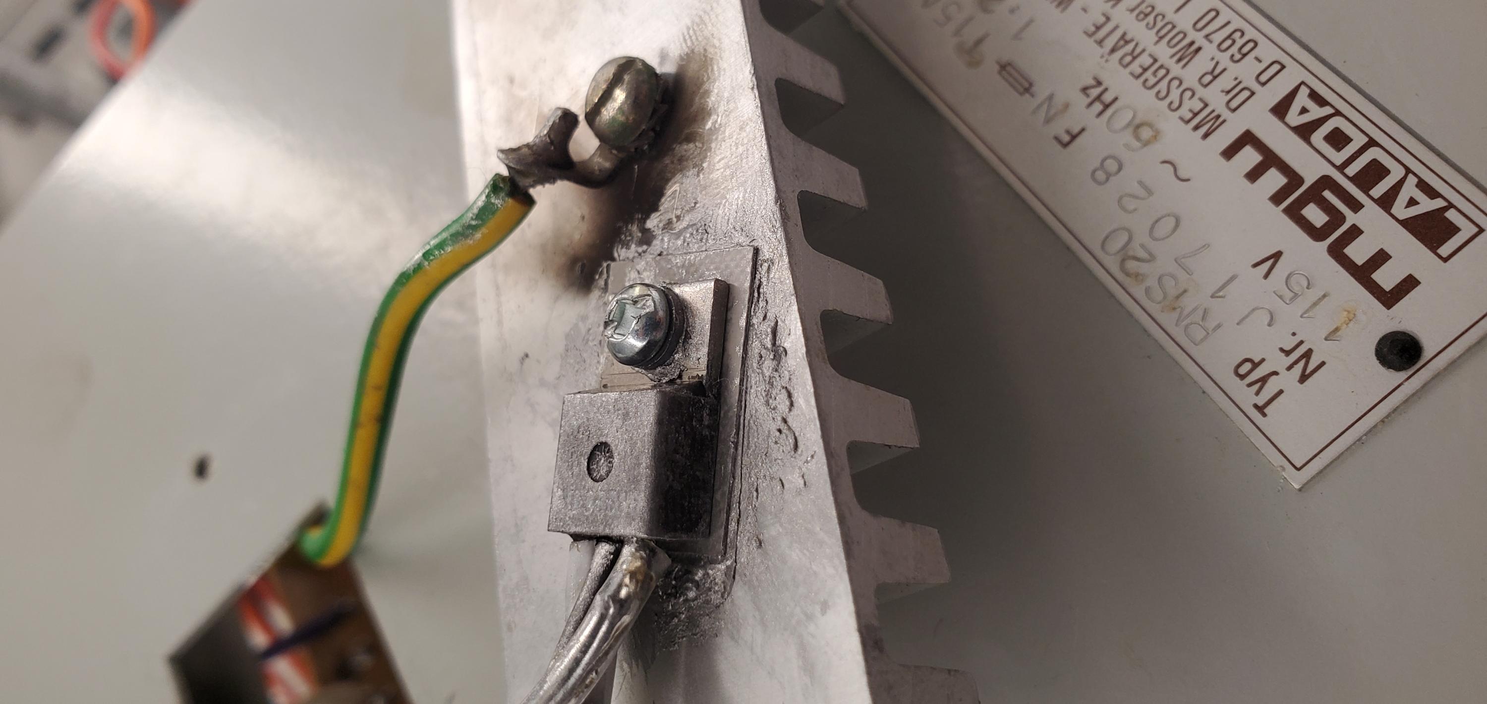

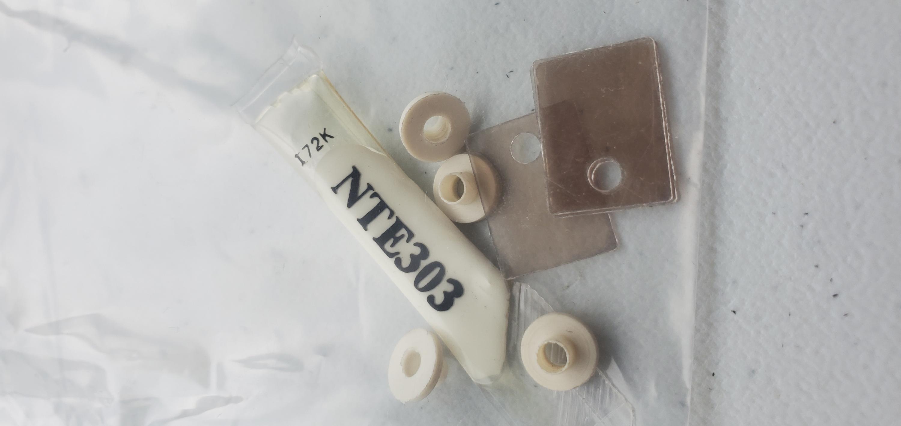

Fixing a laboratory waterbath
  • vrasp
    • Nov 2019
    • 194
    #281
    Re: Fixing a laboratory waterbath
    Originally posted by eccerr0r
    Well you're right it is MT1 MT2 Gate, but sorry, no additional clues why it's frying. You're on your own.
    That's ok. You ve already helped a lot!
      • Jul 2011
      • 6070
      #282
      Re: Fixing a laboratory waterbath
      Like I said earlier in a post you need to know if you are getting a signal from the controller to the triac and it is controlling the triac if it not then you need to figure out what is not working
      Or get something like this
      https://www.ebay.com/itm/22210532801...53.m1438.l2649
      And manually control the temperature and simplifies this setup if you can not figure out how to fix it
      Or get a temperature sensor controller and control the temperature that way
      Also you can do the compressor controller the same way use a temperature controller for this part as well and do way with the controller it has now but it going to take some work on your part and Google for the different controller that you need for this project
      If I can help you figure out what might work for you I would gladly help you as much as I can
      Last edited by sam_sam_sam; 07-28-2021, 05:06 PM.
      • vrasp
        • Nov 2019
        • 194
        #283
        Re: Fixing a laboratory waterbath
        Originally posted by sam_sam_sam
        Like I said earlier in a post you need to know if you are getting a signal from the controller to the triac and it is controlling the triac if it not then you need to figure out what is not working
        Or get something like this
        https://www.ebay.com/itm/22210532801...53.m1438.l2649
        And manually control the temperature and simplifies this setup if you can not figure out how to fix it
        Or get a temperature sensor controller and control the temperature that way
        Also you can do the compressor controller the same way use a temperature controller for this part as well and do way with the controller it has now but it going to take some work on your part and Google for the different controller that you need for this project
        If I can help you figure out what might work for you I would gladly help you as much as I can
        I haven't worked on it since last time. I ll check tomorrow or Friday if there is a signal from the controller. I do like the SCR voltage regulator idea. I might do that if I really cant figure it out. There is already a temperature sensor that works so I just need to control the heating.
        Thanks for the help! It's greatly appreciated.
        • vrasp
          • Nov 2019
          • 194
          #284
          Re: Fixing a laboratory waterbath
          I think I finally got to the bottom of this.
          I plugged the waterbath to the wall (no bulb in series) and got a short on MT1. The 15A fuse didn't even blow but the circuit breaker of the laboratory did. I thought the fuse would blow before the circuit breaker. I don't know why that was not the case. Anyways, I decided to remove the TRIAC from the heatsink and left it hanging without touching anything. Then I turned the waterbath on and this time there was no short and the lamp in place of the heating element turned on.
          I then put the TRIAC back on the heatsink, this time with two mica. Now everything seems to be working fine (lamp turns on). I have no tried it with the heating element yet.
          I had measured the resistance of TRIAC with the heatsink and screw and got max values even at 2000k Ohms. Obviously the TRIACs that blew must have had some continuity with ground. This surprises me. How do I know I can trust the measurements? My leads are clean and I was careful when taking those measurements.
          Next step is to connect the heating element and make sure the water heats up.
          Last edited by vrasp; 07-30-2021, 02:54 PM.
          • petehall347
            • Jan 2015
            • 4445
            • United Kingdom
            #285
            Re: Fixing a laboratory waterbath
            obviously it was shorting to the heat sink by the way its burned the aluminium check the earth connection as it looks burned . i would drill and tap a new screw hole and move the triac to a flat bit .
            • eccerr0r
              Solder Sloth
              • Nov 2012
              • 8703
              #286
              Re: Fixing a laboratory waterbath
              Sigh...so it turns out something silly... If we can't trust measurements, what can we trust...
              dirty probes? Probes have sharp points for a reason - to dig through thin oxide layers.
              Using two insulators, though better electrically, is significantly worse thermally. Usually TO-220s can handle at most about 2W without a heatsink. For TRIACs this means you can pass about 2A before you fry it when not attached to a heatsink.
              Also are you using conductive thermal paste? Don't, or don't bother with thermal paste at all. Wish I could trade you this ZnO heatsink compound I have, I'm still waiting for "gray" heatsink compound to see if it's better for my CPUs...
              • vrasp
                • Nov 2019
                • 194
                #287
                Re: Fixing a laboratory waterbath
                That transparent mica that comes with the TRIAC is not enough, or no good. I ll try with just the other mica that I bought separately instead of both.
                I didn't check the tube but I m pretty sure it's the regular kind. It was $4. The metal based ones are more expensive I believe. I ll have to double check the label.
                Like I said in a previous post, even putting both probes on the heatsink gives me no continuity. But everything else gives me proper measurements. That's what I find confusing.
                I didn't realize it could fry with so little. I guess if I had tried with the heating element right away I would ve fried it.
                • eccerr0r
                  Solder Sloth
                  • Nov 2012
                  • 8703
                  #288
                  Re: Fixing a laboratory waterbath
                  If you perhaps created some shrapnel that could have pierced through the insulator, but I've never had this happen. Never had a TO220 short with the heatsink when I have all the correct hardware installed.
                  As petehall347, you might have to end up selecting a new, clean site. But try with no heatsink compound unless it's known to be insulating (like "White" ZnO) first. Use the sharp probes to scratch into the paint and oxide coatings on metals to ensure you get a good contact.
                    • Jul 2011
                    • 6070
                    #289
                    Re: Fixing a laboratory waterbath
                    I have found that some plastic spacer have an issue with the way you install them the plastic is very thin and if you use the wrong type of screw then you can cut the plastic and short out to the heat sink and like what was mentioned earlier about the heat sink compound you have to use the right type and if you only paid $4.00 for it and it more than a couple of ounces then you got some real crap compound because when I buy heat sink compound I pay about $20.00 for a tube
                    Here is the one I use
                    https://www.mpja.com/Heatsink-Compou...info/30389+MG/
                    I have use this product for years and not had an issue with it
                    Last edited by sam_sam_sam; 07-30-2021, 10:15 PM.
                    • vrasp
                      • Nov 2019
                      • 194
                      #290
                      Re: Fixing a laboratory waterbath
                      What if I clean off the surface and sand it with some 3000 grit sandpaper? I d like to avoid drilling a new hole.
                        • Jul 2011
                        • 6070
                        #291
                        Re: Fixing a laboratory waterbath
                        You need to use a scotch-brite-heavy-duty-scour-pad pad that you can find in the grocery store it one that is green in color do not use sand paper ( unless you use a block of wood that has a very flat surface and it must be very fine grade ) it will make it uneven and you will not have the heat transfer
                        https://www.zoro.com/scotch-brite-he...28/i/G4676353/
                        They also make polish pad that you can put on your drill or die grinder
                        https://www.harborfreight.com/pack-o...scs-99985.html
                        You must make sure that you have NO connection to the heat sink from the device pins or the mounting tab this a must or you keep burning up triacs
                        Just in case you are not sure how to do this the correct way I am not trying to be an a** about this
                        When you put the plastic spacer to the triac it is the smaller end that goes through the metal tab of triac the head of the screw must be on the plastic flat part of the spacer you must use the nonconducting thermo pad under the triac metal tab and you put thermal heat sink compound on the thermal pad to the triac and you put on the heat sink as well one note you only need a small amount of heat sink compound on the metal tab to the thermal pad only you do not need to smear it on the thermal pad on the side of the triac the side that is the heat sink side needs to cover the thermal pad completely
                        Last edited by sam_sam_sam; 07-30-2021, 10:42 PM.
                        • eccerr0r
                          Solder Sloth
                          • Nov 2012
                          • 8703
                          #292
                          Re: Fixing a laboratory waterbath
                          new hole is unlikely going to fix the problem.
                          BTW that plastic shoulder washer... if you're screwing the screw in, the screw is too big. The screw should slide into the plastic.
                          The screw screws into the heatsink so it will be grounded. The heatsink should have an small air gap or the insulator material between it and the metal tab.
                          • eccerr0r
                            Solder Sloth
                            • Nov 2012
                            • 8703
                            #293
                            Re: Fixing a laboratory waterbath
                            TBH the only thing that makes sense ASSUMING you assembled the TRIAC properly is that your heatsink compound is conductive or you somehow have shrapnel on the screw.
                            Actually I'd have to say: since you're using an insulator sheet (mica, kapton, or silicone), don't use any heatsink compound at all, especially if you don't know if it's conductive or not. These materials are soft enough to expel air bubbles, just do not overtighten the screw (5-10 inch-lbs is sufficient). Make sure it's cleaned off of all old compound. Clean off any metal debris you can see.
                            Mica is clear, brittle, and cleaves little shards. Kapton is orange and flexible. Silicone is gray and rubbery.
                            Again use the sharp points of the multimeter in the highest resistance range to check the dielectric. Make sure your meter is actually working too... Scrape the top side of the metal tab of the TRIAC and check against the screw.
                            Last edited by eccerr0r; 07-31-2021, 07:55 AM.
                            • vrasp
                              • Nov 2019
                              • 194
                              #294
                              Re: Fixing a laboratory waterbath
                              That thermal compound had no label so I have no idea if it's conductive.
                              I just got back from the store with some NTE ZnO thermal compound, a few mica (they re thicker than the one provided with the TRIAC), and while I was there I also got some more washers. I love this store - they have everything!
                              The plastic washer I have works fine, it slides into the screw like you said. The screw didn't touch the TRIAC at all. I think everything was correctly assembled so it has to be something with the thermal paste or a damaged mica.
                              With all of this, I should be good to go. I'll clean the heatsink of the old thermal compound, scrub it with the scotch-brite pad, and assemble it all.
                              Last edited by vrasp; 07-31-2021, 01:40 PM.
                              • eccerr0r
                                Solder Sloth
                                • Nov 2012
                                • 8703
                                #295
                                Re: Fixing a laboratory waterbath
                                You probably could just stick your multimeter probes into the heatsink compound and see if there's any conductivity.
                                No need to scrape or scrub the heat sink, just need to make sure the surfaces are flat and rid of any shrapnel that might be large or sharp enough to damage the insulator. Again don't bother with thermal compound for now. And the main reason for not torquing down the screw more than a foot pound or so is to prevent warping, along with not damaging the insulator.
                                • vrasp
                                  • Nov 2019
                                  • 194
                                  #296
                                  Re: Fixing a laboratory waterbath
                                  Originally posted by eccerr0r
                                  You probably could just stick your multimeter probes into the heatsink compound and see if there's any conductivity.
                                  No need to scrape or scrub the heat sink, just need to make sure the surfaces are flat and rid of any shrapnel that might be large or sharp enough to damage the insulator. Again don't bother with thermal compound for now. And the main reason for not torquing down the screw more than a foot pound or so is to prevent warping, along with not damaging the insulator.
                                  Sounds good. I ll do that this coming week.
                                  • vrasp
                                    • Nov 2019
                                    • 194
                                    #297
                                    Re: Fixing a laboratory waterbath
                                    I was going to mount the TRIAC with the new thicker mica I got. However, I can peel the layers off. I initially thought that there was a sticky part to stick to the TRIAC or something like that but below each peeled layer was another layer that is easily peeled. I added a photo below with a "full" mica and one peeled into it's layers. Anyways, not knowing if this was normal, I decided to use the other isolator I have which I believe is Silicone or Kapton.
                                    I cleaned off the surface of the TRIAC and heatsink and used the new washers I got. Checked for resistance, everything was good (max resistance between the metal tab and heatsink/scew). Turned everything on and it worked!
                                    I then proceeded to resolder the heating element instead of the lamp. Turned on the waterbath and the water heated as it should. It took about 20 min to go from 20 °C to 40 °C. I then proceeded to measure the TRIAC temperature with an infrared thermometer. After 20 min of heating, the TRIAC temperature was approx. 80 °C to 90 °C depending on where I point the laser. The datasheet mentions temperatures from -40 °C to +125 °C so it should be good. I assume that the TRIAC reaches it's operating temperature quickly and that this temperature stays more of less constant over time (assuming constant room temp) because the current going through is always the same. In other words, leaving the waterbath on for 20 min or 24 hours should not have a significant effect on the temperatures I measured. Can someone confirm that?
                                    There are two other minor issues that I believe are due to bad soldering. The first one is that the display is missing some LED bars that show the numbers and also the dot for decimals (it's still readable so no big deal if I cant fix that). I had changed the ICL a while ago and have to check each pin is properly soldered on its pad. The other minor issue is that I sometimes have to turn the waterbath on - off then on again for the display to show the temperature. So the first time I turn it on the display turns on but doesnt show numbers (just a some LED bars are on) then if I turn it off and on again it shows the proper temperature and it's good to go. Again, it probably has to do with bad soldering. I ll have to double check all the connections.
                                    Thanks for your help guys.
                                    • eccerr0r
                                      Solder Sloth
                                      • Nov 2012
                                      • 8703
                                      #298
                                      Re: Fixing a laboratory waterbath
                                      No you don't want to peel mica, it's one of the characteristics that it can be split very thinly. And no there's no adhesive layer. Though thinness helps heat conduction, it also encourages shorts so you want to use full thickness. And peeling it, as you assumed, ruins it - so don't use the peeled version.
                                      Question is how hot is the heatsink getting versus the TRIAC. At 90°C I'd think it's on the warm side though it's within limits. Rule of thumb is that if you can't keep your thumb on it, it's too hot. However don't do that as it's electrically live and you could get electrocuted. If the heatsink is also getting warm then you can probably leave it; if the heatsink stays cold then you might want to tighten the screw a bit more or look into heatsink paste.
                                      Last edited by eccerr0r; 08-03-2021, 11:44 AM.
                                      • vrasp
                                        • Nov 2019
                                        • 194
                                        #299
                                        Re: Fixing a laboratory waterbath
                                        I did do that. I can keep my thumb on the heatsink but it's definitely hot. I did a quick measurement but didn't write it down. I think it was around 60 °C. What I m worried about is reducing the TRIAC lifetime if it gets too hot. Do you think 90 °C is ok or should I try with some ZnO thermal paste? There isn't much else I can do. The TRIAC is tight on the heatsink.
                                        • eccerr0r
                                          Solder Sloth
                                          • Nov 2012
                                          • 8703
                                          #300
                                          Re: Fixing a laboratory waterbath
                                          It's probably the way it is. 90°C is hot, but it could be hotter.
                                          Also have to consider, is it hot when the heater/TRIAC is "off"? Should get some reprieve when the heater is off as it shouldn't be on 100% of the time.
                                          Is the heater heating as fast as it was before? Perhaps the TRIAC you got is a fake?
                                          • learnmore
                                            Help choosing replacement transformer for Levoit 600S SMPS
                                            by learnmore
                                            Hello Community,
                                            I'm attempting to repair the SMPS on a Levoit 600S air purifier. The transformer is likely open. It has six pins. 2 pairs on the primary side (one pair tested open) and 1pair of legs on the secondary side. Legs on the secondary side are spread wide apart (end-to-end). I've circled them in blue. Dimentons of the transformer are 22x23mm. Marking on the transformer are EE16 1.9mH-B. Fuse for the powerboard is fuse 250V 3.15A. I've been unable to find an exact match and I'm hoping for some help here to find a suitable replacment.
                                            Peace
                                            LM...
                                            Yesterday, 09:35 AM
                                          • ohren
                                            Original Xbox 1.0 PSU: Foxlink FTPS-0002 Rev. B. — 12 V low, 5 V high — transformer?
                                            by ohren
                                            Hello!
                                            I'm looking at an original Xbox PSU: Foxlink ftps-0002 rev. B. The 12 V output is too low, and the 5 V output is too (?) high. Unfortunately I don't have an oscilloscope but only a DMM for diagnosis.
                                            Measured voltages with no load:
                                            After rectifier diodes
                                            12V: 6.17 V
                                            5V: 5.67 V
                                            Secondary transformer pins AC measurement (really don't know if this says anything)
                                            12V: 2-2.5 V
                                            5V: 1.04 V
                                            I also have another (working) Xbox psu from Delta. The same measures there, in order, being: 10.79,...
                                            03-18-2023, 10:33 AM
                                          • mikey5791
                                            Is it possible for transformer substitution?
                                            by mikey5791
                                            Got this local made DC power supply (12/14V) given free as the transformer has melted. There is no marking or indication to identify what type or rating of transformer used.
                                            Fyi,. I had a busted autogate mainboard with transformer with marking 13-0-13 . Is this the 13v dc type transformer?
                                            My questions are
                                            1. How do i test to see if the transformer is in good working condition?
                                            2. Can this transformer (marking 13-0-13) be used to replace the melted transformer on the DC power supply?
                                            Hope you guys understand what i was asking. My intention is...
                                            11-03-2022, 02:11 AM
                                          • dennis_elx33
                                            3PHASE STEP-DOWN Transformer in Check
                                            by dennis_elx33
                                            Hello All,
                                            i would like to post an interesting topic regarding 3-phase stepdown transformer which we suspect to cause an overcurrent (138A) which resulted to power tripped off of the HV power supply (80KV output).
                                            Problem statement: Power tripped Off
                                            Initial Problem: Found 2 IGBT and 2 rectifier diodes shorted (burnt).
                                            Action Done:
                                            1) Replaced the faulty parts with good spare.
                                            2) Measured impedance of the 3phase input lines and found that L2 to L3 has 23.3ohm while other pairs are 51Kohm. This pins will...
                                            12-02-2024, 06:52 AM
                                            ASUS Transformer T101HA - X5DHD Hybrid (2-in-1) Book Specification for Upgrade or Repair
                                            This specification for the ASUS Transformer T101HA - X5DHD Hybrid (2-in-1) can be useful for upgrading or repairing a laptop that is not working. As a community we are working through our specifications to add valuable data like the T101HA - X5DHD boardview and T101HA - X5DHD schematic. Our users have donated over 1 million documents which are being added to the site. This page will be updated soon with additional information. Alternatively you can request additional help from our users directly on the relevant badcaps forum. Please note that we offer no warranties that any specification, datasheet,...
                                            09-06-2024, 04:40 PM
