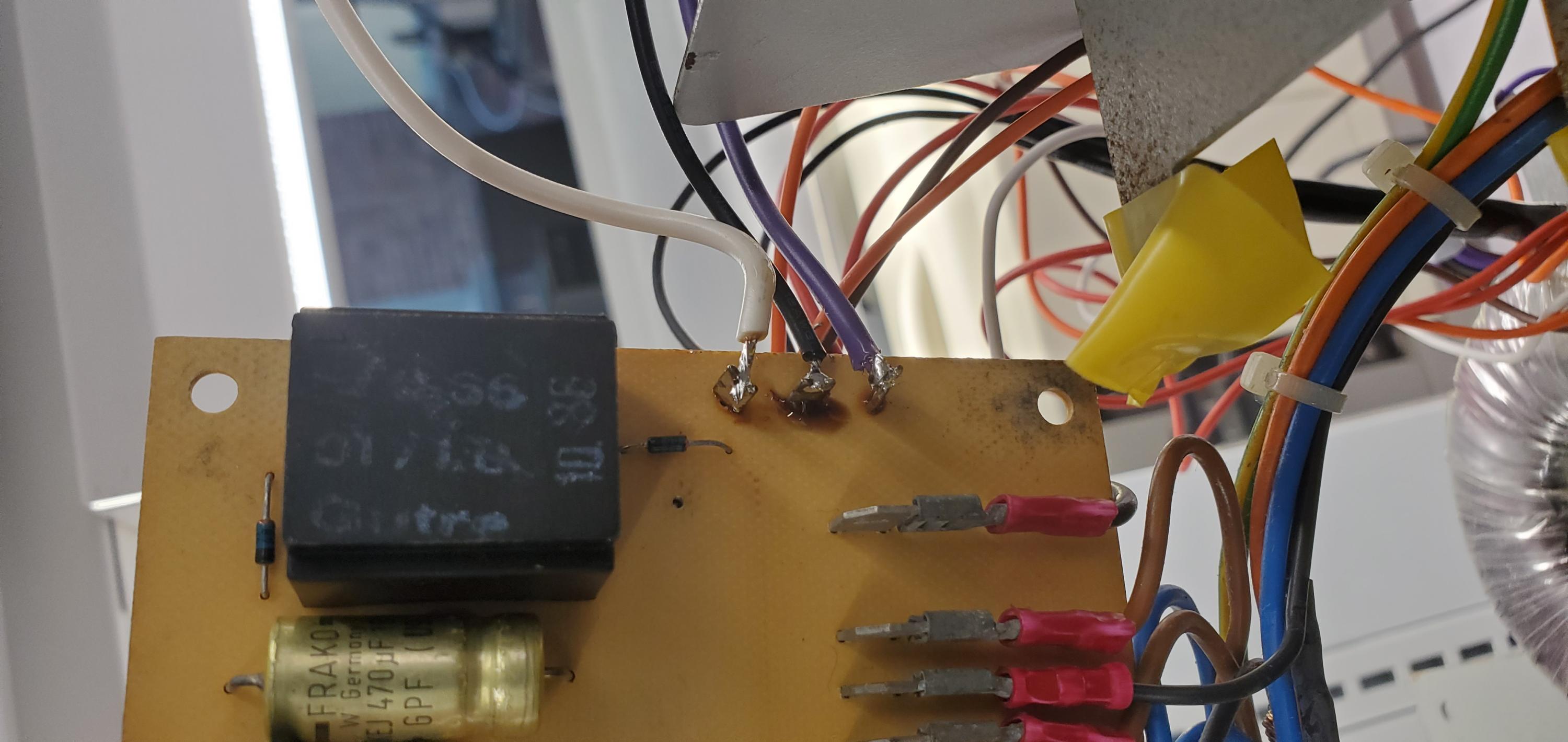

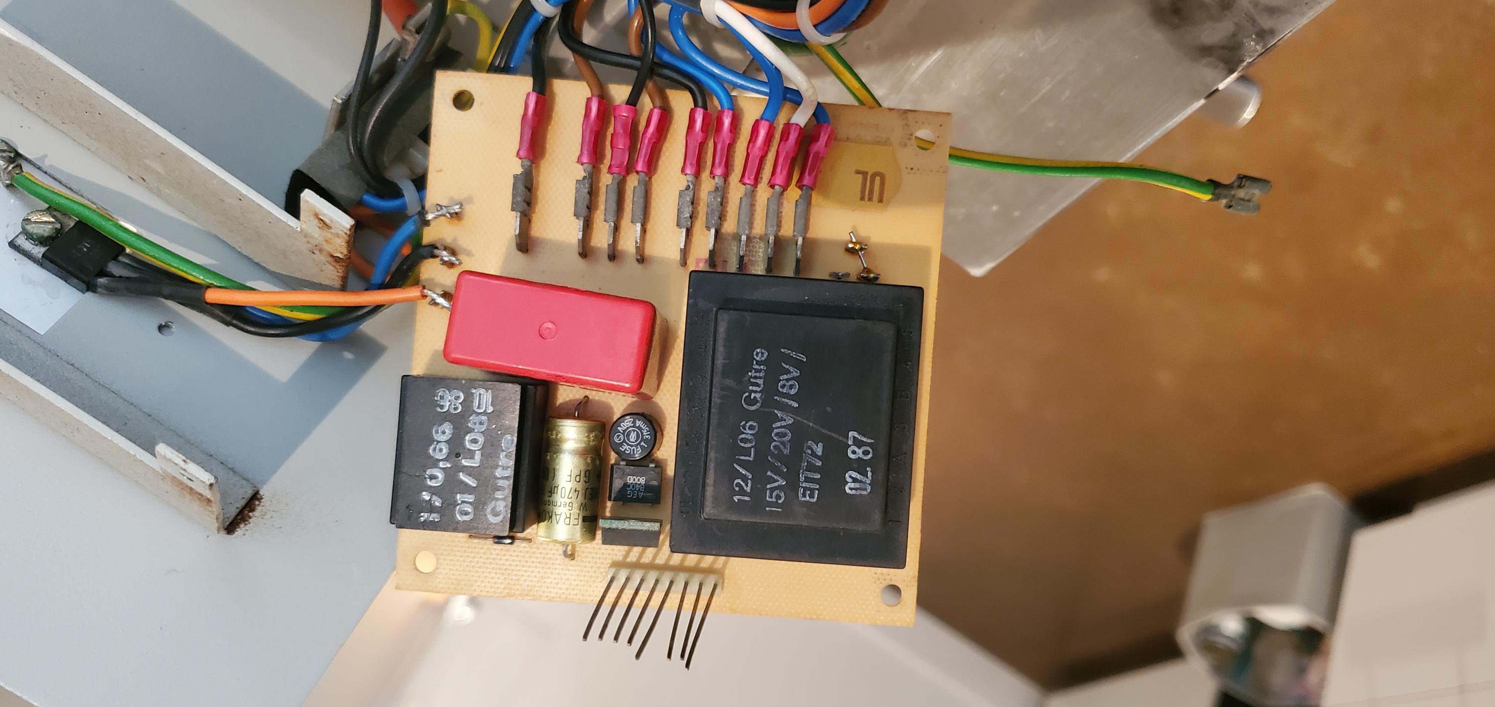

      I think he does, https://www.badcaps.net/forum/attach...4&d=1626717671 but M4 is too big (should be M3 or #4), and the plastic shoulder washers for #6 screws seems rare.
      Again something really wrong is here that's not being described. In the off state, according to the PCB, gate is shunted to MT1 through the diode/isolation transformer and therefore should be off. Unless MT2 reaches above the isolation voltage limit it won't heat up until it's forced to turn on. So therefore unless there's a wiring mistake somewhere, this makes no sense and not worth investigating further. Based on history, wiring mistakes are abound and has been extremely annoying to work through.
      Could be a wiring mistake but then I think it would be on the control board. I double checked and the TRIAC was wired correctly. The last time the waterbath worked was when I used a NTE5671 TRIAC (800v 16A https://cdn.badcaps-static.com/pdfs/...779fb4dd7a.pdf). It does not have a metal plate. I dont know the material but I had installed it without a mica and it worked so it isn't conductive. The original TRIAC (so before the NTE5671) was a IT715 (800v 15A). IT715 seems to be equivalent to NTE56010.
      I have not wired anything differently since then. The only difference is the TRIAC which is a NTE56010 (800v 15A https://cdn.badcaps-static.com/pdfs/...3966fef995.pdf).

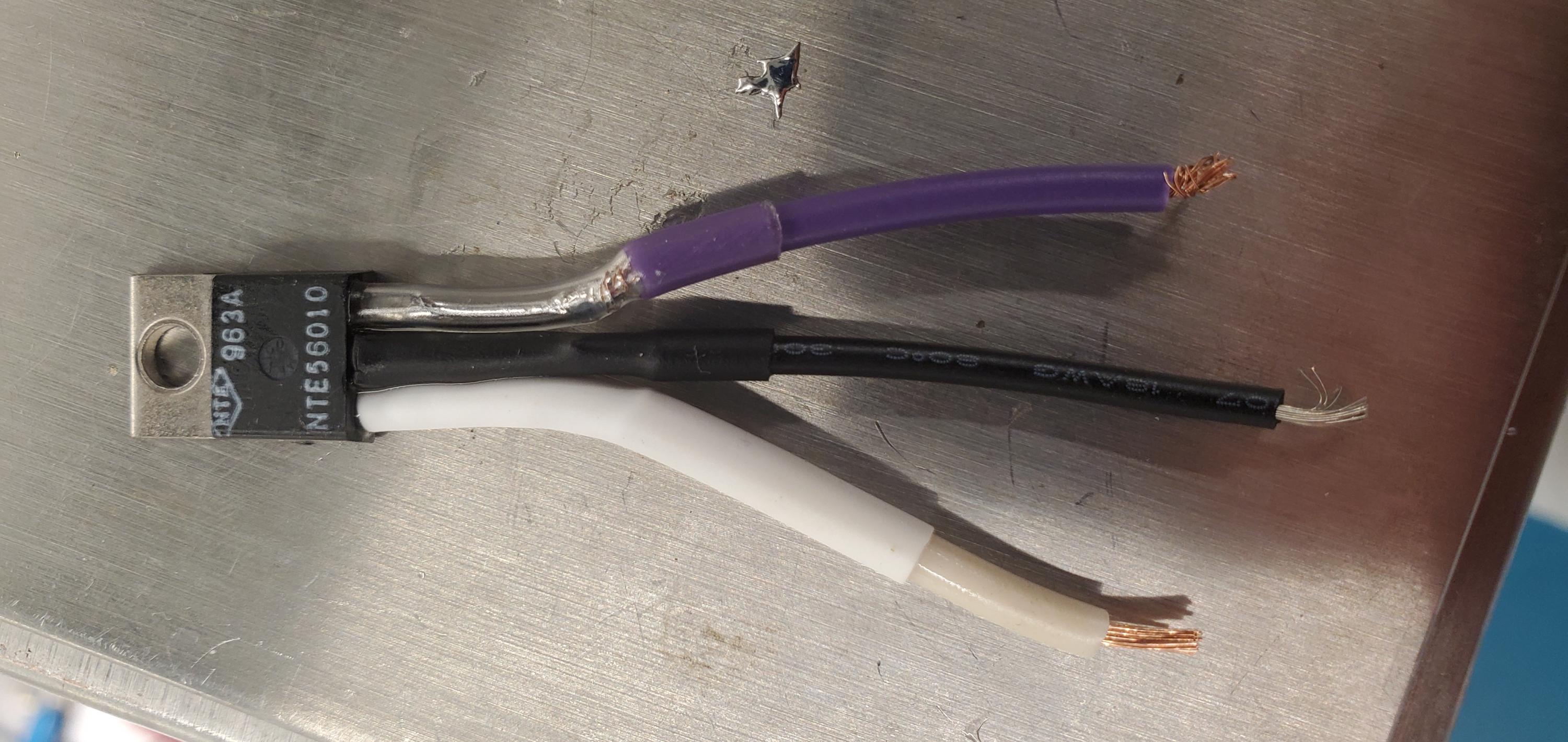

                          what i'd like to see is how the wires connect from the PCB to the TRIAC... the wire colors don't seem to make sense from the limited photos of the wires in the existing pictures, alas it looks like a lot of splices are in place so things may not be as they seem.
                          • vrasp
                            • Nov 2019
                            • 194
                            #273
                            Re: Fixing a laboratory waterbath
                            This is an old picture but the best one I have. It s the first TRIAC.
                            Blue: GATE
                            Black: MT2
                            Orange: MT1
                            . I wired the subsequent ones similarly.

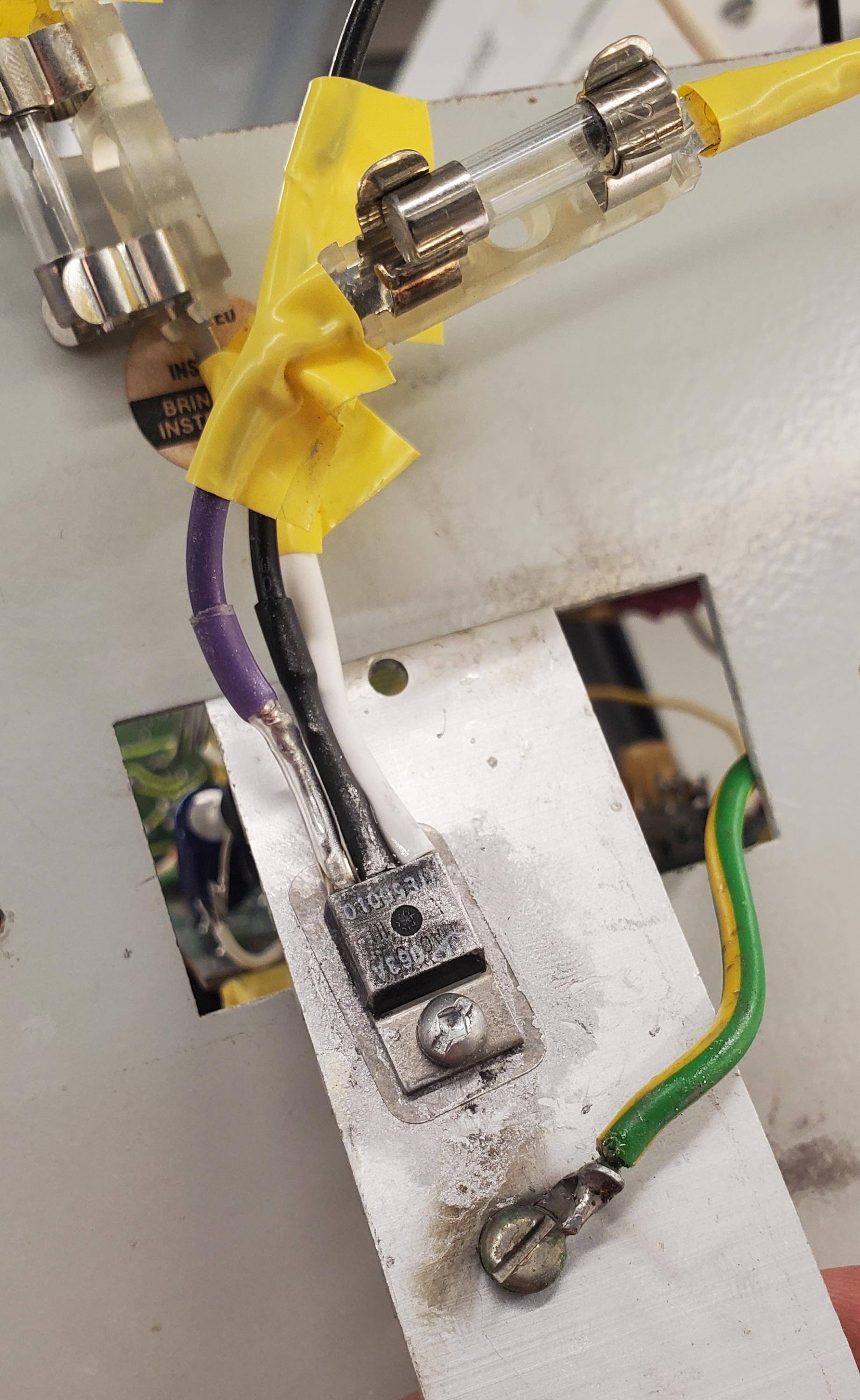

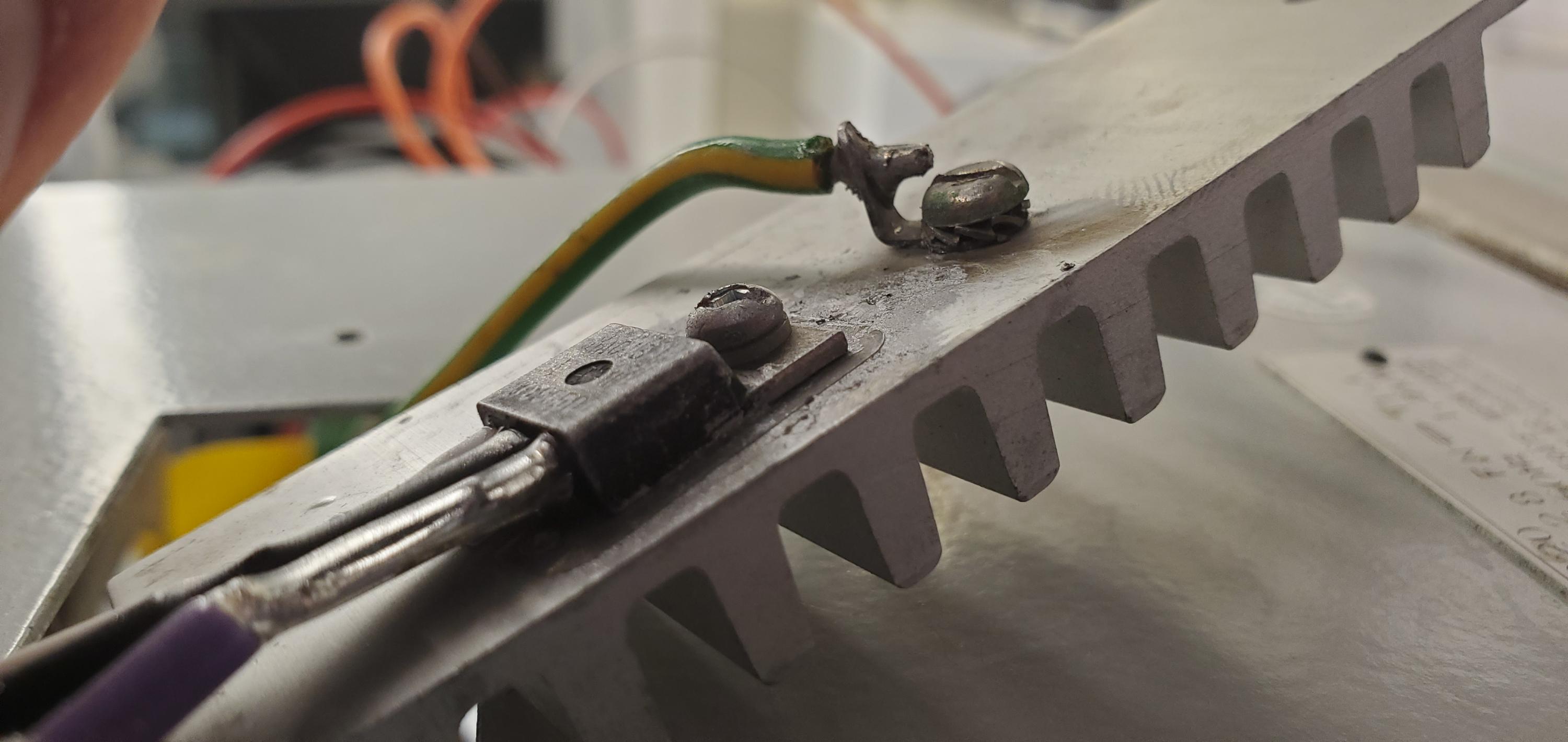

                              I have installed the new TRIAC. A NTE56010. Same as before.
                              I added 15A fuses on MT1 and MT2 and a 0.1A fuse on GATE. I did not solder the fuses. I did a quick job. The wire is just twisted in the fuse holder's holes. This will be done properly after it's fixed.
                              I replaced the wires from the PCB to the TRIAC so there is no splice or colour changes. It's now easier to follow.
                              I plugged the waterbath in series with a 100w bulb and made the following measurements. First, the bulb in series drops the voltage to 77v between live and neutral. I don't know if this is normal.
                              I also removed the heating element live wire and put a 100w bulb instead.
                              Resistance is max between any TRIAC pins and ground with my multimeter at the max Ohm setting. Putting both multimeter leads on the heatsink also gives me a max resistance. It should give me continuity or at least some resistance. It is connected to ground. There is no continuity between heatsink and ground either. The heatsink must have a very high resistance. Why is this the case? It makes me doubt that the TRIAC is not shorted. My multimeter works fine and the leads are clean, so are the surfaces I m measurement on.
                              There are the measurements:
                              GATE - MT1 : 30 Ohms
                              GATE - MT2 : 47 Ohms
                              MT1 - MT2 : 17 Ohms
                              GATE - Neutral : 35 Ohms
                              Bulb (so MT2-Neutral): 12.1 Ohms
                              Of course these measurements were done when the waterbath is off so the TRIAC is not activated.
                              I then turned on the waterbath with the bulb in series and measured this:
                              GATE - MT2: 77v
                              GATE - MT1: 0.1v
                              GATE - Neutral: 77v
                              MT1 - MT2: 77.1v
                              Bulb (so MT2 - Neutral): 0v
                              At this point I haven't tried plugging the water bath staight into the wall. I think the TRIAC is OFF because it's at the same potential then live and neutral, hence why the bulb in place of the heating element does not turn on.
                              I believe this could also be due to the fact that only 77v is supplied to the waterbath. This might not be enough to power the whole thing and turn on the TRIAC. I m not sure. I m not confident enough at this point to plug it into the wall. I have fuses on each TRIAC wire but they are 15A and 0.1A so I think the TRIAC could still blow.
                              This is where I need your help figuring out what to do now. Anything else I can do before plugging it into the wall?
                              Thank you!

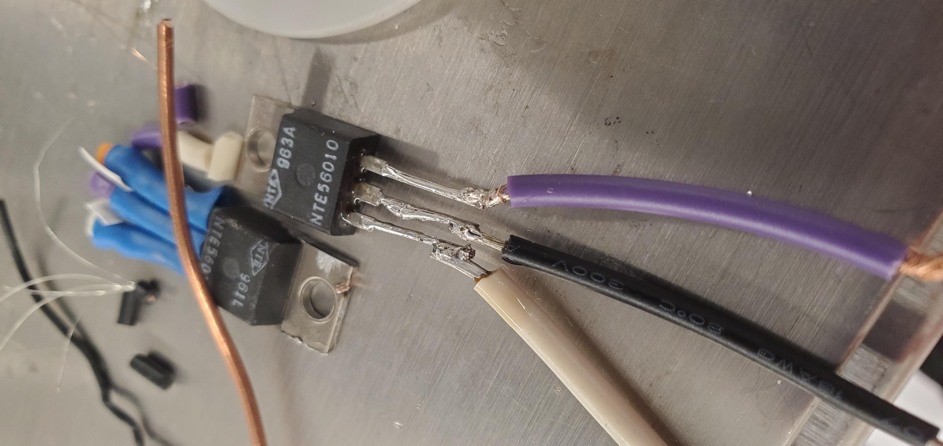

                                        I was rereading all the answers to make sure I hadn't forgotten anything. Just realized you said left pin is GATE, middle is MT2 and right is MT1. Are you sure about this? The datasheet (attached below) seems to indicate the GATE is right, MT2 middle and MT1 left. The diagram in the datasheet is showing the TRIAC from the front correct? If it's actually from the back I ve been wiring it wrong this whole time...Could you check my photos with the wiring above and tell me if it's correct?
                                        It goes
                                        Purple - GATE
                                        Black - MT2
                                        White - MT1
                                        Thank you!

                                          Well you're right it is MT1 MT2 Gate, but sorry, no additional clues why it's frying. You're on your own.
