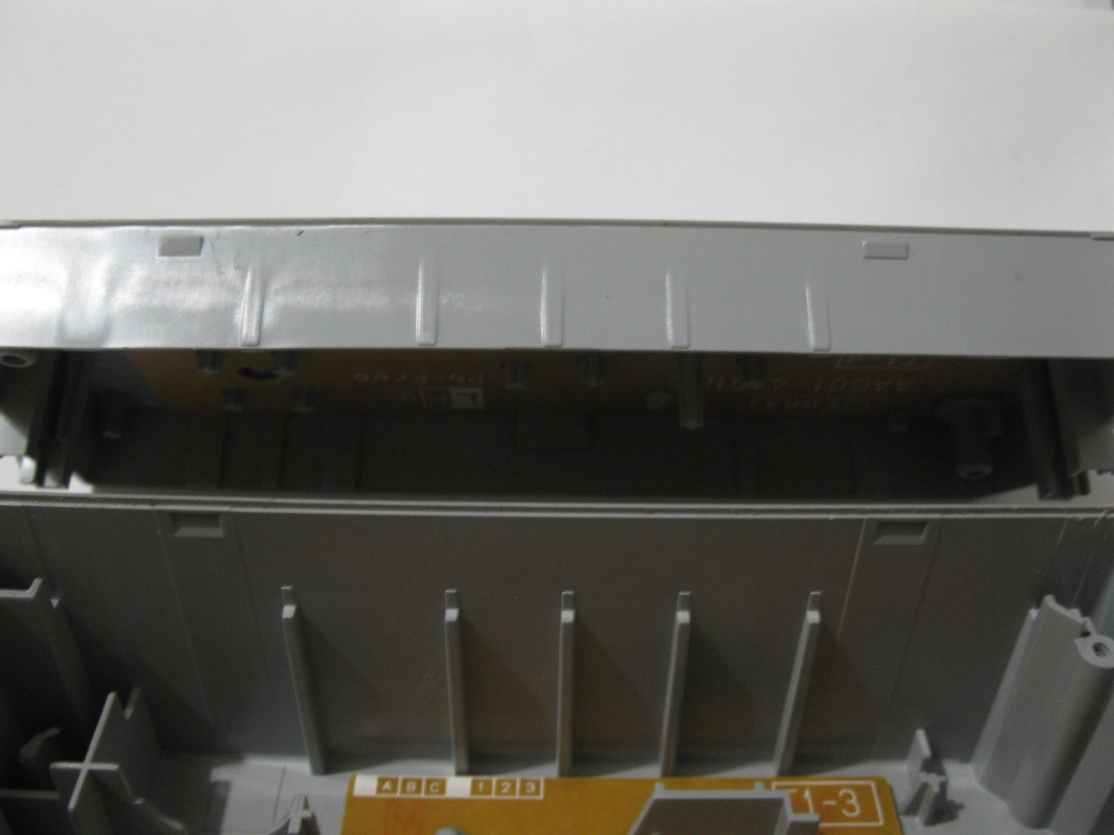

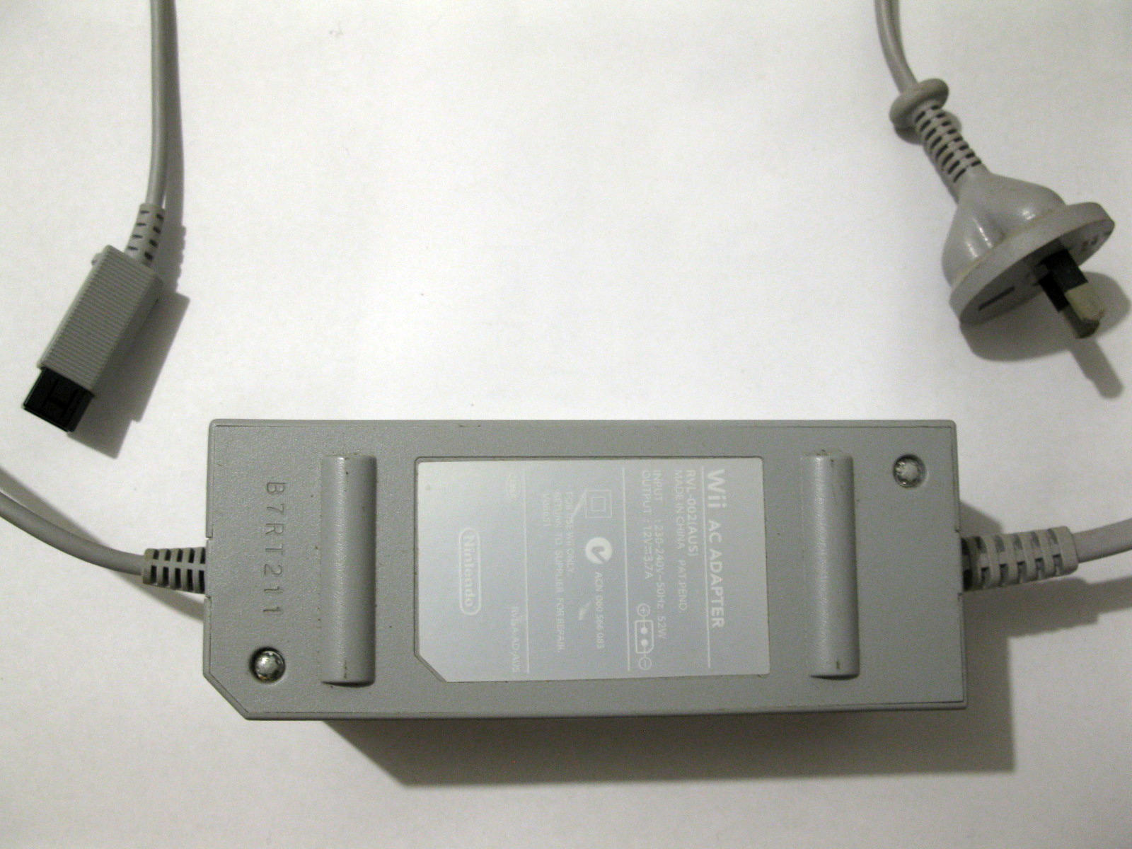

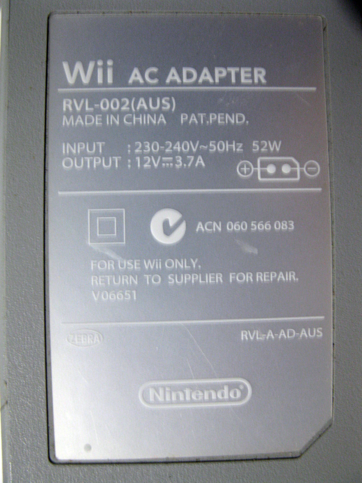

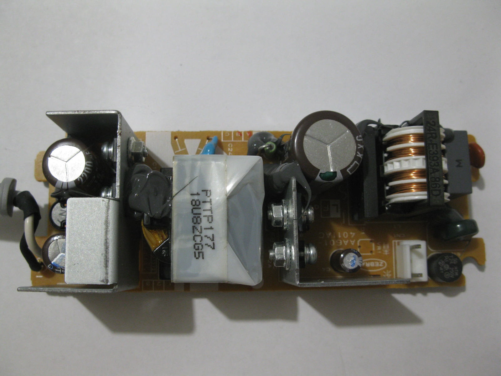

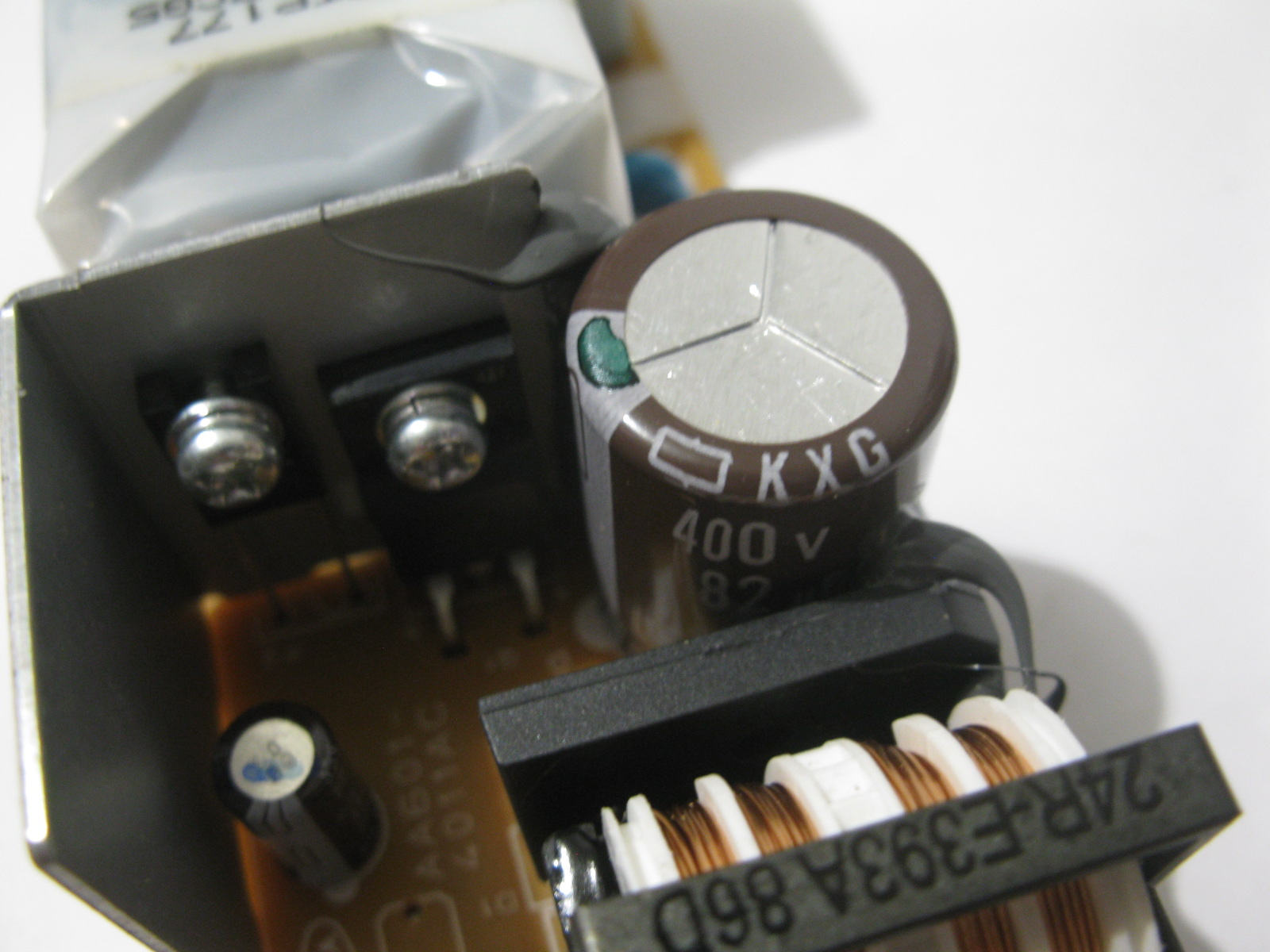

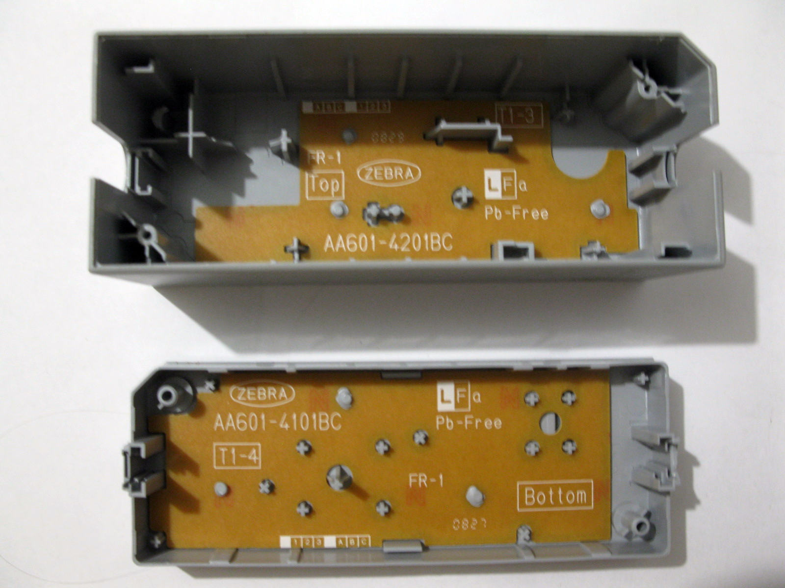

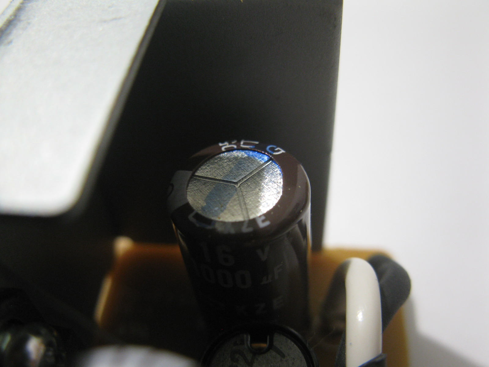

            Just for reference, I have uploaded some photos of an Australian Wii power adapter RVL-002(AUS), manufactured by Zebra. It is most likely the same as the European/UK 230V version but with a different AC mains plug.
            If anyone has an American or Japanese Wii adapter to show, it would be interesting to see the differences.
            This thing was a pain to open. Not only did it have 2 gamebit screws (same size as the ones on a SNES/N64 console), but the enclosure has four locking tabs, two on each side, and trying to get to them is extremely difficult as the gap between the two halves is almost microscopic.

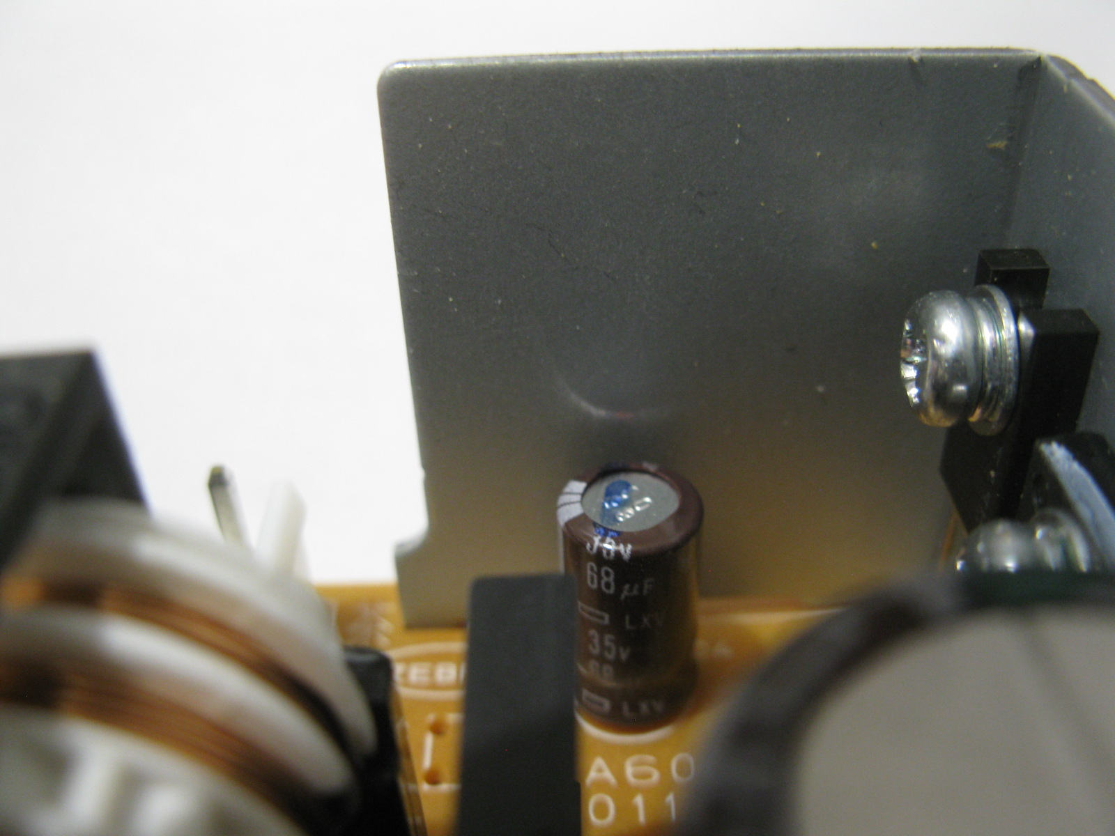

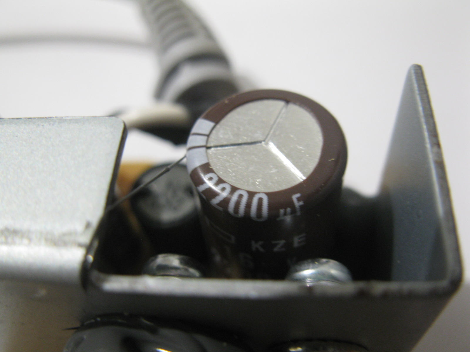

            Anyway, in the Australian Wii adapter, I was greeted with a nice set of Nippon Chemi-con caps, as opposed to the junk found in the OP's Wii adapter. Additionally, the AC plug is only clipped in, so it can be easily replaced if it breaks, or if you find one in the hard waste with the cord cut. Unfortunately though, the 12V side with the proprietary plug is soldered directly to the board so you'd be out of luck if that end was cut off.
            Both the top and bottom halves of the enclosure have blank PCBs attached to the insides, presumably for a bit of safety similar to having a sheet of plastic in a PC power supply.
            Now for the most important part, being on badcaps.net and all, electrolytics:
            C2: NCC KXG 400V 82uF 105°C
            C4: NCC LXV 35V 68uF (temperature rating obscured, but assuming it's 105°C)
            C9: NCC KZE 16V 2200uF 105°C
            C12: NCC KZE 16V 1000uF 105°C
                The LXV series is an older non-aqueous low impedance series, so it is a 105C rated part.
                As for the part mentioned in the OP, probably a UCC/NCC LXZ or KZE series part would be suitable, though it may have other questionable quality electrolytics elsewhere.
