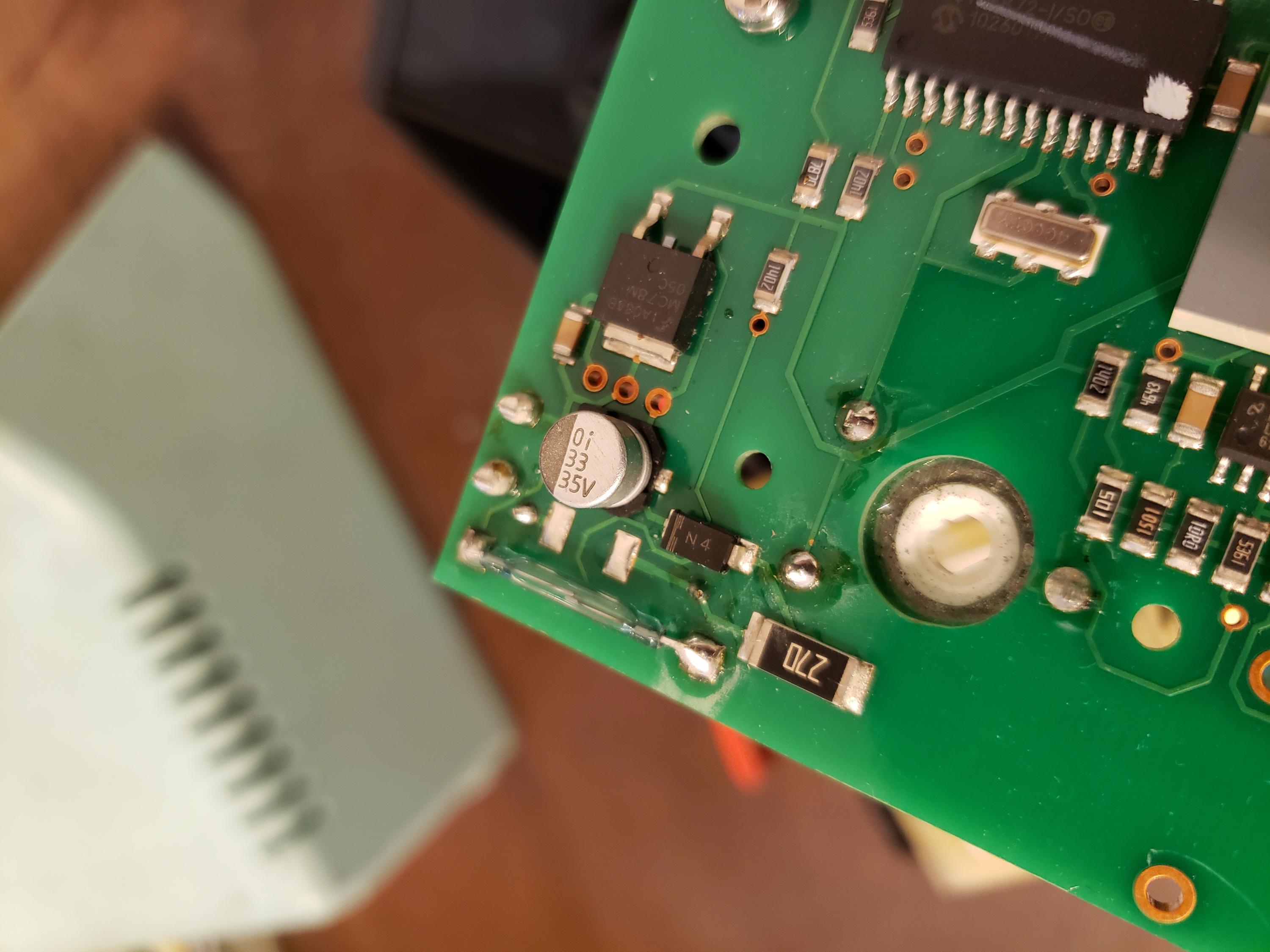

    Weller WESD51 no power
    Years ago, a friend asked me to look at his WESD51 because it would not power on. I wrote it off as the iron being bad because it smelled kinda burnt. No, I didn't check power at the secondaries. Move forward to a few years later, I'm dismantling the unit and notice a component I've never seen, and wonder if it could be the problem. If it's an easy fix, I'll fix it and either sell it or use it.

    Re: Weller WESD51 no power
    what are you refering too, the glass tube?
    thats a reed switch - a magnet controlled switch
      Yes, I have never seen one. If it looks normal, then I'll test the secondaries to be absolutely sure and report back.
        you can test it - hold a meter across it reading continuity and then put a magnet near it to switch it on.
