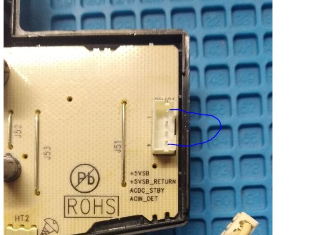

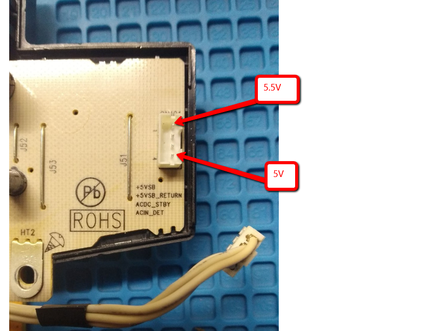

PS3 Super Slim PSU
  • bobale
    replied
    Re: PS3 Super Slim PSU
    Thanks for the info
    Leave a comment:
  • rtstorm
    replied
    Re: PS3 Super Slim PSU
    Hey, I did not. The problem was on a Wi-Fi chip. I order a 'new' one from AliExpress but still no help. I am not sure that the one that I order was working also, so I give up on this. Problem is that I did not find actually the new one, they are all scraped from the broken console. If you can find one, go ahead and replace it (hint: use preheater to desolder it)
    Leave a comment:
  • bobale
    replied
    Re: PS3 Super Slim PSU
    rtstorm, did you manage to fix that PS3 in the end?
    I have the same problem with PS3 slim, there is so much draw from the 5V standby rail that PSU shuts down. Powering the main board from the bench psu it does the same thing as yours did: initially it draws almost 2A, and then in a few seconds it goes down to 0.5-0.6A.
    Leave a comment:
  • CapLeaker
    replied
    Re: PS3 Super Slim PSU
    Originally posted by rtstorm
    No, i check it. The short is in the Marvell 88W8781 IC
    unfortunately yes. you could replace the Marvel chip? Or maybe find a replacement wifi module on ebay?
    Leave a comment:
  • rtstorm
    replied
    Re: PS3 Super Slim PSU
    No, i check it. The short is in the Marvell 88W8781 IC
    Leave a comment:
    replied
    Re: PS3 Super Slim PSU
    look at the module - maybe it's just a shorted cap in it.
    Leave a comment:
  • rtstorm
    replied
    Re: PS3 Super Slim PSU
    Yes it could be. My controller does not work so i assume that this chip is for Bluetooh also . I thought that i could use console with LAN cable but obviously i need to replace it
    Leave a comment:
    replied
    Re: PS3 Super Slim PSU
    probably needs the wifi for the initial self-test
    a lot of other consoles wont boot without the module either
    Leave a comment:
  • rtstorm
    replied
    Re: PS3 Super Slim PSU
    I remove the WiFi little board and i got working But it will only work when i short +5VSB and ACIN_DET. I test the console and it boot up and run normaly (just no WiFI). Do you have any idea why it wont work without jumping wire those 2 pins?
    Last edited by rtstorm; 03-30-2020, 09:34 AM.
    Leave a comment:
  • rtstorm
    replied
    Re: PS3 Super Slim PSU
    Sorry, dis not understand you. What do you mean by load the tested ps3 psu az 0.5A?
    I noticed that at first Amps jump to 1.9A then go down to 0.3-0.5amp.
    Last edited by rtstorm; 03-29-2020, 04:04 PM.
    Leave a comment:
  • CapLeaker
    replied
    Re: PS3 Super Slim PSU
    Umm something is off if the main board is working on your bench power supply only drawing 0.3A. I mean you load tested the ps3 psu at 0.5A, right?
    Leave a comment:
  • rtstorm
    replied
    Re: PS3 Super Slim PSU
    I already watch that video before. It draw 0.3A, but at first it drop my voltage to 2.3V and then come up to 5.5V. i will try to remove it and then check
    Leave a comment:
  • CapLeaker
    replied
    Re: PS3 Super Slim PSU
    Watch this: https://youtu.be/eEJ9zCgbg4k
    Leave a comment:
  • CapLeaker
    replied
    Re: PS3 Super Slim PSU
    How much is the current draw?
    A whiny something shouldn’t be with the ps3 off. At least I do t think so. Maybe remove the wifi module and plug the ps3 psu in.
    Last edited by CapLeaker; 03-29-2020, 02:18 PM.
    Leave a comment:
  • rtstorm
    replied
    Re: PS3 Super Slim PSU
    Ok so i connect 5V to the +5VSB and ACIN_DET and i got red light on the on/off switch. I hear some wining sound from board, and i notice that WiFI module is getting hot.
    The marking on this is :
    384FF0C6C3D7
    Rev 1.1
    AW-GM381-2-12040-0BH
    Leave a comment:
  • CapLeaker
    replied
    Re: PS3 Super Slim PSU
    If you got a lab psu, you could feed the main board 5v, one or 2 amps and try to feel with you fingers if something gets hot. You also can douse parts of the main board with IPA and see if it evaporates or bubbles in a specific section. Could be anything from IC’s to a shorted smd multilayer cap.
    Leave a comment:
  • rtstorm
    replied
    Re: PS3 Super Slim PSU
    Yes i have it all exept osciloscope
    Leave a comment:
  • CapLeaker
    replied
    Re: PS3 Super Slim PSU
    Yeah, there is a short on the main board all right. Do you have tools like a constant voltage, constant current power supply, DMM, hot air etc?
    Try to measure with your DMM in Ohms setting between 5vsb and 5vsb Return on the main board.
    Last edited by CapLeaker; 03-29-2020, 12:57 PM.
    Leave a comment:
  • rtstorm
    replied
    Re: PS3 Super Slim PSU
    When i diconect 4-pin connector and plug in PSU in wallet i get 5.5V on +5VSB, and 5V on ACIN_DET. ACDC_STBY is 0V. When i plug in the 4-pin to mainboard i lose those 5V on both (+5VSB and ACIN_DET)
    Leave a comment:
  • CapLeaker
    replied
    Re: PS3 Super Slim PSU
    So, as soon as you plug this board in, your stby voltage disappears, correct?
    Leave a comment:
  • AJ847.63e
    Playstation 3 phat, slim and super slim resource search
    by AJ847.63e
    Hi All,
    I recently got a bunch of faulty/partially faulty PS3s and wanted to get some advise on them. Models are:
    X4 are PS3 slims with disc drive errors.
    X1 is a PS3 slim with the 8002F1F9 update error.
    X1 is a ps3 slim with no display.
    X1 is a slim with RLOD
    X1 is a super slim with a missing disc drive and receiving the same update error 8002F1F9 (I'm assuming because it needs it's drive)?
    X1 is another super slim with no power (board number MPX-001).
    Does anyone know of any good resources that list parts interchangeability?...
    11-24-2025, 05:39 PM
  • MORETTIGIAN
    Capacitor detached from PCB – RTX 2070 Super Founders Edition
    by MORETTIGIAN
    Title:
    Capacitor detached from PCB – RTX 2070 Super Founders Edition
    Description:
    During maintenance on an RTX 2070 SUPER Founders Edition, I found a capacitor lying on my desk after reassembly.
    I did not notice it detaching, so I am unsure of its original location on the PCB.
    Procedure performed:
    - Removed backplate
    - Cleaned heatsink and PCB with isopropyl alcohol + soft ESD brush
    - Reapplied thermal compound
    - Reassembled card
    Observed behavior after reassembly:
    - GPU powers on and operates normally under...
    09-18-2025, 12:14 PM
  • Destroyer-Br
    [HELP] Acer AN515-55 (LA-J871P Rev: 1B) – Board won't power on after GPU investigation – Suspecting Super I/O or PCH
    by Destroyer-Br
    [HELP] Acer AN515-55 (LA-J871P Rev: 1B) – Board won't power on after GPU investigation – Suspecting Super I/O or PCH
    Hi everyone,
    I'm working on an Acer Nitro 5 unit with the following specs:
    • Motherboard: LA-J871P Rev: 1B
    • Model: Acer AN515-55-59MT
    • S/N: NHQ7JAL00403906A973400
    • SNID: 03902728734
    Initial Issue
    The laptop initially presented graphic issues and driver failure (Code 43) for the GPU.
    After preventive maintenance (cleaning, thermal paste, etc.), it powered on normally. We disassembled it again to inspect the GPU, reassembled...
    04-17-2025, 08:18 PM
    SHUTTLE XPC slim DX30 XPC slim J3355 Specification for Upgrade or Repair
    This specification for the SHUTTLE XPC slim DX30 can be useful for upgrading or repairing a desktop PC that is not working. As a community we are working through our specifications to add valuable data like the XPC slim DX30 boardview and XPC slim DX30 schematic. Our users have donated over 1 million documents which are being added to the site. This page will be updated soon with additional information. Alternatively you can request additional help from our users directly on the relevant badcaps forum. Please note that we offer no warranties that any specification, datasheet, or download for SHUTTLE...
    09-12-2024, 03:30 PM
    SHUTTLE XPC slim DH110 XPC slim i3-7300 Specification for Upgrade or Repair
    This specification for the SHUTTLE XPC slim DH110 can be useful for upgrading or repairing a desktop PC that is not working. As a community we are working through our specifications to add valuable data like the XPC slim DH110 boardview and XPC slim DH110 schematic. Our users have donated over 1 million documents which are being added to the site. This page will be updated soon with additional information. Alternatively you can request additional help from our users directly on the relevant badcaps forum. Please note that we offer no warranties that any specification, datasheet, or download for...
    09-12-2024, 03:28 PM
