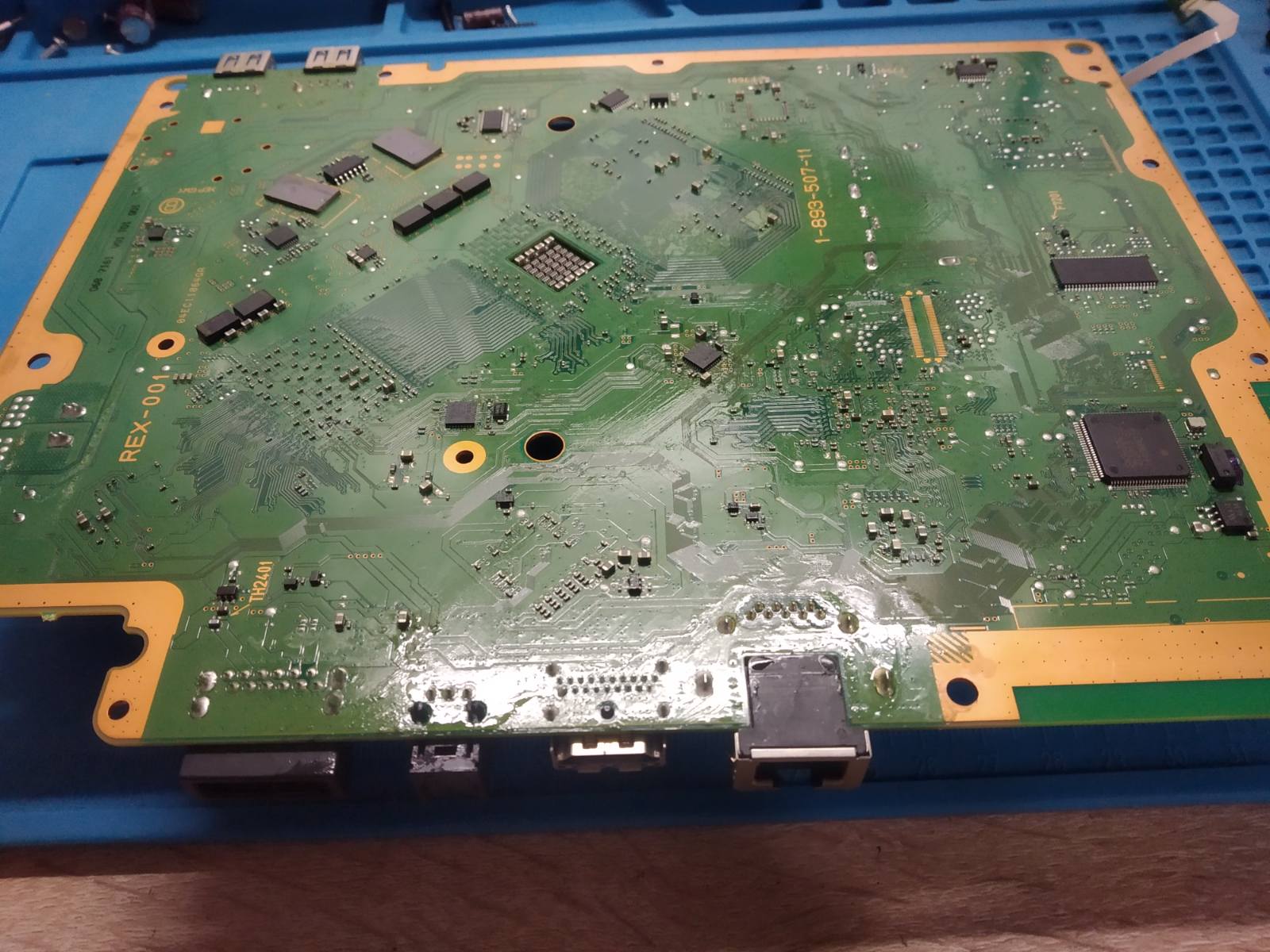

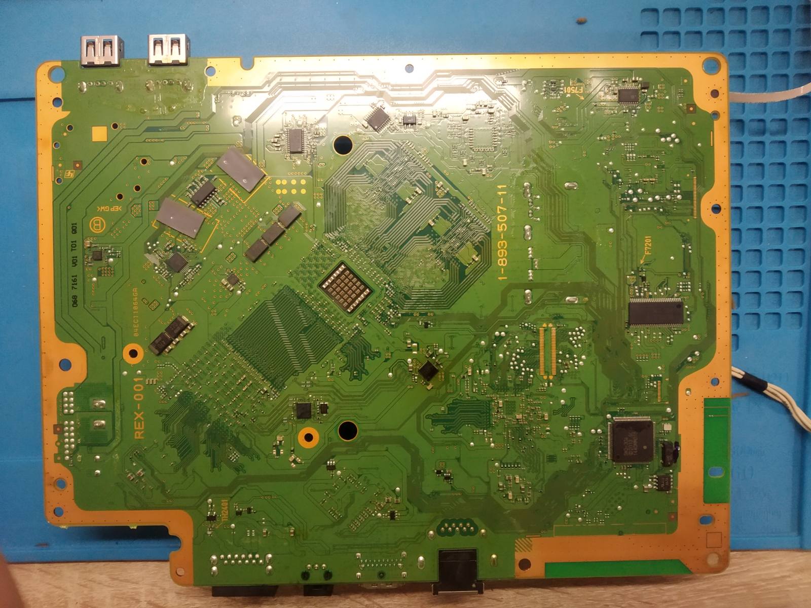

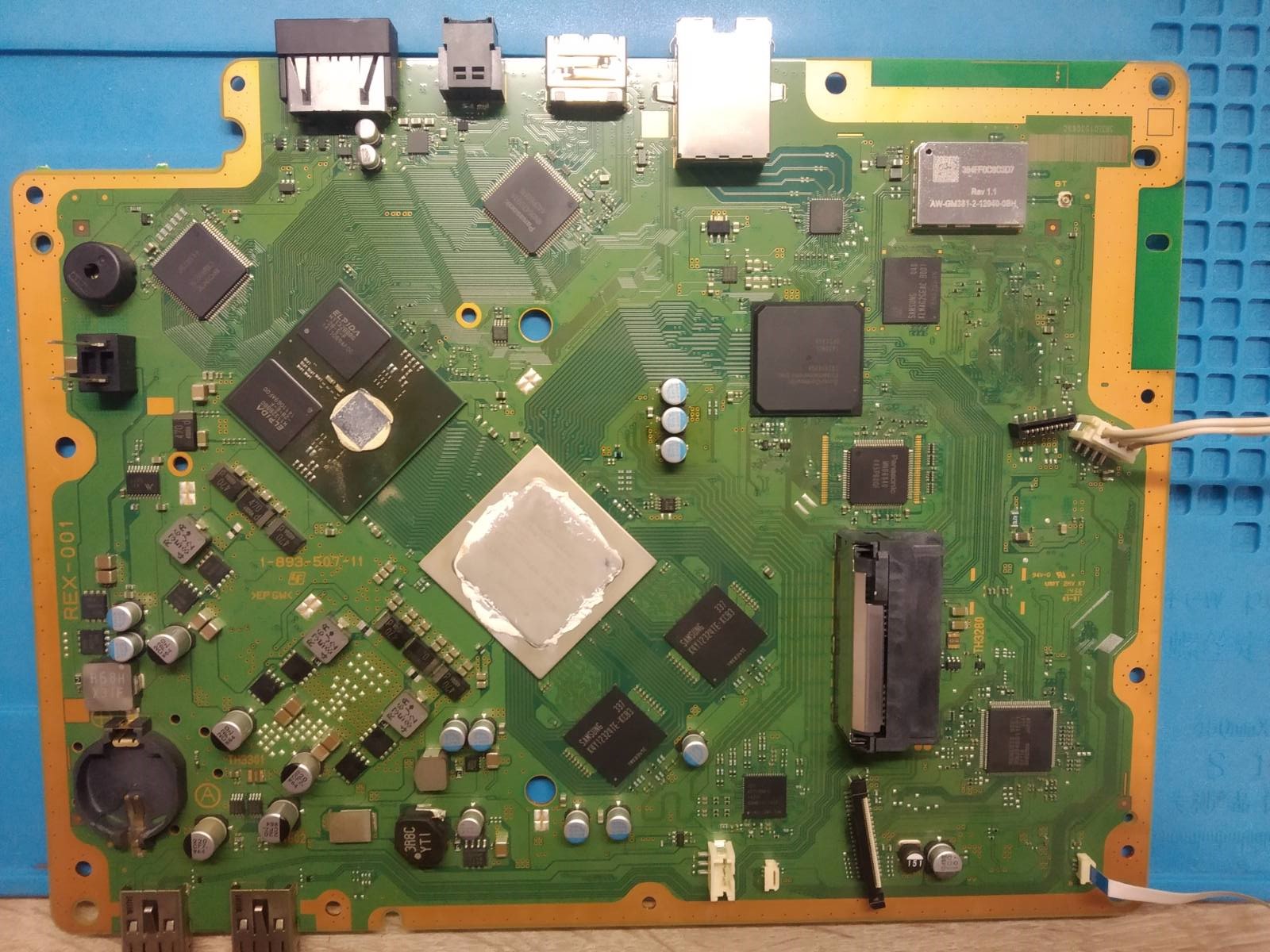

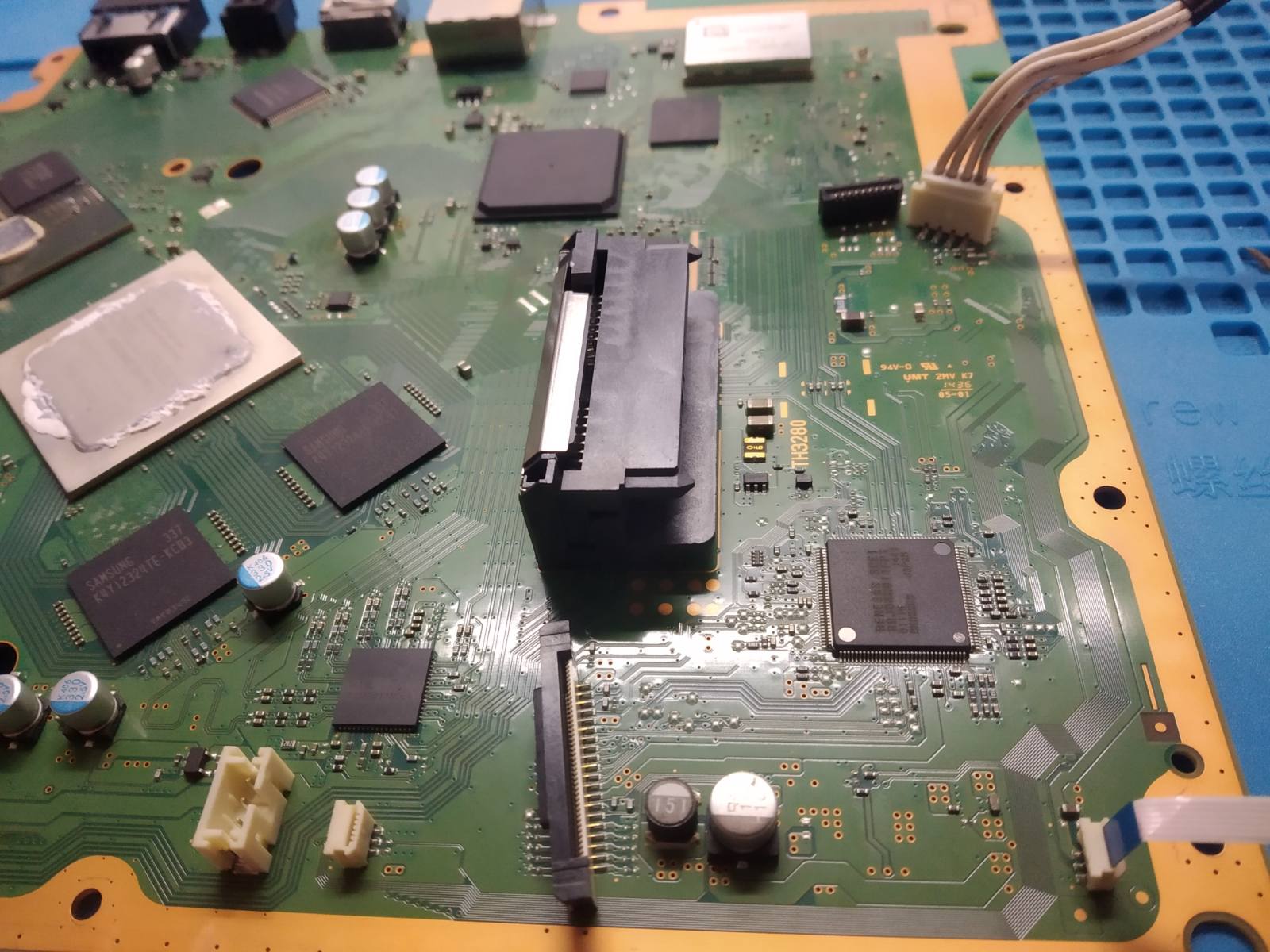

PS3 Super Slim PSU
  • rtstorm
    replied
    Re: PS3 Super Slim PSU
    I think, here is the picture of mainboard.
    Leave a comment:
    replied
    Re: PS3 Super Slim PSU
    does the slim have the damned nec-tokin prodalizer ceramic caps on it??
    Leave a comment:
  • CapLeaker
    replied
    Re: PS3 Super Slim PSU
    You did pretty good so far. You discovered that the psu is loaded down by a short on the main board. The psu is fine. From here on it probably gets a little ugly.
    Leave a comment:
    replied
    Re: PS3 Super Slim PSU
    RETURN is an old name for neutral or ground.
    so that's o.k.
    Leave a comment:
  • rtstorm
    replied
    Re: PS3 Super Slim PSU
    I check those caps and they are ok, i replace most of them. Is it normal that +5VSB_RETURN is shorted to gnd? I check and it is shorted on mainboard and psu. I disconect it and test separate. And now i discovered when mainboard is not connected with psu i got +5 on +5VSB and +5v on ACIN_DET. So is the priblem with mainboard?
    Last edited by rtstorm; 03-29-2020, 09:12 AM.
    Leave a comment:
    replied
    Re: PS3 Super Slim PSU
    I would also recommend change all three capacitors next to that ic chip “FS117”
    Leave a comment:
  • ngth82
    replied
    Re: PS3 Super Slim PSU
    I'd look at the cap too as STJ suggested if you haven't already. Got a cap meter?
    Leave a comment:
    replied
    Re: PS3 Super Slim PSU
    jumping startup is usually a bad cap
    Leave a comment:
  • rtstorm
    replied
    Re: PS3 Super Slim PSU
    Yes, i think this is the same component. On my measuring i get 0V on all (exactly -0.8V) except on pin5 i get jumping volage from -2 to 6V. The datasheet say that pin 5 is STARTUP and pin 4 is V-IN
    Last edited by rtstorm; 03-28-2020, 05:58 PM.
    Leave a comment:
  • ngth82
    replied
    Re: PS3 Super Slim PSU
    I agree...
    BUT... if you look at the US version, my supply has a DNP013 by Fairchild Semi. ()
    Fairchild has a device FSL117 - note the addition of the L. (https://cdn.badcaps-static.com/pdfs/...5d406acc7c.pdf)
    Both are green-mode Fairchild power switches.
    I just can't find the package marking for the FSL117 - it's not in their datasheet. Maybe this is a good start... Pin out looks similar except pin 4 between the two devices.
    Leave a comment:
  • rtstorm
    replied
    Re: PS3 Super Slim PSU
    Here is the picture of component. I fount it on AliExpress
    Last edited by rtstorm; 03-28-2020, 05:21 PM.
    Leave a comment:
    replied
    Re: PS3 Super Slim PSU
    Originally posted by rtstorm
    FS117
    This is not a good part number
    Leave a comment:
  • rtstorm
    replied
    Re: PS3 Super Slim PSU
    My board is N160A 002L
    I check all FET's and diodes and they are ok, at first i thought that B3045G Switch Mode Power Rectifier was shorted becoust pin 1 and 3 was shorted. Then i remo it from board and it was ok. The false reading was becouse the 1 and 3 is connected to the primary of transformator. All other diodes and heatsink element show no short.
    @ ngth82 - the IC is FS117
    Leave a comment:
  • ngth82
    replied
    Re: PS3 Super Slim PSU
    Originally posted by rtstorm
    i check the reading on second fuse and i got 0.02V and on the IC all pins are 0.2V exepr pin #5 voltage is jumping from 0.2V to 5V
    What's the markings on that IC that you show in post #10?
    Leave a comment:
  • ngth82
    replied
    Re: PS3 Super Slim PSU
    Whats the model of your power supply? it should be molded on to the bottom plastic piece. The one that i have is a ADP-160AR - it has a white 4 pin connector.
    In any case, the common failures for the PS3 and PS4 supplies are the N channel FETs and diodes downstream. If you haven't already, i suggest checking the four 3-pin heatsinked parts for shorts.
    In my supply, it's a K15A60U and a BYV29FX-600 diode close to the big 450V cap. You can use the DMM in continuity / beep mode for the N-FET, and in diode mode for the diode.
    Next to the 12V output, there are two heatsinked components as well. For me, it's two STPS3045CT diodes wired in parallel.
    I've fixed several PS4 and Xbox One supplies with failed FETS/Diodes.
    Leave a comment:
    replied
    Re: PS3 Super Slim PSU
    it could be one of the small caps dried up inside
    Leave a comment:
  • rtstorm
    replied
    Re: PS3 Super Slim PSU
    i check the reading on second fuse and i got 0.02V and on the IC all pins are 0.2V exepr pin #5 voltage is jumping from 0.2V to 5V
    Leave a comment:
  • rtstorm
    replied
    Re: PS3 Super Slim PSU
    Yes, you are right. My first reading was wrong :-(
    Any sugestion what should i check next?
    Leave a comment:
    replied
    Re: PS3 Super Slim PSU
    then with 240vac on the input you should have about 340vdc on the output.
    Leave a comment:
  • rtstorm
    replied
    Re: PS3 Super Slim PSU
    + to AC reading is 502 and reverse is 0L
    Leave a comment:
  • AJ847.63e
    Playstation 3 phat, slim and super slim resource search
    by AJ847.63e
    Hi All,
    I recently got a bunch of faulty/partially faulty PS3s and wanted to get some advise on them. Models are:
    X4 are PS3 slims with disc drive errors.
    X1 is a PS3 slim with the 8002F1F9 update error.
    X1 is a ps3 slim with no display.
    X1 is a slim with RLOD
    X1 is a super slim with a missing disc drive and receiving the same update error 8002F1F9 (I'm assuming because it needs it's drive)?
    X1 is another super slim with no power (board number MPX-001).
    Does anyone know of any good resources that list parts interchangeability?...
    11-24-2025, 05:39 PM
  • MORETTIGIAN
    Capacitor detached from PCB – RTX 2070 Super Founders Edition
    by MORETTIGIAN
    Title:
    Capacitor detached from PCB – RTX 2070 Super Founders Edition
    Description:
    During maintenance on an RTX 2070 SUPER Founders Edition, I found a capacitor lying on my desk after reassembly.
    I did not notice it detaching, so I am unsure of its original location on the PCB.
    Procedure performed:
    - Removed backplate
    - Cleaned heatsink and PCB with isopropyl alcohol + soft ESD brush
    - Reapplied thermal compound
    - Reassembled card
    Observed behavior after reassembly:
    - GPU powers on and operates normally under...
    09-18-2025, 12:14 PM
  • Destroyer-Br
    [HELP] Acer AN515-55 (LA-J871P Rev: 1B) – Board won't power on after GPU investigation – Suspecting Super I/O or PCH
    by Destroyer-Br
    [HELP] Acer AN515-55 (LA-J871P Rev: 1B) – Board won't power on after GPU investigation – Suspecting Super I/O or PCH
    Hi everyone,
    I'm working on an Acer Nitro 5 unit with the following specs:
    • Motherboard: LA-J871P Rev: 1B
    • Model: Acer AN515-55-59MT
    • S/N: NHQ7JAL00403906A973400
    • SNID: 03902728734
    Initial Issue
    The laptop initially presented graphic issues and driver failure (Code 43) for the GPU.
    After preventive maintenance (cleaning, thermal paste, etc.), it powered on normally. We disassembled it again to inspect the GPU, reassembled...
    04-17-2025, 08:18 PM
    SHUTTLE XPC slim DX30 XPC slim J3355 Specification for Upgrade or Repair
    This specification for the SHUTTLE XPC slim DX30 can be useful for upgrading or repairing a desktop PC that is not working. As a community we are working through our specifications to add valuable data like the XPC slim DX30 boardview and XPC slim DX30 schematic. Our users have donated over 1 million documents which are being added to the site. This page will be updated soon with additional information. Alternatively you can request additional help from our users directly on the relevant badcaps forum. Please note that we offer no warranties that any specification, datasheet, or download for SHUTTLE...
    09-12-2024, 03:30 PM
    SHUTTLE XPC slim DH110SE XPC slim i7-7700 Specification for Upgrade or Repair
    This specification for the SHUTTLE XPC slim DH110SE can be useful for upgrading or repairing a desktop PC that is not working. As a community we are working through our specifications to add valuable data like the XPC slim DH110SE boardview and XPC slim DH110SE schematic. Our users have donated over 1 million documents which are being added to the site. This page will be updated soon with additional information. Alternatively you can request additional help from our users directly on the relevant badcaps forum. Please note that we offer no warranties that any specification, datasheet, or download...
    09-12-2024, 03:28 PM
