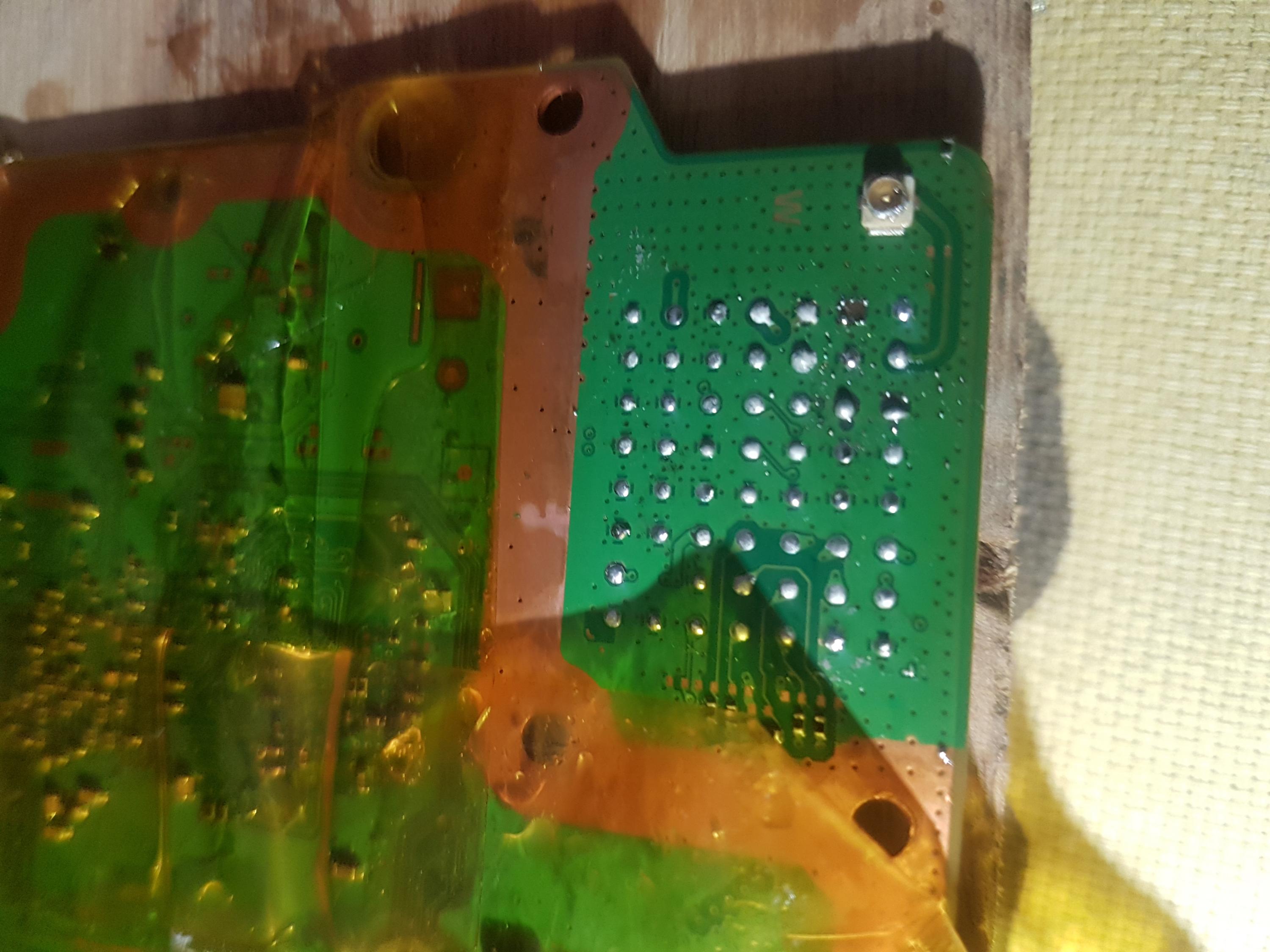

    First off, English isn't my primary language so I don't know all the technical terminology. So I ended up owning this PS4 slim that had a problem pairing controller. Once opened, I removed the WiFi chip and some joint ended up like in photo (I don't know the technical terms, if you could tell me how it's called I'll appreciate). How can I fix this?

      Re: PS4 Wi-Fi chip bad joint
      "Cratered BGA Pad" is something you can look up on Google for some info. I second looking at Luis Rossmann on YouTube on repairs.

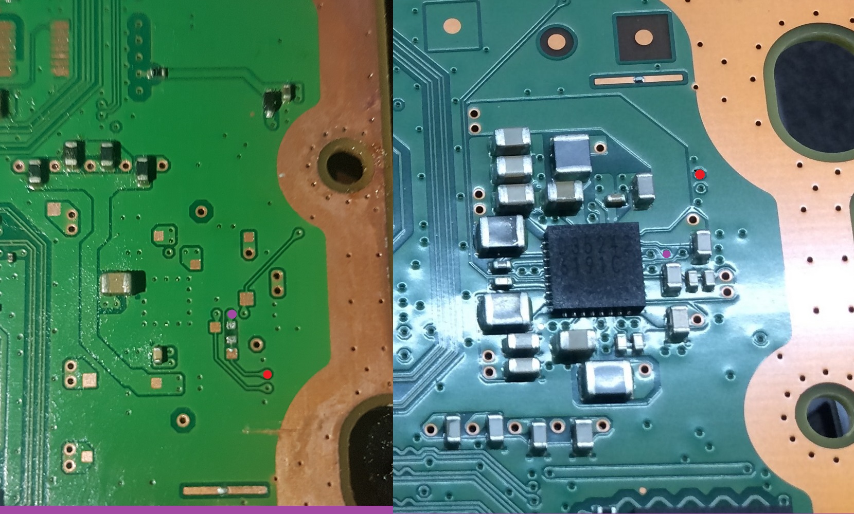

          Sorry guys, I've seen many videos from Louis but didn't found one with a similar problem to mine, could you link one please?
          • ngth82
            • Jul 2015
            • 541

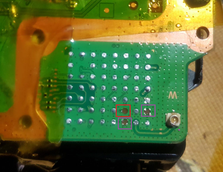

            The general idea would be to:
            1) Identify where the electrical net would go to.
            2) Identify where you can jumper something to that BGA ball.
            In your case: The red box looks like it's a signal pad that is connected to the via immediately to the left. You can scrape off the green solder mask from the via and add a 'jumper' wire (really thin wire -- 32 AWG (8 mil) or smaller wire for the red box.
            The purple boxes appear to be connected to GND. You may be able to scrape off the green solder mask around it and get a copper foil sheet and tack it down "outside" of the BGA region.

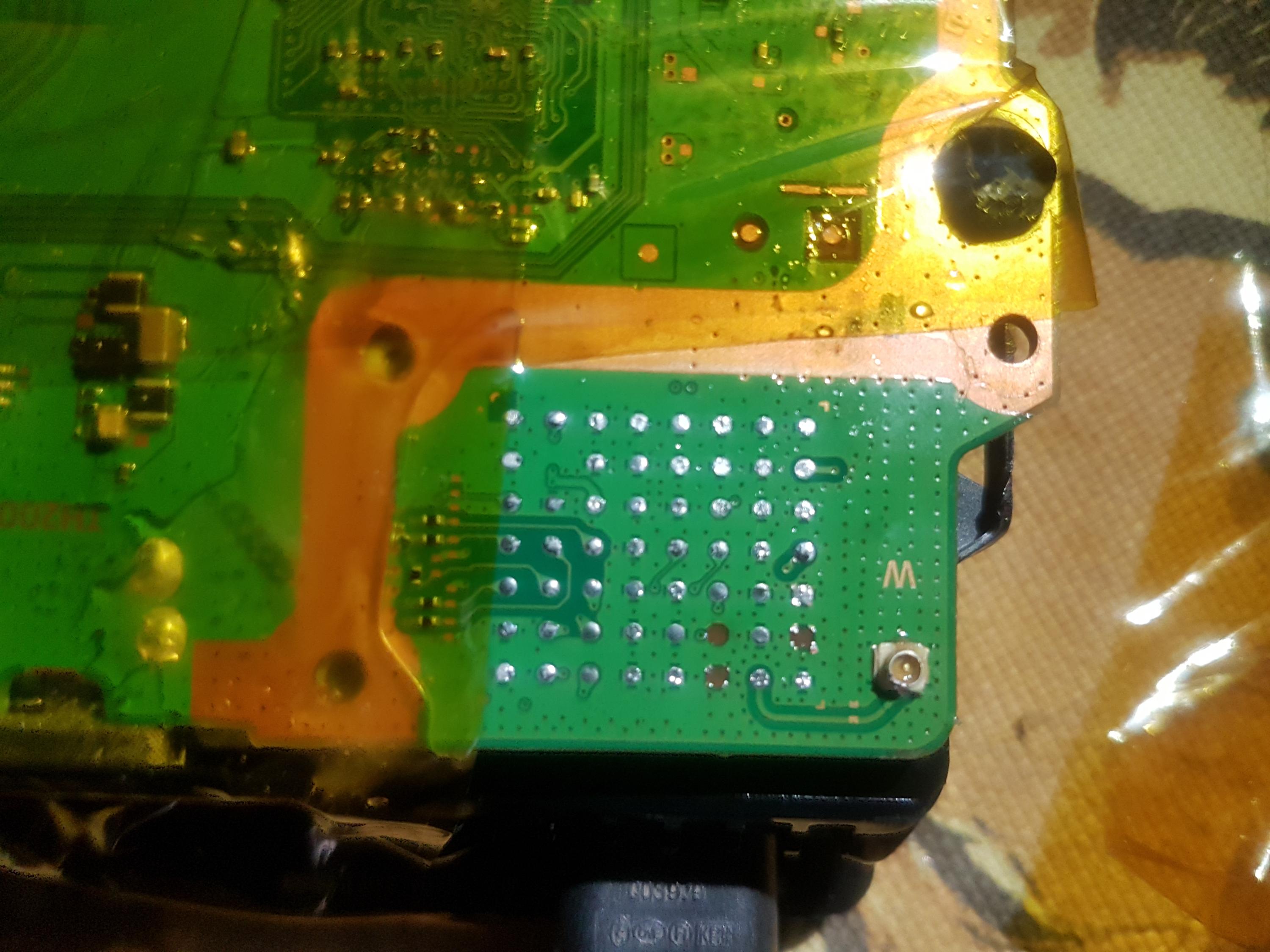

              So I kind of resolved, now the PS4 turn on and update (with the non working module it just couldn't giving me an error) but I haven't an official controller, just a nacon, and can't get past the screen where it says to press the PS button

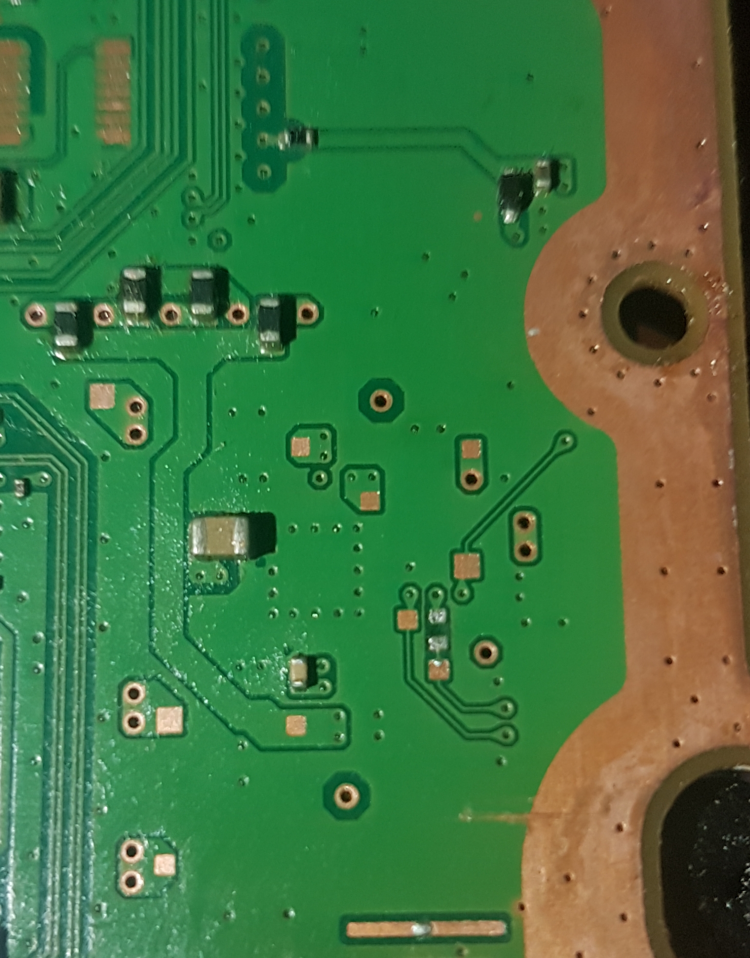

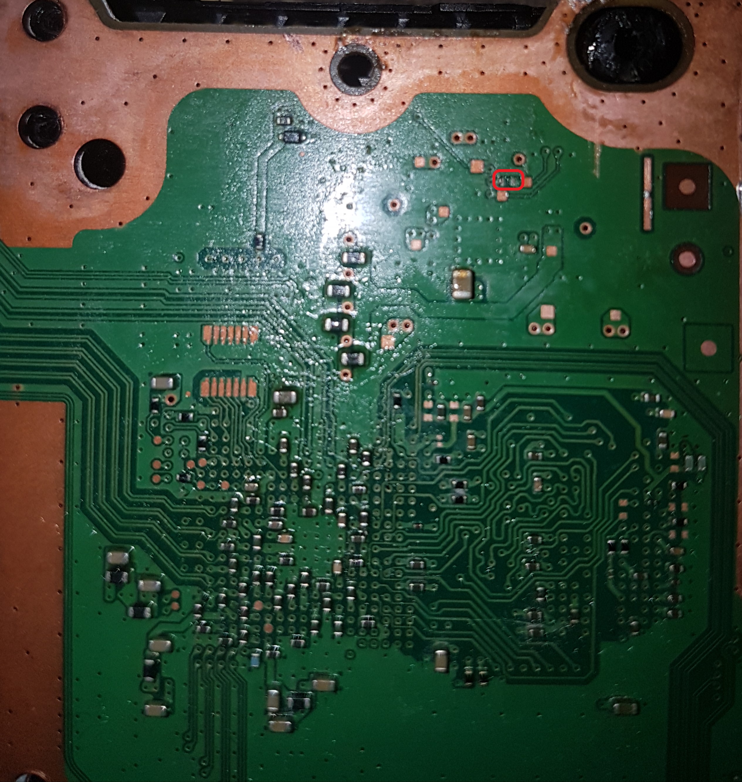

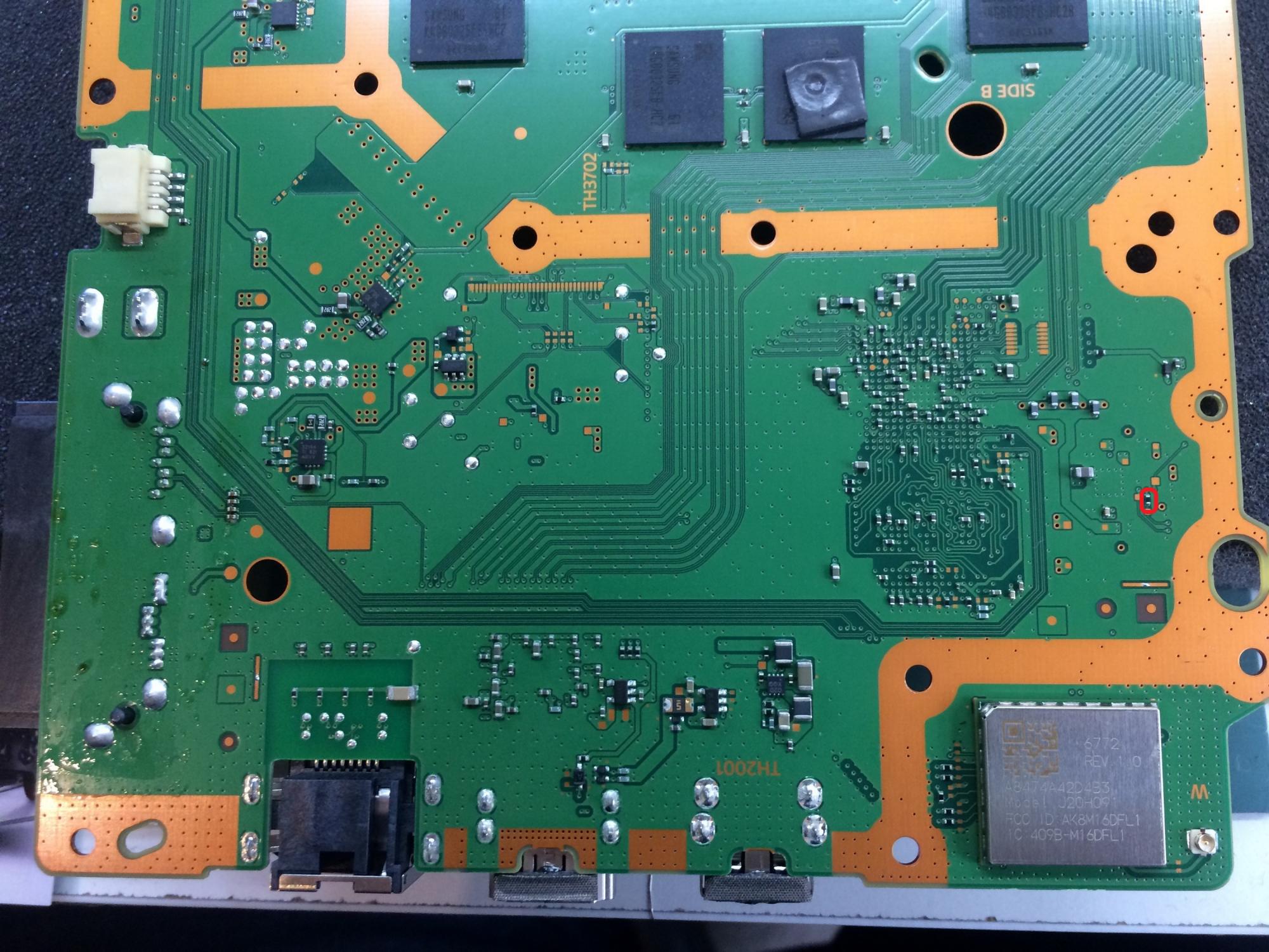

                    So found the problem, I dissoldered a little resistor, could someone tell me what resistor is it?
                    • ngth82
                      • Jul 2015
                      • 541
                      It's likely just a pull up or pull down resistor. Can you identify if one of the pads is connected to a power rail or ground? If so, a pull up, or a pull down resistor is likely - in which case, start with a 10kOhm resistor.
                      Other questions:
                      - What's the board model number? (alternatively, what's the PS4 model number?)
                      - What's on the primary side in that general area?
                      -Thomas

                        So none of the pad is connected to ground (I tried to see if there's continuity with the brown pad on the board, I'm a noob sorry). Also the PS4 is a SLIM CUH-2016A B01Y, motherboad SAD-001 1-981-279-21. On the primary side there's the NOR chip and the southbridge
                        On another forum they says that is a 22 Ohms.

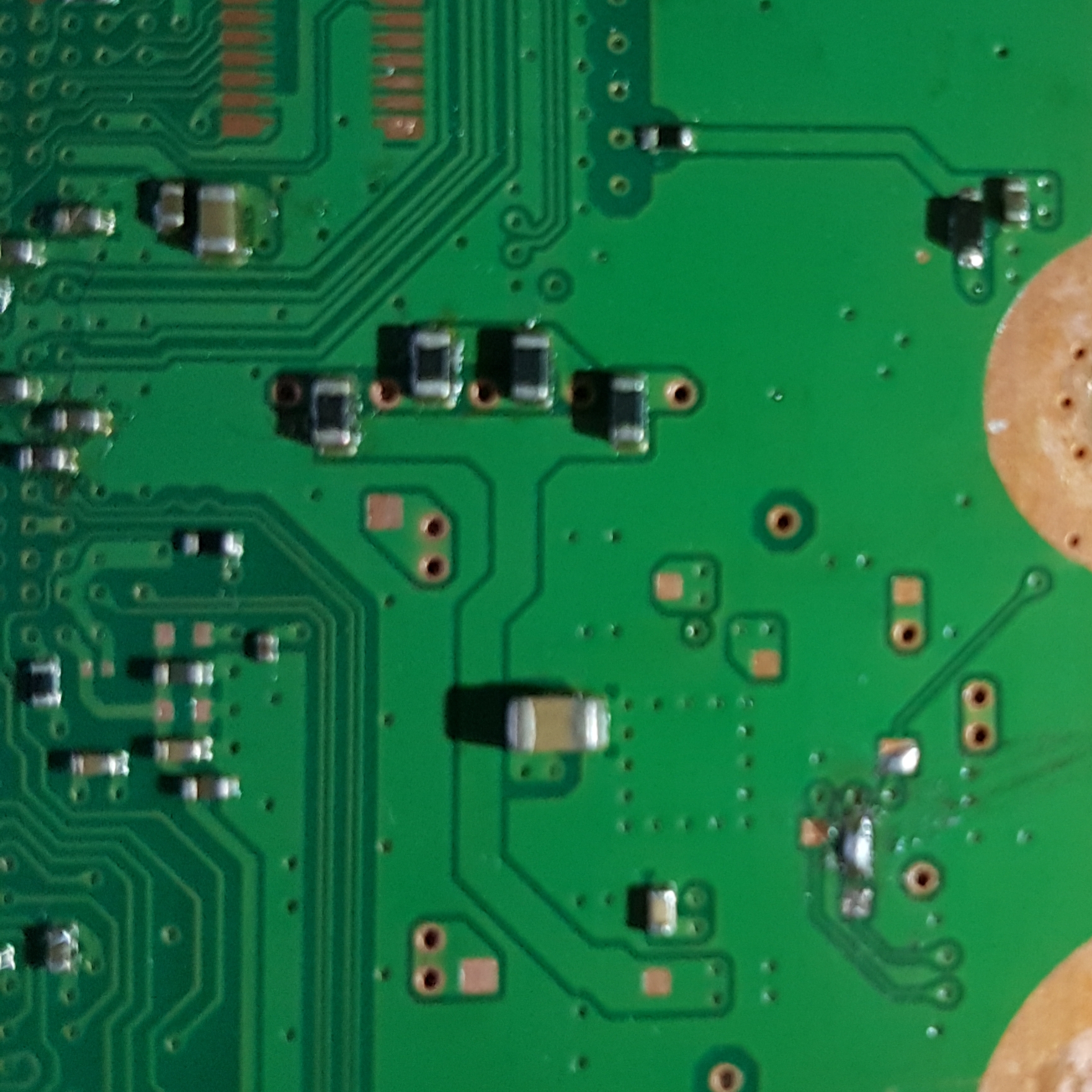

                          Here's a closer look at my motherboard
                          • ngth82
                            • Jul 2015
                            • 541
                            If it's not connected to GND or VCC, then it's probably a series resistor - 10 to 33 Ohm seems reasonable.
                            I compared your top and bottom pictures and traced where it goes. Looks like a 5-6 mil wide microstrip trace from the IC (top side), to a through hole via to the bottom side, the (missing) resistor, then a via to an internal layer (no microstrip trace on the top side).
                            There's no datasheet for that IC either... but with the pics you provided, its a series resistor for the signal to snub out any over/undershoot caused by the driver on that IC. If you don't have a small value resistor, you can bridge it to begin with. Power it on and see if it works for testing.
