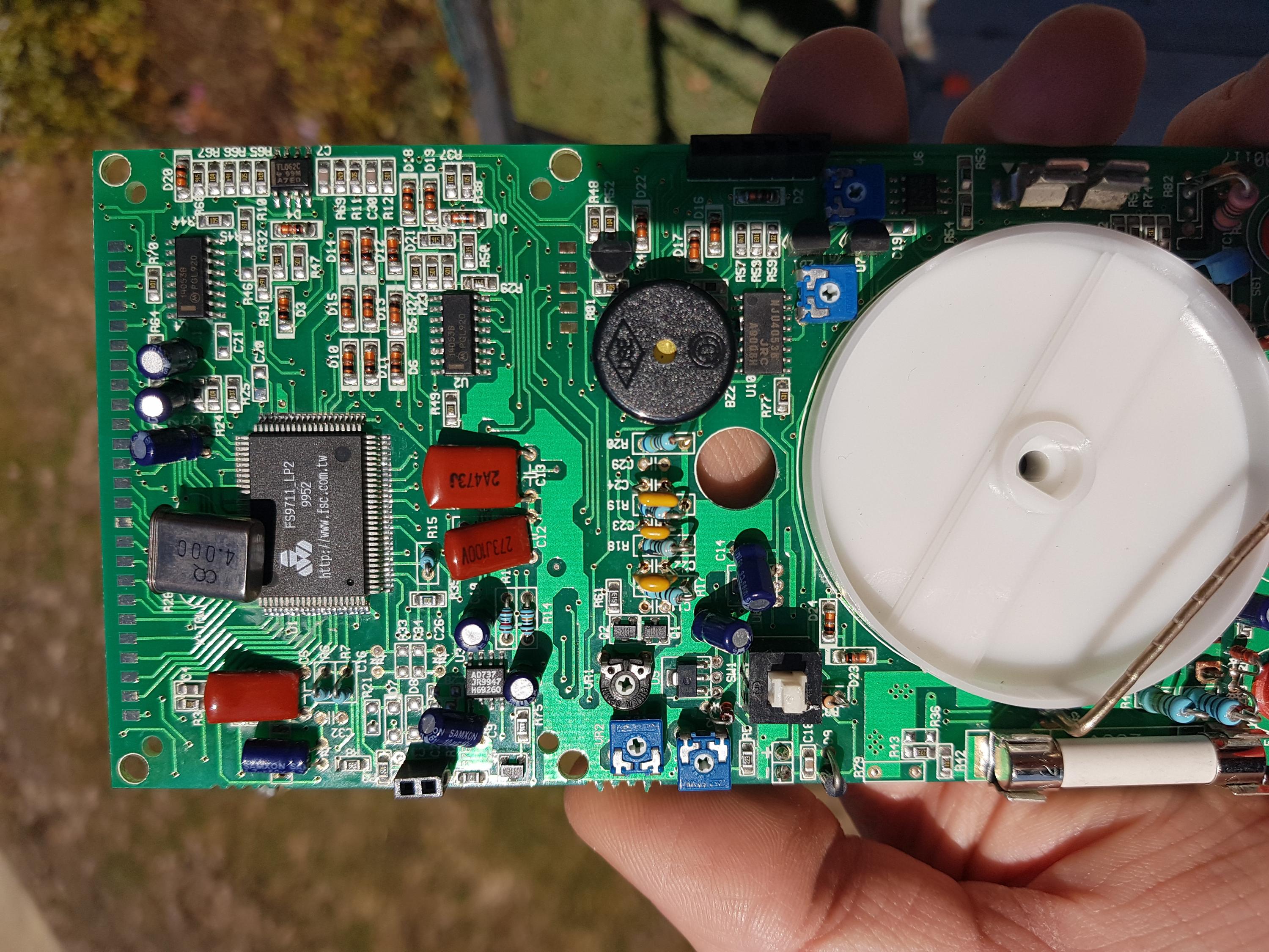

    Hi!
    I have a Craftsman 82357 that has been good to me. It's old, but we've been through a lot and I'd rather not replace it if I don't have to. It's been acting up lately so I pulled it apart and discovered a burned resistor.
    I am not 100% sure of the colour code. It looks like Red Black Red Red Green.
    It's the third red I am not so certain of. I read it as a 20.2 kohm resistor. I see R42, right next to it has Red Black Black Red Green, and I wonder if somehow the that red ban is showing red because it's burnt and should be a black band.
    What do you guys think? If it really is a 20.2 kohm resistor, I am having trouble locating one. Can anyone help me? It's a 1/2 watt 0.5%'er. Thanks!

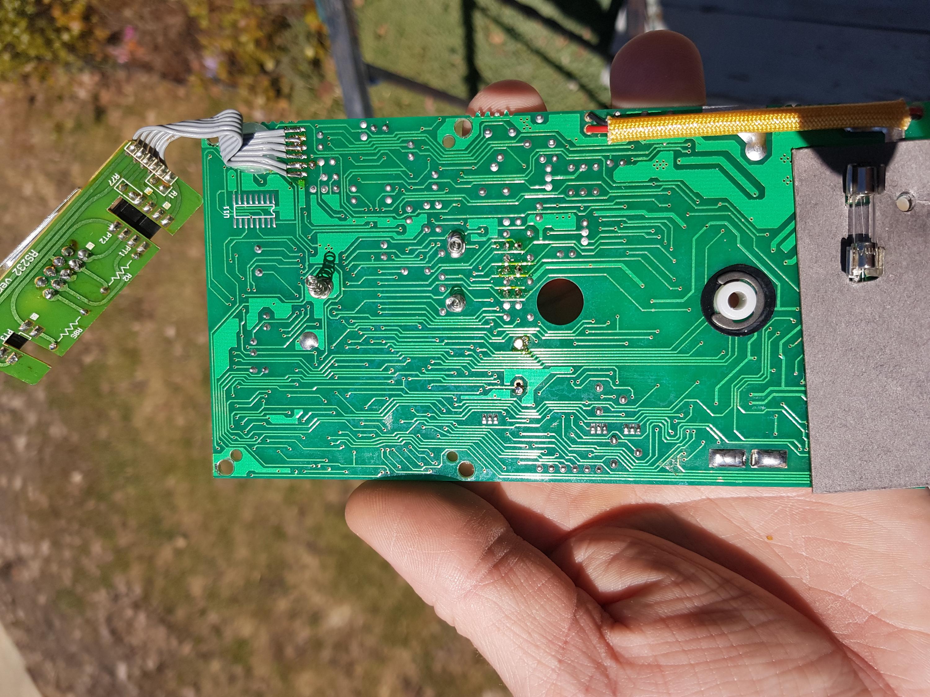

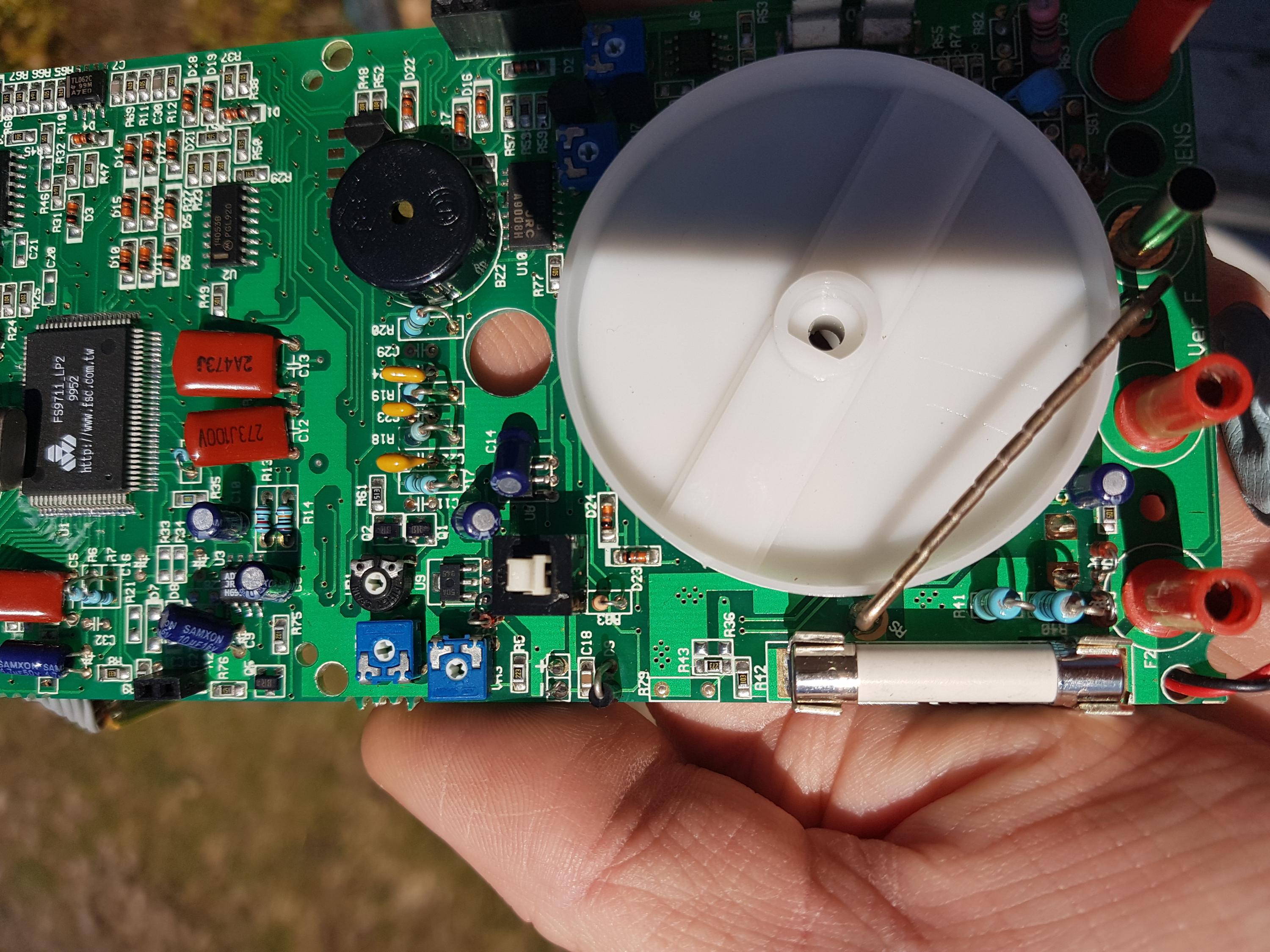

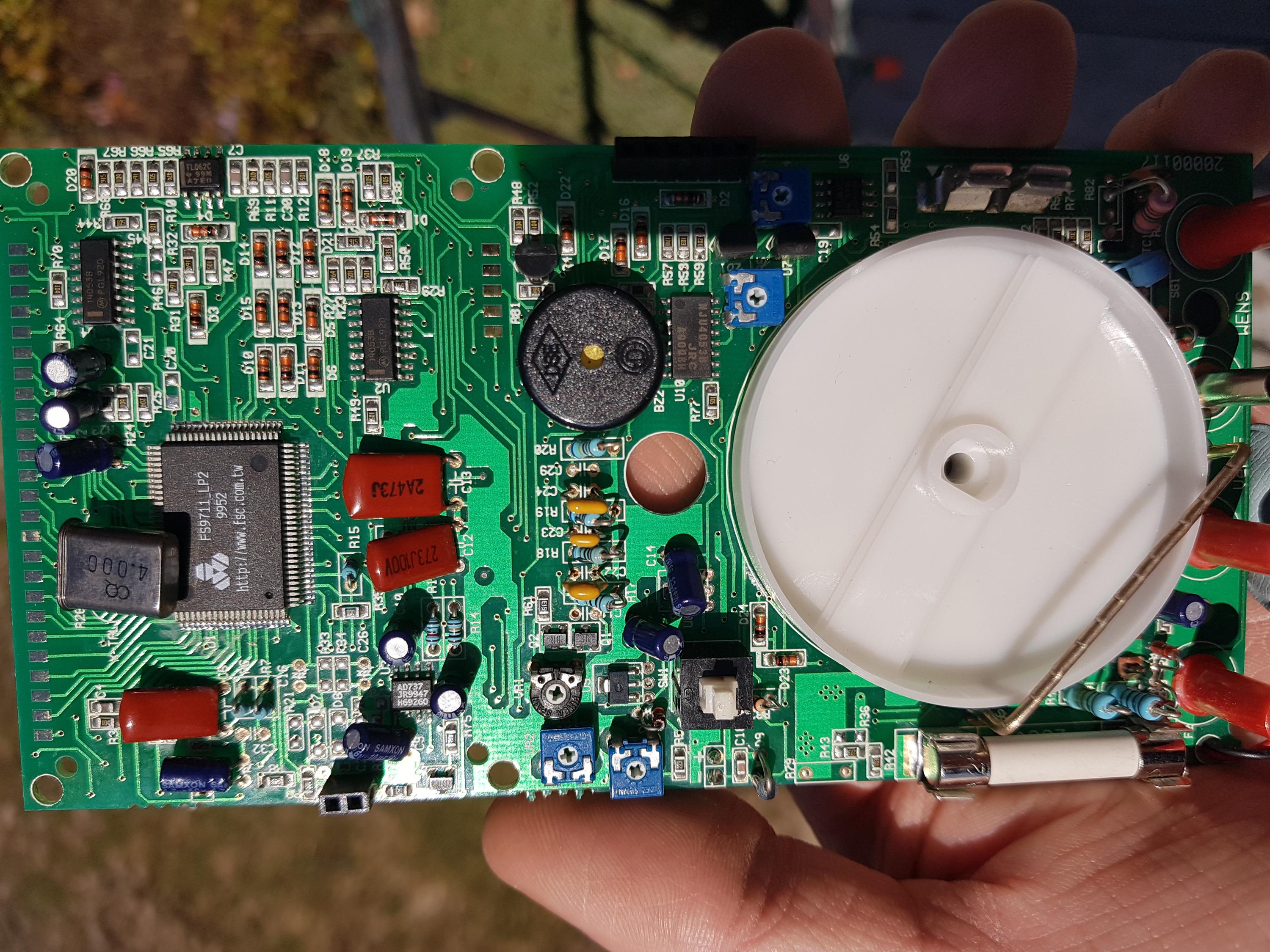

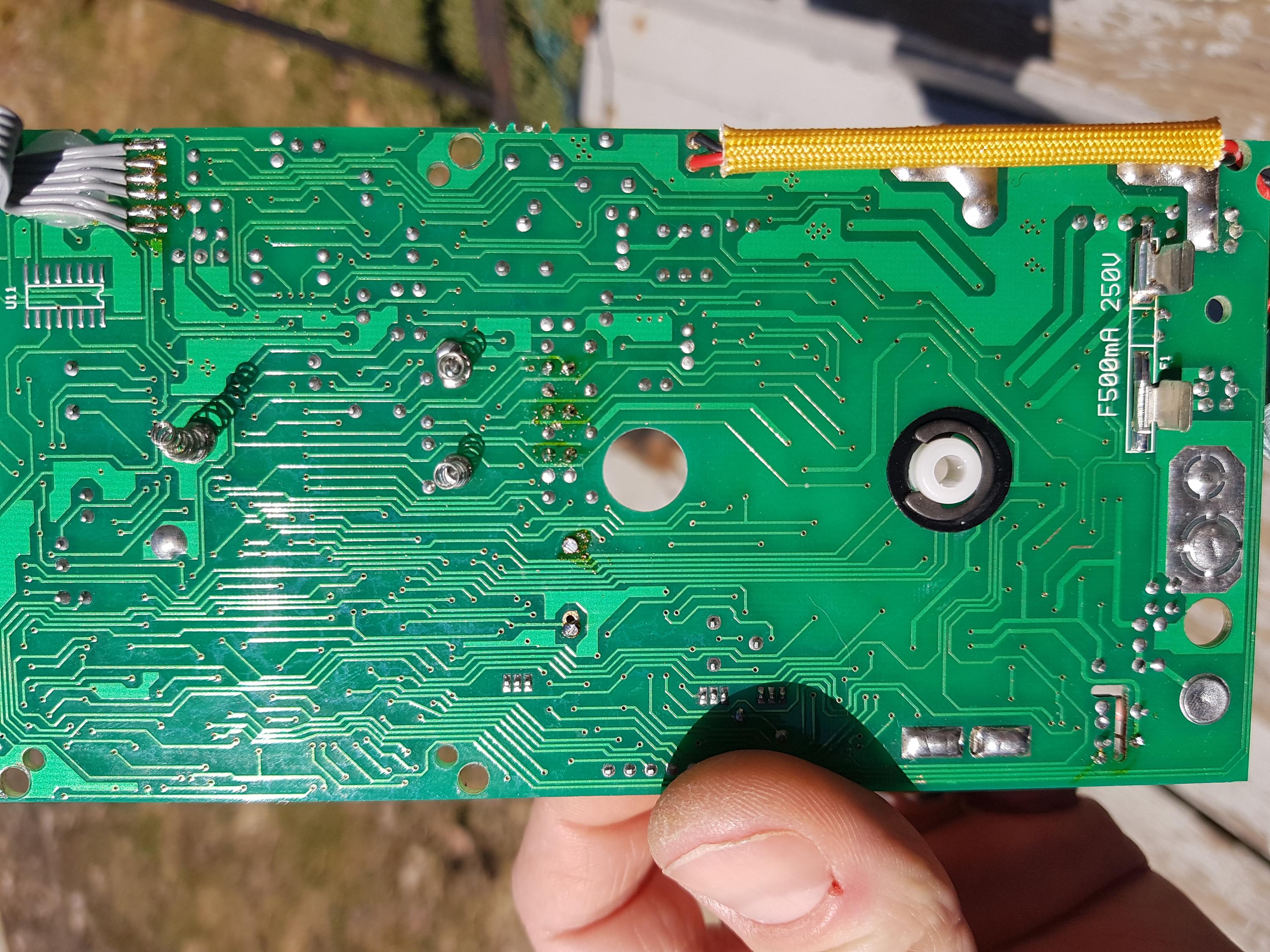

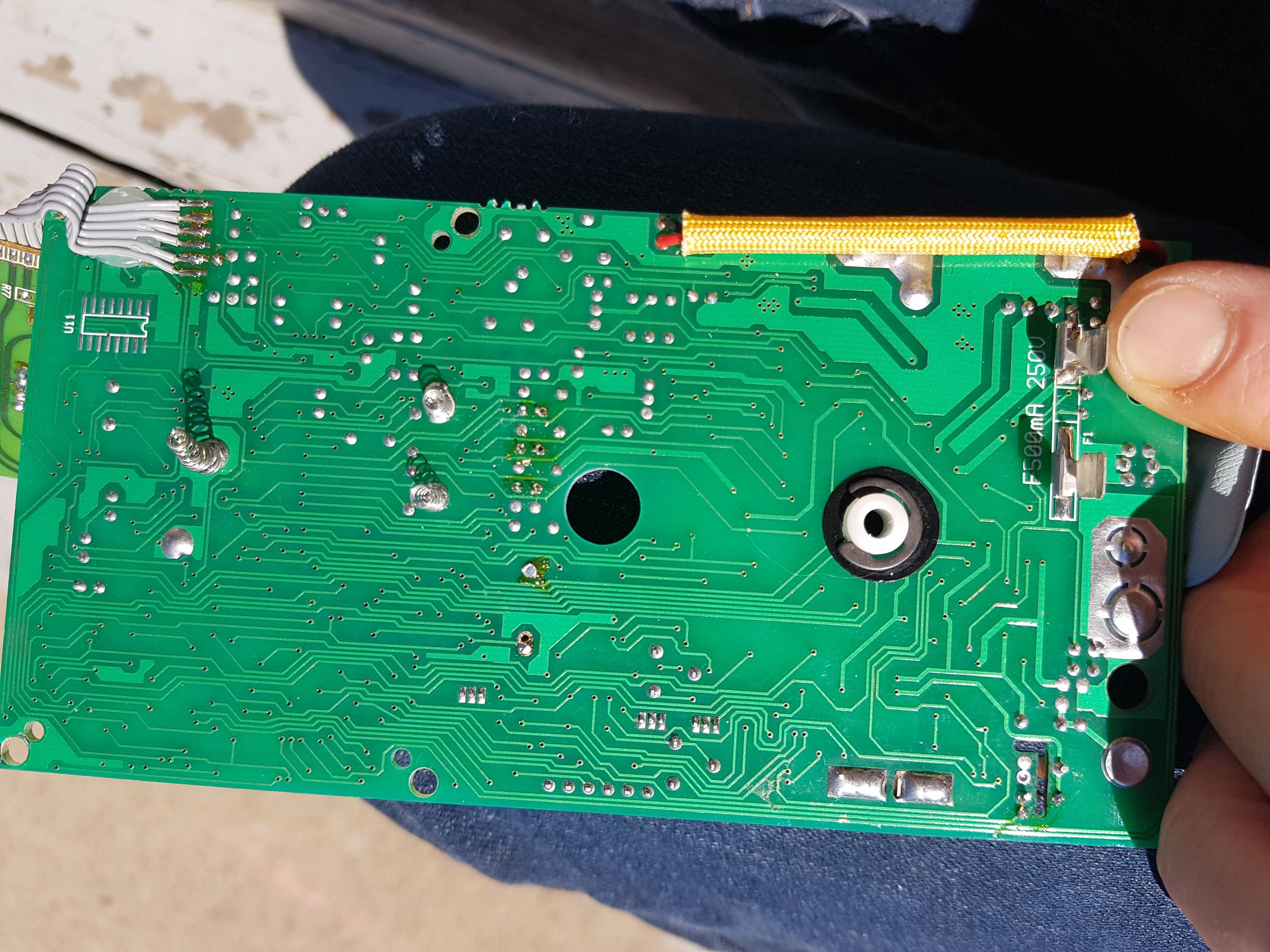

                    Here are pictures that were taken in the sunlight. I hope these help.
                    Thanks!

                      To me, they look like they connect to the fuse there, the one that's used for measuring current.

                        There are typically three current-shunt resistors in DMM's
                        0.01R for 10A range (RS)
                        0.99R or 1R for mA range (R40?)
                        99R for uA range (R41?)
                        I would put the meter in uA/mA, and using another multimeter, measure how many ohms is there across COM and current jacks (with good fuse).
                        It might be the uA shunt that is burnt.
                        Otherwise the resistor connects to the rotary switch and I can't trace that to anything in the pics.
