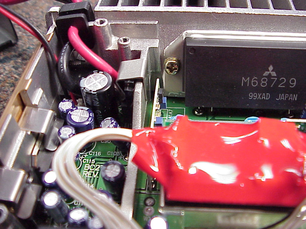

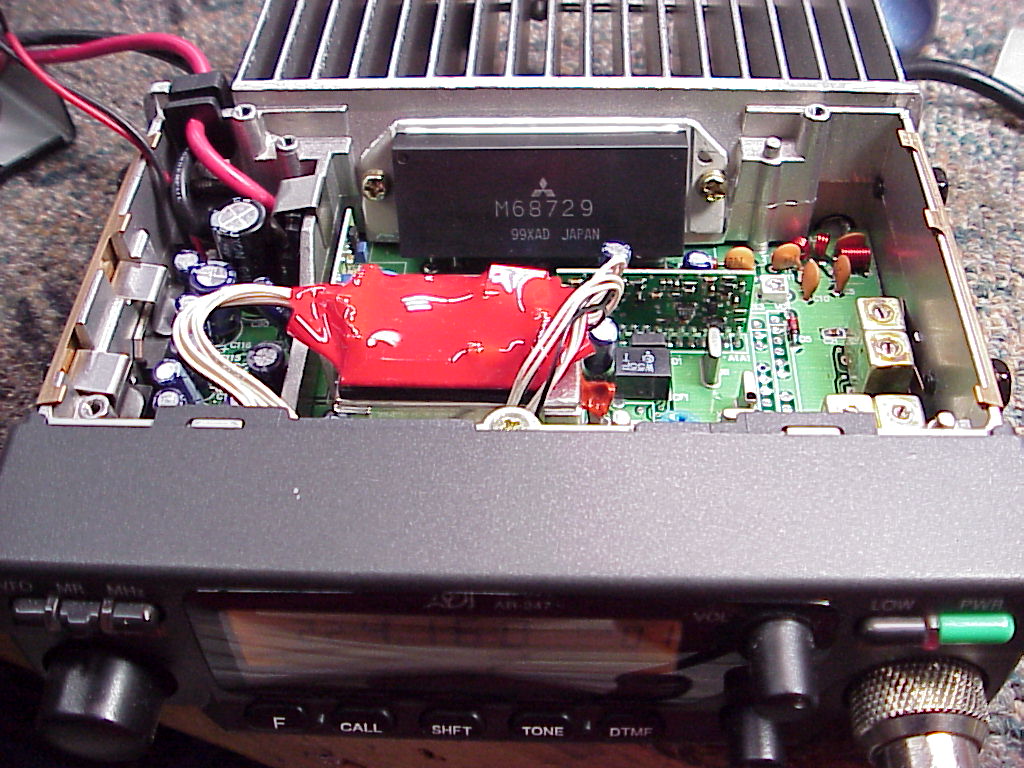

adi ar-247 alternator whine
  • kc8adu
    • Nov 2003
    • 8832
    • U.S.A!
    bad g-luxon in dc input.
    open but not bulged.
