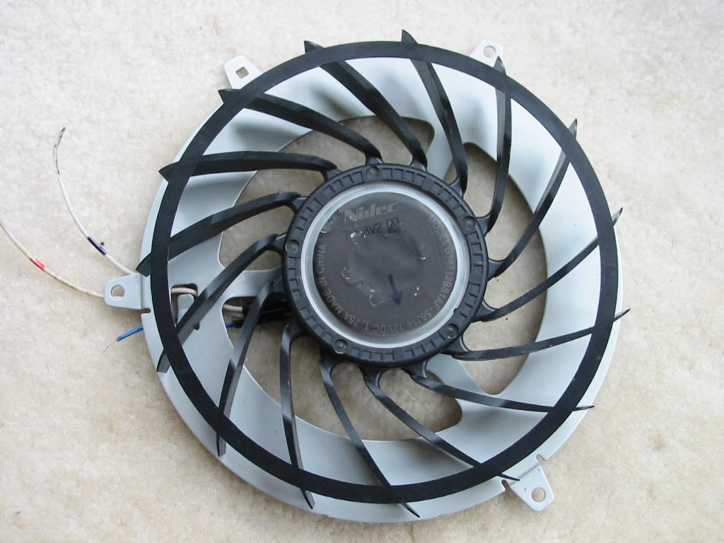

    I will start with an NBM-MAT 140 mm squirrel cage fan, model BG1402-B045-P00.
    The story:
    Back when I worked in the console repair shop in 2012, there was a technician there that didn't know much about electronics at the time. One day, he thought that he could plug a 12V PlayStation 3 fan into the wall to test it and it would work. He thought it would just spin faster. His logic: spin 10 times faster, because the wall provides 10x more voltage (120V AC here in the US.)
    Needless to say, when he attempted to run the fan like that, there must have been a small 4th of July fireworks show. I wasn't there when it happened, but I saw the fan in the trash and asked what was wrong with it and why it was thrown away. He said it was burned. He also gave me another one that he burned in a similar way (more on that in a bit). When he explained what he did, I was shocked and amused at the same time – the guy was dead serious. It was hard to keep a straight face, but nevertheless I explained to him why his idea/experiment failed. Hopefully he remembered. Glad I wasn't a person to give him my computers for repair. But after all, everyone has to start somewhere, right.
    Anyways, I took both bad fans with me, even though I wasn't sure what I was going to do with them at the time. They sat in storage for maybe 2-3 years until I had to make an order from Digikey for some parts and decided why not pitch in a few more dollars to see if I could get these fans going.
    Granted, one can buy replacement PS3 fans on eBay for around $10, the repair wasn't worth it from an economical stand point. But I decided to do it anyways, mainly to see if those fans were revivable. And I also wanted to have a working PS3 fan, just in case I ever think of a project that might need it.
    With all that said, here are some pictures of the fan and the aftermath of being plugged in to 120V AC.
    The fan shot:
    Label:
    Look at that current rating: 2.9 Amps at 12V! That is almost 35 Watts of wind power!!! I've ran one at full speed out of its cage before, and they are scary.

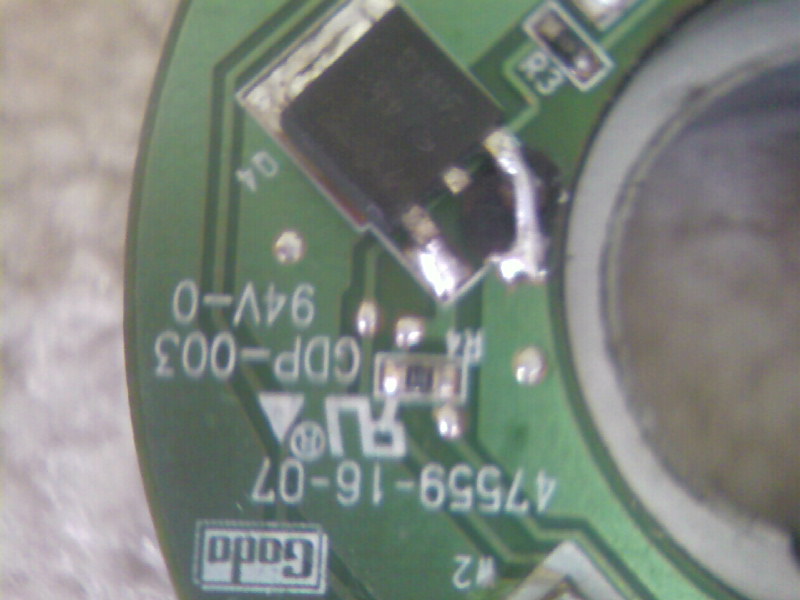

    Hmmm... I think I have found the source of the sooth – look at that MOSFET!
    Say what now? Did I hear anyone say it doesn't look that bad? Well here is a close-up for you then:

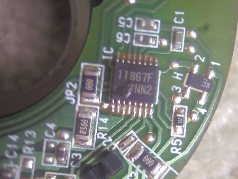

    And even the controller (a Sanyo LB11867FV single-phase variable speed controller) took a hit:
    https://www.badcaps.net/forum/attach...1&d=1500759436
    Mmmm. Well done!
    That said, it wasn't just one FET and the controller that were bad – ALL of the MOSFETs on the board were shorted on ALL pins. I suppose that is one good reason NOT to plug fans directly in the wall.
    Of course, before I could order any parts, I had to find what else was bad. So I started removing components. As soon as I tried to remove the incinerated FET, it just fell apart.
    But eventually, I got everything that was bad removed.
    Worth noting here is that SMD resistor R15 at the top was also open. It is in series with a bunch of ceramic caps, which filter power to the FETs and reduce EMI from going back to whatever the fan is powered from. I'm not sure why NMB put the resistor in series with those caps, as that essentially increases their ESR to the value of the resistor (it was a 0.036 Ohm resistor, if I am not mistaken). In any case, had the caps been connected directly without it, there is a chance they could have taken the hit instead of the MOSFETs and possibly saved everything else. Judging by the blown resistor, looks like they did short out from the over-voltage too, which is why R15 opened. However, my multimeter indicated they were fine - and they were, indeed.
    As such, I replaced R15 with a jumper wire (figured it wouldn't hurt anything) and also the rest of the blown components: that is, four MOSFETs (two 2SK4067 N-channel FETs and two 2SJ646 P-channel FETs) and the controller. Miraculously, everything else was fine, including the Source resistors for the FETs. For the N-ch FETs, I used two 4813NH units from a Xbox 360 motherboard (they look burned because they were removed with a blow torch as an experiment ) and for the P-ch FETs, I used P4051L - not exact replacements, but close enough.

    That one FET burned so bad that even the trace for its Source pad was burned. As such, I had to bridge it with some wire and solder. It is a miracle the Source resistors survived.
    It also took a bit of eye-strain to hand-solder that controller, as this was my second SSOP IC I soldered by hand (SOIC are much easier). I do have hot air as well, but I never got to like using hot air. When doing these SSOP/TSOP packages, make sure your iron has almost no solder on its tip. Even a tiny bit too much can cause a bridge. Drag soldering was not possible here, but I will go over the details of why a little later below.
