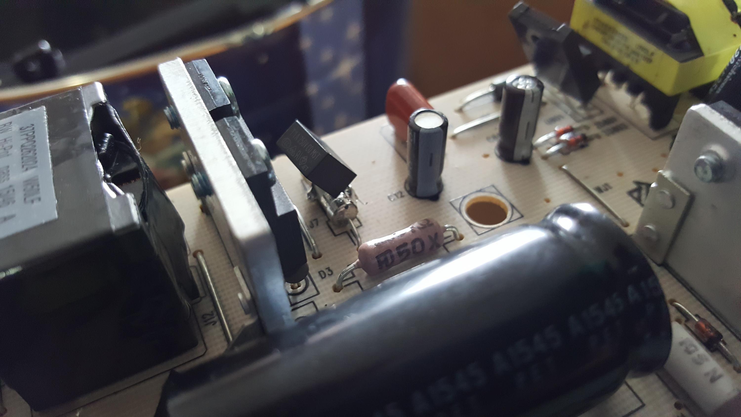

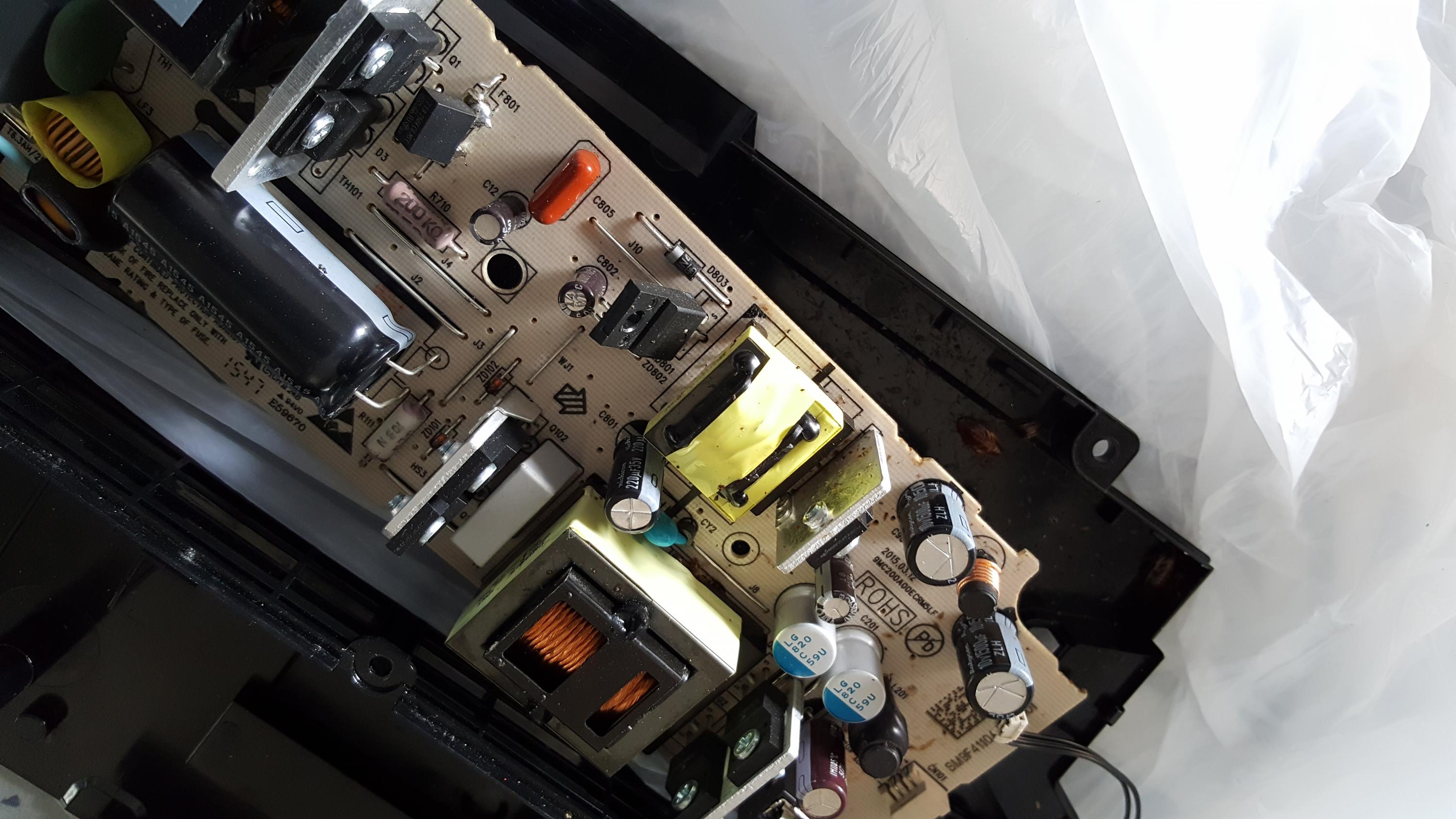

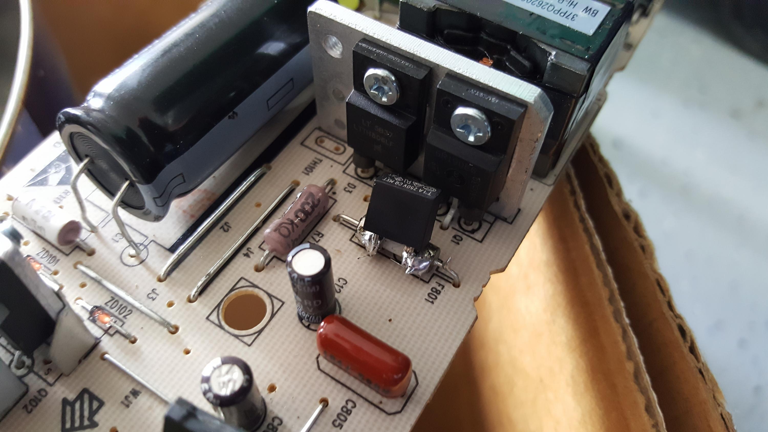

    Is that supposed to be like that (F801)? Is that a fuse on a fuse? Trying to figure out if someone did that trying to fix the PSU or if it came from China like that. The system had been opened and was missing a bunch of screws. I think they saw the cockroaches and put it back together.
    Bonus pics of cockroaches living under the PSU. They seem to prefer the primary side.
    N14-200p1A PSU on a newer system with the non-touch power buttons.

    that is bodged and not factory ... i noticed a strand of wire too that they probably used first before adding the fuse .

      OK, thanks. I will order some fuses and see if it was just a cockroach the caused the short and blew the fuse.

        Hell no PS4 comes like that from the factory. Someone monkeyed around in there.
