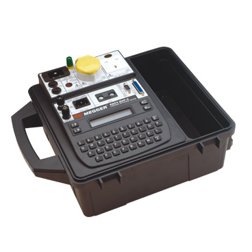

    So I have one of these in the workshop which I have been using for some years to test equipment under repair before returning to clients, the machine has been regularly calibrated without issue.
    Just recently though I have found there is a timing issue with each test for instance test for electrical resistance (set to 5 seconds) is taking less than 2 seconds, an earth bond test (set for 5 seconds) again takes less than 2 seconds. The problem seems to vary and affects all of the instrument tests.
    I have carried out a factory default settings reset and it has made no difference, I have yet to disassemble the machine so include a picture of the unit for reference, I have the full service manuals.
    thanking anyone who may be able to offer advice in advance

    probably using a capacitor for a timing circuit.

      There is a real time clock module (BQ4847YMT) which contains a Lithium Battery power source, a crystal controlled Clock / calendar module. This clock integrates, a time of day, 100 year calendar, CPU supervisor watchdog, a battery and timing crystal, the chip is socketed.
      looks to be the likely culprit

          Replaced BQ4847YMT real time clock module appears to have solved the problem
