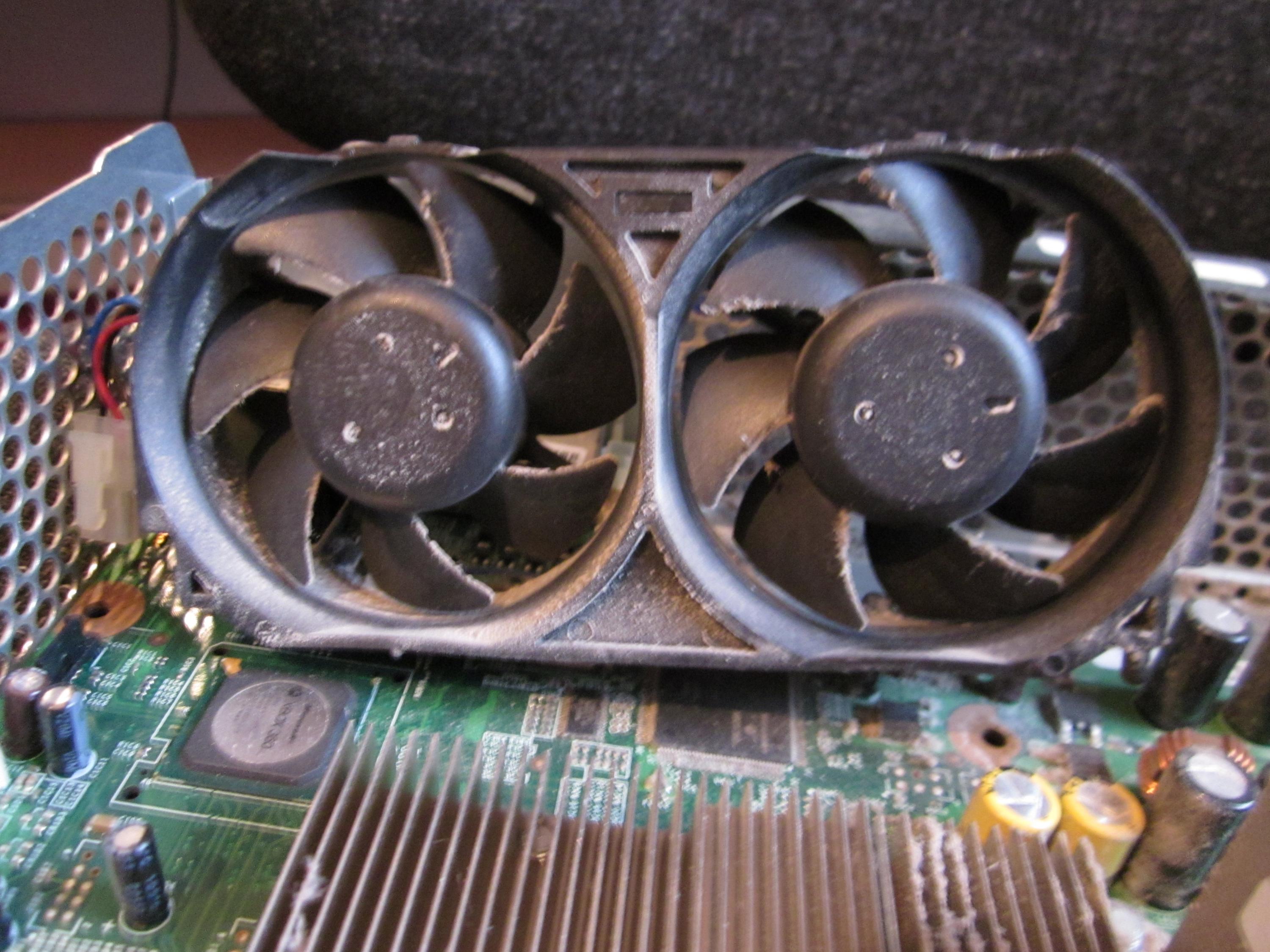

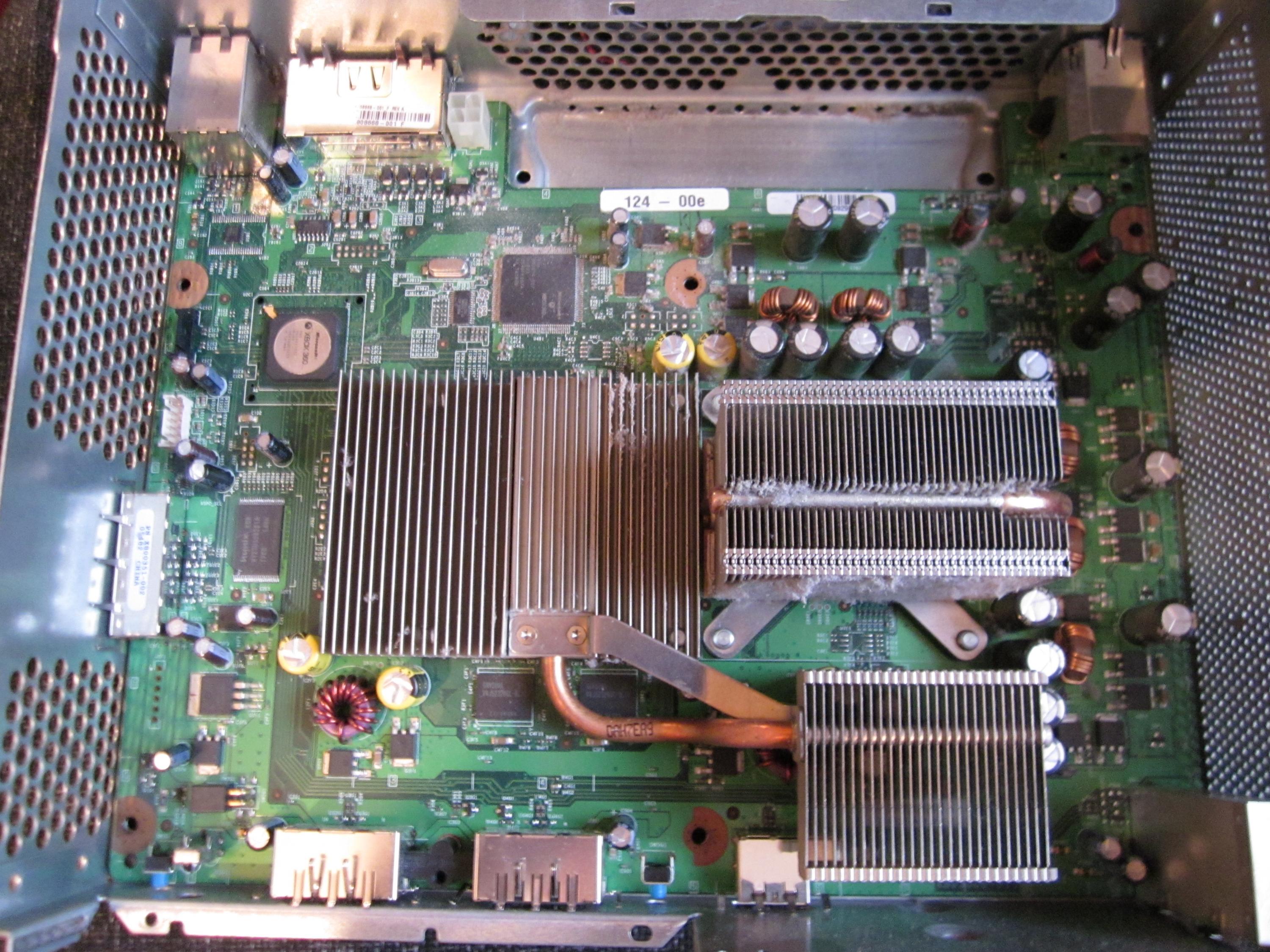

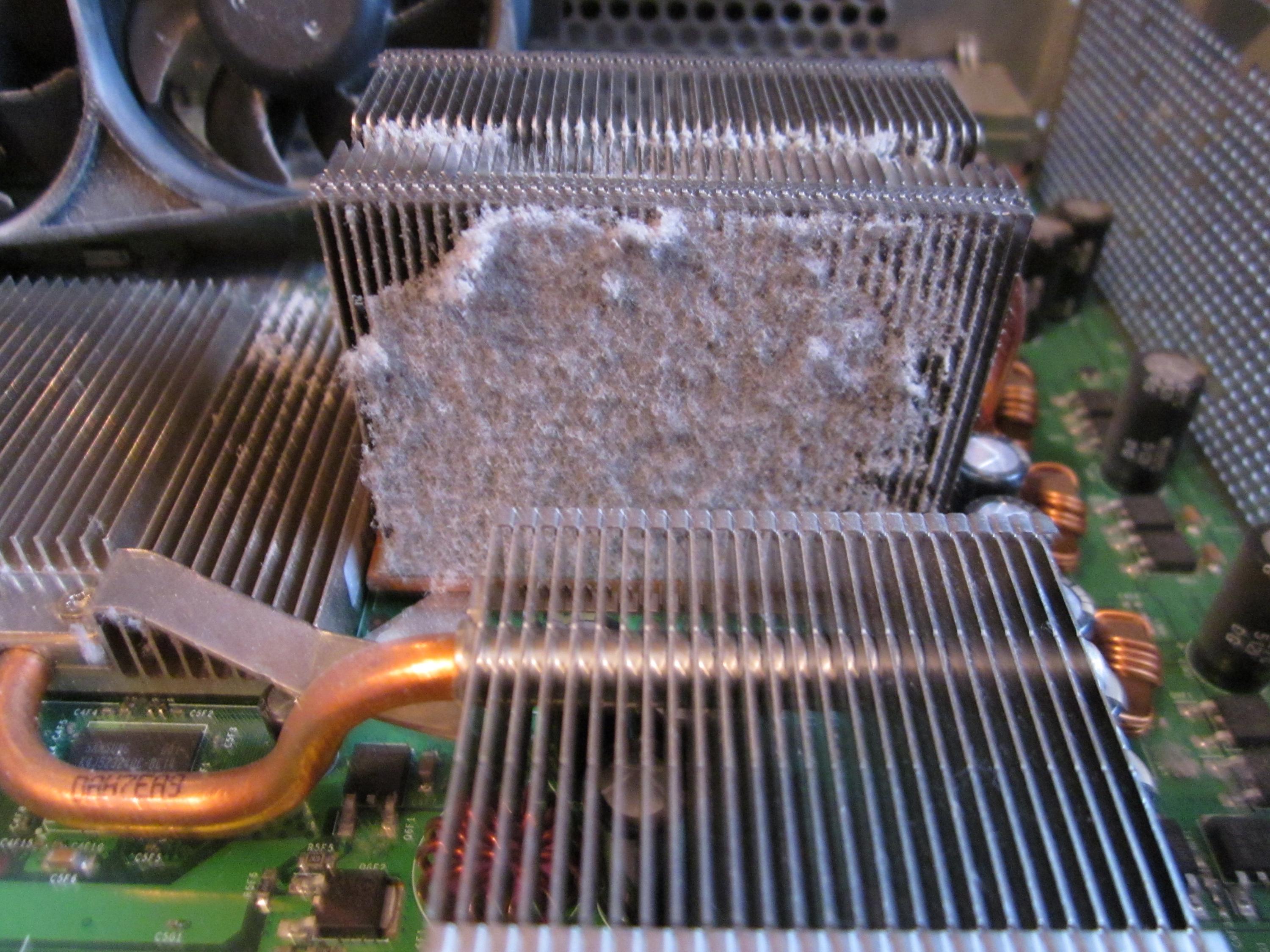

    Hey everyone, in a nutshell I have an Xbox 360 that isn't working. I didn't buy the console so I don't know what model it is etc... I do, however, know that it has a Xenon motherboard after following a YouTube video that helped me identify it.
    When I cracked open the case I found the motherboard missing around 20 main capacitors and I would love some help in identify what I should replace them with. I only have the cXXX code that is printed on the motherboard where the capacitors should be.
    If anyone could tell me what type of capacitor I need for the following I would be very grateful:

                  I sectioned these for you, so you can understand what each cap does
                  Stand-by 1.8V rail (generated from 3.3V stand-by)
                  - C5B4 - Nichicon VZ 16 V, 100 uF, 5x11 mm (dia. x h)
                  Stand-by 3.3V rail (generated from 5VSB)
                  - C5B2 - Nichicon VZ 16 V, 100 uF, 5x11 mm (dia. x h)
                  5VSB rail from PSU
                  - C5B7 - Nichicon VZ 16 V, 100 uF, 5x11 mm (dia. x h)
                  12V rail from PSU (GPU VRM high side)
                  - C6B3 - Nichicon HN 16 V, 1500 uF, 10x20 mm (dia. x h)
                  - C7B3 - Nichicon HN 16 V, 1500 uF, 10x20 mm (dia. x h)
                  GPU V_core rail (GPU VRM low side)
                  - C6C2 - Nichicon HZ 6.3 V, 2200 uF, 10x20 mm (dia. x h)
                  - C6C3 - Nichicon HZ 6.3 V, 2200 uF, 10x20 mm (dia. x h)
                  - C7C1 - Nichicon HZ 6.3 V, 2200 uF, 10x20 mm (dia. x h)
                  - C7C2 - Nichicon HZ 6.3 V, 2200 uF, 10x20 mm (dia. x h)
                  CPU V_core rail (CPU VRM low side)
                  - C8C1 - Nichicon HZ 6.3 V, 2200 uF, 10x20 mm (dia. x h)
                  - C8D1 - Nichicon HZ 6.3 V, 2200 uF, 10x20 mm (dia. x h)
                  - C8D4 - Nichicon HZ 6.3 V, 2200 uF, 10x20 mm (dia. x h)
                  - C8E3 - Nichicon HZ 6.3 V, 2200 uF, 10x20 mm (dia. x h)
                  - C8E8 - Nichicon HZ 6.3 V, 2200 uF, 10x20 mm (dia. x h)
                  - C8F1 - Nichicon HZ 6.3 V, 2200 uF, 10x20 mm (dia. x h)
                  - C8F2 - Nichicon HZ 6.3 V, 2200 uF, 10x20 mm (dia. x h)
                  - C8F3 - Nichicon HZ 6.3 V, 2200 uF, 10x20 mm (dia. x h)
                  5V rail (generated from PSU 12V rail) for USB controllers and front ports, if I remember correctly
                  - C7F1 - Nichicon HZ 6.3 V, 2200 uF, 10x20 mm (dia. x h)
                  12V rail from PSU (5V rail VRM high side)
                  - C7F2 - Nichicon HN 16 V, 1500 uF, 10x20 mm (dia. x h)
                  - C6F3 - Nichicon HN 16 V, 1500 uF, 10x20 mm (dia. x h)
                  Worth noting is that if you have other dead 360 boards, you can use these caps interchangeably:
                  Nichicon HZ 6.3 V, 2200 uF <--> Rubycon MFZ 6.3 V, 2700 uF <--> Fujitsu FPCAP RE 4 V, 820 uF (the yellow ones)
                  Nichicon HN 16 V, 1500 uF <--> Rubycon MCZ 16 V, 1500 uF <--> Panasonic FL 16 V, 1500 uF <--> Sanyo WF 16 V, 1500 uF <--> Chemicon KZJ 16 V, 1500 uF
                  (I personally wouldn't recommend using the last two, as they are somewhat unreliable series)
                  Nichicon VZ 16 V, 100 uF <--> Rubycon YXA 16 V, 100 uF <--> Chemicon KMG 16 V, 100 uF <--> Panasonic NHG 16 V, 100 uF
                  Let me know if you need any other help with these. I have these boards for scrap (already pulled the caps) and can get most component value measurements for you.
                  As stj noted, there might be a reason why the caps were pulled from your board (probably unrepairable). I've seen quite a few 360's develop bad RAM. Not worth the effort changing it, IMO. But it could be that GPU just needs a reflow. Or, if you are very lucky, a shorted MOSFET on GPU or CPU VRM - but I've seen only one or two cases of that (used to work/help in a console repair shop). Most common problems are GPU BGA issues, DVD drive laser or stuck door, and overheating RAM chips (which is not easily repairable).

                            i can see why it has the 3 red lights now and secondary code 0102 no wonder the xbox failed look at the dust in the enclosed pictures i think i may try a reflow on this board.
                            Yeah, probably just needs a GPU reflow. The CPU BGA rarely fails (even though yours has all of that dust on its heatsink).
                            Also, when testing these boards, I highly recommend you have the PSU nearby so that you can see its indicator light. Normally, it is yellow when the Xbox 360 is OFF. But after you power ON the Xbox 360, if the light on the PSU flashes Red or goes back to solid Yellow (after flashing Green for a quick moment), then you likely have a short-circuit somewhere (usually GPU chip itself, GPU BGA, or RAM chips). Occasionally, you may also hear a slight buzzing sound coming from the MOSFETs near GPU - this is also a good indicator of a short-circuit in GPU, GPU BGA, and RAM.
                            If I remember correctly, 0102 may also cause MOSFETs Q2G1 and Q3F1 near the RAM chips to overheat (as well as coil L2F1). This is a sign that there is a short-circuit in either GPU, GPU BGA, or RAM. The PSU will not detect this short-circuit and its light will continue to be Green. Therefore, I always check those two MOSFETs to see if they are overheating. Just put your finger on them - if they turn burning-hot within 5-10 seconds of turning ON the Xbox 360, you have a short-circuit on that rail.
