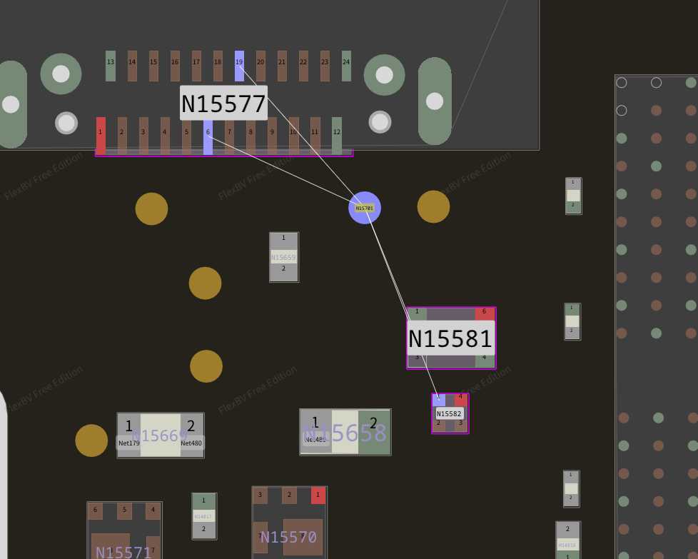

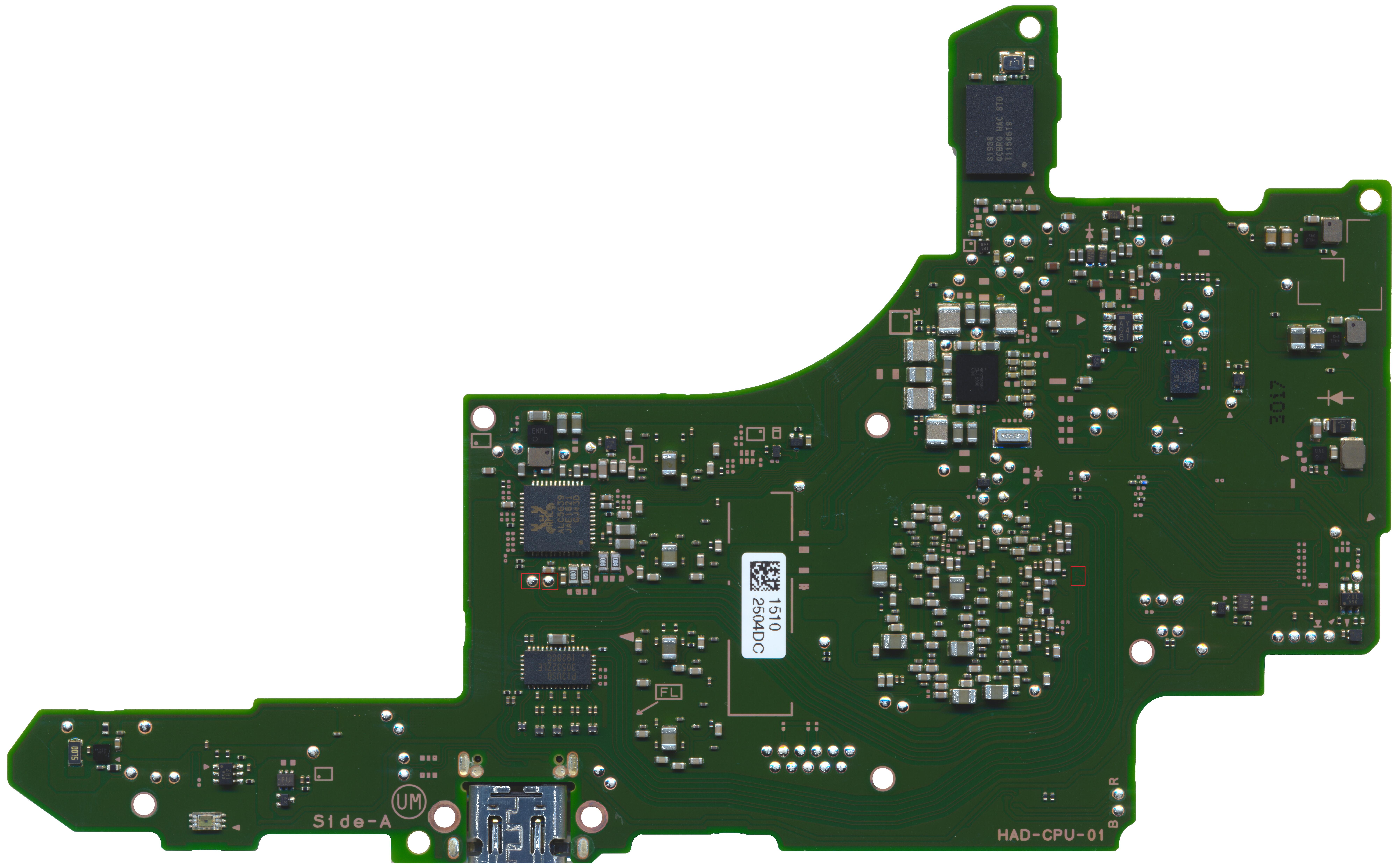

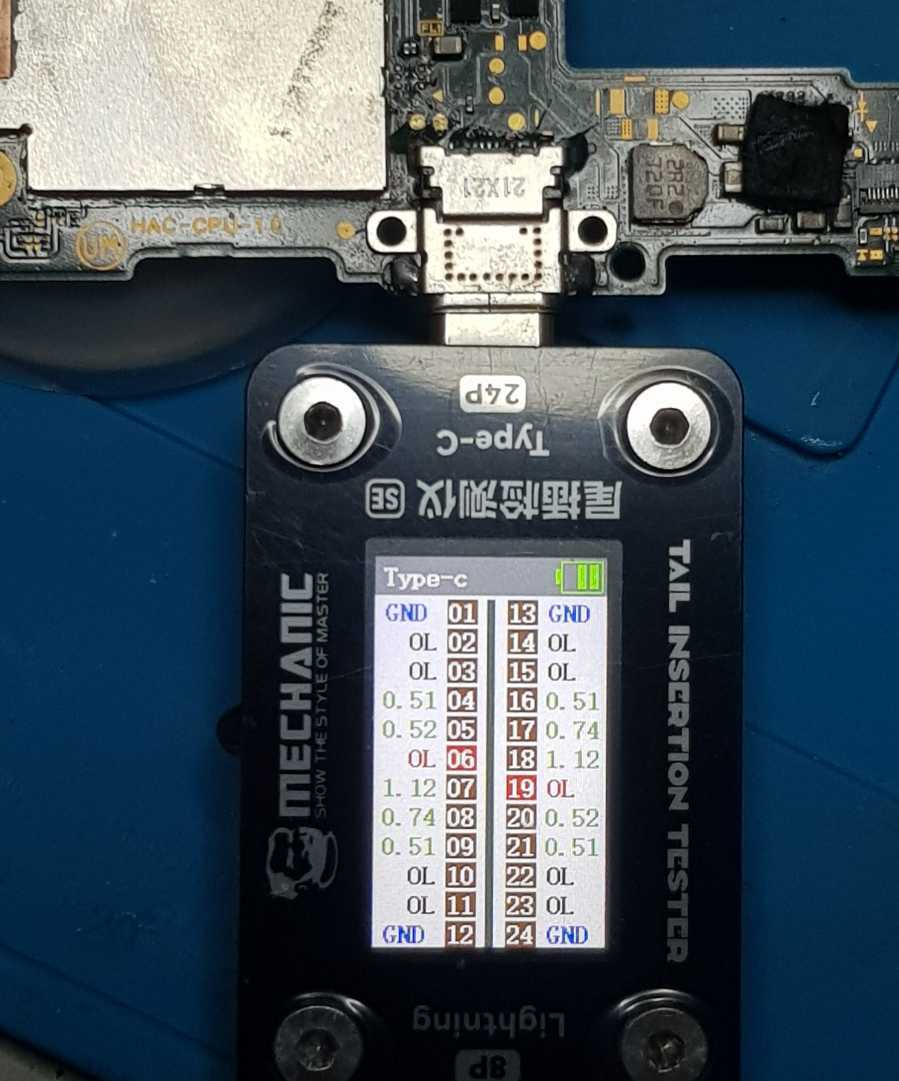

    Hi everyone:
    Anybody know anything about a N.switch without resistance in 6 & 19 pin (D+) in USB C conector? This is a HAC-10 board, all conector pins al good. Console runs ok but charging in very very slow 005 mAp.
    Thx!!!
  • mod1215
    • May 2022
    EMI Filter N15581 on your first Picture blowen? If not, D+ is internal blown on APU/CPU/SOC. 1% chance, APU disconnect from board.
    I marked two points where is D+ and D- is going. On the right you must scratch the coating to mesure. If on this place also O.L.
    • taso
      • Jun 2020
      • 6
      • spain
      Thx! MOD1215. The EMI filter is ok, i desolder it to make sure. After making sure it was the same, I reflowed the CPU with the same result. I'll check the lines you mentioned in a bit.
      • taso
        • Jun 2020
        • 6
        • spain
        Sorry for delay. D+ and D- have continuity with your marked points. The charging is good with the original PSU, but if use otherone not. Console works fine on TV dock, but do not charge although it maintains the charge percentage during use in the dock and does not discharge. I will test if it charge with console off.
        • taso
          • Jun 2020
          • 6
          • spain
          With console off in dock the charge is correct.
