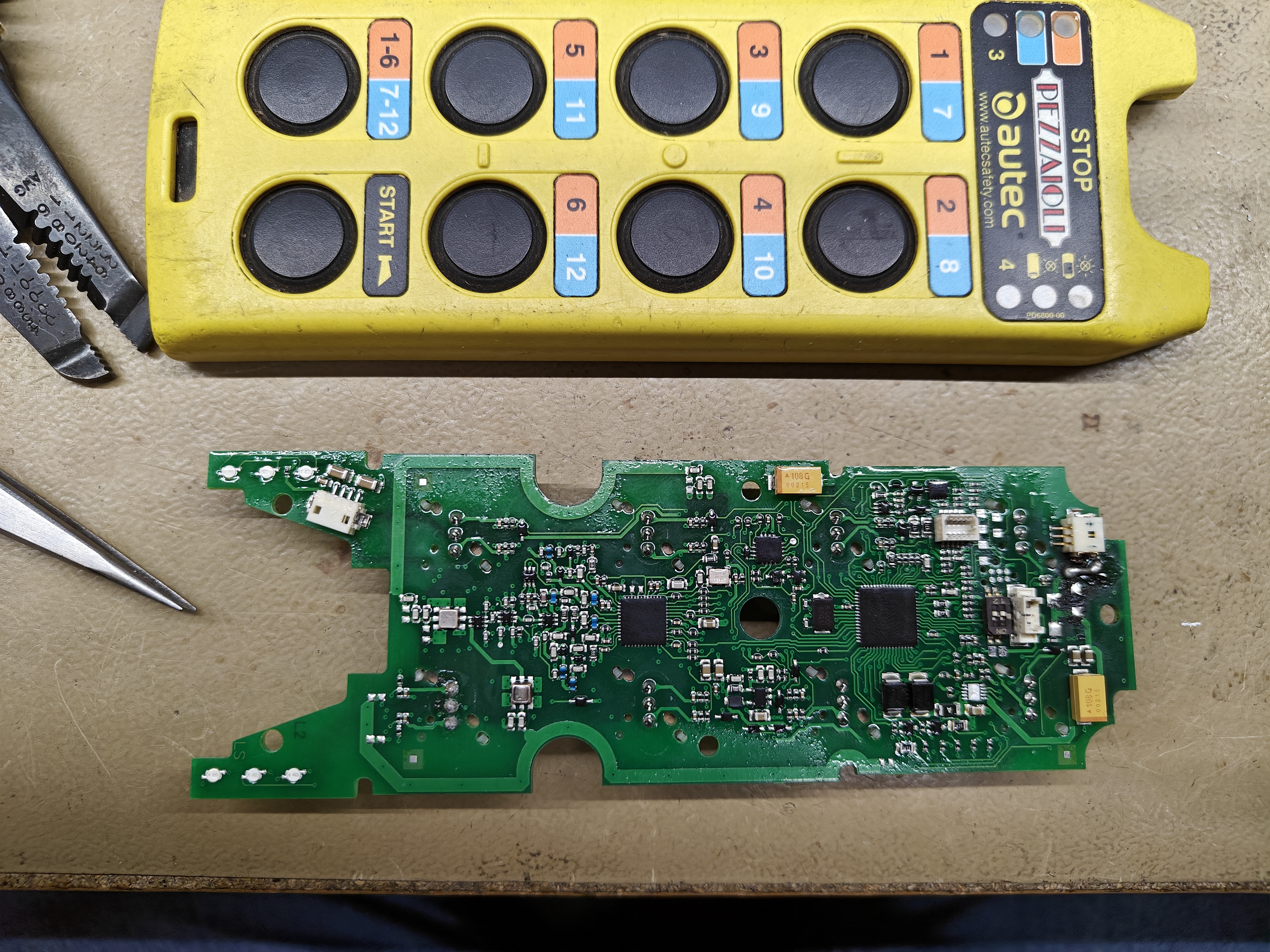

    I am trying to repair an Autec A08 remote which does not turn off and depleting the battery

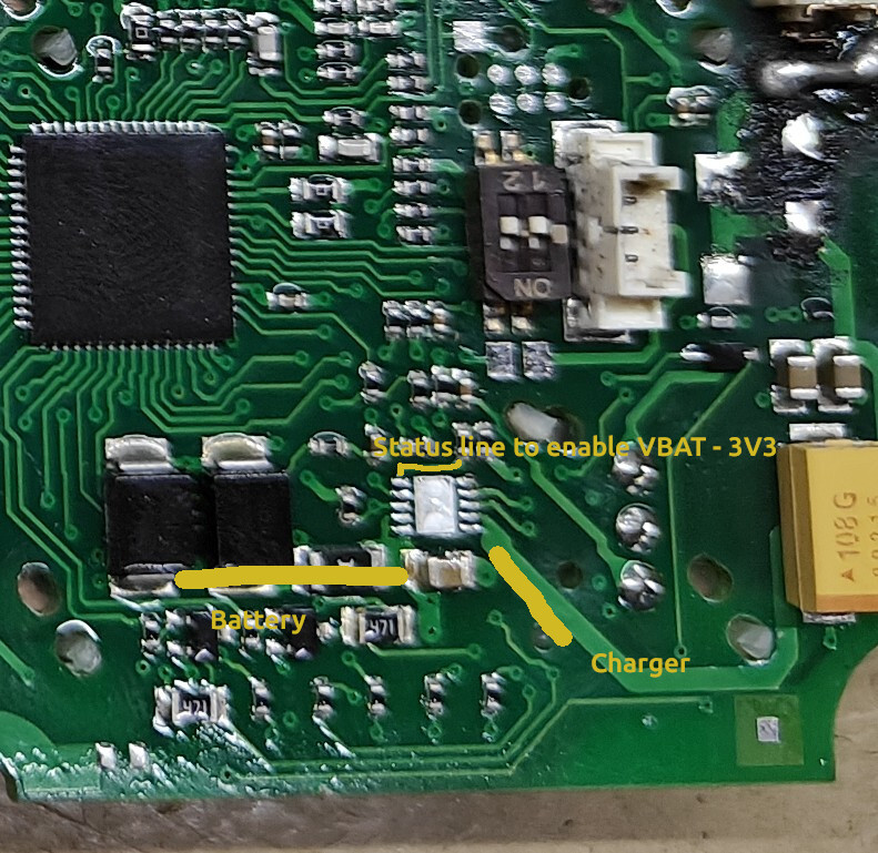

    I spotted a burn mark on the li-ion charger IC what I removed, and after the removal the power ON LED is no longer continously on, however it does not turn on at all.
    I traced the enable signal of the VBA - 3V3 DCDC LM3674 converter and it is wired to the charger IC through some passive network.
    Likely to disable the power for the MCU/RF part during charging in the bay.

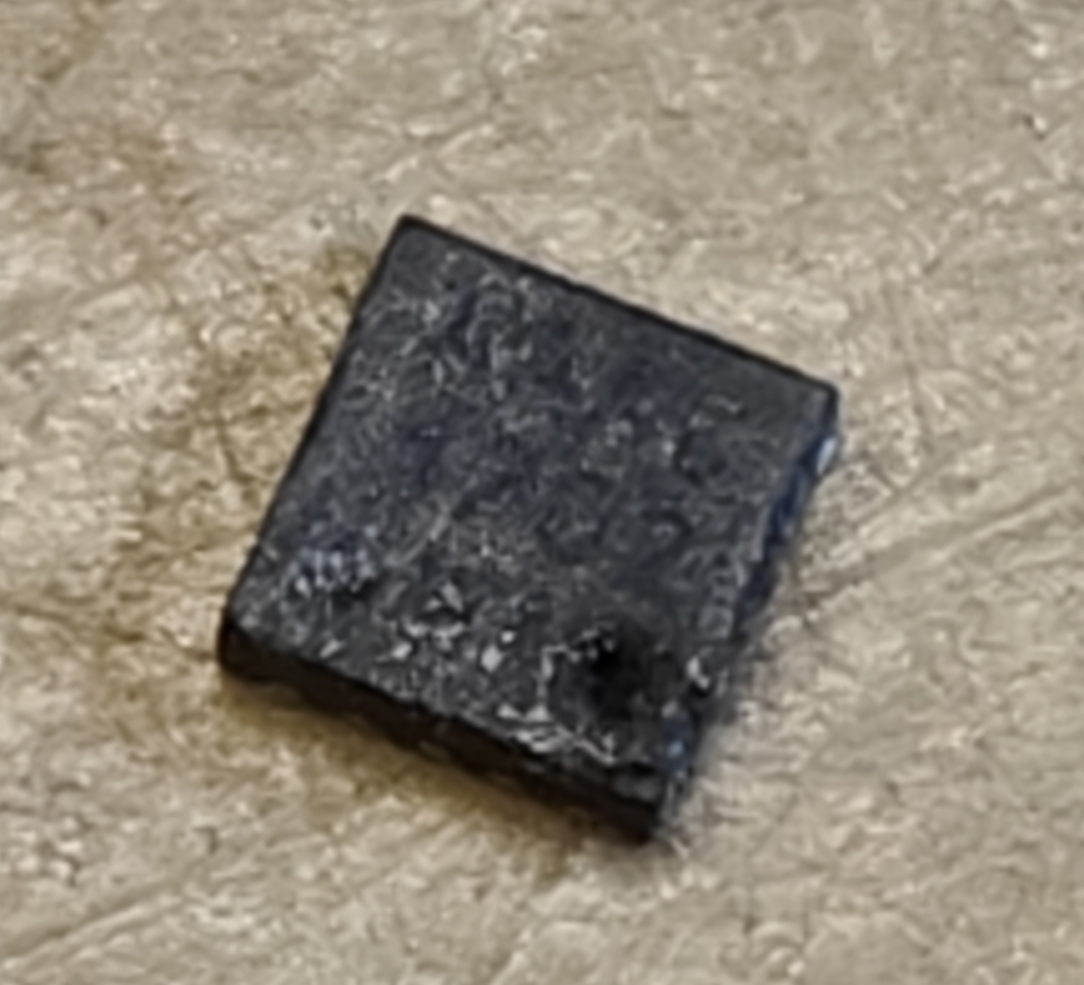

    After investigating the IC further I got to the following:
    The markings were barely visible as the board was coated, my best readout from the IC was:
    AAAC
    1702
    I have attached an photo from the IC itself but it is quite useless in quality.
    The board itself is made from mostly western semiconductors (Atmega128A, MSP430, LM3674).
    Does anyone has a good tip about what type of IC could it be?

    For the shake of posterity: finally figured out: MCP73833-FCI/MF
