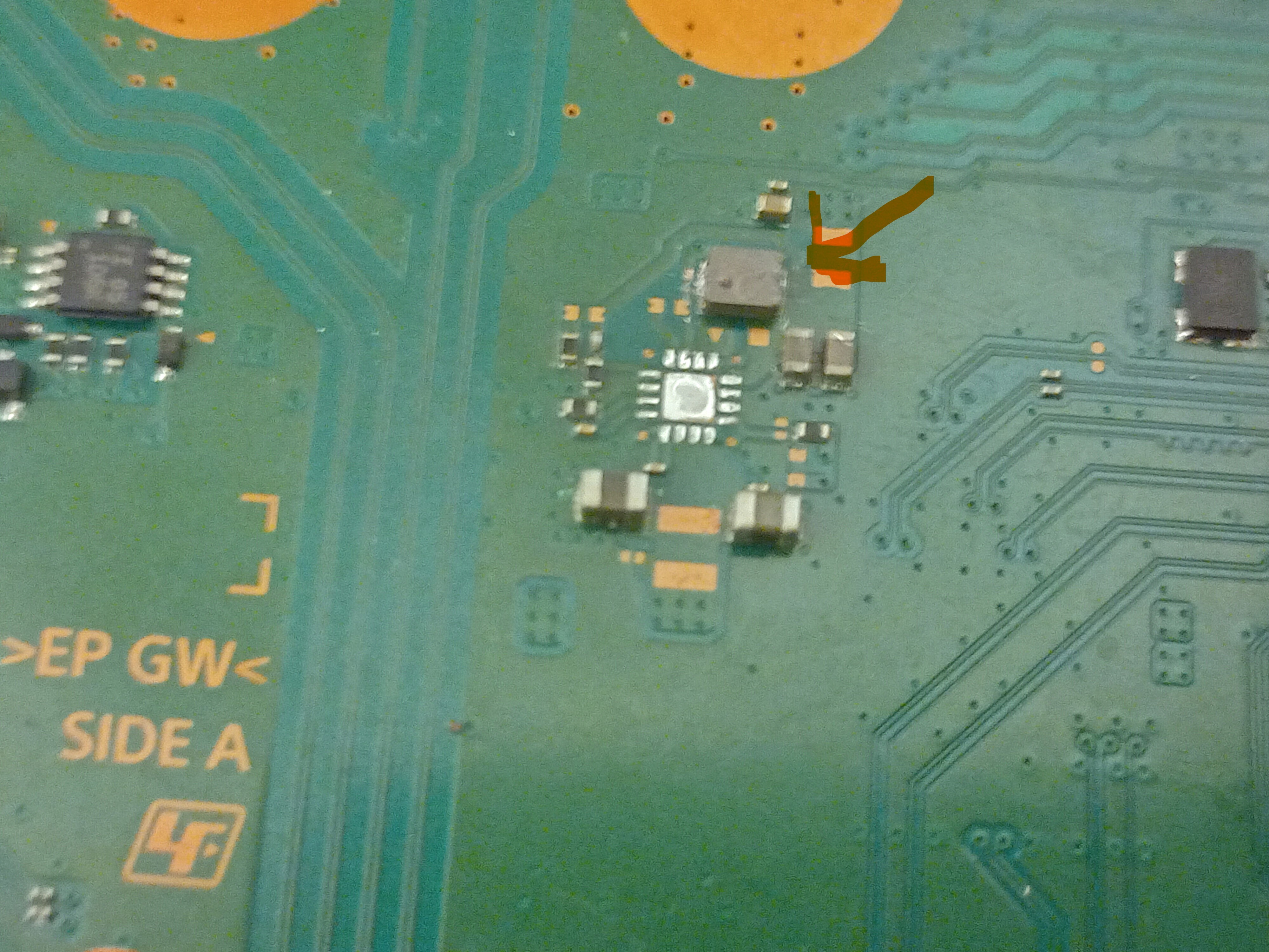

    Hi.all.
    Working on a PS5 EDM-010 motherboard and i've located a short after the TLV62090RGTR 5v to 3.3v chip directly behind F7002.same chip i think. I've removed the chip thinking that was the problem but the short is still there.I injected 1v at 1 amp on output coil (arrowed in picture) but nothing shows up on my thermal camera. No boardview so I because I dont know which rail it feeds i'm reluctant to up the power injection.I could use some help with this if anone has any ideas. Click image for larger version

    This rail goes to WiFi/BT module. Check there.

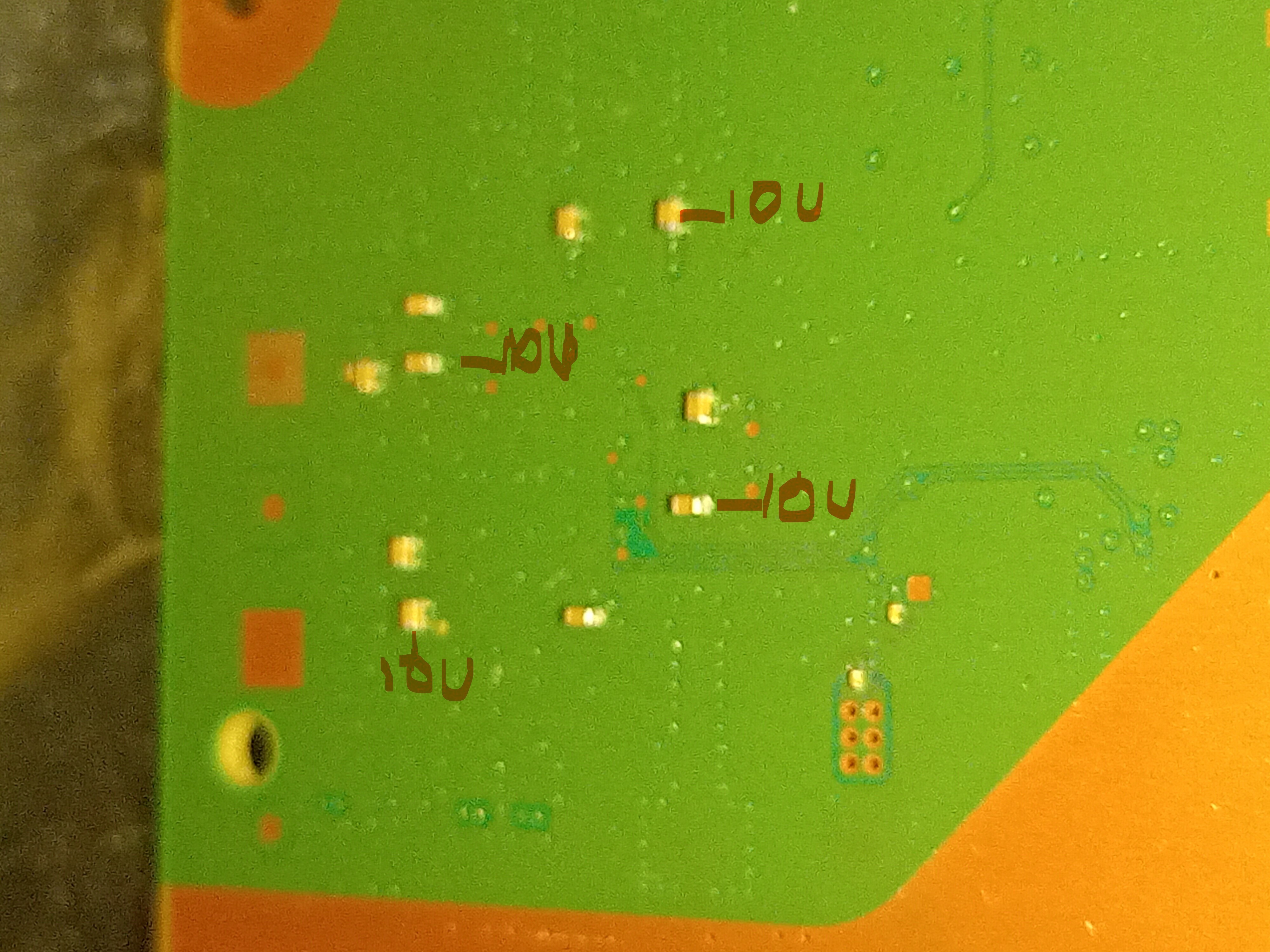

      Thanks ofr the help Manieq.
      There are ten caps on the underside.I've been advised to remove them one at a time to see if it clears the short.I'll report back on my progress. Click image for larger version

        Basically, the chip in the module itself dies, just like in PS4, PS3.
        It is powered by 3.3V and 1.8V.​

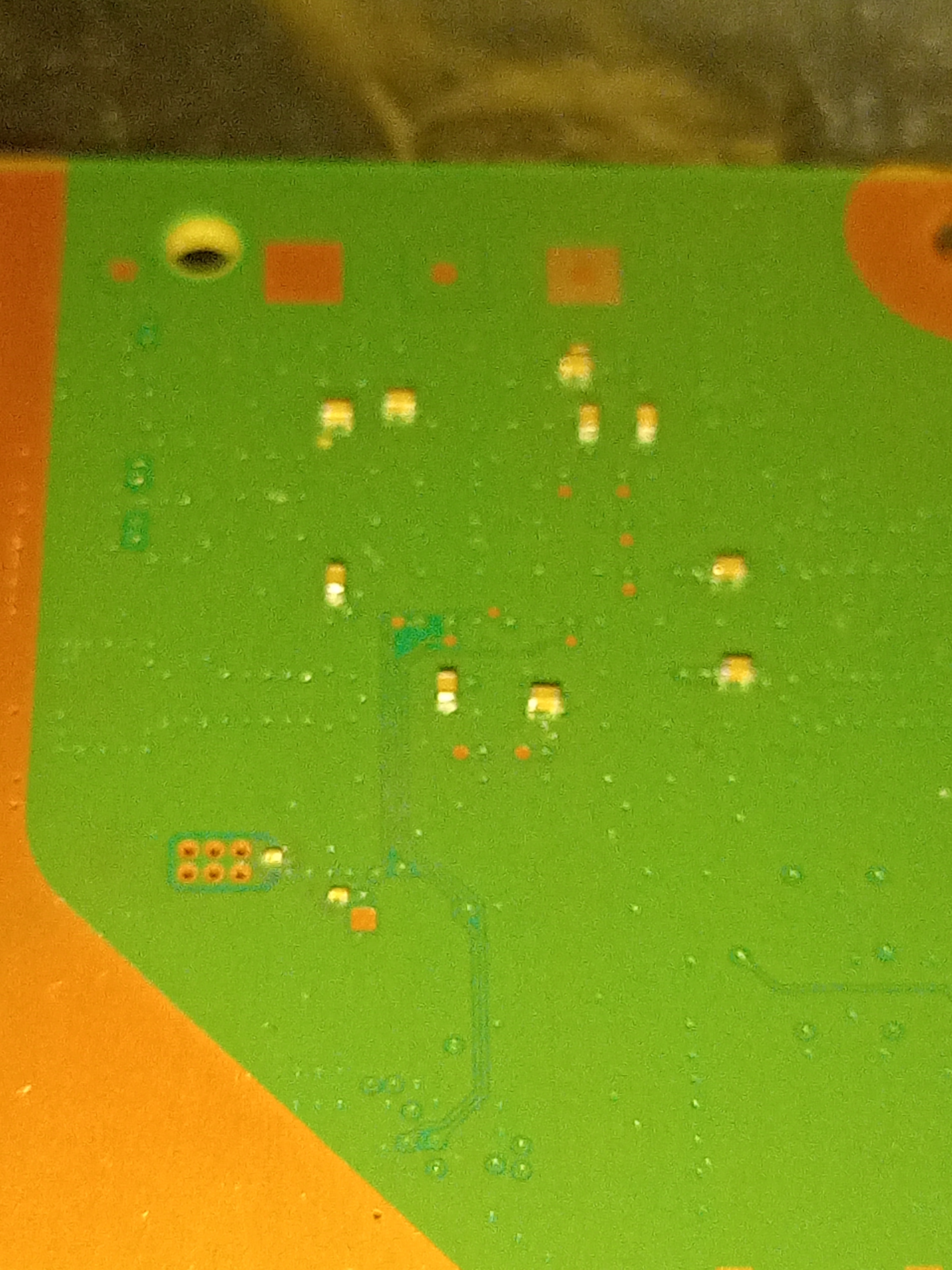

          Thanks for the input lotas,Just removed all the shorted caps uner the ic (see picture) all 10Uf. removed the two 22uf caps near the inductor also but still shorted.Looks like its the Wifi chip itself, Is there any way to test it.
          Click image for larger version  Name:	IMG_20241220_123723.jpg Views:	0 Size:	1.58 MB ID:	3532745

            Remove the Wi-fi module and check whether the short connection disappears or not.

              Just to update,I managed to remove the shield on the wifi chip and was the able to see the short was indeed on the ic.Sent for replacement so should soon be up and running.Unfortunately I managed to lose one of the two 22uf caps on the output side.Just wondering what voltage they are.

                As I said, the problem will be in the chip, you shouldn’t have soldered these capacitors. Install any capacitors, the voltage on them is only 3.3v and 1.8v.

                      The output voltage on the TLV62090RGTR is set by a divider consisting of resistors R1 and R2.

                        Thanks for the help Iotas.
                        Could you identify them on my first picture so i can test?.
                        • lotas
                          • Jan 2016
                          • 4642
                          • Russia
                          Most likely these (they sit on 5 pin.).

                            Thanks for pointed them out.They read good.
                            Struggling to find the 500k shown on the diagram. If thats ok it must be something to do with chip.
                            • lotas
                              • Jan 2016
                              • 4642
                              • Russia
                              Yes, just install a new chip, and it will output the correct voltage, which will be set by its divider (R1+R2).
