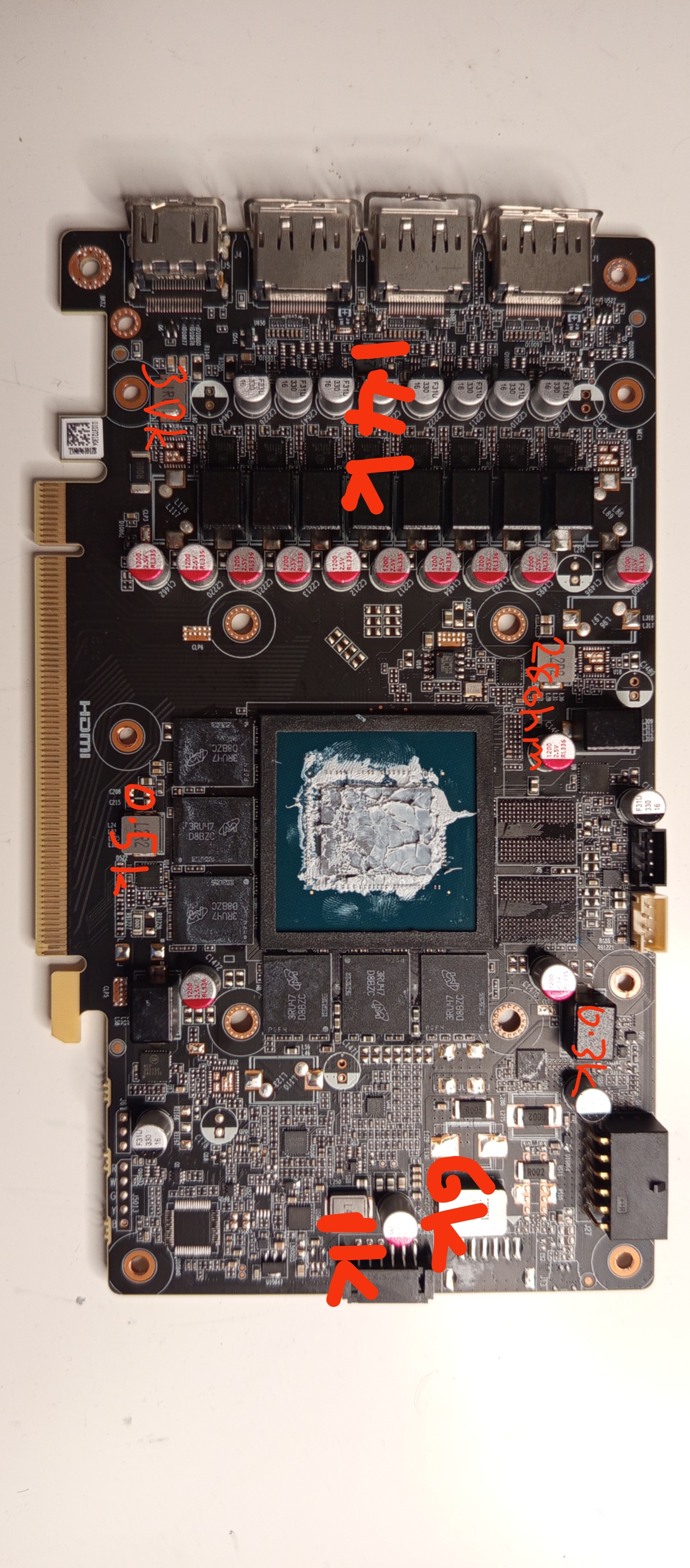

Resistances:
Ext 12v = ~6-7kohm
PCIe 12v = 30kohm
5v led = 1kohm
5v = 1.4kohm
3.3v = 91kohm
1.8v = 0.5kohm
PEX = 28ohm
Vmem = ~350ohm
From resistances PEX and Vmem seem quite high however nothing would indicate as being shorted.

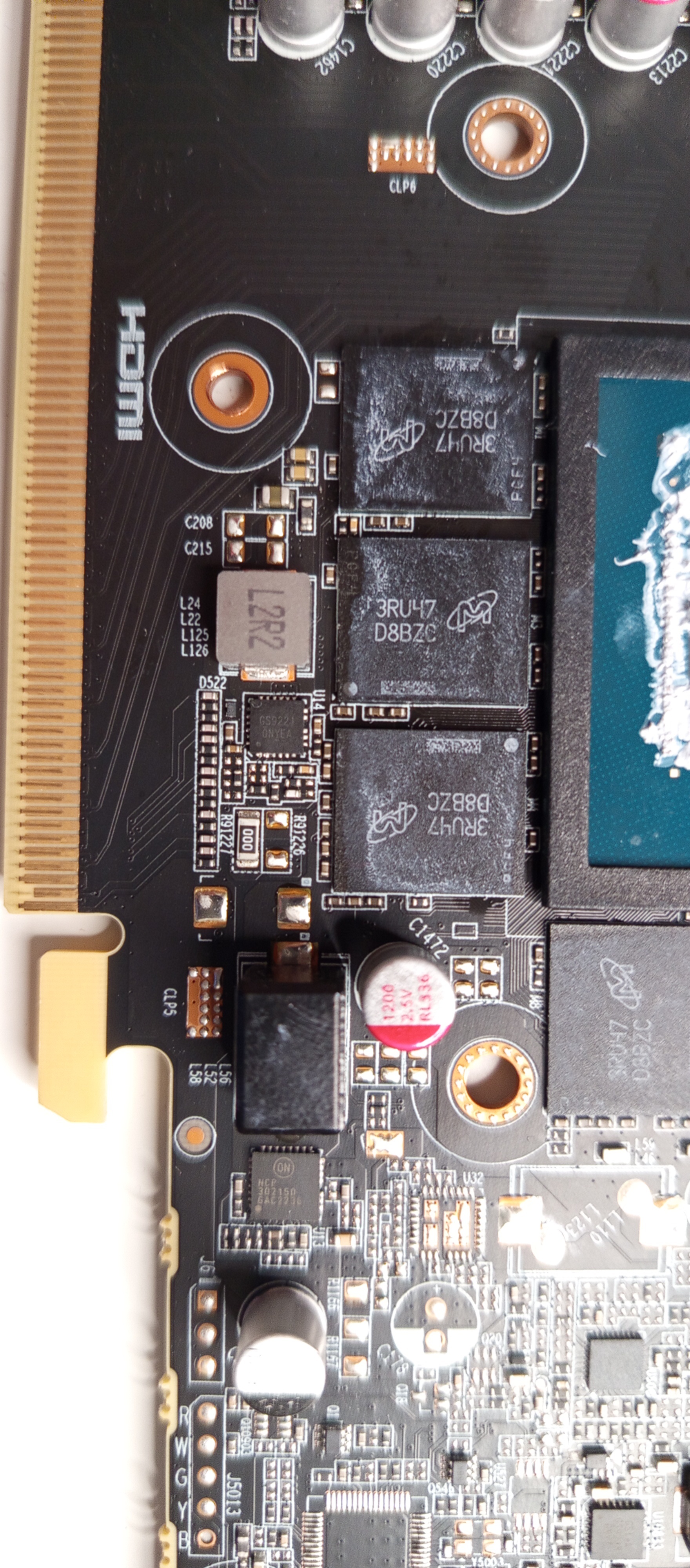

Based on this I suspect that the 1.8v buck converter is faulty.
Checking for EN, VCC, and PGOOD signal reveals that they are all present even after the output dips to under 1.2v.
En and PGOOD ~ 3.3v and VCC = 5v
Would I be correct here in assuming the 1.8v/1.2v gs9221 buck converter is the faulty component or are there any other tests I can do on the other pins of the buck converter or the other resistors connected to the buck converter.
I have also attached a picture of the resistances and a close up of the buck converter.
