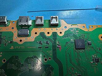

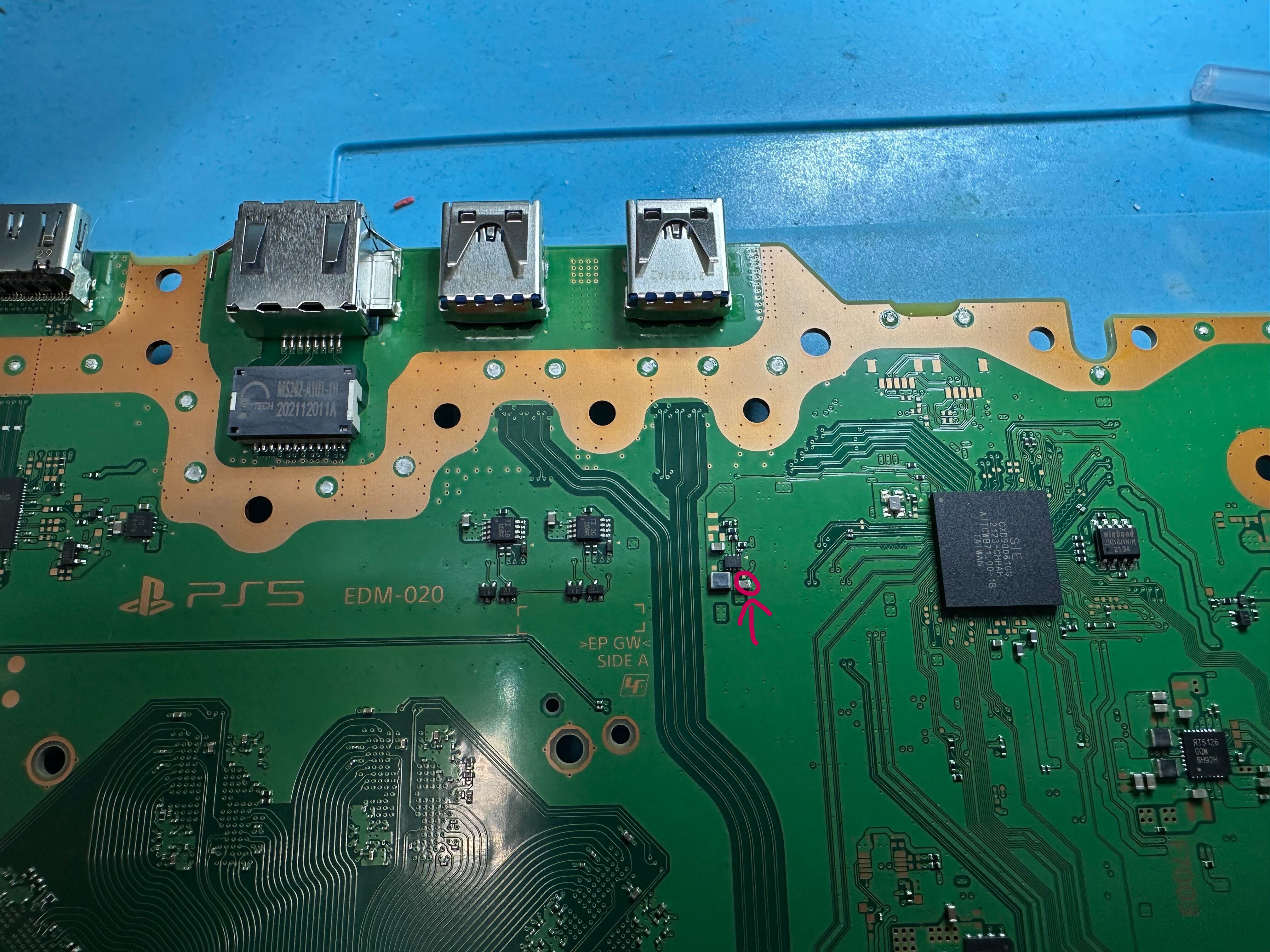

    Hello
    Anyone able to tell me what value this cap is? Cracked and shorted.
    Thanks in advance

    47uF/6.3V
