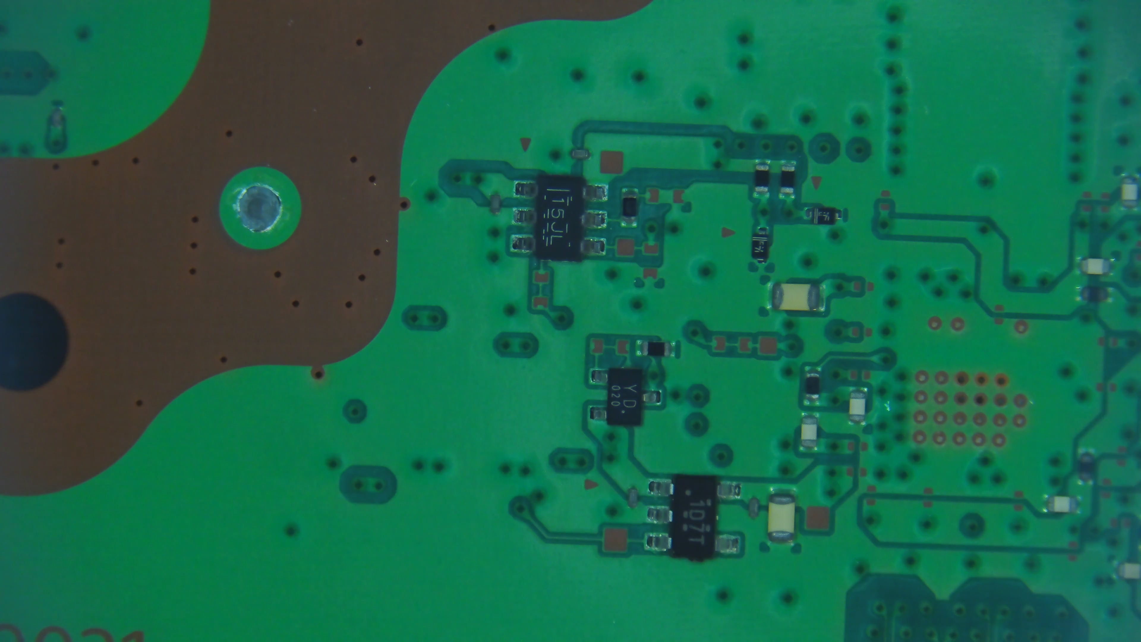

    Hello Guys!
    I recently bought a PS5 with WLOD.
    Somebody already worked on it and knocked off some diodes unfortunately.
    It can go to safe mode, and boots up perfectly to system aswell. I hear backround music from the controller with earphone and somehow started a game.
    I need your help to find / indentify these components to complete the circuit.
    What i looking for are circled in pink.
    Thanks for your help!

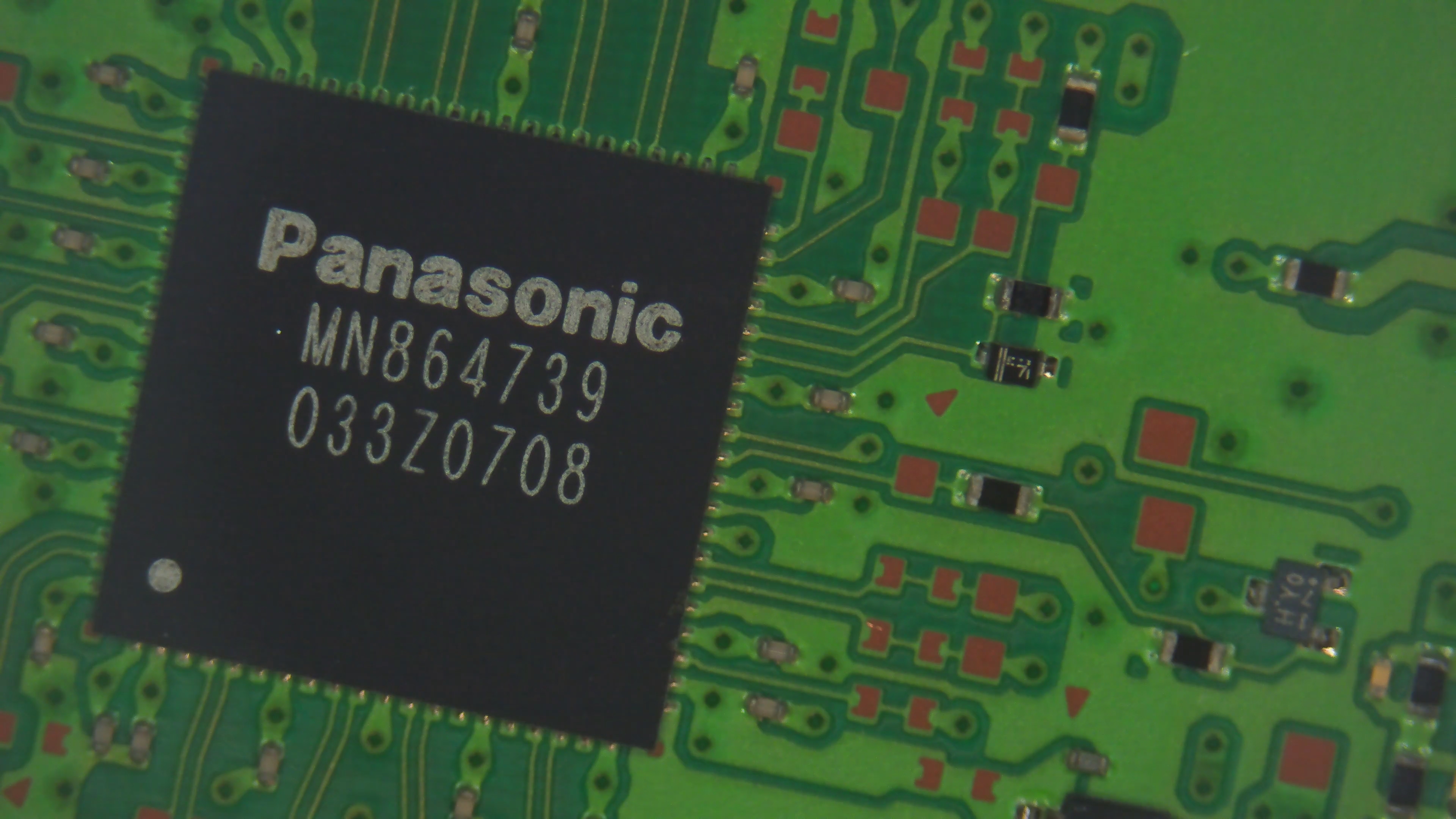

    Ok, I found the diode next to the encoder chip. Looks like its a zener diode. And I get the orientation.
    But what type the other ones and what is the orientations for them?
    In the original post second picture is under the hdmi encoder chip, back side of the board
    Can somebody take close up hd picture of it please?
