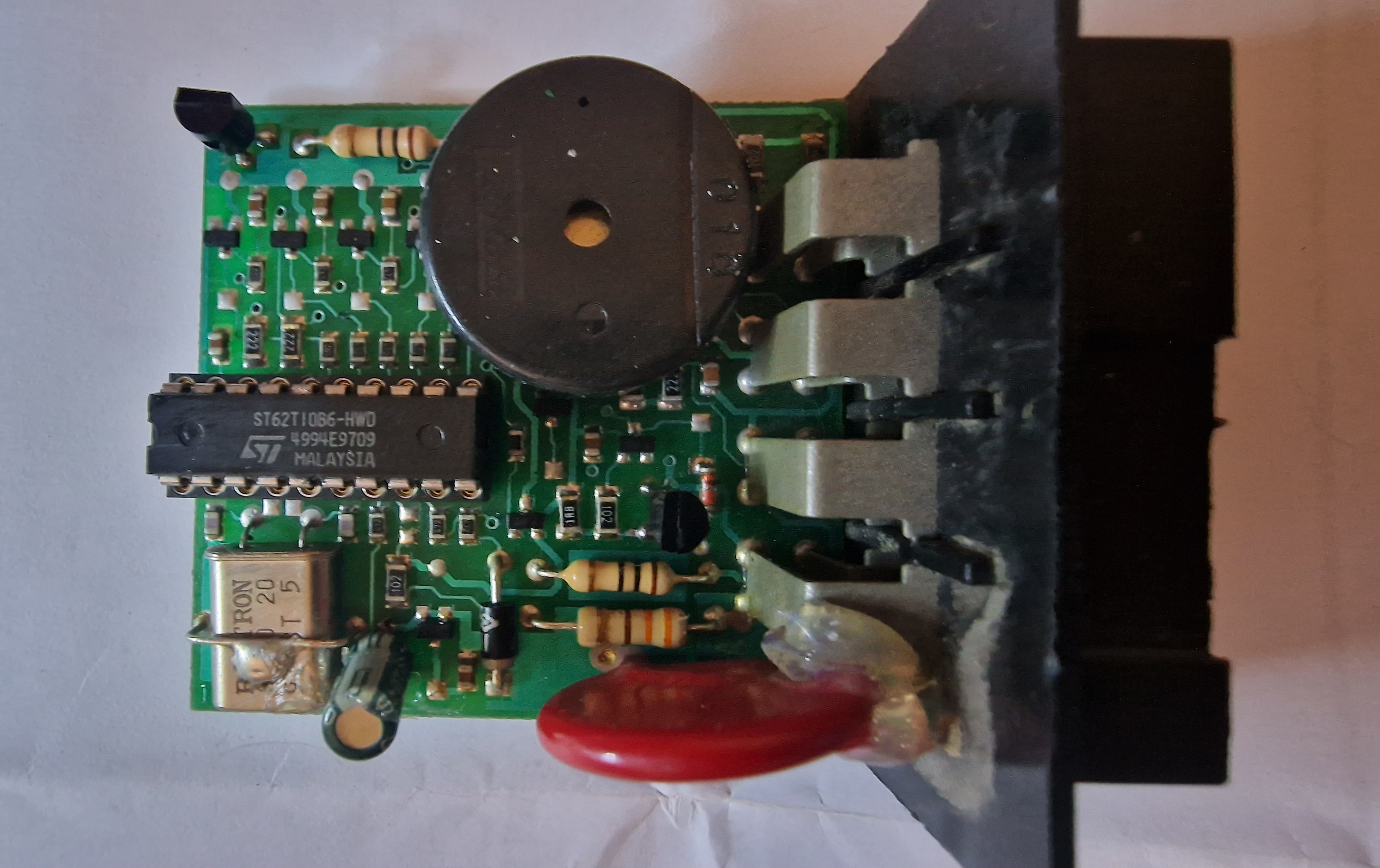

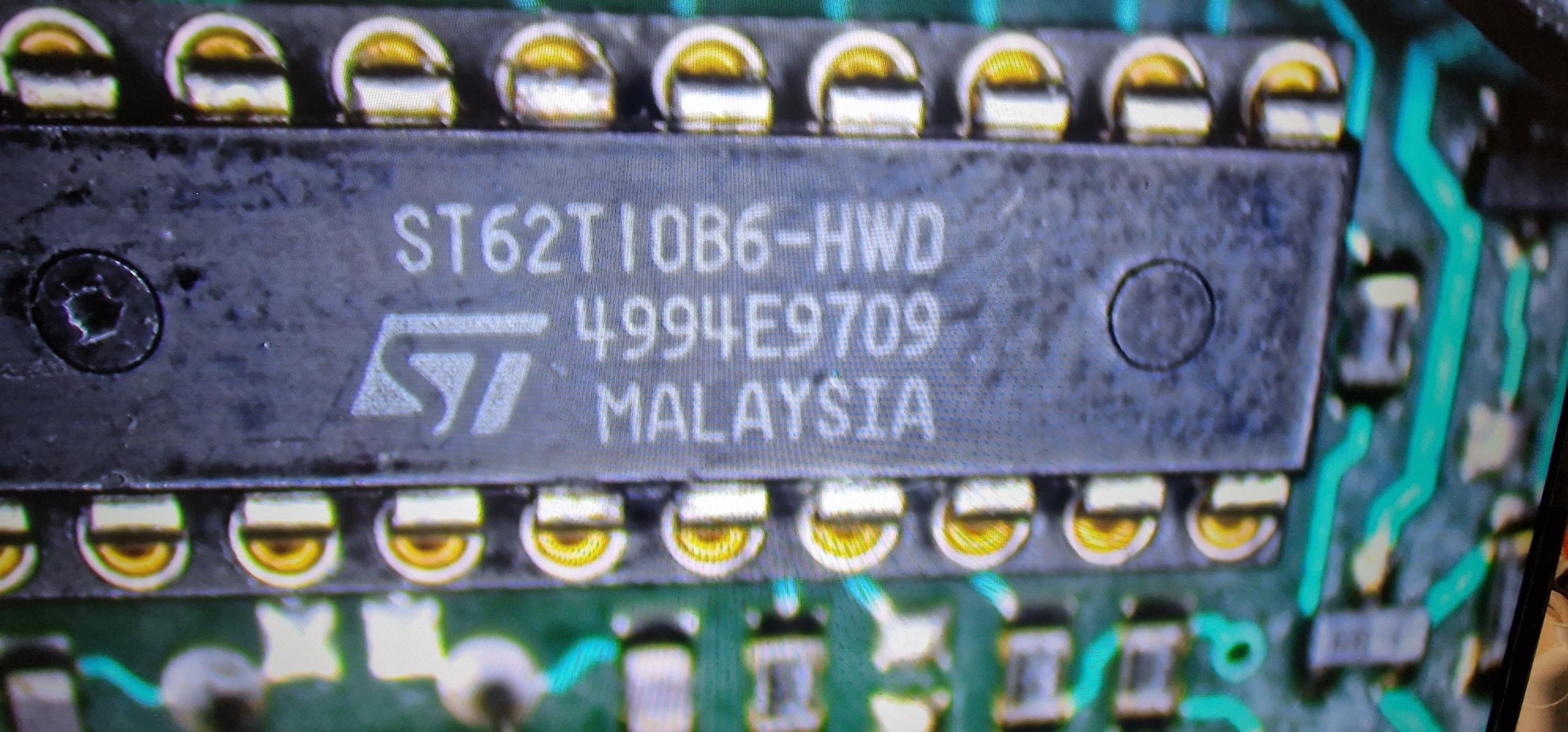

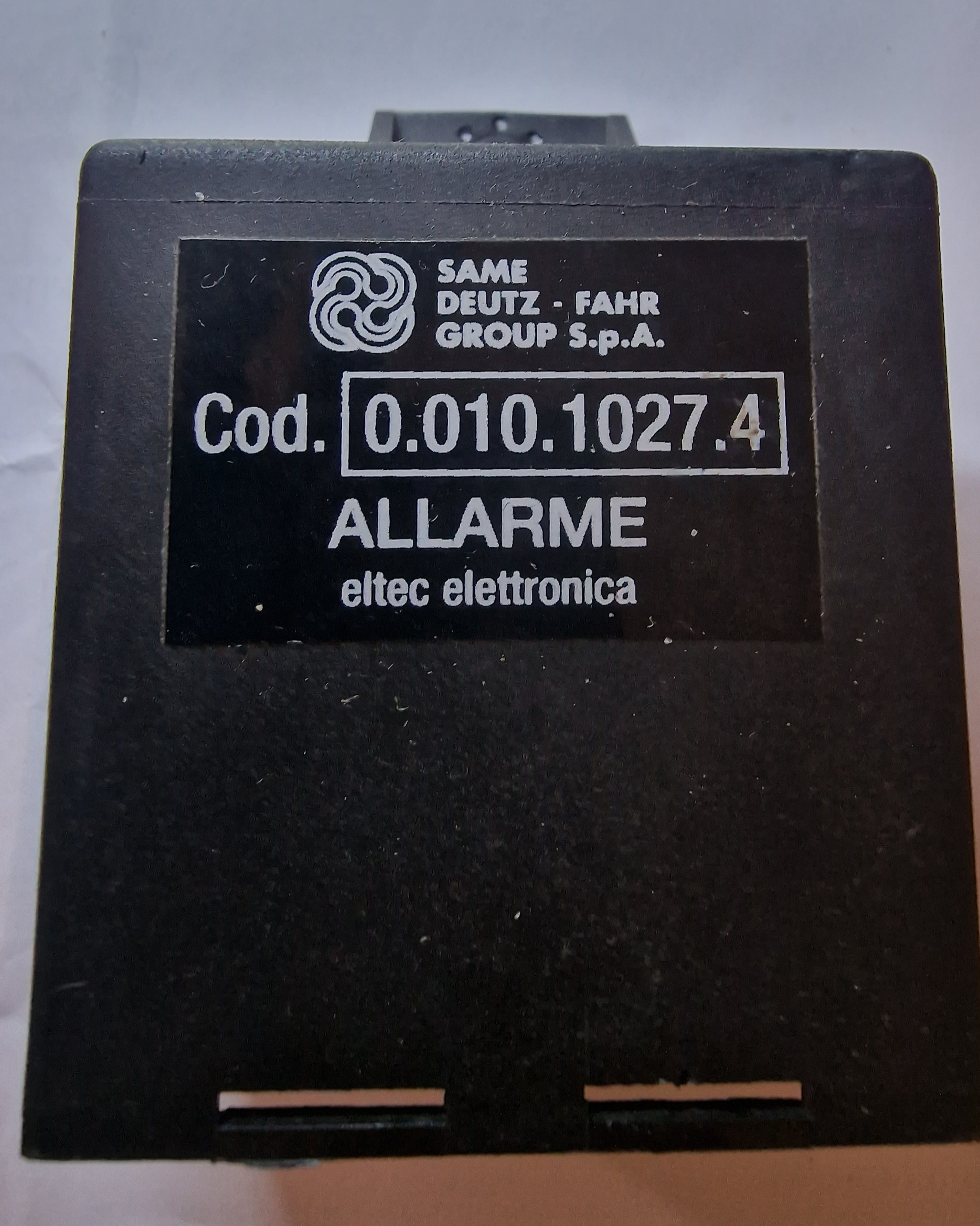

    Hi guys , a friend of mine give me this kind of electrical thing he says when it turn on the track without fire up , the buzzer still on and keep beep . So it's possible to test it to understand if it's shorted..? Thank you for the answer

    its more likely to be whatever switches the buzzer on . you should check the tractor itself

      You need to diagnose the problem with this module installed in the tractor.

        or find the pin out for the module and build a test circuit .

          what tractor model is it from ? there might be a workshop manual for it .

            same silver 100.6

              What test I can do..? When it's plugged the buzzer turn on like loop. Thanks

                Maybe try over at tractorbynet.com and see if someone has an idea. Is SAME a rebranded Deutz-Fahr? Similar like Case and New Holland? Bigger tractors have something similar like an OBD1 or OBD2 port to read out the trouble codes with a appropriate scanner.
                Also see if you can either get for free or purchase a workshop manual.

                  find the manual and post a link to it .
